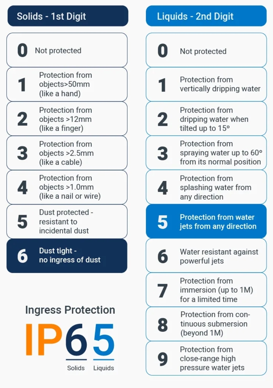

IP65 does not protect against submersion.
