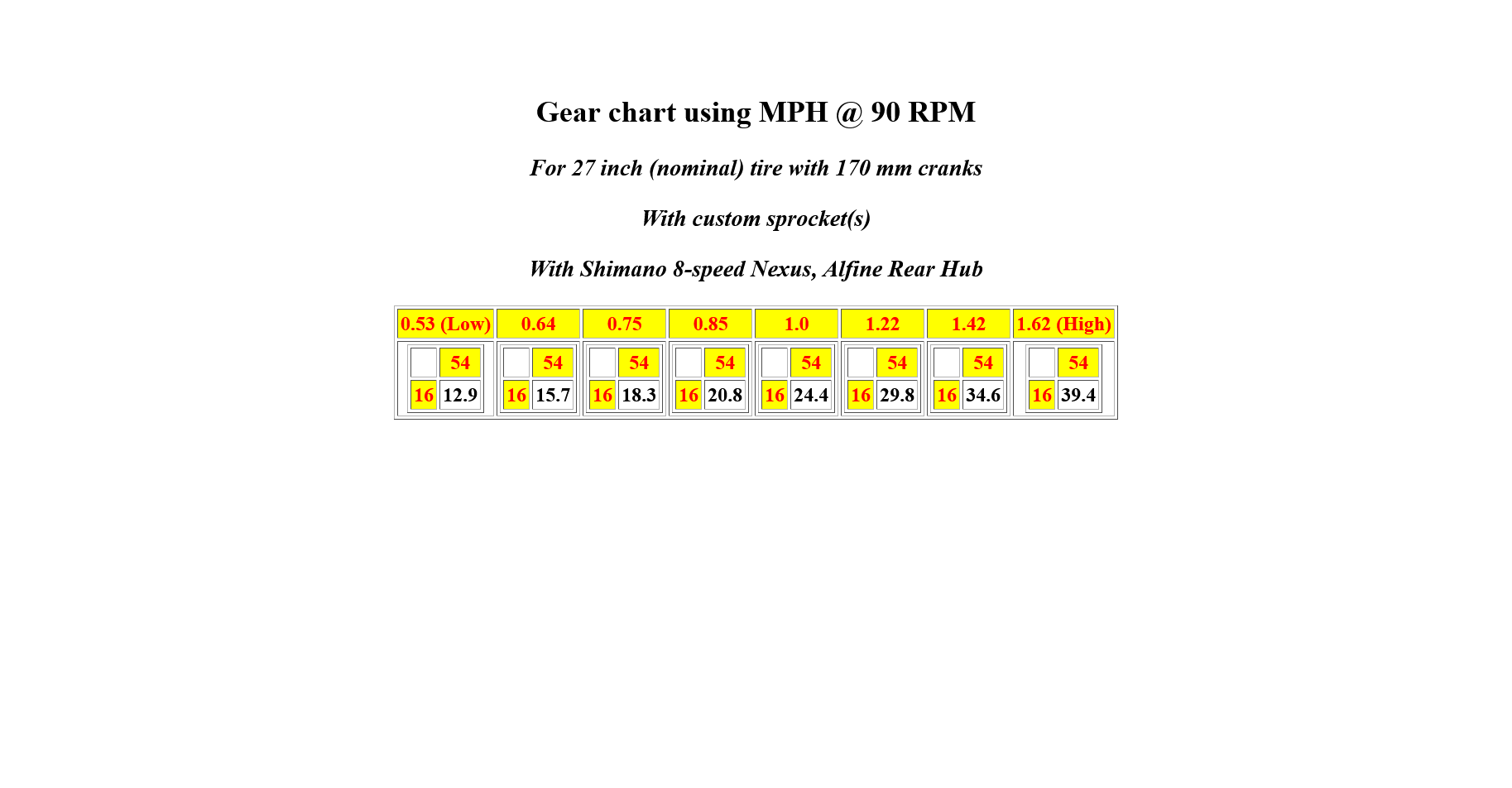

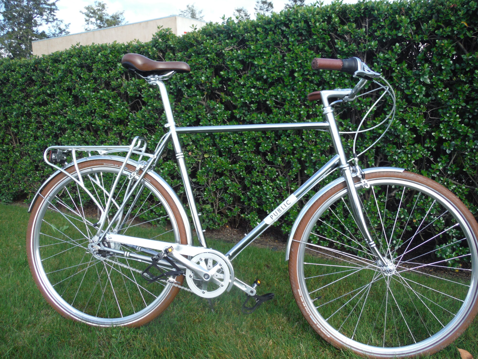

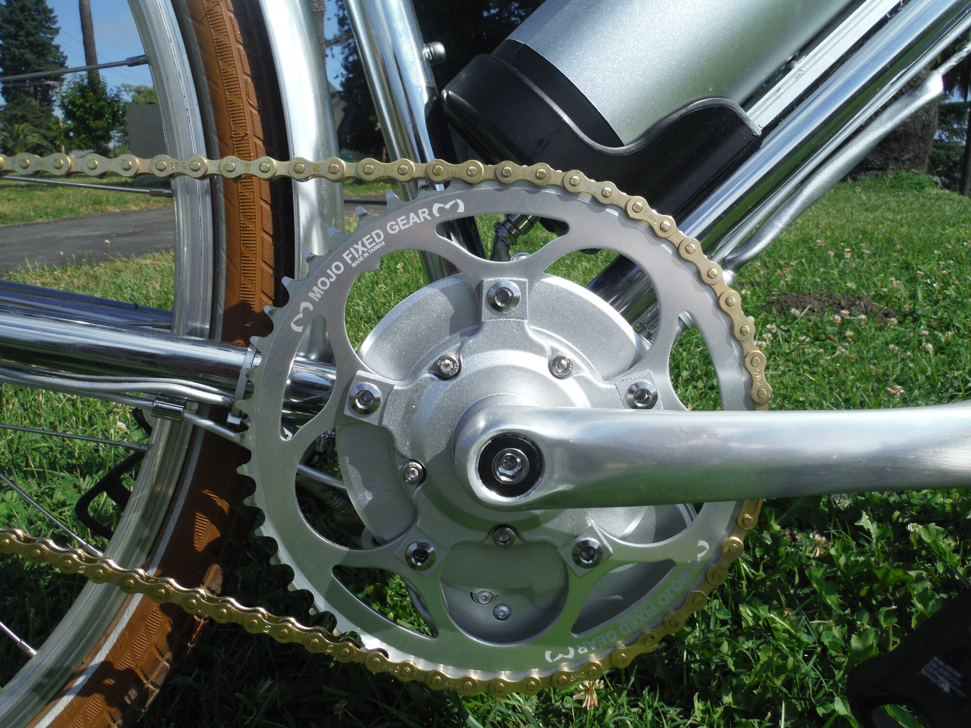

I converted this bike and installed a 54. I would ride it flat out at full power but, because I was not lightly spinning like I should have, I killed the internal bearings. I wish I still had it. That chrome frame was so beautiful. It got tan wall gravel 42's a Brooks B17, and leather grips. I used silver engine paint on the motor before installation. This was before I knew how to hide wires or go thru frame. On the Nexus 8 I dropped the cog to 16-t. Sheldon Brown's gear calculator put top speed a 39+ at 90. Sorry bike. I miss you. But I loved you to death.

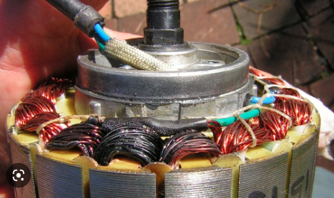

Heat is what is hard on the controller and the motor. Draw the highest amps all the time and pretty soon the varnish on the windings in the motor will degrade or melt.
