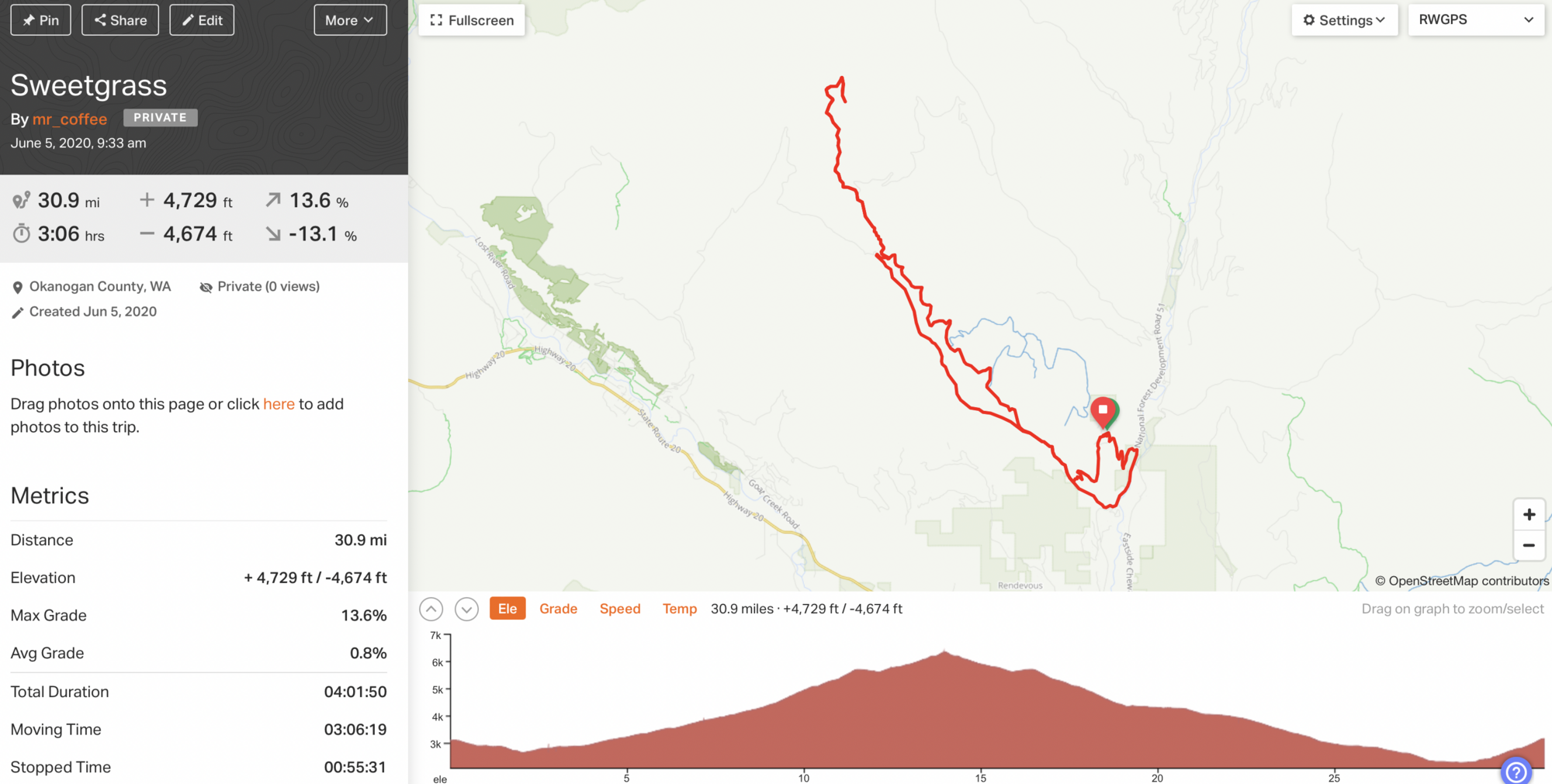

31 miles, granted lot of elevation changes, and it took 3 hours. So what? Is that not an average of 10mph? Show me something like that's much flatter, and run at 20mph while pulling 600w. THEN you have something relevant to this discussion. ;)
