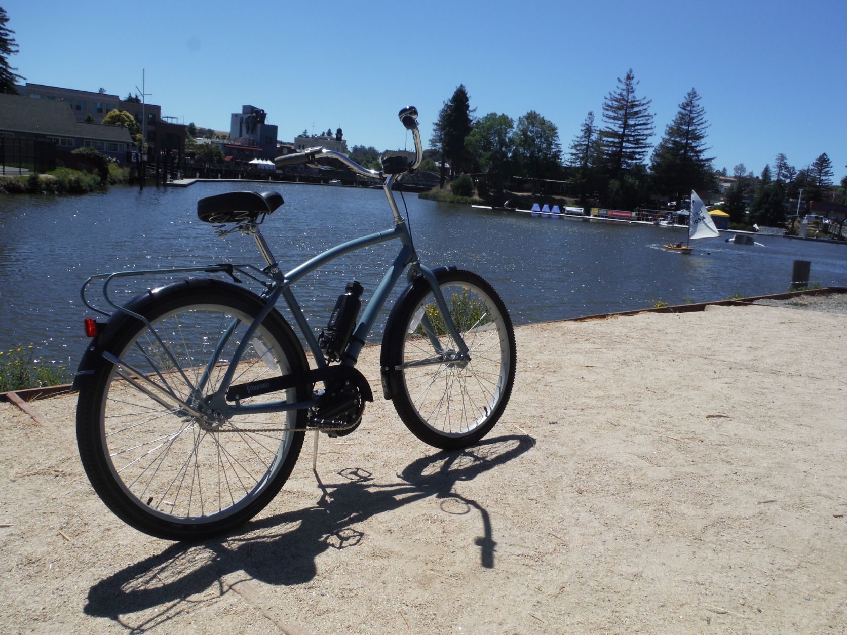

My one speed mac step through scratch build does just fine as a one speed, 42T X 20T around town with pas or throttle when to pooped to pop. If I’ve learned anything here it’s we’re all eBike fans. I’m often critical of factory direct bikes, not because they’re all bad but because buyers are often clueless and taken advantage of by som3 sellers and refuse to own their choice. I’m also critical of Sur Ron and their ilk no5 because they’re bad but because I have a nagging feeling that they have brought on the nanny state. i despise the fact I can own a 120mph cage and be trusted to use common sense but I’m hobbled if my ebike can potentially propel me over 30mph. IMO unfair selective enforcement. I sold my class three and faster builds in favor of 20mph limited eBikes. But I have no high ground. I’m finding more and more I just like eBikes and nit picking choices is, well, dumber than snot.
