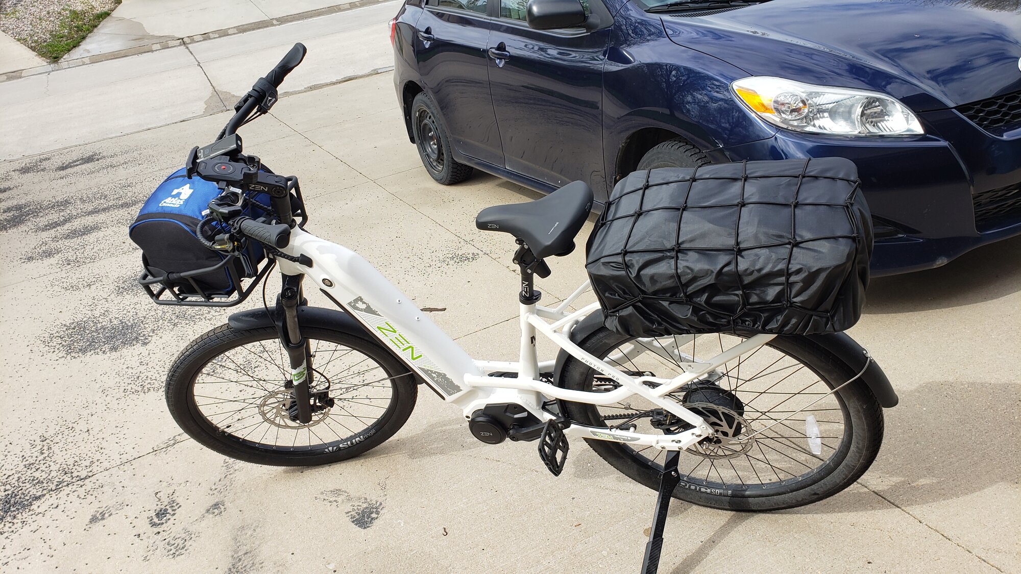

Testing the cargo capacity today. In the front is a cooler full of ice and Gatorade. In the back, some clothes and granola bars for energy.

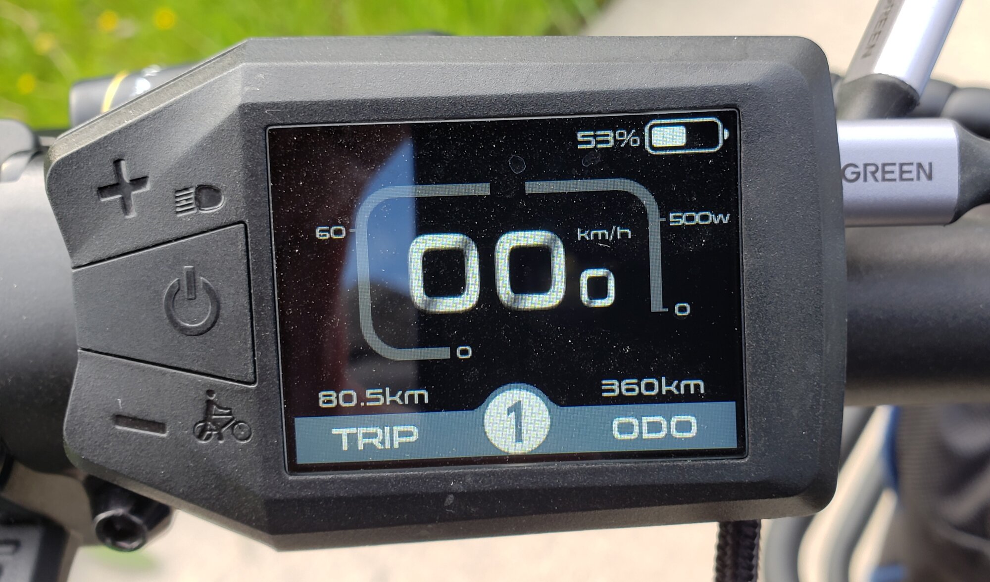

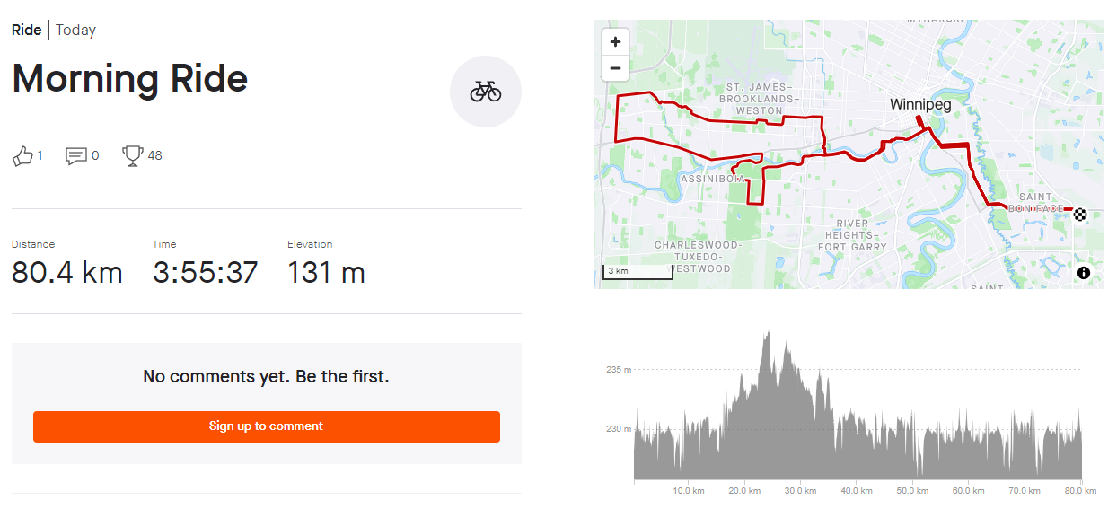

We covered 80km with about a third of the way in the middle of a severe thunder storm. Battery remaining at the end of the trip was 43%; we used 57% battery for 80km, not bad.

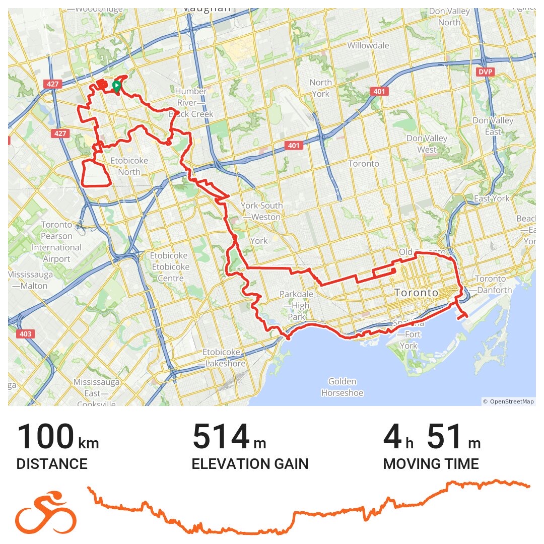

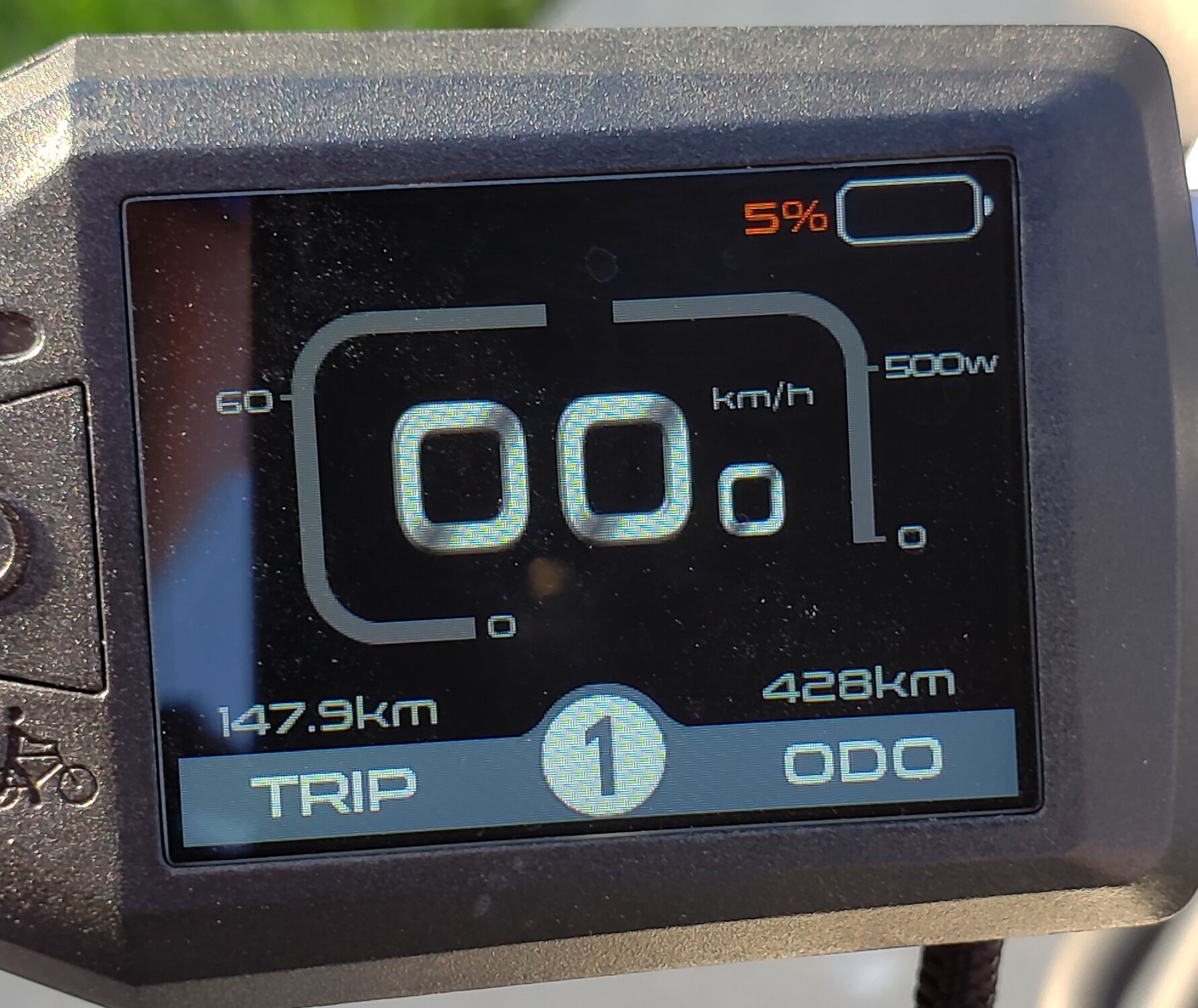

Did my first 100km (60 mile) ride. Started with a full 100% battery, finished with 21%. Just PAS 1 for most of the ride with the odd throttle. I’m a bit of a heavier rider, so getting 140km is bit unrealistic me, but I’m sure others can. Already have over 1500km on the bike and I’m loving it. Hope you all get to enjoy your bikes soon enough.
View attachment 176219View attachment 176220
