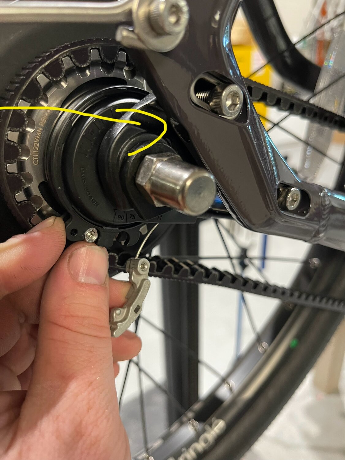

Yeah, 2 or 3 days after posting on here I received the email from Drew on my questions. I would have never figured out where the tension screw was if it wasn't for these pictures... never thought it was part of the hub itself.
What did you end up tightening to? My tests with the Gates app have me in the right range-ish so I'm leaving tension alone.
Still haven't narrowed down the whistle from wind I keep fighting with, will need an air compressor to be at all accurate in finding it, I think.. It's not the cranks themselves. It's either motor casing(which I've made some educated guesses about and covered with tape to test), or something inside the motor itself.
My Kricket kept showing 35 pounds or so of tension and was within the acceptable range, the best tension suggested for an ebike is around 40 pounds so I moved it up to around there so I wouldn't have slippage when I am really pushing it. What is funny about my whistle is that it keeps setting off my Apple watch's loud noise alarm.. lol.

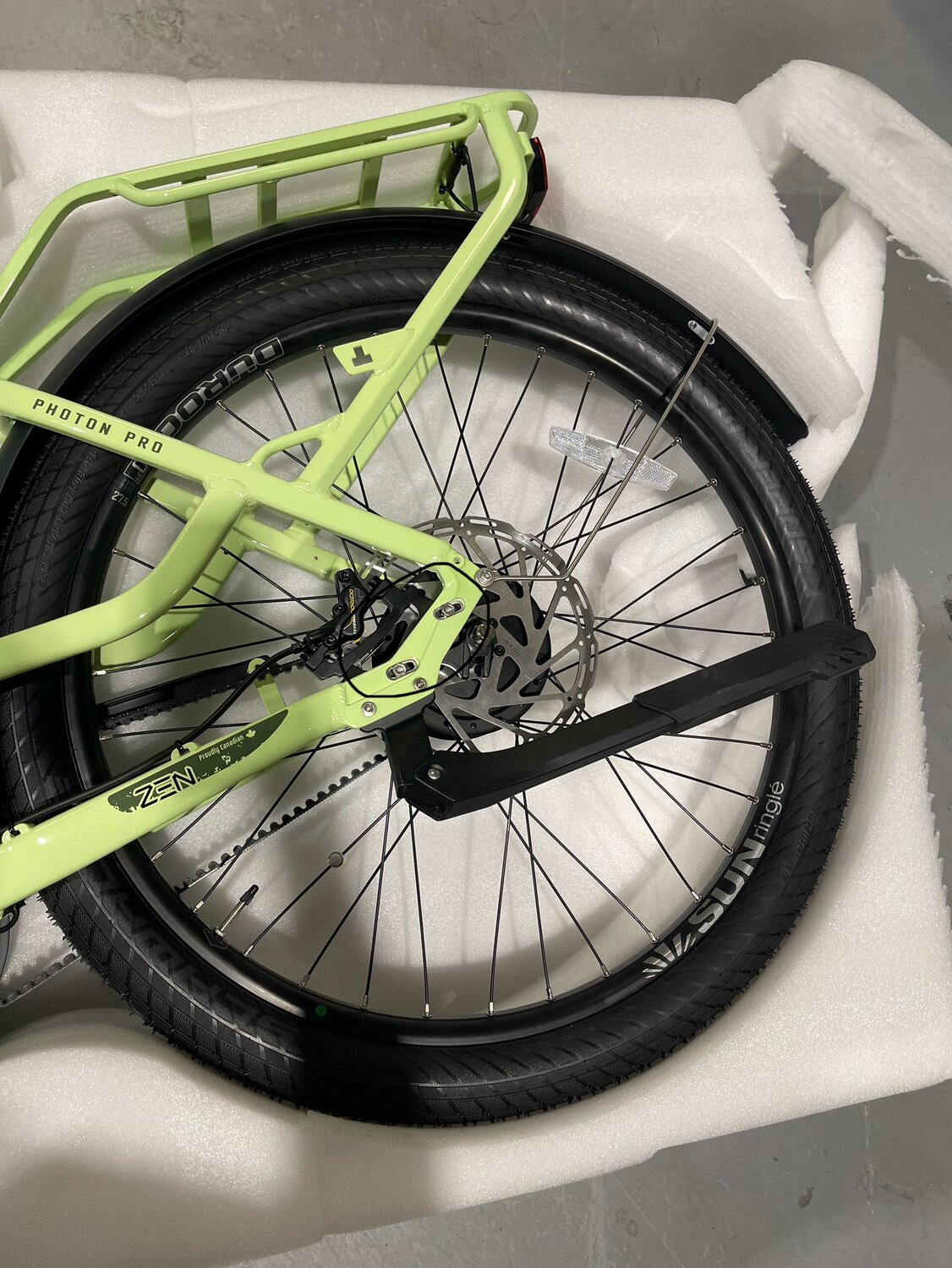

It took about 29 minutes from unboxing to built status. Nothing complicated at all. Of course, I used to wrench my own bikes when racing MTB back in the day, too. In reality that experience has nothing to do with how easy it is to build up out of the box.
First impression? This is a BIG bike!

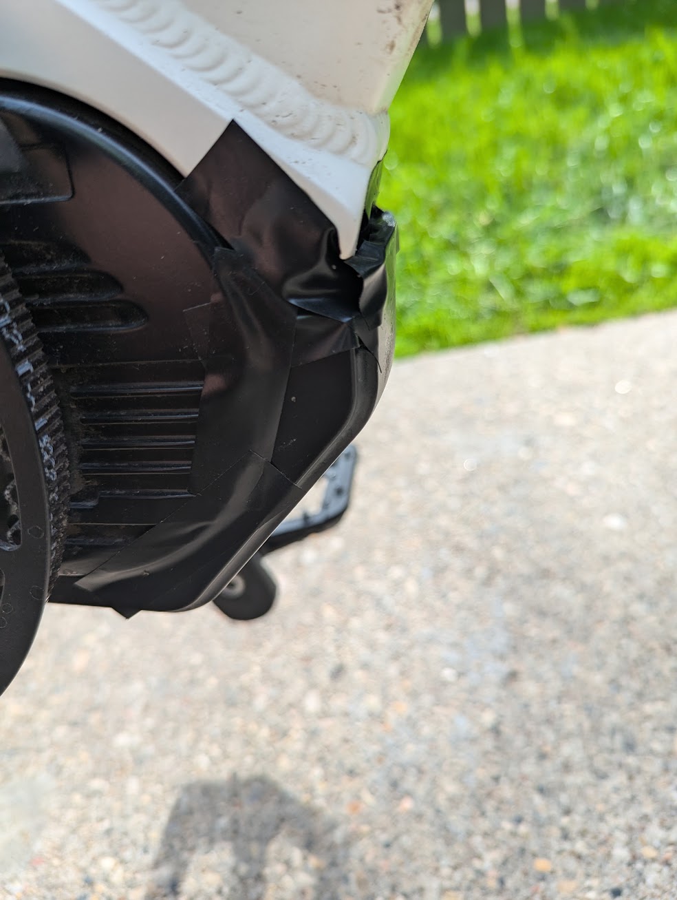

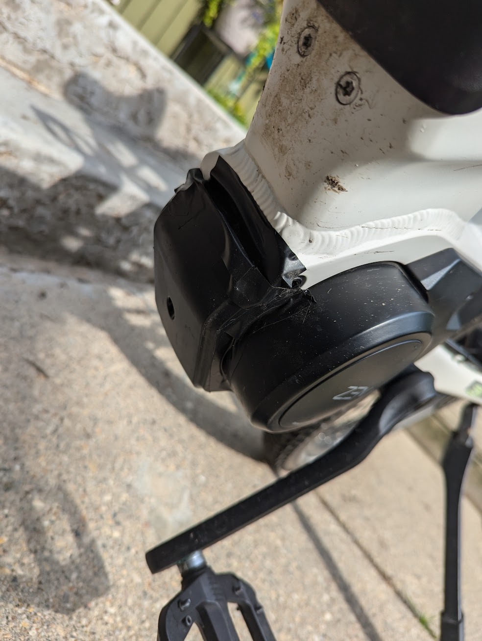

I think I finally zeroed in on the whistle. My first tape test was not enough coverage, but it's definitely the outside of motor and motor casing making the whistle between 24-30km/h. I got rather more liberal with the tape(but left the openings clear-ish where the motor meets the frame). Just had my first 10km without the whistle. Gonna recharge both myself and the battery and go for another tour to confirm..It's ugly, and I'll need better tape to sort it more permanently(unless this is the kind of thing I can get parts for, I'll ask, but they're stretched thin as Ravi mentioned).
We will look into this today. Thank you for sharing the details.
