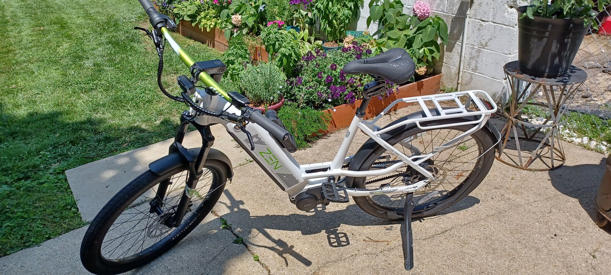

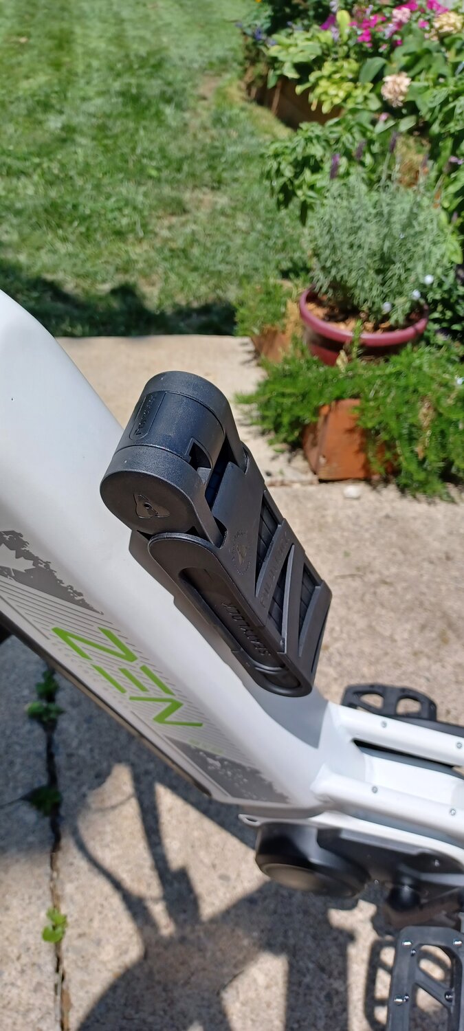

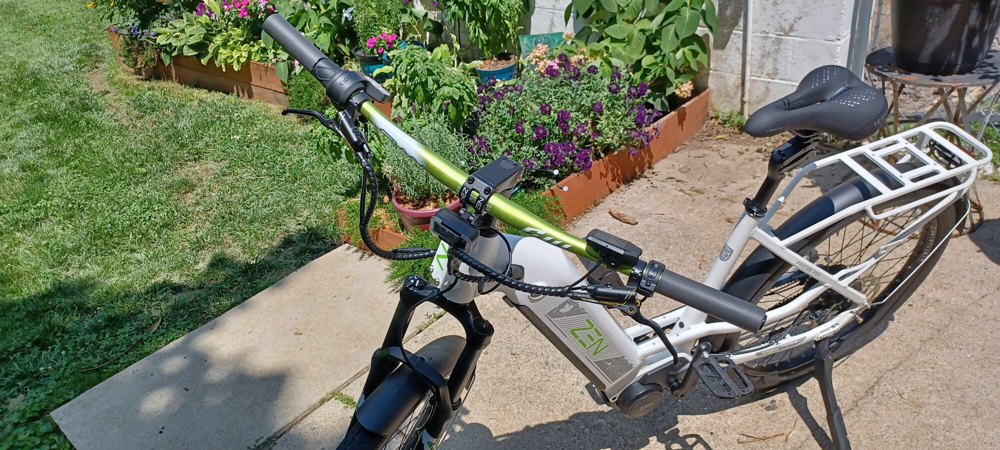

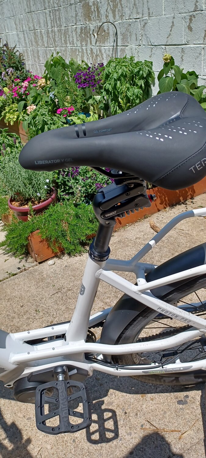

I have updated my bike: flat bar, grips, saddle and seat post clamp. Plus, a Foldylock. Much more reach. Silicone grips are tacky plus more comfortable. Yet to see the impact on a long ride.
Went with a Terry Liberator Y gel. 30 day trial plus support my local shop.
The bike is a bit quicker turning too.

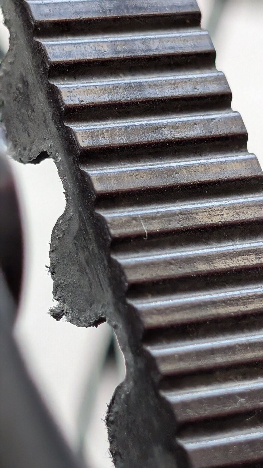

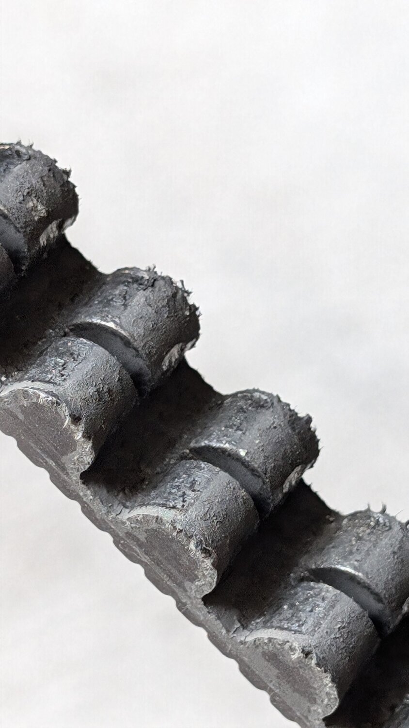

This is super awesome!! Thanks for sharing and perhaps, if you can share pictures of the bike, Gates belt condition every 500/1000kms, it would make for a real-world testimony of the long-term durability of the Gates belt drive and Enviolo hub.

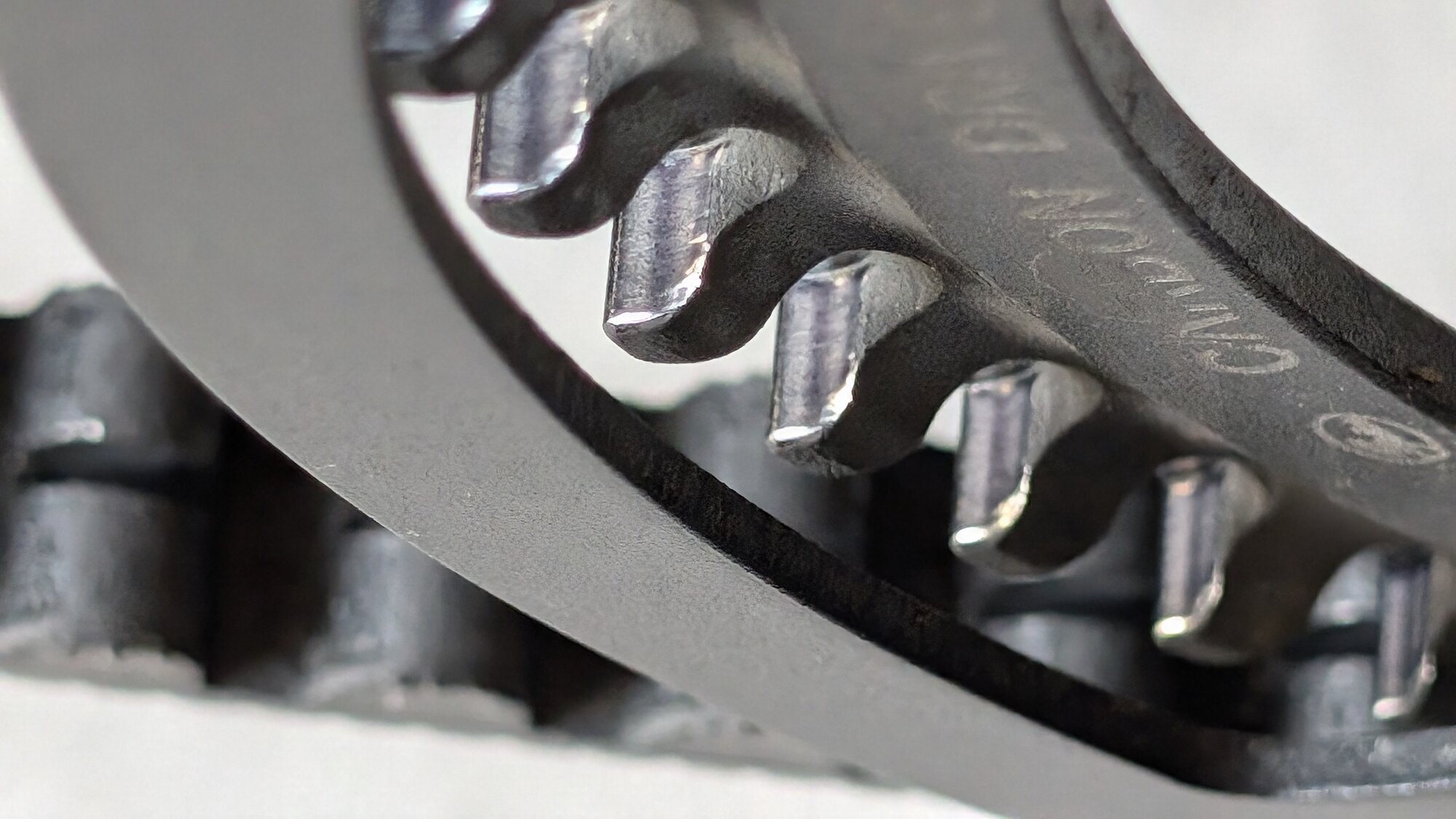

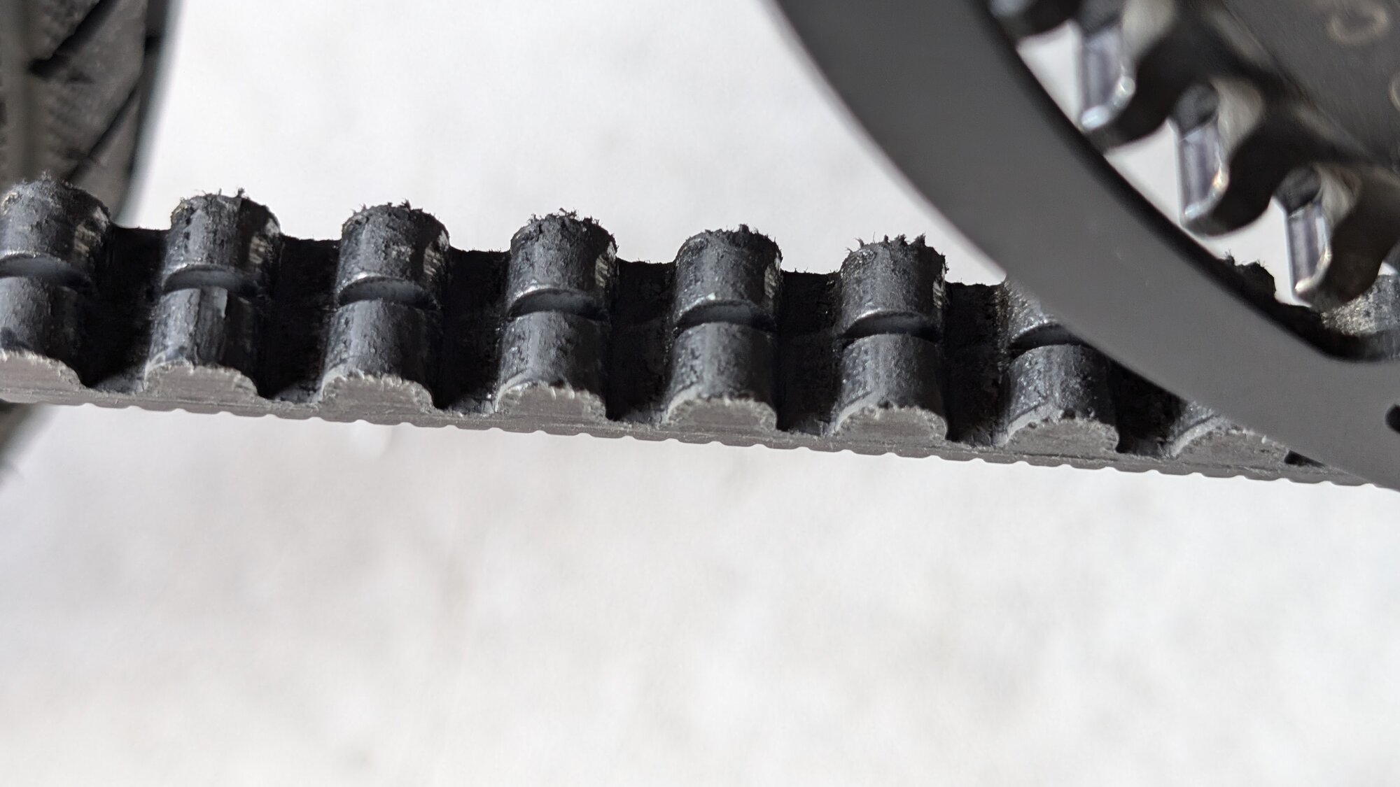

Hi Kriti, here is what the belt looks like after 5000km. No issues so far.

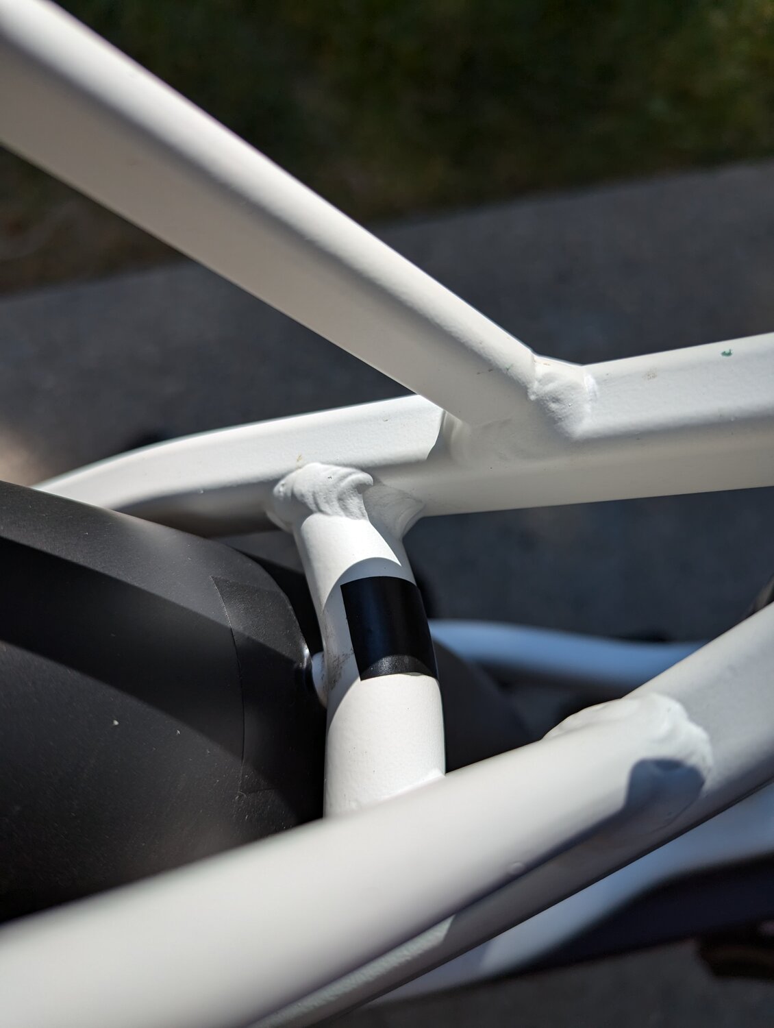

I did also eliminate my whistle, and it wasn't the motor ultimately. Took the tape mess off little by little over several hundred km and found it was entirely the rear fender screw, both the frame hole, and the space on the fender itself were producing the whistle. Cover both and it's gone. Been whistle-free for at least a few hundred km...and I don't have an ugly tape mess on the motor any more.

Still a wee bit of tape. Probably something else could be used, but had this on hand.
This is totally normal. A bit of fiber frayed at the edges is normal, and this is from small rocks and chips.
Gates belt typically lasts about 8000 to 10,000 km, depending on the power level used and maintenance interval.
It would help wash the belt with a simple (NON-pressure) washer-like shower head every 1000 km. This removes any fine dirt that grinds down the polymeric urethane compound and improves its lifetime. Belts lasted me around 12,000 km, at which point I replaced the front and rear sprockets and the belt as preventive maintenance.
  • The #1 reason belts fail prematurely is improper belt tension.
  • #2, accumulation of tiny rocks that start grinding away the belt, and this can be easily eliminated by a simple wash after riding in a very dusty environment.
