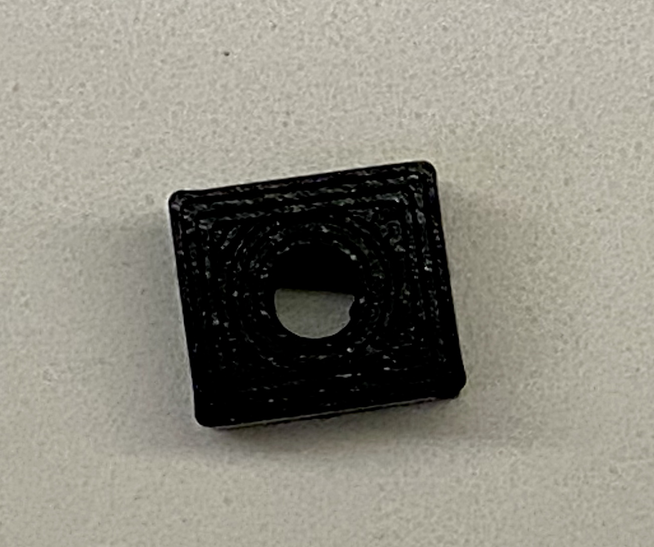

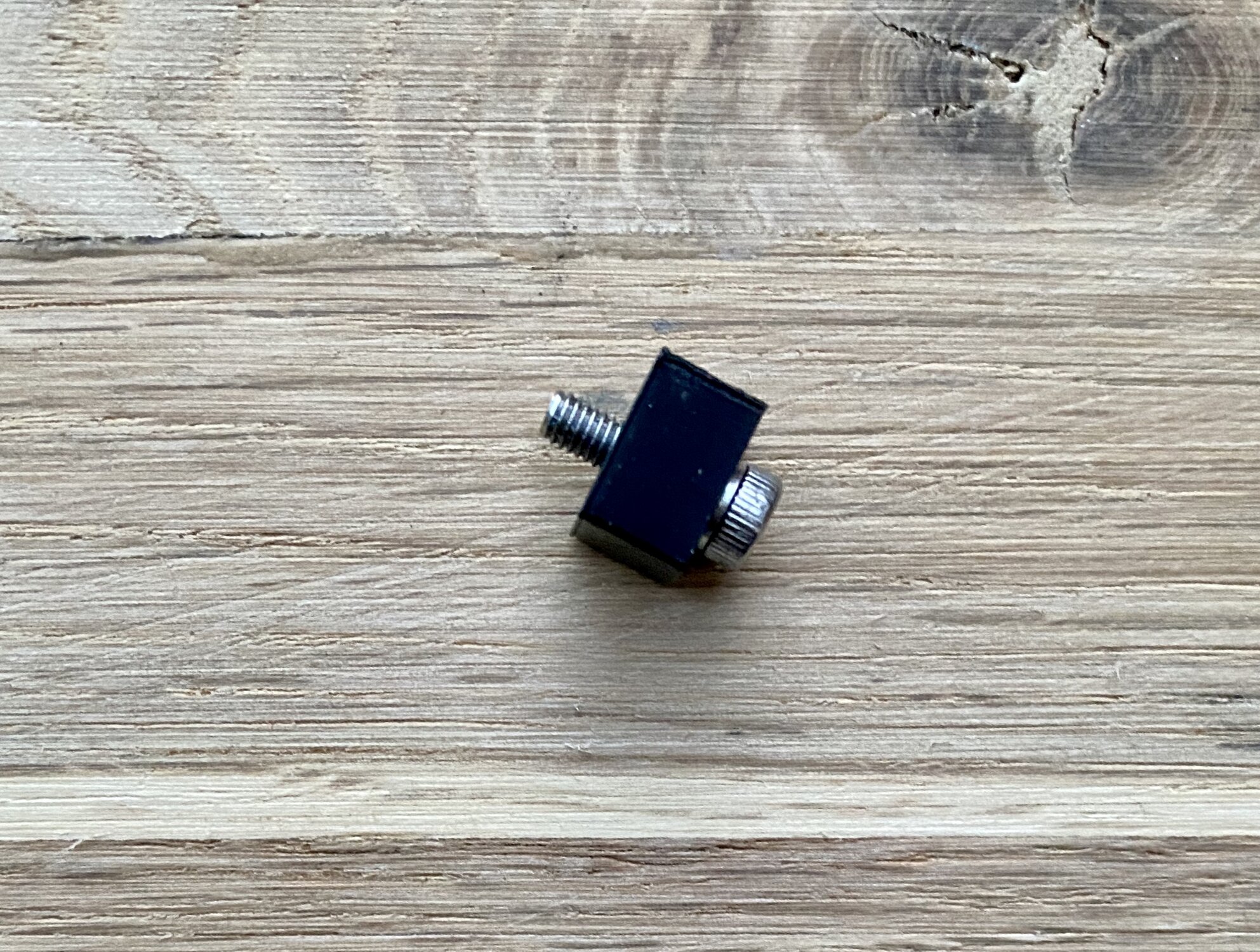

Guys, those that have done it, is it just a bit of rubber, with a hole in it, then drill a hole in the stand and fit the rubber with a self tapping screw? Is it as simple as that? I guess you need to line the rubber up to ensure it slots in the right place when closed to ensure no rattle?
Yes, it can be is a simple as that ... In my case I tapped it first and then used a normal M3 screw and just for fun I 3D-printed (TPU) the rubber cube :) but for sure you can just cut a piece of rubber and trim it to your satisfaction.. mine is 5mm thick, I felt that at this distance the kickstand spring tension is optimal ..but it is just my feeling
I just used superglue on a piece of rubber. The job took 60 seconds snd many weeks later it still works.

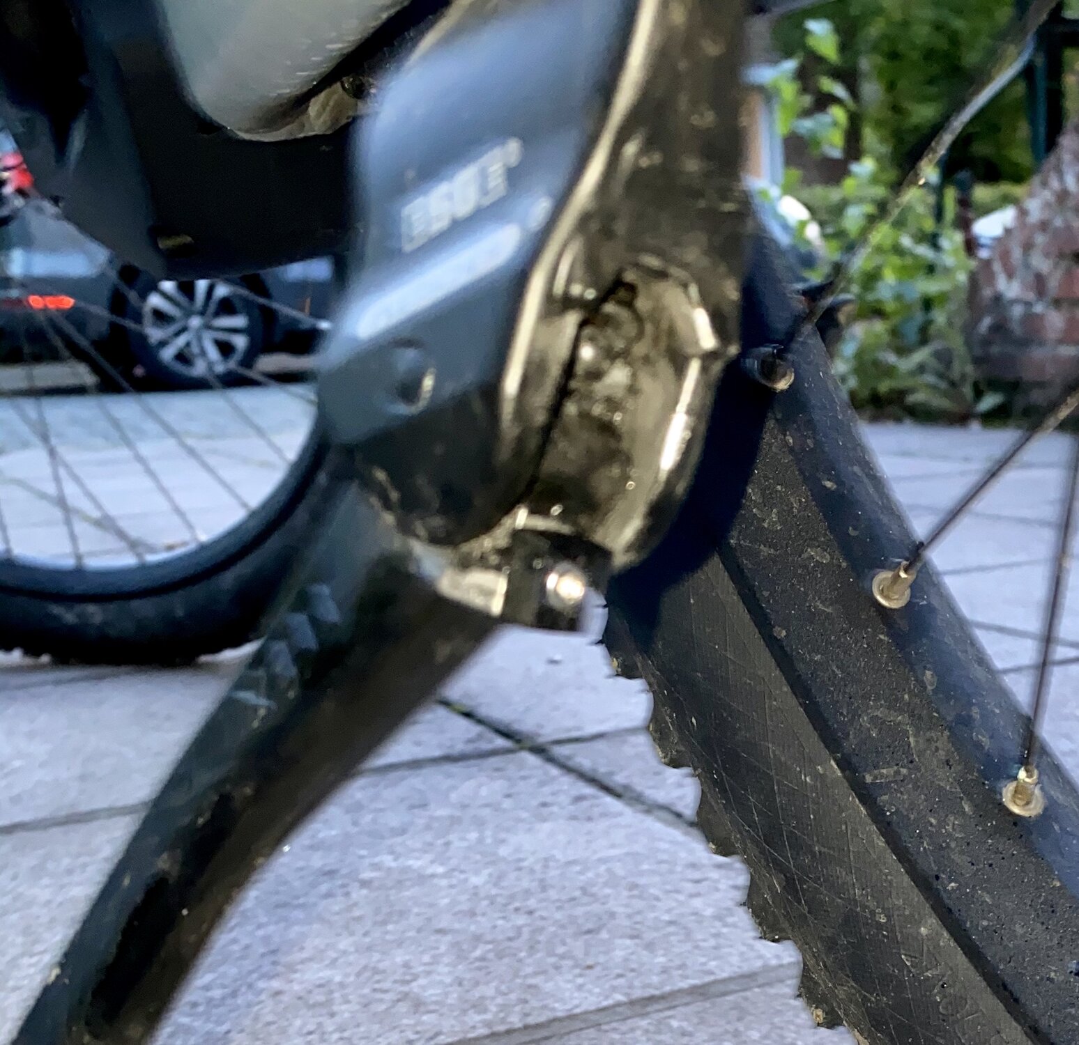

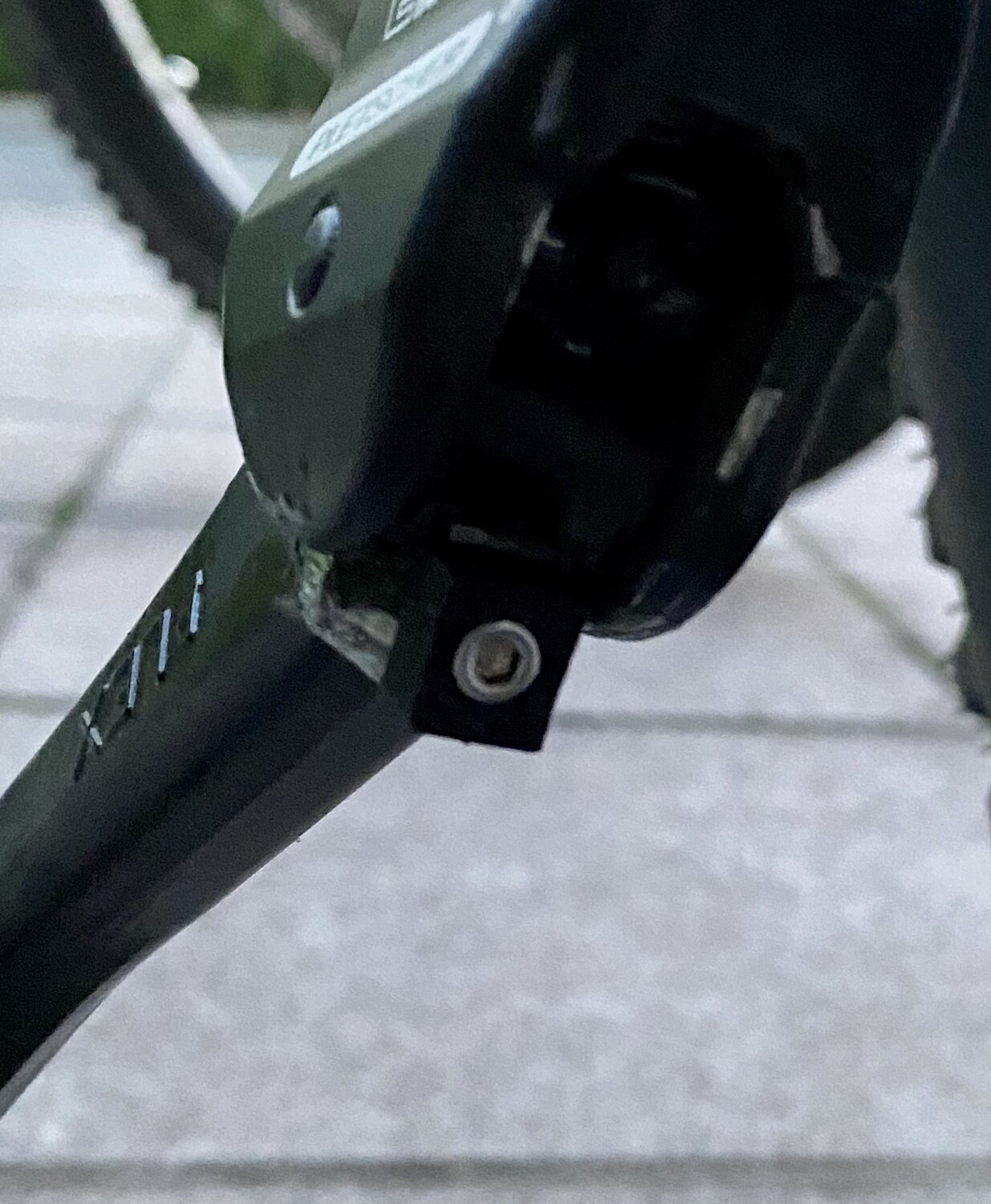

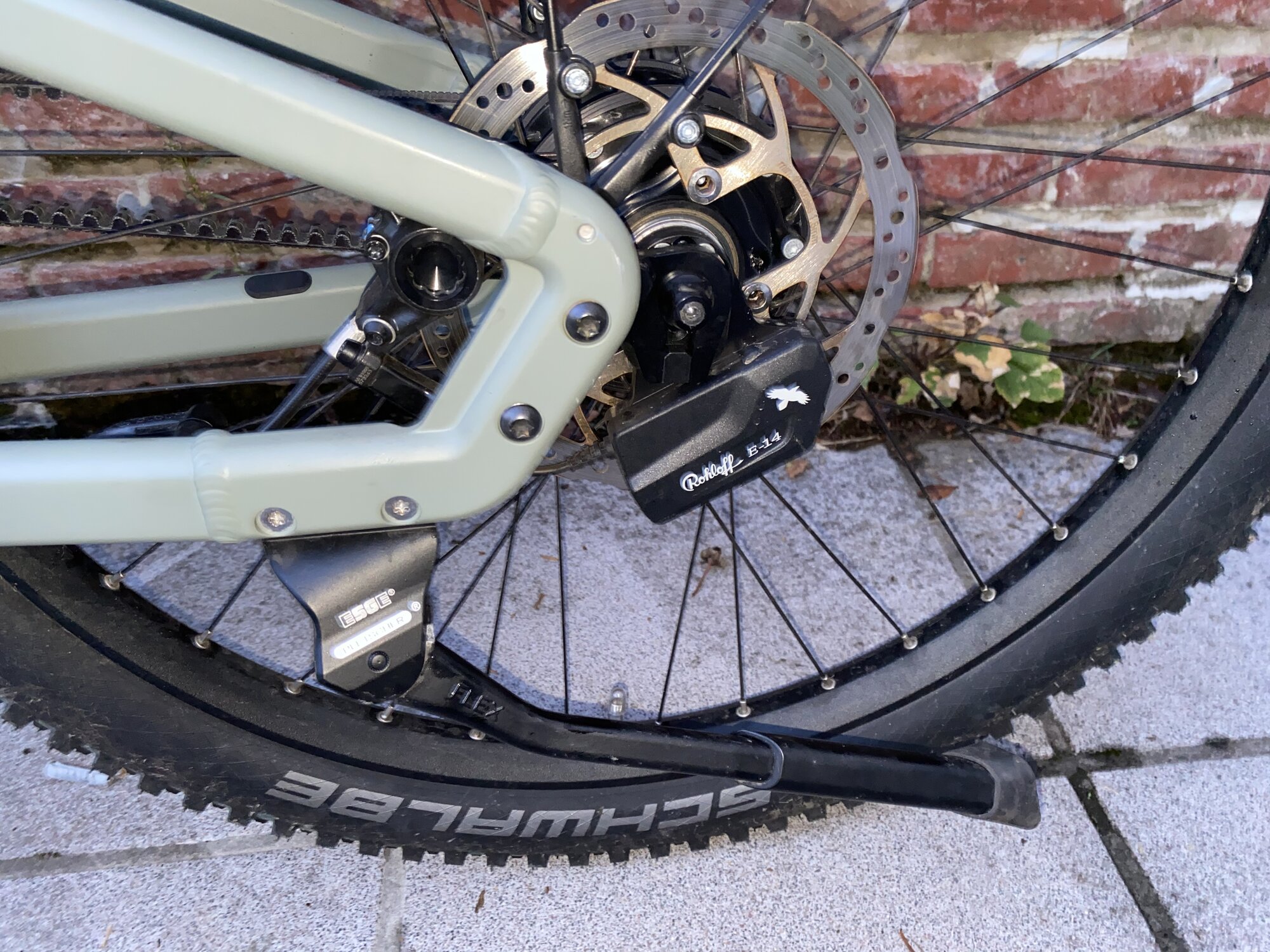

Thanks guys, I have a rattle over really tough surfaces, but, when I take a look at the stand, it sits very tight to the frame when in the up position and I find it hard to believe it could be the issue. I assumed my rattle was the rear mud guard. I guess if I do this simple fix I will know what it is afterwards. Thanks........
@marcparnes Many thanks for the photos and feedback, I just did the same and it works !! No rattle sounds anymore !! kickstand stays a bit low but I dont think it will be an issue ..
View attachment 67385View attachment 67386View attachment 67387View attachment 67388View attachment 67389
To me that looks to be too thick on the rubber, It does not need to be so thick. It leaves the kickstand at a noticeably lower angle rather than perpendicular. I think @marcparnes got it right with the piece of vaccum belt, not too thick and very durable.
