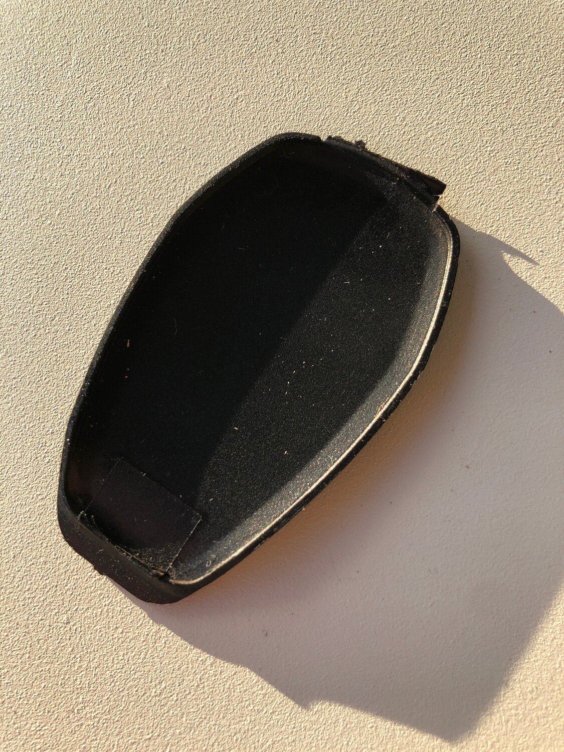

Has anyone had an issue with the Superdelite plug cover? Mine just fell off while I was riding. The bike is only a month old.
The plastic is brittle and only a fraction of a millimetre thick at the hinge. It really is a terrible quality component. It also plays an important role, keeping water out of the electrics.
I presume they will repace it for free. But the next one is likely to fail.View attachment 62912
My cover fell off after 3 weeks (it didn't close properly from the start), I'm quite shocked of the poor quality of this. Can anyone tell me if it's now safe to ride the bike with the charging terminal exposed to the elements. Luckily I managed to find the cover and I'm holding it on with tape as a makeshift solution.

The design defect with the charging cover is that if you do not close it or it springs open it will make contact with the pedal and the pedal will snap it off.
