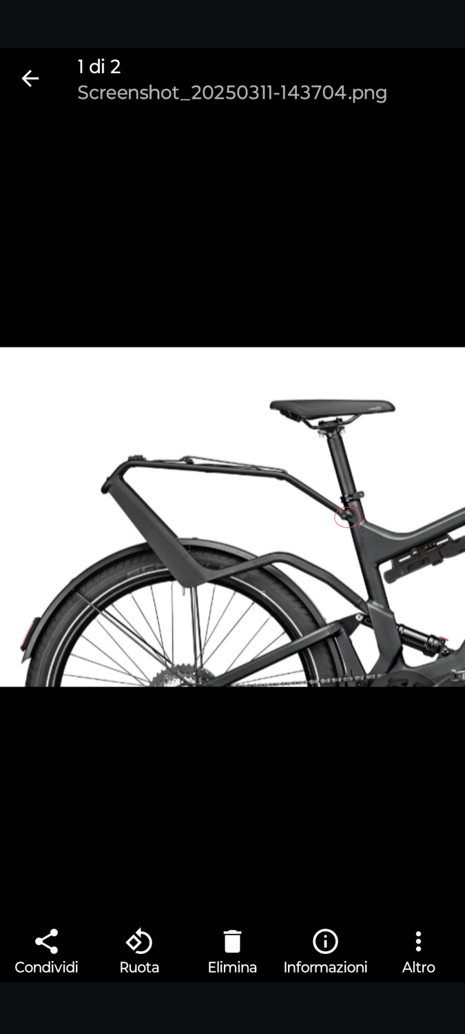

Hello, I have a delite4 GT Rohloff
Is the rear rack noisy?
On rough terrain, mine makes a bit of noise.
The Superdelite should have the same issue.

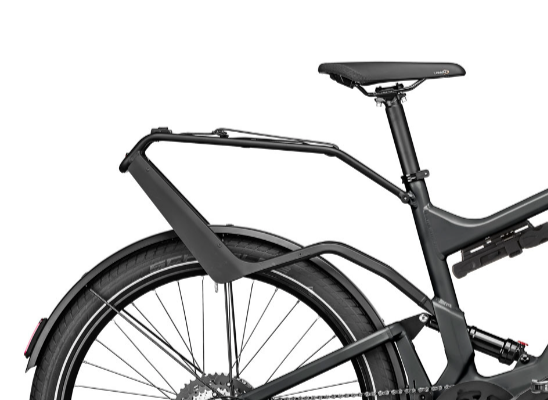

Hi,
I can’t see the video, but I had a similar issue to the one you described.
I have a Delite with a suspended rear rack, the same one the Superdelite has.
In my case, the noise was coming from the mounting point where the rack attaches to the frame, just below the saddle. I removed the through bolt and applied some grease to the two contact points between the frame and the rack, the noise disappeared.
I’m attaching a photo of the exact spot.
The Superdelite should have the same issue.View attachment 190497
it could be the fender. there are some guys that have posted about this few pages back. Mine has the same slight rattle in the rear fender(and kickstand), just haven't had a chance to work on em.
