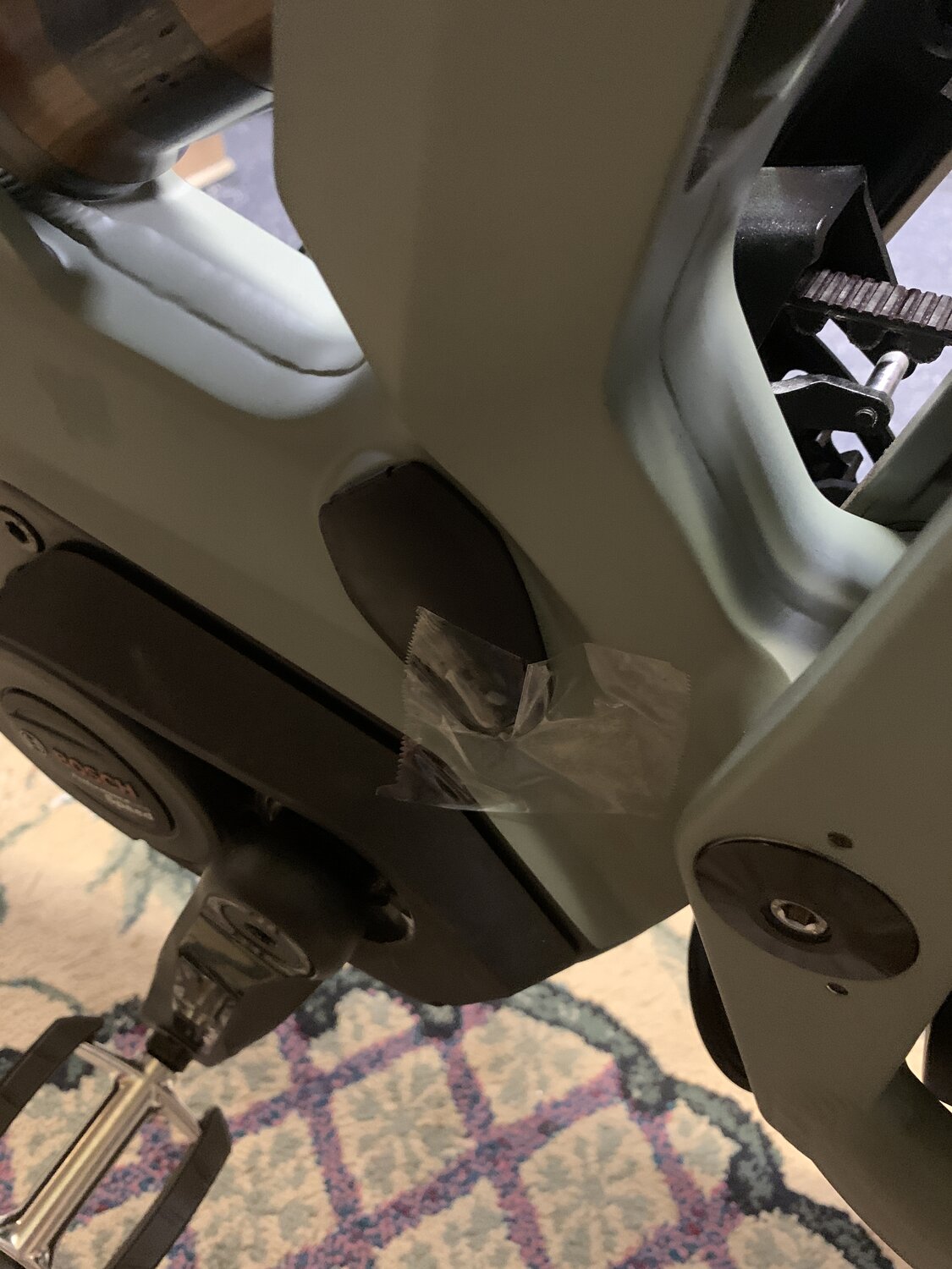

Hi everyone - I got my 2021 SD in 51 cm with Rohloff and Nyon display all together and finally had the weather to ride. Amazing bike. I have a new serial 1 also with the Enviolo AutomatiQ and there is no comparison - they are both wonderful but I love the Rohloff!
One seriously annoying problem - the SD charging port cover simply will NOT latch 🤷‍♂️.
Certainly other Super Delight owners have encountered and solved this issue without resorting to tape??

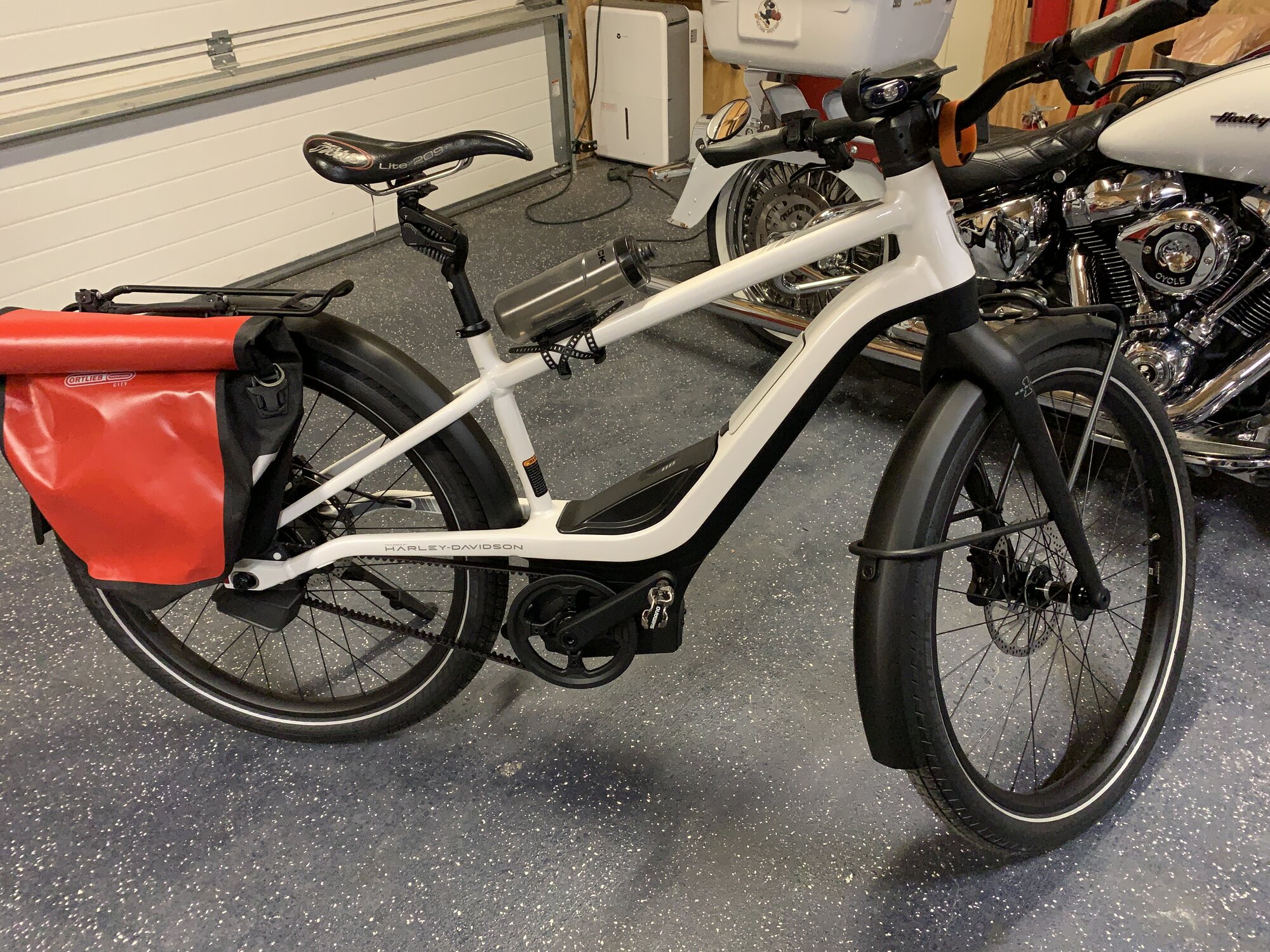

Rudy, what is a 'serial 1 with enviolo AutomatiQ'?
David
Hi David,
Harley Davidson started developing an Ebike several years back as a way to initiate younger riders into the Harley Davidson fold = future customers. In 2019/2020, they split their electric division away from their original "gas powered" behemoth, essentially creating two companies from one.
The Serial 1 Ebike is a well designed and finely made, E-bike with a price point from $3800. single speed, to aprox $5400. for a class 3 pedalec. They are all belt driven and all use Brose Mag S motors. My top end model uses the Speed version and comes with an Enviolo AutomatiQ internal hub; quite amazing when you figure out how to set it for "your" style of riding; you set it and forget it. Serial 1's have elegant internal wire routing with beautiful built in tail and headset lighting. The Kinetik seat post shown in my picture, is my "add on" and it is quite nice for the butt, however, the head set is quite proprietary so i can't adapt a Kinetik Stem to it.
Sadly, motorcycle manufacturing people don't think about hydration outside of the bar, and so they incorporated zero water bottle bosses. The rear rack is Pannier ready and accepts the MIK adapter "add on". The front rack...not so much. Clever ideas for water bottle attachment would be appreciated in the Serial 1 forum here on EBR.

The lid catch is right on the very tip of the cover, mine snaps firmly. You may need a new one, my LBS wouldnt sell me one, ie likely free if you ask

I got my SD a couple days ago, and broke the charging port cover on the first ride as it opened and caught on my trousers. :)
Ordered this aftermarket replacement from an ebike shop who looks like realised an opportunity there and designed & made their own:
Hope this helps :)

It's a known issue with the lower Bosch charging port. I use black gaffer tape to secure during rides.
Hope this helps :)
It does, many thanks. 👍

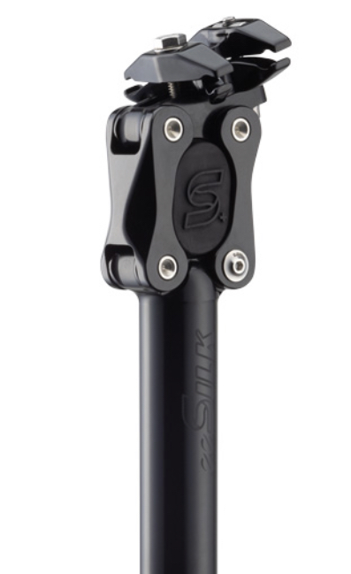

The only real issue I’ve had with the Nevo3 GT Vario GX, apart from self-inflicted ones, is the Cane Creak Thudbuster ST seat post. Just could not get it tight enough to hold the saddle in position.
The nose of the saddle kept tipping up and became uncomfortable. No amount of tightening up or replacement bolts could hold in in position.
The only permanent solution I found was to change the seat post to a Cane Creak eeSilk+, which has a different saddle clamping system. This time, vertical, rather than horizontal on the Thudbuster.
DG…
