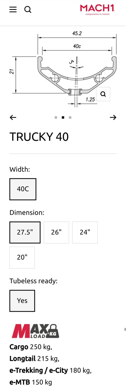

Input your measurements then play with the rim spoke hole offset. Moving it 1 mm only changes the spoke length a couple tenths. That would represent your bend conundrum.View attachment 211626

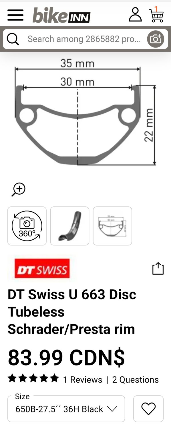

You had good luck with Bikeinn? They have a killer deal on some tires, thinking about ordering some.I'm thinking of getting this rim,..
It comes to $105 with the shipping.
DT Swiss U 663 Disc Tubeless Schrader/Presta rim, Silver | Bikeinn
Get DT Swiss U 663 Disc Tubeless Schrader/Presta in Silver for 54.99 CDN$. Ideal for bike with fast delivery. Buy Rims and spokes at Bikeinn!www.tradeinn.com

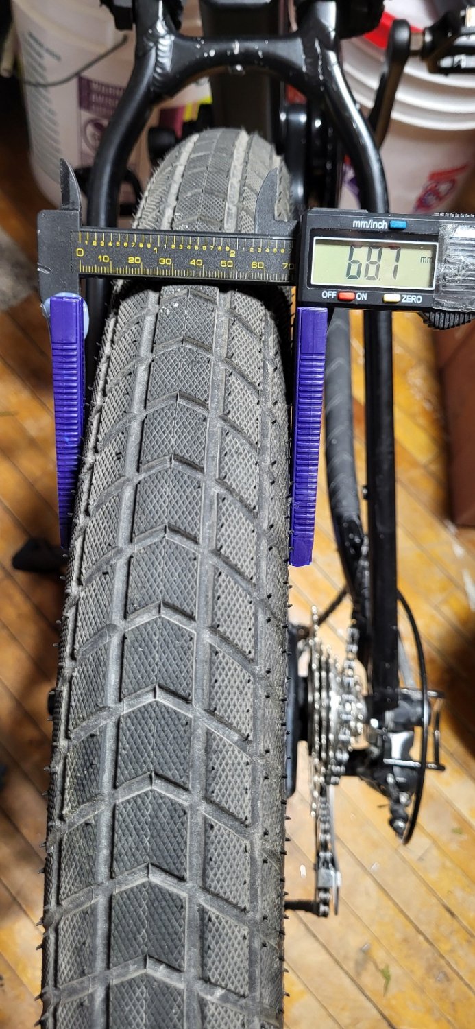

I want to get the 27.5" version because I've got 3 new 27.5" x 2.8" Super Moto-X tires and want to be able to use them.
This particular Canadian store doesn't offer the 29" version that you would probably want to get the longest spokes possible.

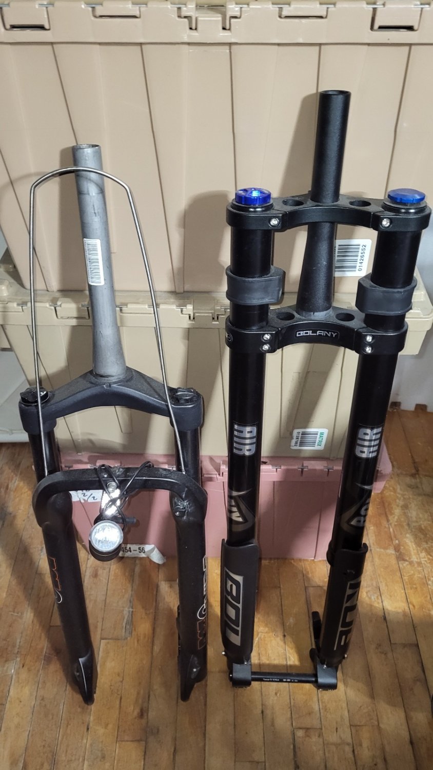

When I bought my second ebike (a Voltbike Outback with Fatbike dropouts and a hub motor), I ordered a new set of double shoulder inverted air forks, a 29" wheel, and a 29" x 2" Shwalbe Hurricane tire.
(The Outback came with RST Guide Fat Forks with those stupid QR axles)
Unfortunately, the steerer tube was too short to fit my Outback,..
So,.. I ended up buying Suntour downhill air forks, and a new 27.5" wheel for it (that had Boost Spacing instead of Fatbike spacing) to mount my Super Moto-X tires.

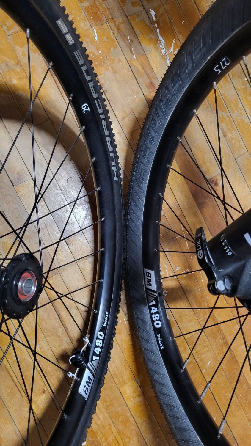

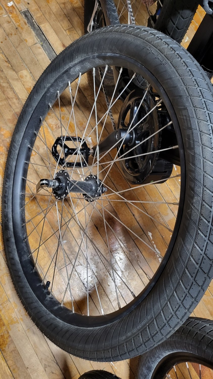

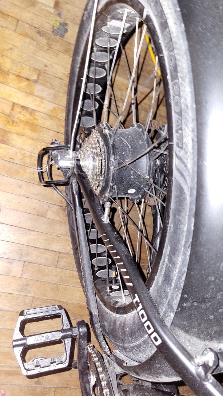

This is my original Fat Outback rim with a 27.5" Super Moto-X tire.
View attachment 211232View attachment 211231

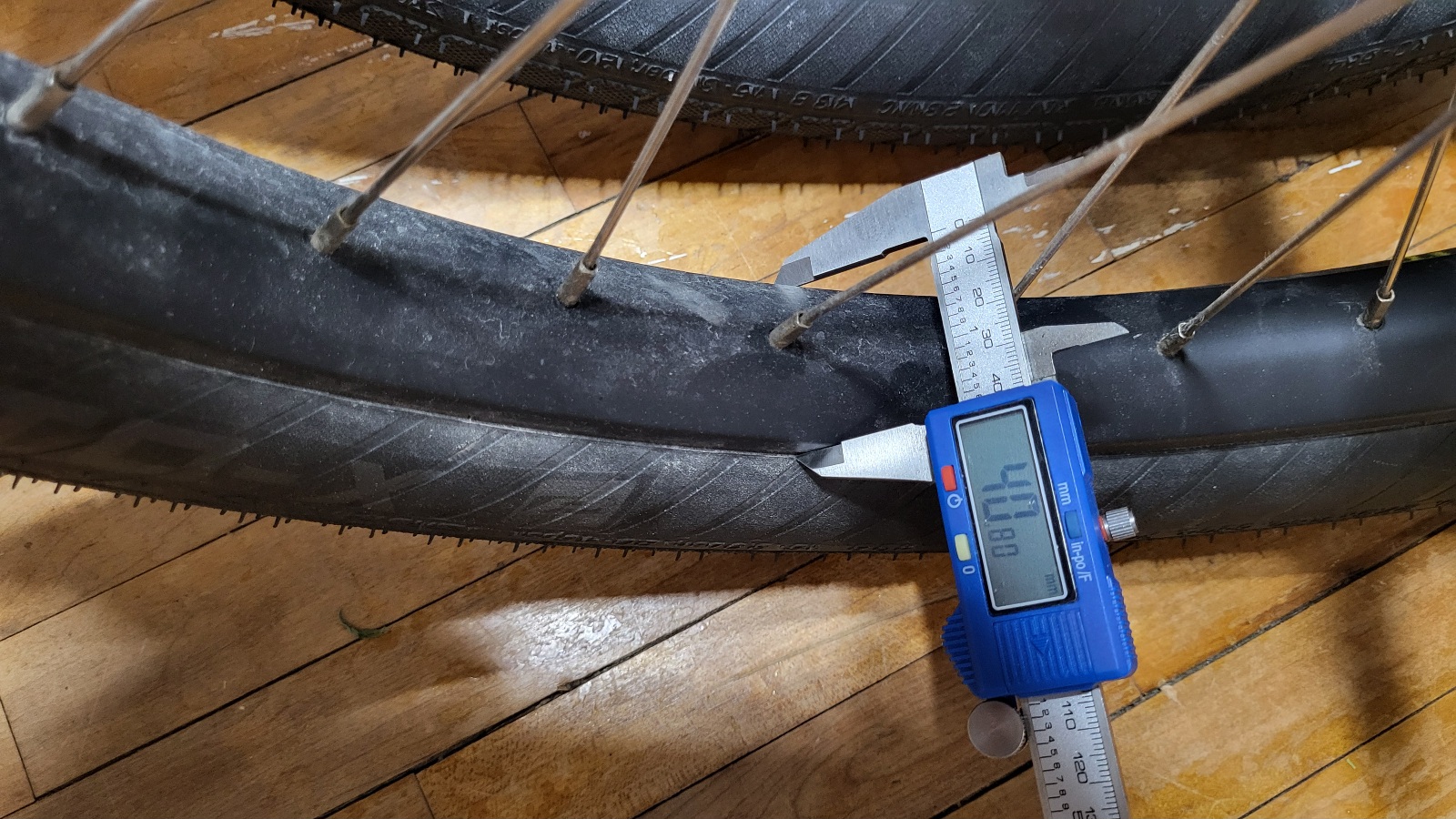

The rim has 40mm bead to bead spacing, and fatbike dropout spacing.

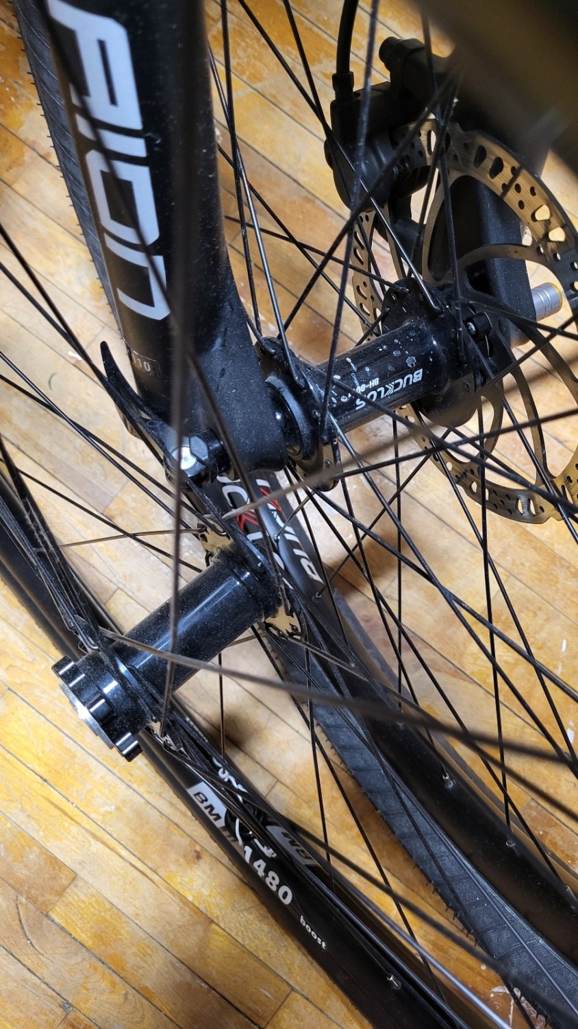

This is the new 27.5" wheel with a Super Moto-X tire currently on my Suntour forks, along with my new 29" wheel with the Hurricane tire on it,..
View attachment 211233View attachment 211234

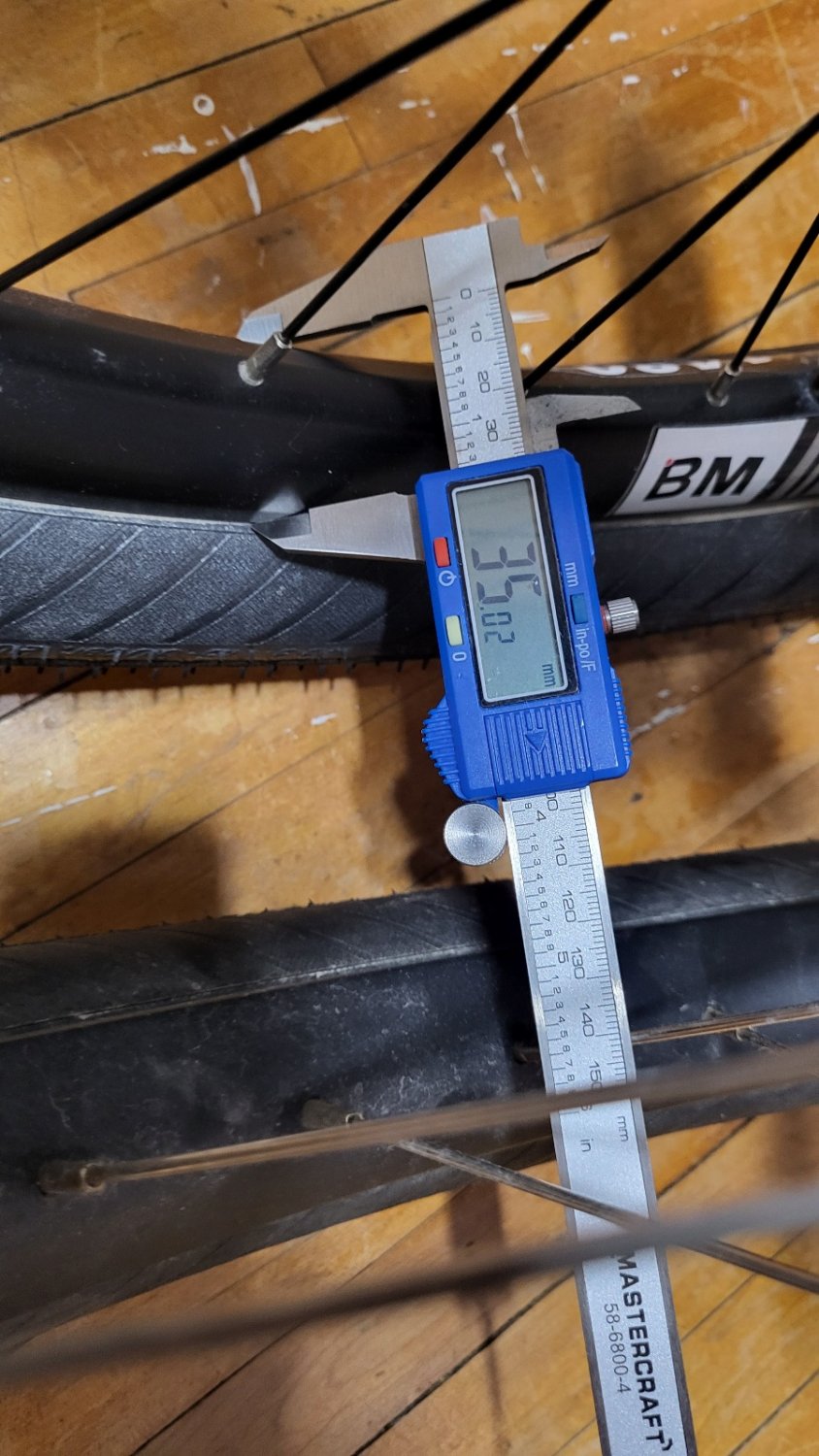

So I've already got a 27.5" x 2.8" tire mounted to a skinnier 35mm rim, which I just kinda realized (or remembered??)
So I think I might get the DT Swiss rim and try and string it into my original ebikes Fat Motor.
Apparently, it's an unbranded MXUS motor that I has identical specs and measurements as a Bafang?
I don't use that ebike anymore, but I like the motor better.
Its actually a 750 Watt motor that was detuned (programmed) to 500 Watts.
And my Bafang motor has either a bent axle or a crooked bearing or something, because the freewheel wobbles as the wheel spins.
That's almost as annoying as bent spokes, but it looks like I might have to live with bent spokes if I want a 27.5" rim on a fat motor ?

I gave up on that project but here is something interesting. Made in taiwan which I think is better than China and drilled for the 12 ga nipples. 30 mm id rim. Has the right profile for strength.Well,.. I found a 27.5" DT Swiss U 663 rim with 36 holes.
I didn't actually order anything and I'm not sure what size it's drilled to?
It might be a special order, so they might be able to drill it to 12 gauge with either a Presta or Schrader (or maybe a spacer for the presta?)
Or you could string it with those 13 gauge nipples with the tapered 12 gauge spoke ends?
I didn't actually email them with any questions.
But the good news is that my current front wheel has the same rim spacing as the DT Swiss U 663.
I've got a big fat 27.5" X 2.8" tire mounted to it, but the wheel feels fine (it is kinda donut shaped though.)
So I think that you'd be fine with the 27.5" X. 2.3" (I think it was?) that you would want to mount to it.

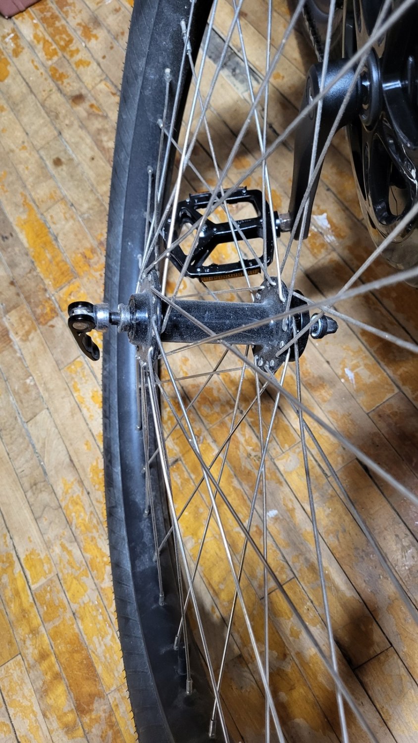

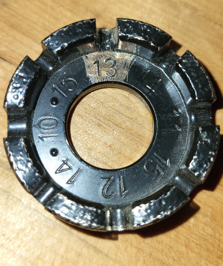

I "measured" my spoke nipples with my spoke wrench,..
My front wheel has 13 gauge nipples. 14 wouldn't fit, and 12 was too loose.
So I guess that I'd need to measure my spoke diameter to find out if the nipples are drilled and tapped for 13 or 14 gauge spokes?
(if that is how it works?)

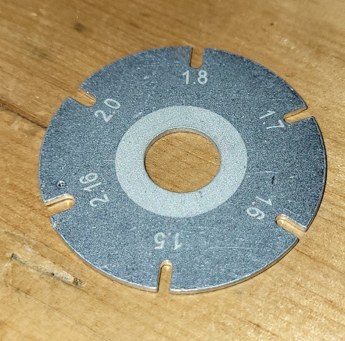

I've got this spoke measuring tool as well,..
It looks like it's mm instead of the gauge measurements??
(The "gauge" system is stupid anyway. A fatter spoke should be a larger gauge number. Wire gauge is just as stupid. A Big Fat wire is "0" gauge. What would an even fatter wire measure? Does it go into negatives or fractions after Zero Gauge?)
