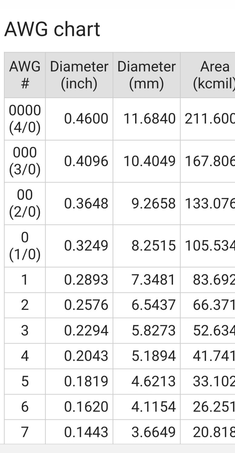

0, 00, 000 are the wire gauge increments, that last one is sometimes called a fatty.
Well that makes sense. 🤔
What's bigger than nothing? Two nothings.
Three nothings is even bigger !!😁
I wonder what gauge this wire would be?? 🤔
That's A Lot of nothing.
Maybe even too much nothing to measure ?? 😁

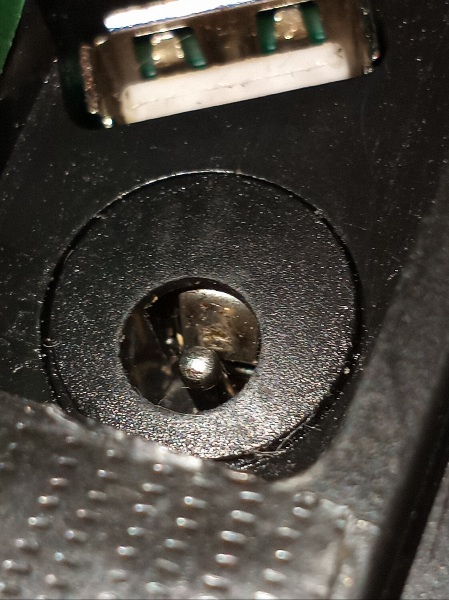

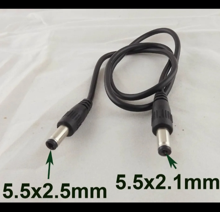

I wanted to put a new barrel plug on battery charger because the connector was getting sloppy, but I couldn't figure out what size pin was on my battery's charge port,..
I ended up buying this adapter to use the end that fit,..
Both ends of adapter cord worked??
I just used the end that felt tighter.
I sure couldn't tell for lookin. 😁
00 is pronounced double aught and 000 is triple aught.
I found out that there's 0000 available as well,..
I think that I'll buy me some me some quad aught wire for my ebike? 😁

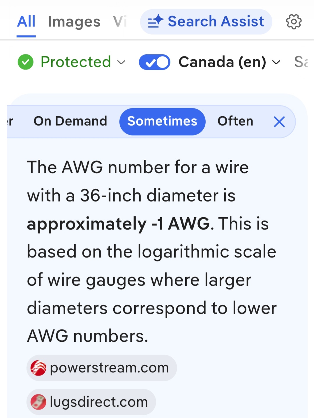

AI search says that the 36" Golden Gate Bridge cables would have a AWG number of about -1
Choosing a logarithmic scale to measure wire diameter is stupid.
If they simply counted up as the wire got thicker, it would be a linear scale that counts in a straight line.
I'm just used to it, but still irritates me. 😁

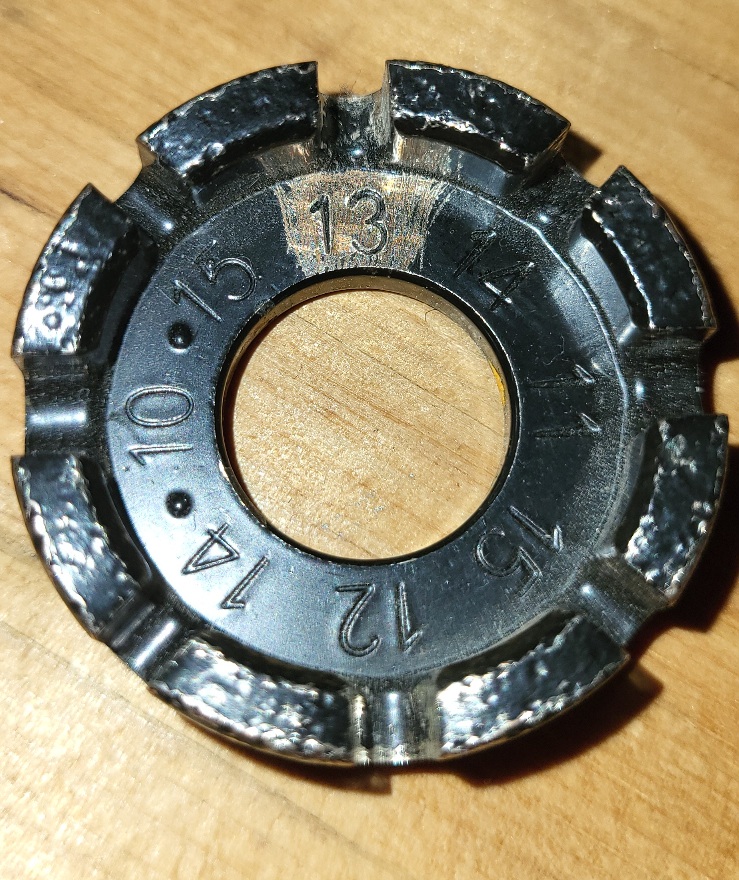

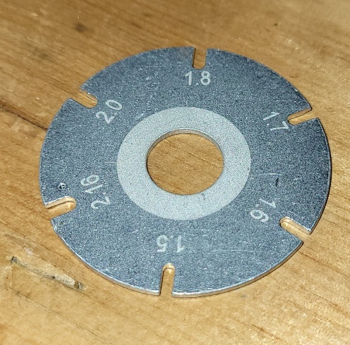

I "measured" my spoke nipples with my spoke wrench,..
My front wheel has 13 gauge nipples. 14 wouldn't fit, and 12 was too loose.
So I guess that I'd need to measure my spoke diameter to find out if the nipples are drilled and tapped for 13 or 14 gauge spokes?
(if that is how it works?)
I've got this spoke measuring tool as well,..
View attachment 212174numeral
It looks like it's mm instead of the gauge measurements??

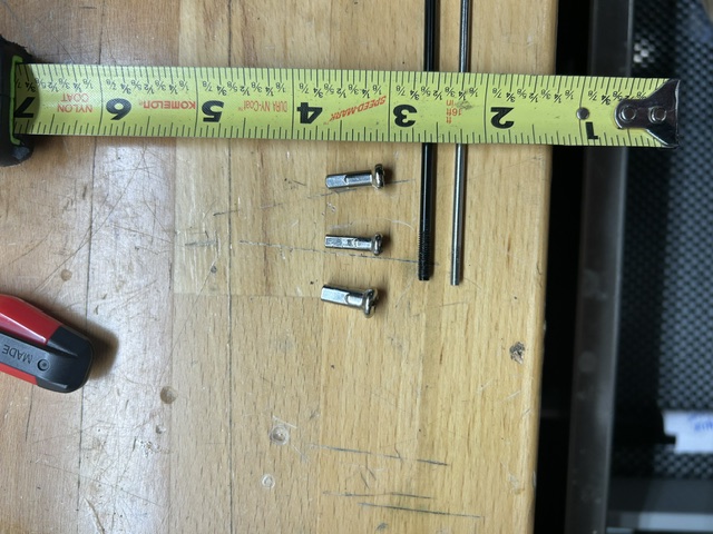

Got the micrometer out and measured the spokes on the 140 and 170# Wired ebikes with the Hentach 2000w motor the rear spokes are 10 ga. The front spokes on the drive 1500w motor and nondrive hub are 12 ga. Surprise!
Buchanans website shows 10 to 12 ga nipples have same outside diameter of .236.

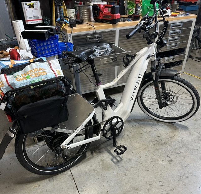

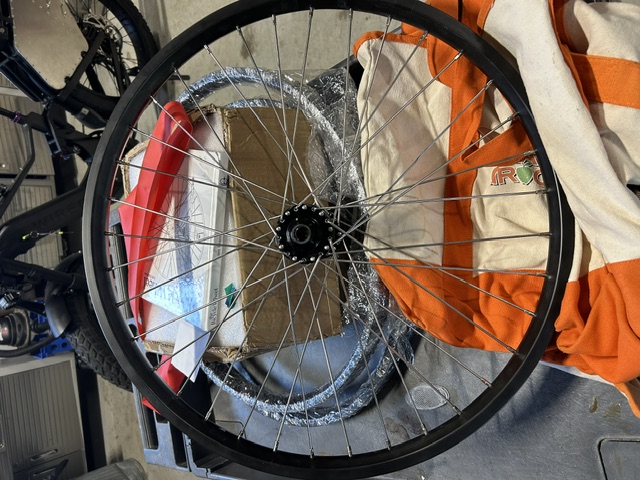

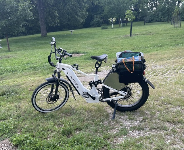

So I took apart the 26 x 4 fatbike front tire. Has the regular hub, no electric. Was hoping the spokes and such could be used on the Husky 26" rim. Calculation says the spokes need 4mm more length. So close. Surprise, Husky has the spokes, 258mm in stock with nipples for $50, so order on the way, and that is for 75 spokes.
Those Husky rims are nice. That would be the option if someone wanted to change from the fatbike 26 x 4 to another 26 with slimmer tires, the inner dia of the Husky is 31mm. It is a nice strong rim with the inner channel on both sides inside the rim for strength. 12 ga spokes holes verified, and the larger hole inside for the nipple is the same size as on the fatbike rim.
The beat goes on. So excited. Get to lace up a 3 cross.

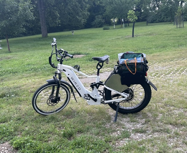

There it is. I got tired of waiting for the schwalbe pick up to show up so went down to wally's place and bought their in stock cruiser special for $20. Not a bad tire really, 40-65 psi recommendation. The white wall is a nice touch:). The fender may look a little funky, that is as low as it will go.
The handling is much improved, much. The shocks work as it should, better than I thought it would. I could not get the front fork to wobble. With the 4" tire it was very easy and dangerous really for someone without experience, as it is something that could get out of control. The steering is quicker also, or lighter. I believe the miles per kilowatt should improve also.
Getting ready to do the back tire.

Mine are the RSTs. Work pretty good really from the short run i made with the smaller tire. There is movement fore and aft without compression over some of the terrain so I wouldn't call them top notch stuff.
The 4" rim I took off was pretty stout. It has three ribs inside the double wall, so four spaces. Makes for a pretty stout rim.

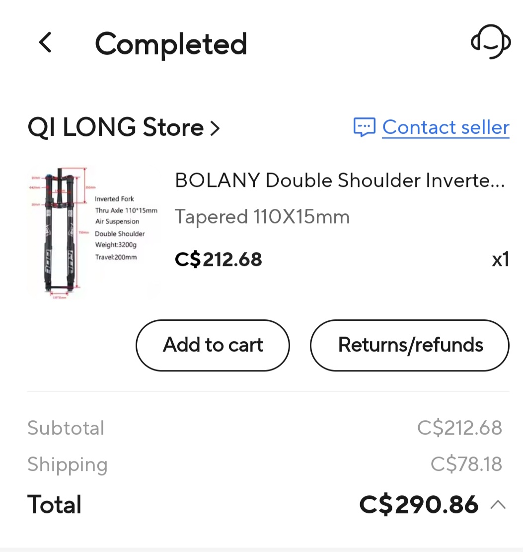

I originally bought double shoulder inverted air forks for it, but I ordered them before my new ebike arrived, and the steerer tube turned out to be too short,..
Then I found out that the "no-name" forks didn't stand up to bad weather and were prone to failure.
It was recommended to buy Suntour forks.
I was considering buying Surron double shoulder forks, (also recommended. Bee, I think they were called?) but I ended up buying the Suntour AION downhill forks.
I'm pretty sure that double shoulder forks are A Lot less likely to wobble front to back?
(I never did install those BOLANY forks, but they will fit my first ebike.)

This is where it gets weird, or wired.:). The rear wheel uses 10 ga spoke and nipple, the new rims are made for 12 ga. I had thought to drill the rim for the new hardware but looking at the pieces the holes would be pretty big, especially inside to get the nipple head through. The holes in the hub are 3.5mm, which is right for the 10 ga spoke but prob too big for the 12 ga. Buchanans makes a 10 ga swaged to 12 ga spoke at the price of $2.68 ea, times 75 for both bikes equals a $200 bill, and I don't think that includes nipples. Just money right? Husky has the 10 ga spokes at the right length for $.39 ea with nipple, isn't that a kick in the pants?
Decisions, decisions.
Here's the Wired 10 ga nipple on the left, the Wired 12 ga nipple, and then the Richman 12 ga nipple, and the difference between the 10 ga and 12 ga spoke. That's a pretty good jump from 12 ga to 10 ga.
The hub motors have the same dimensions, rear wheel on both bikes and the front on one. So if I could use the 10 ga spokes x 108 from Husky at .39 ea that would be a big savings.
There it is. From 26 x 4 fat tire to 26 x 2.35 rear and 26 x 2.15 front. I was lucky, Huffy had the spokes that worked for $.39 for both spoke and nipple and the rims were $50, all quality taiwan stuff, that spoke price saved a lot of money. The 10 ga spokes on the rear were a little bit of a tussle but worked out in the end, 1 cross, don't know if that was the nature of it or been easier with 2 or 3x but the hub wouldn't allow that anyway. The front uses 12 ga 3x, similar tussle but still worked out in the end.
Rides more like a bike, a heavy bike. I was hoping an improvement on the rear same as the front but have come to the conclusion the rear air shock is just a pos. Really needs separate bump and rebound damping, maybe an upgrade some day. Lowered the bike a little also which makes the ride height friendlier. Had to adjust the kick stand. That's a Schwalbe pick up on the rear, would be nice on the front also but the present make do tire on the front is working fine.
I'll keep the fat tire setup in case this doesn't pan out. For some reason I was using the Huffy name for the parts, it is actually Husky:).
The difference in handling is big, and the amount of electric used per mile is much less, along with the coasting. Those 4" wheels are energy suckers.
Got to lace up a 14 ga spoked rim, it is so much easier than the 12 or 10 ga. In the end though there are a lot of similarities:)
