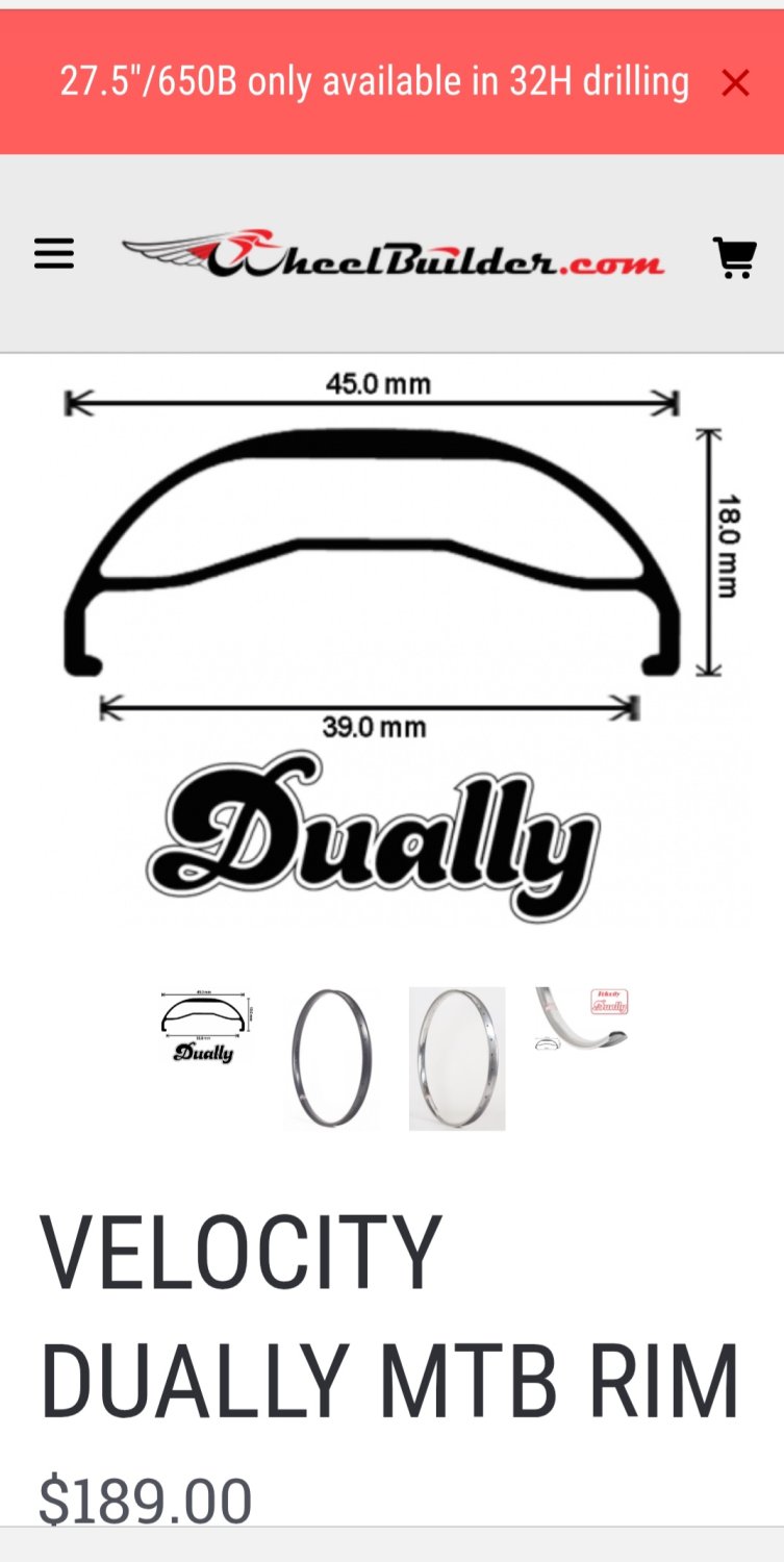

Information about the Velocity Dually:
Also, keep in mind all our rims are drilled for a 14g nipple. We tend to use Sapim E-Strong spokes with the reduction nipples. 12g at the elbow bend and 13g at the nipple end. The reduction nipples have a 13g thread but the OD is the same as a 12g nipple. Also, we recommend getting tension close to 120kgf.

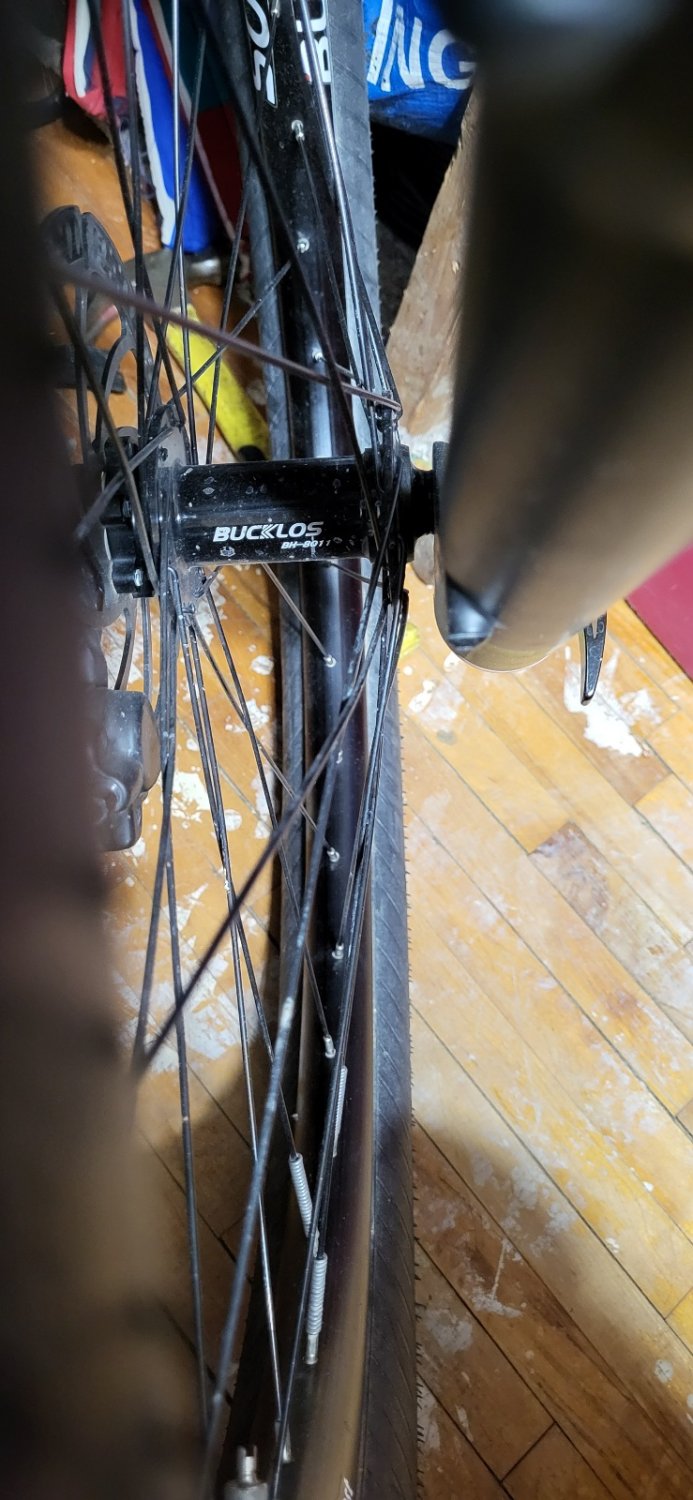

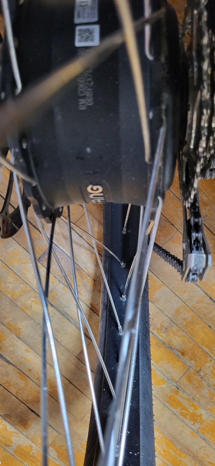

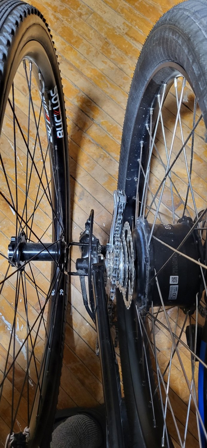

I took another picture of my bendy spokes,..

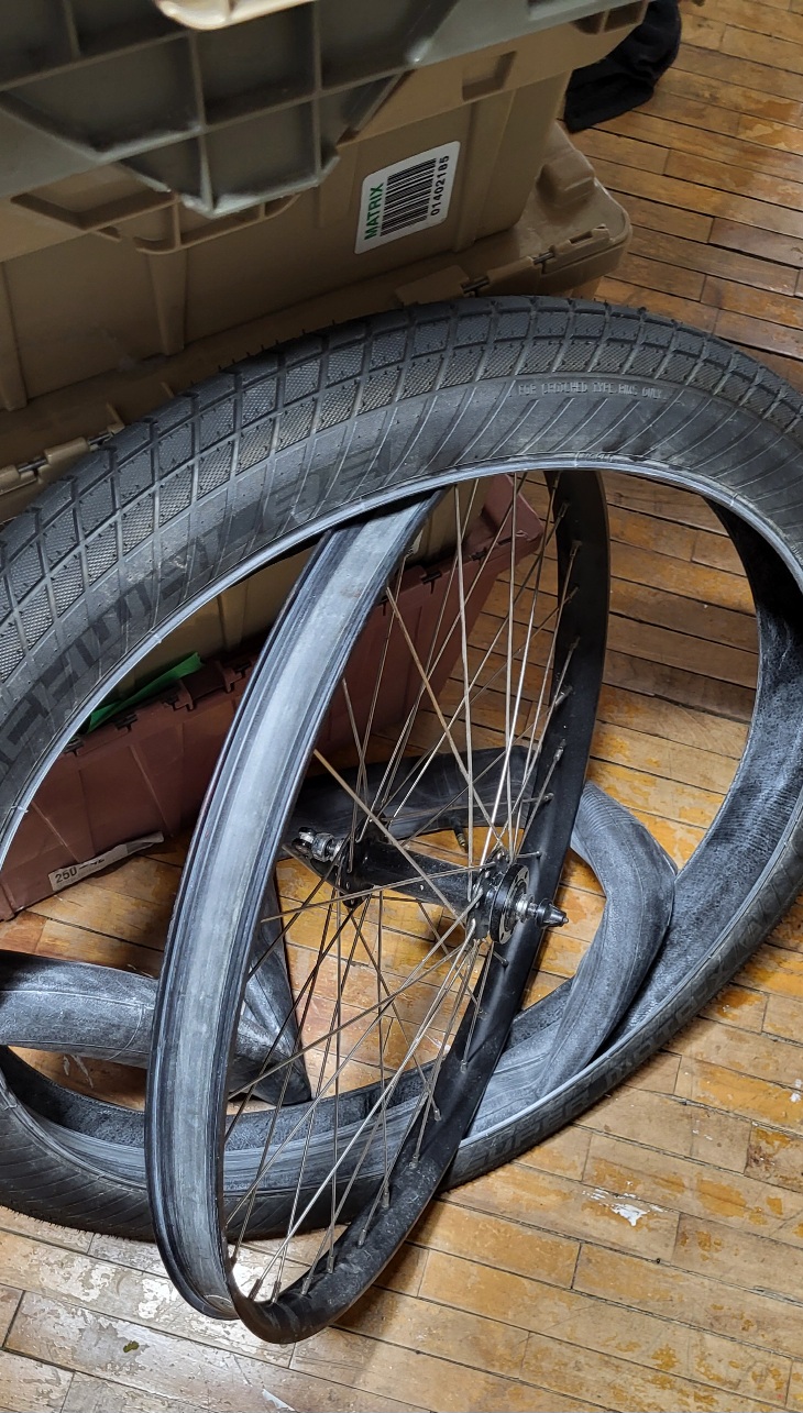

And for reference, I used a "regular" MTB wheel to mount my 27.5" x 2.8" Super Moto-X tire.
It's on the front of my 100# ebike now.
It's been fine for thousands of km.

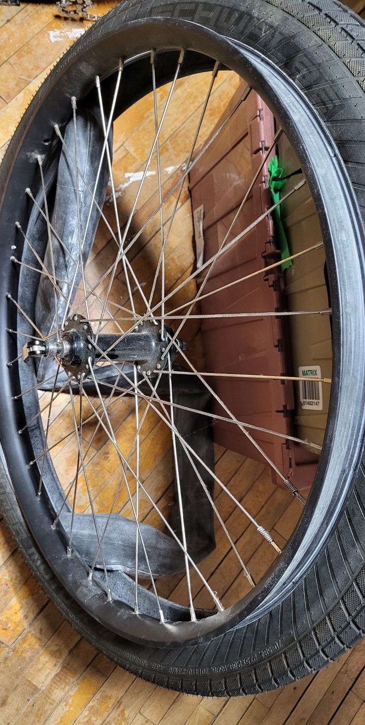

And this is my 29" wheel beside my wider (externally) original rim,..

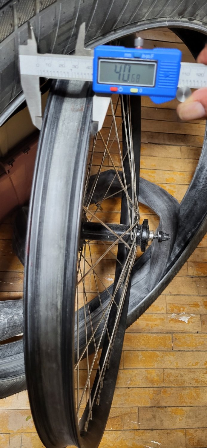

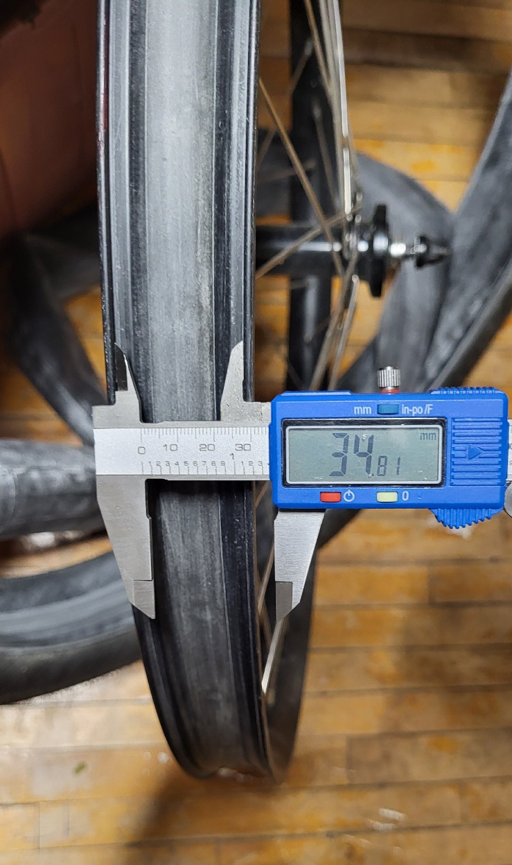

I'm gunna remove my tire from my wider original rim and check the internal diameter to compare with the DT Swiss

The spokes on my wired ebikes are atrocious. You should see the bends in them. Even the spokes on my 600# yamaha motorcycle cross and touch, and bend. While tensioning spokes, tightening one pushes the other out.
That is Velocity who I emailed about their rim with the questions.
The Velocity website linked me to Canadian distributors, then I could only find the 27.5" rim with 32 holes again.
I purchased the rims through pro wheel builder.
I guess I need to find a Canadian wheel builder or supplier of Velocity 27.5" 36 hole rims.

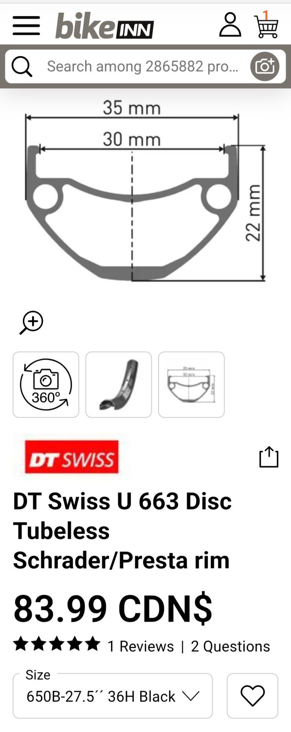

I'd like the wider interal diameter with my "donut" tires, but I think you'd be fine with the DT Swiss with its 30mm internal diameter (if it's cheaper for you than Velocity?) with the Schwalbe Pickup 27.5" x 2.3" mounted on it?
It wouldn't be as ballooned as my tire, and it wouldn't be as tall, which is what you want anyway.
Not available in 36 hole drilling,..
I'd have order directly from Velocity at $400 CAD
Ain't worth it.
I'm going with DT Swiss for $84 CAD if I do it.
I can have it drilled for a Schrader valve, and maybe 12 guage too?

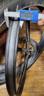

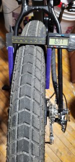

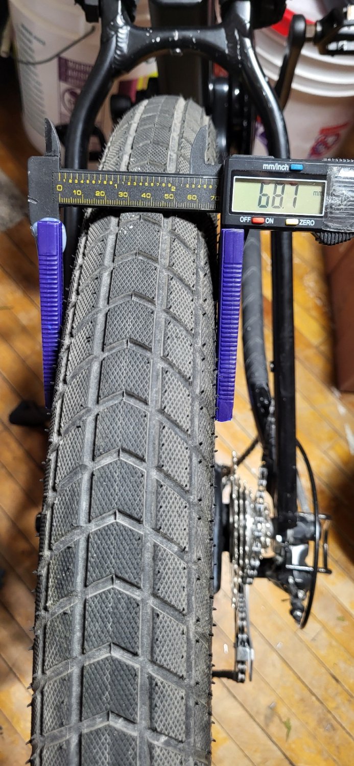

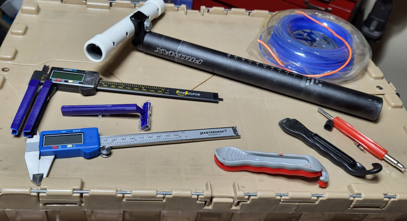

I made a long jaw caliper and a seatpost T-stand,..

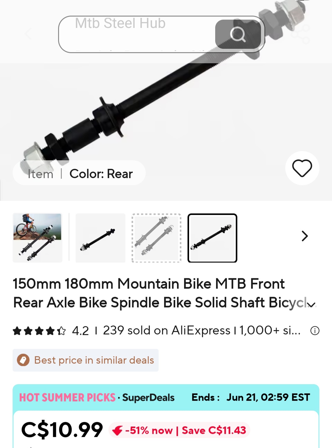

I bought a new solid axle assembly for a front wheel that was the right length for my Fat Fork spacing but never installed it,..
This is just FK-in Stupid,..
The axle has old-school steel frame spacing.
The steel axle chews into the aluminum dropouts and then your wheel drops out.
Doing exactly what they are supposed to do I guess 🤷🙃
