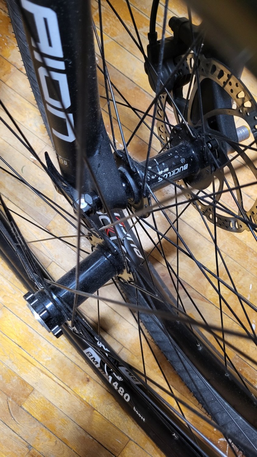

Is it possble to covert 26x4 to 3 onch tire and rim combo
Where did you shop your rims?
I fell into a rabbit hole on Aliexpress and spent half a day searching for rims.

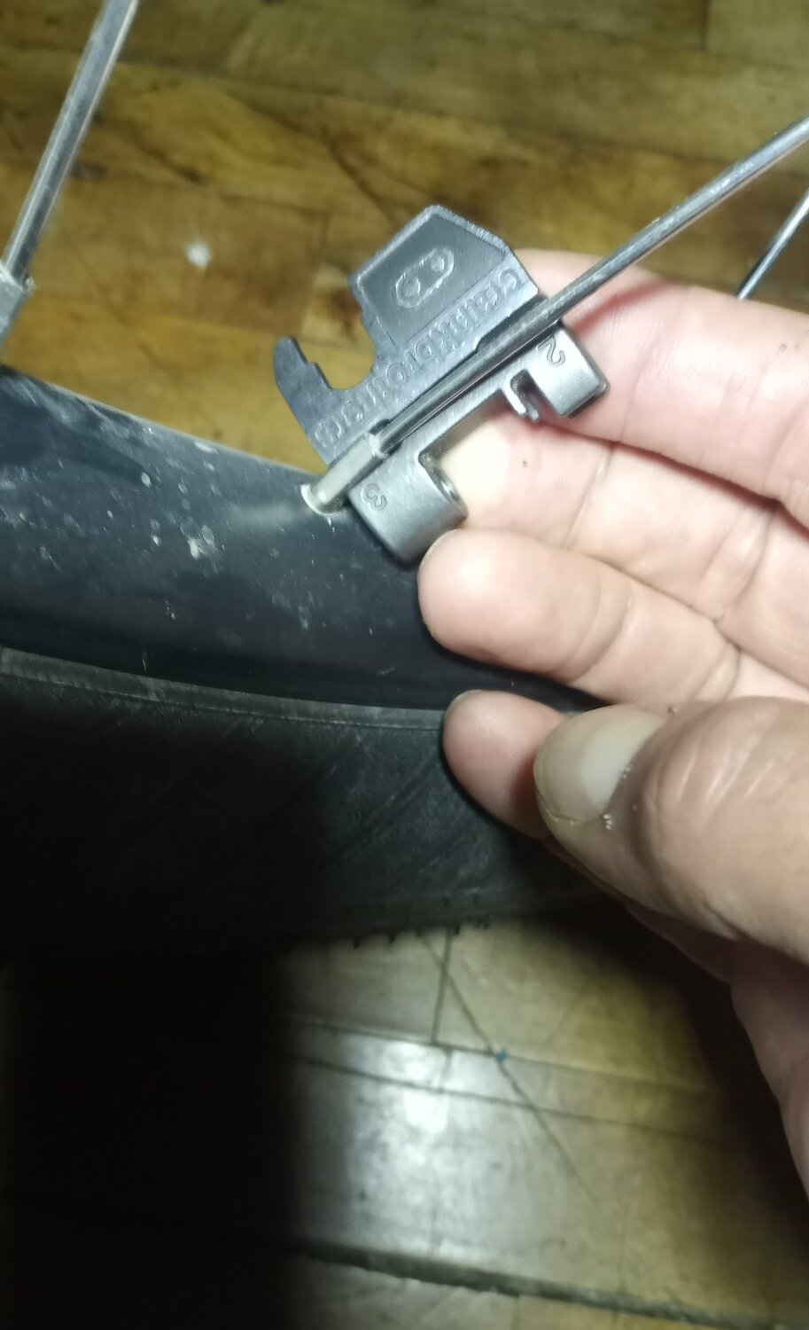

My rims aren't labeled so I had to do manual measurements.
I did find what appears to be an exact replacement for my rim, but I don't think that much at all in a 29" rim?
I didn't think to shop at the DT Swiss website.
Much better rabbit hole to fall into. 😁

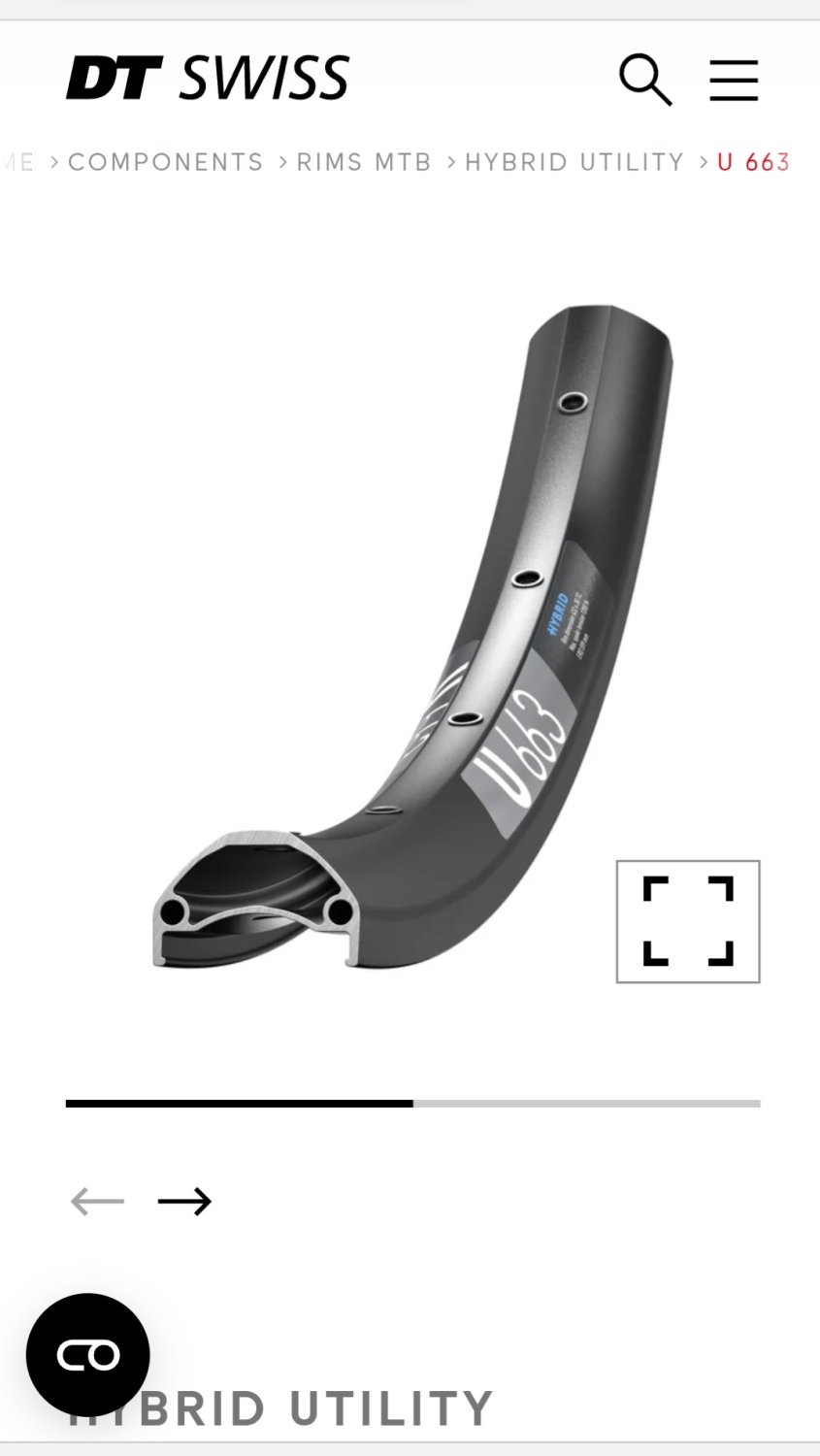

This rim is pretty close to what I have but it's about 5 mm narrower bead to bead.
The rim might still work, but maybe not with a 2.8" tire like mine?
The rim is double walled, so your spoke length doesn't have to be Dead On.
There's plenty of room to have the spoke go through the nipple without poking your tube.
And it's tubeless ready if you wanna go tubeless.
And its DT Swiss, so its a quality rim, (and hopefully ebike tough?)

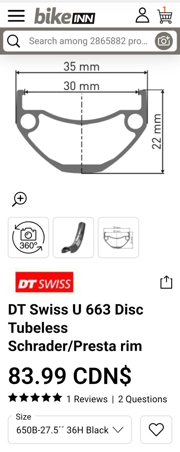

That one looks good. The 30mm inner rim width is right for the 26 dia rim I was looking for, would have to check to see if there was a 29 tire to fit. 36H. Don't see a price.

I'm thinking of getting this rim,..
It comes to $105 with the shipping.

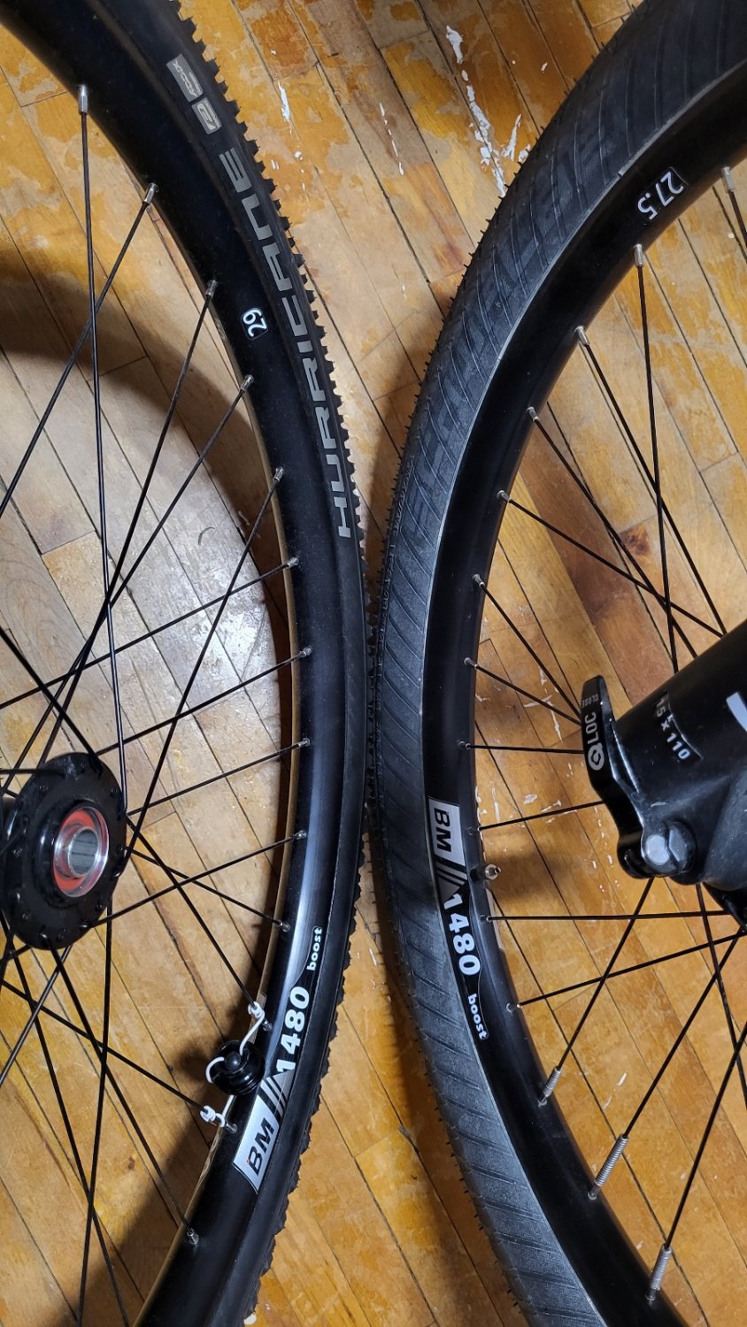

I want to get the 27.5" version because I've got 3 new 27.5" x 2.8" Super Moto-X tires and want to be able to use them.
This particular Canadian store doesn't offer the 29" version that you would probably want to get the longest spokes possible.
When I bought my second ebike (a Voltbike Outback with Fatbike dropouts and a hub motor), I ordered a new set of double shoulder inverted air forks, a 29" wheel, and a 29" x 2" Shwalbe Hurricane tire.
(The Outback came with RST Guide Fat Forks with those stupid QR axles)
Unfortunately, the steerer tube was too short to fit my Outback,..
So,.. I ended up buying Suntour downhill air forks, and a new 27.5" wheel for it (that had Boost Spacing instead of Fatbike spacing) to mount my Super Moto-X tires.

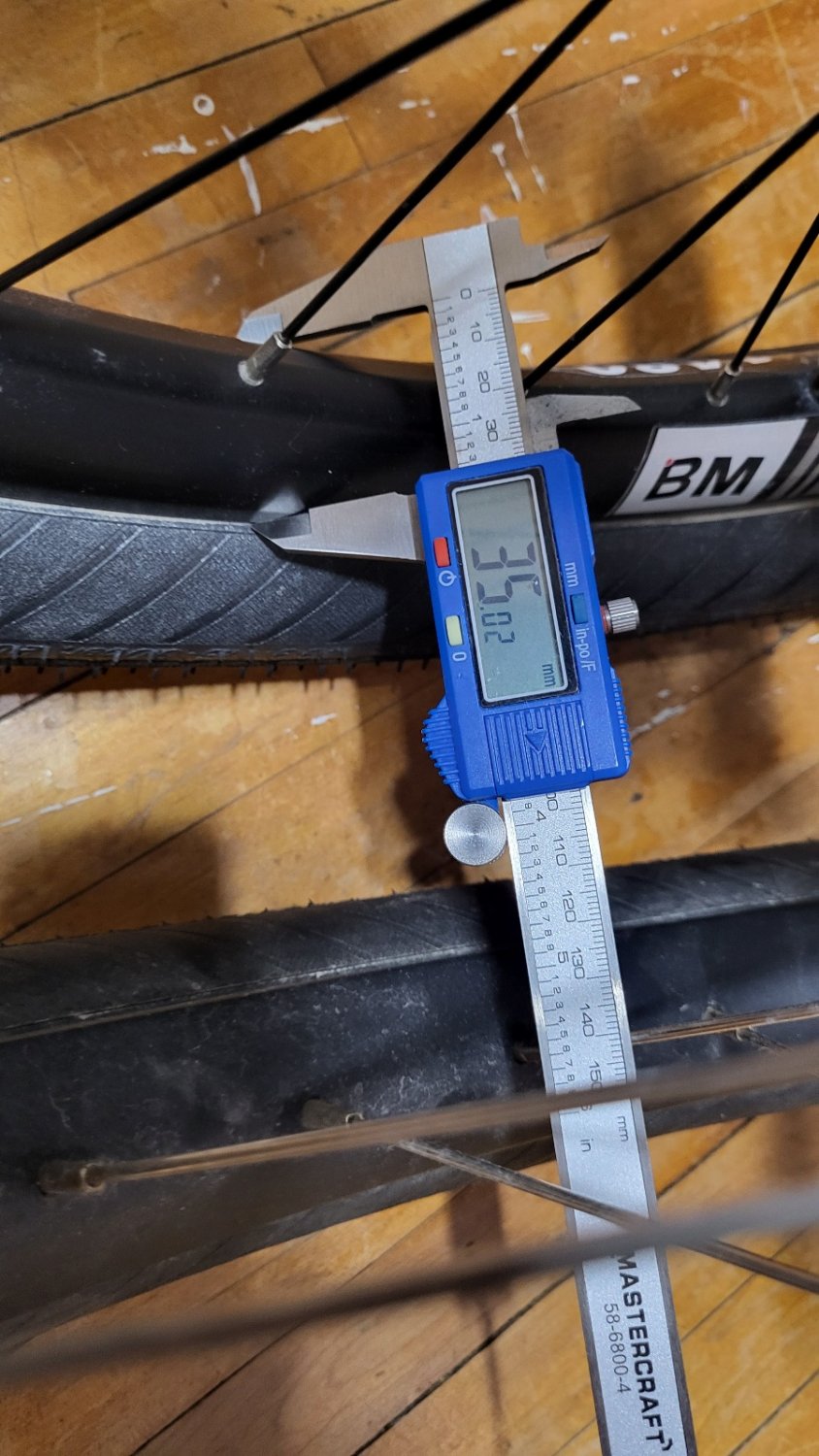

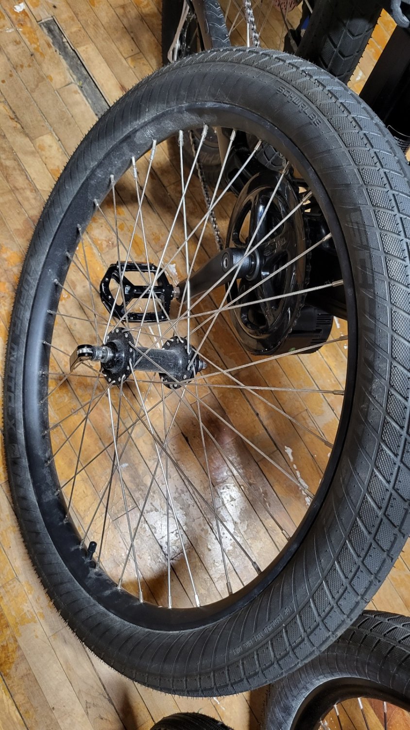

This is my original Fat Outback rim with a 27.5" Super Moto-X tire.

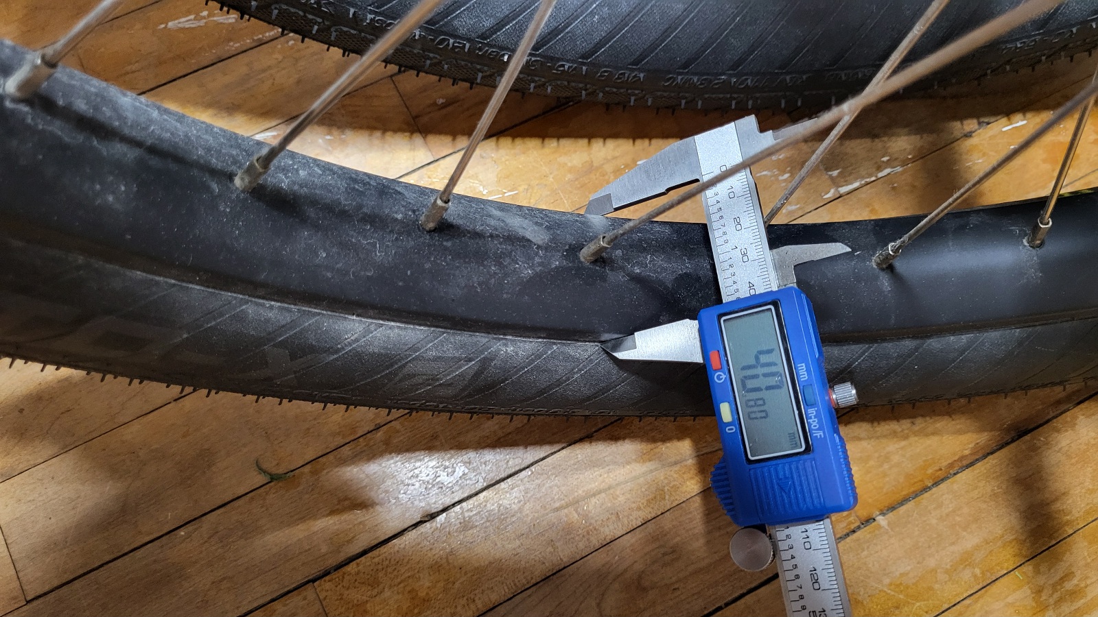

The rim has 40mm bead to bead spacing, and fatbike dropout spacing.
This is the new 27.5" wheel with a Super Moto-X tire currently on my Suntour forks, along with my new 29" wheel with the Hurricane tire on it,..
So I've already got a 27.5" x 2.8" tire mounted to a skinnier 35mm rim, which I just kinda realized (or remembered??)
So I think I might get the DT Swiss rim and try and string it into my original ebikes Fat Motor.

The only thing that I haven't verified is if the DT Swiss U663 is drilled for 12 guage?

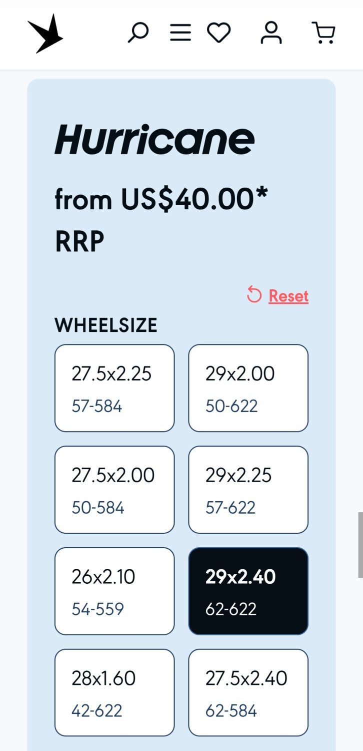

I bought my 29" Hurricane off Amazon, thinking that it was the largest size available, but there is a 2.4" available that would give more ground clearance (to help with pedal strikes) and should easily clear your fork braces and rear swing arm (or chainstay as they call it)
You might like the Hurricane?
It's got a Fast rolling center tread, with knobs on the sidewalls.
The AI Grounder is another good option.

And,.. I think that the U633 rim is drilled for 12 gauge and you use eyelets on the spoke nipples if you want to use 14 gauge spokes?

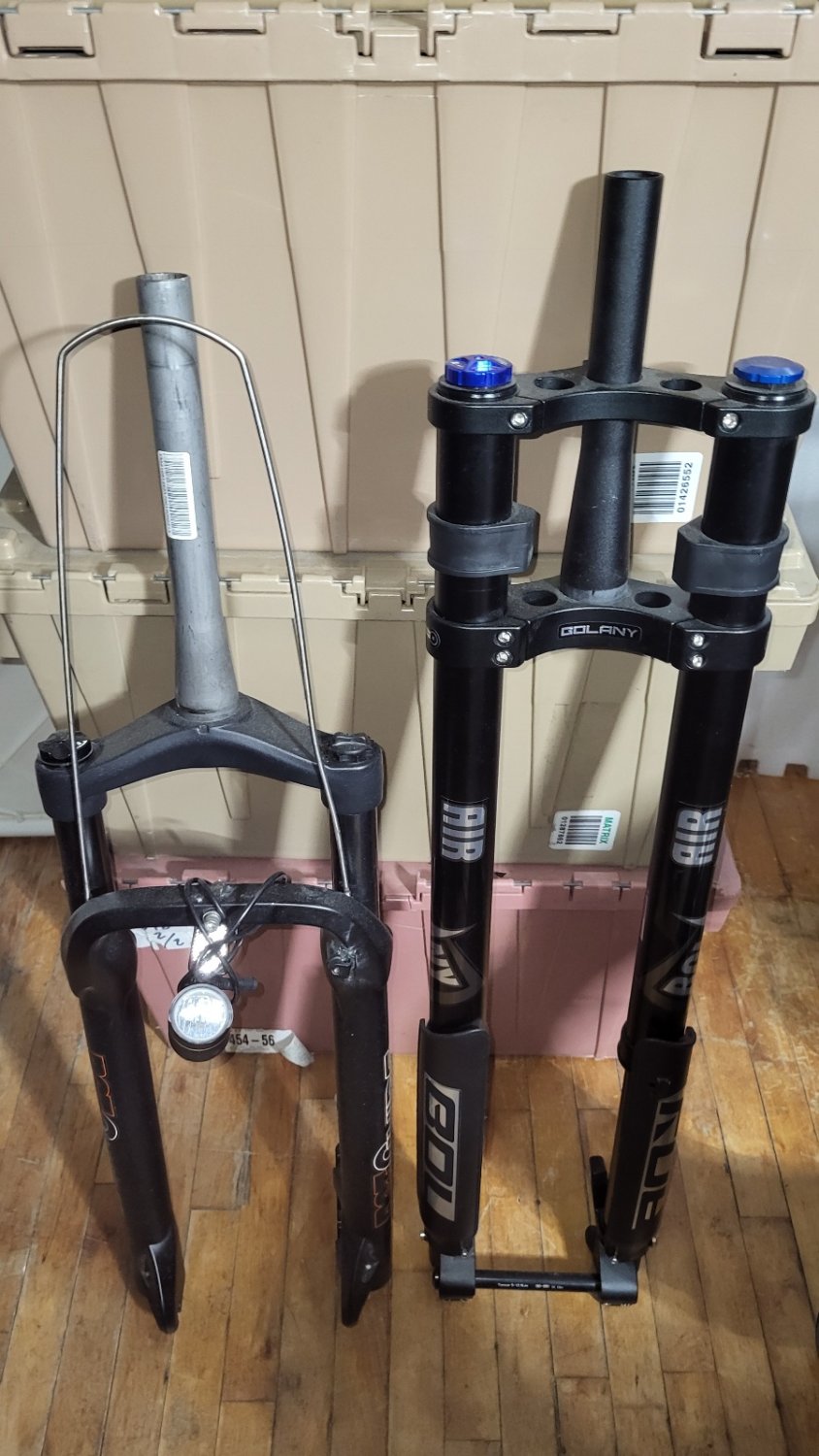

Yeah the RST forks are really tough, but they don't have real damping and they kinda suck
They have springs inside that are wrapped in plastic/rubber sleeves that scrub inside the fork stanchions to act as dampers.
I would lock my front brake and watch the fork movement as I pushed, and the forks would move ¼" at a time then bind.
My current front end is still quite heavy with the downhill forks, and the Super Moto-X tires are heavier with their Moped rating, and they've got heavy duty tubes with half a quart of Flat-Out inside.
But my ebike is amazingly stable and comfortable.
I can float through 2" deep potholes, no-hands, and the handlebars just wobble a bit.
Air forks are worth the investment.
Maybe something made for a Surron with double shoulder fork braces would be better suited for your ebike.
I did look into them after I bought the inverted forks, but bought the Suntour Forks instead.

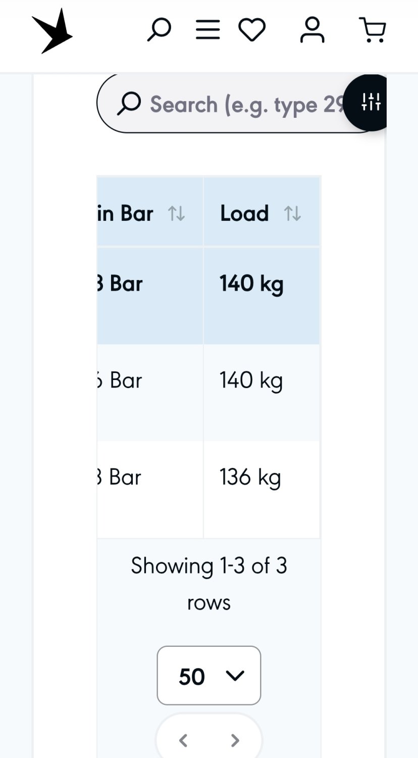

Either way, you should be good with any Moped rated tire that Schwalbe has to offer unless you're a three hundred pounder yourself. Lol
Some of the tire weight ratings are not listed.

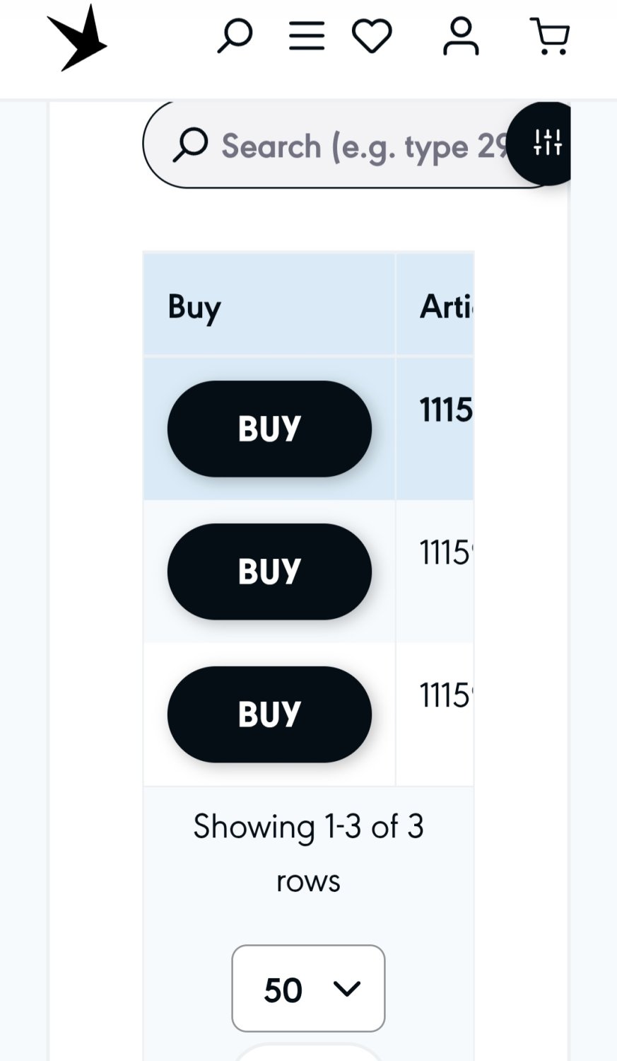

You have to scroll down to the chart, then scroll to the far right of the chart to see the load rating.

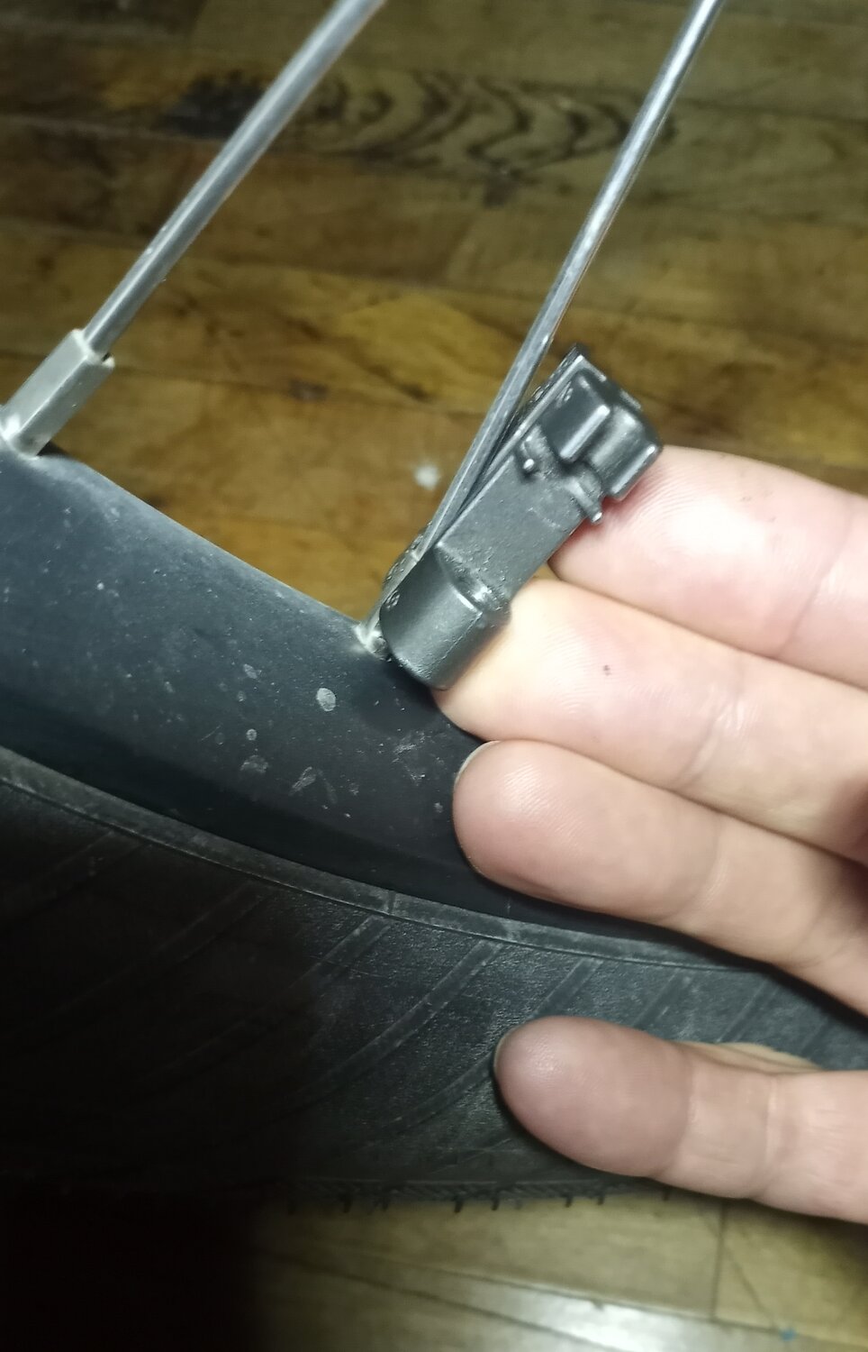

Think as long as the eyelets on the hub motors don't have any sharp edges, a little bend is not going to hurt them.
Yeah that's what I'm thinking, and the 12 gauge spokes don't have any flex, so the spoke heads aren't wobbling.

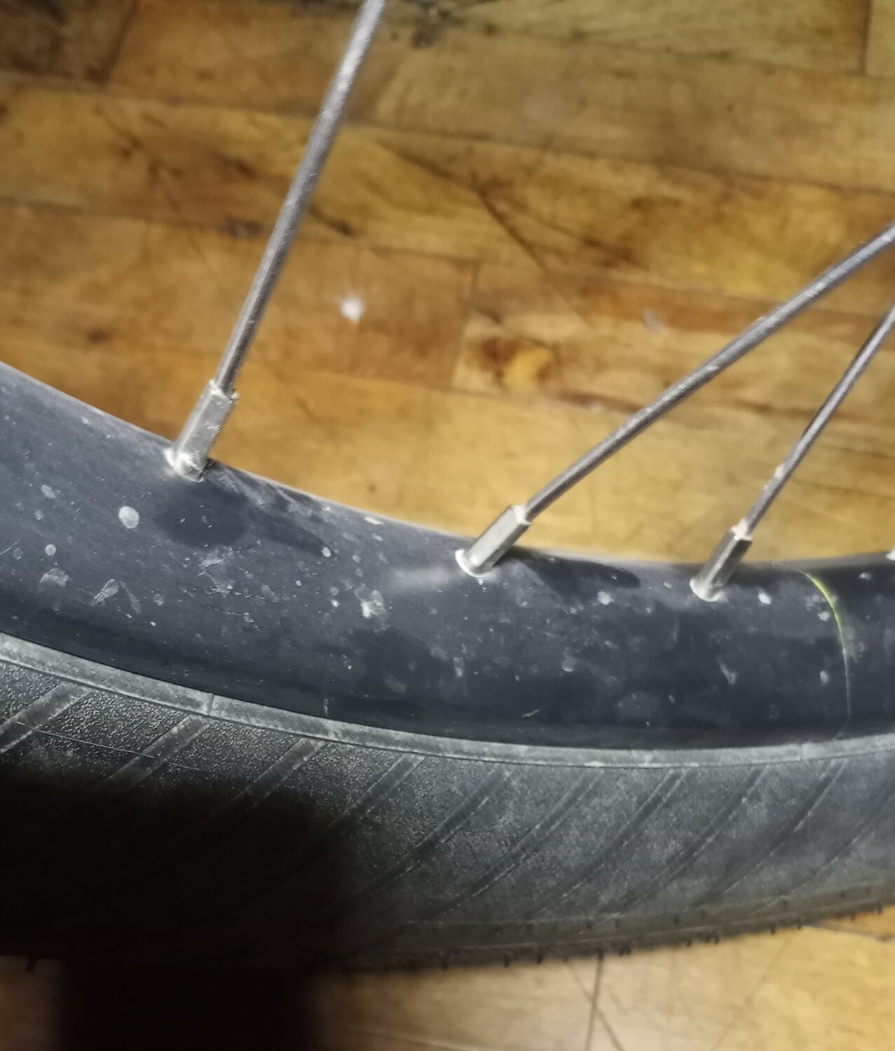

Maybe an eyelet isn't a good idea, because the spoke end has to pivot so much?
It's the spoke at the nipple too.
There's quite a bend because the nipple isn't allowed to pivot or lean,..
The spoke is so bent that my spoke wrench only fits on the nipple if the spoke is bending out of the way.

Probably depends on the rim maker whether the eyelets can be used or not. My 26" rims don't use eyelets and haven't seen any problems so far so probably not necessary. The Vado is the only bike I have that uses eyelets. Maybe the eyelets allow for the manufacturer to make shitty holes and easier to put the eyelet in. When it comes to wheel building time, you want the nipple to turn easily, or I do, cause I do it by feel. The websites probably explain why, it's not rocket science.

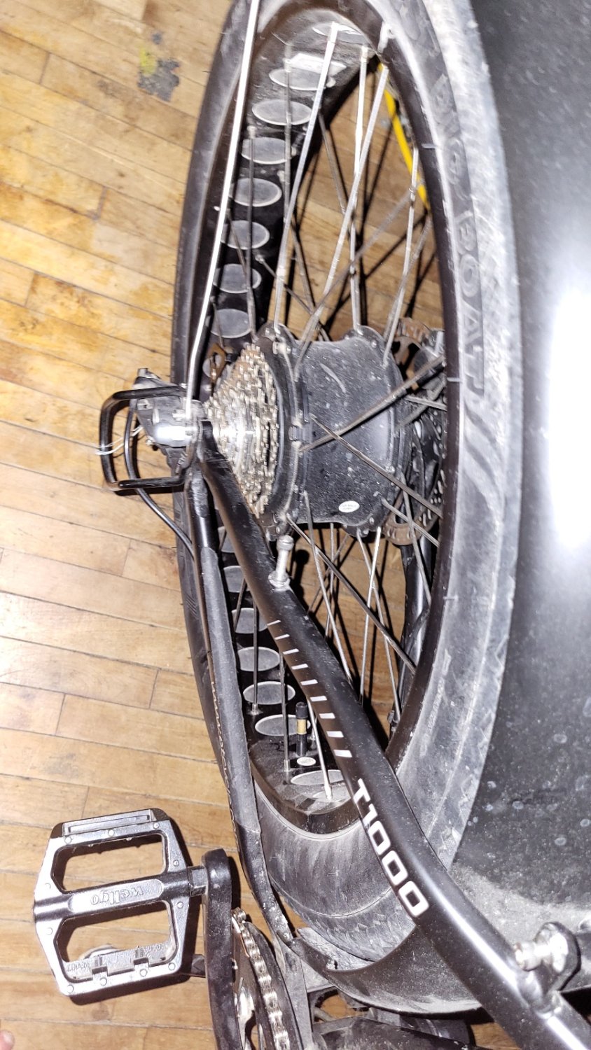

Yeah, there's lots of motor kits, but the problem is that if it's got a Fat motor, then it's got a Fat rim as well.
A fat rim has the spokes offset/staggered around the rim so the spokes are pulling straighter.
Connecting a Fat motor to a "normal" rim of any size is something that is almost never done.
My Voltbike is kind of a unicorn with a "regular" rim connected up to a Fat motor.

One good thing about having a "skinny" wheel in a Fat frame is that you've got Tons of room to fix a flat without removing the wheel.
I've got Lots of room to install a 29" x 2.8" version of my, (if there is such a tire?) and I would still have lots of room to the side to remove a tube.
You "could" install one of those 2000 Watt motor kits on your ebikes, but you'd need a longer axle with spacers, and that starts getting ridiculous.
You'd be better off starting over with a new ebike with regular or boost dropout spacing.

Looking at either the Hurricane or Hookworm as tires. Bikeparts has a good selection of spokes and nipples.

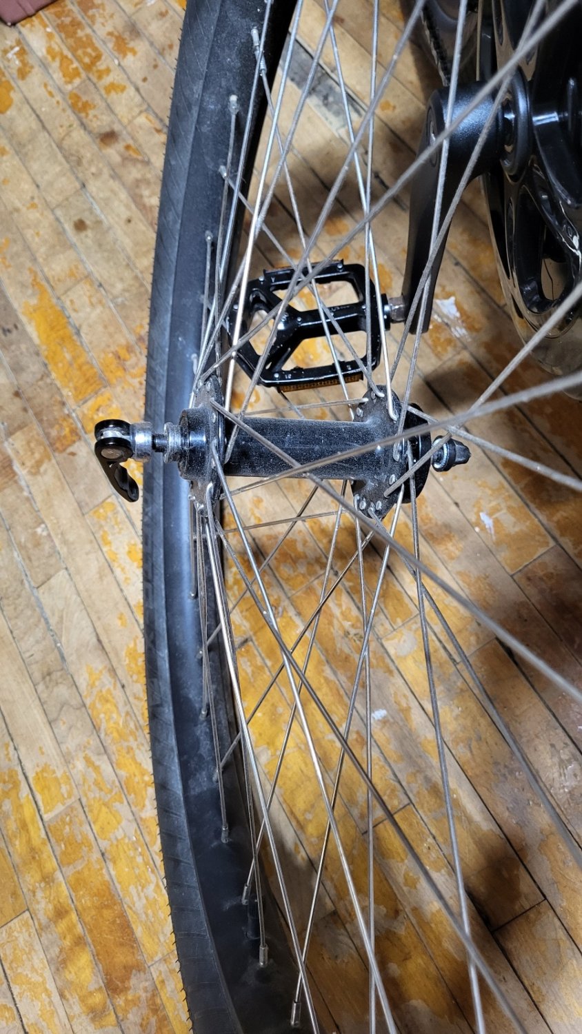

My front wheel has a Chinese rim, but it has 14 gauge spokes and no motor.
It seems fine to me but I'm not sure how it would cope with the power you've got or for going 50 mph?

My rear hub motor has the 27.5" wheel and 12 gauge spokes and the rim has no label on it, so it must be Chinese?
It seems fine too.

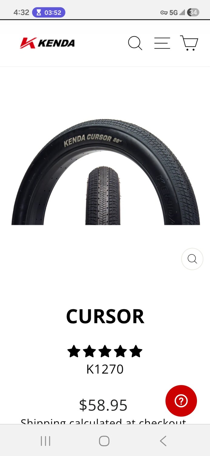

The Como wheel has a nice profile so I took it apart. The rim id width is 30mm, the tire is 2.3. Don’t think I would want to go much wider on the 30mm.
I don't see any 29 tires that are appealing for a heavy ebike that will carry a little cargo, probably another 30# at the most. Thinking of dropping down to the 27.5 for the Schwalbe pick up or something similar.
Awesome.
Then I can copy your homework, and build one myself.
(I'm serious too. If I know exactly what to buy, then I'll definitely spend the money to make one)
