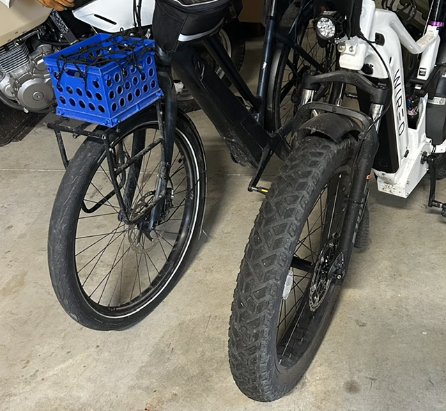

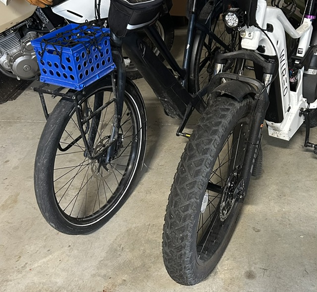

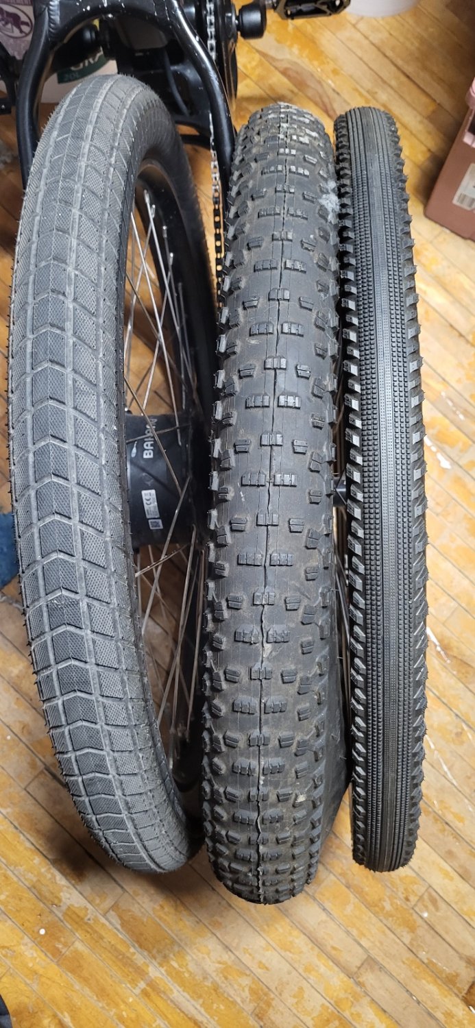

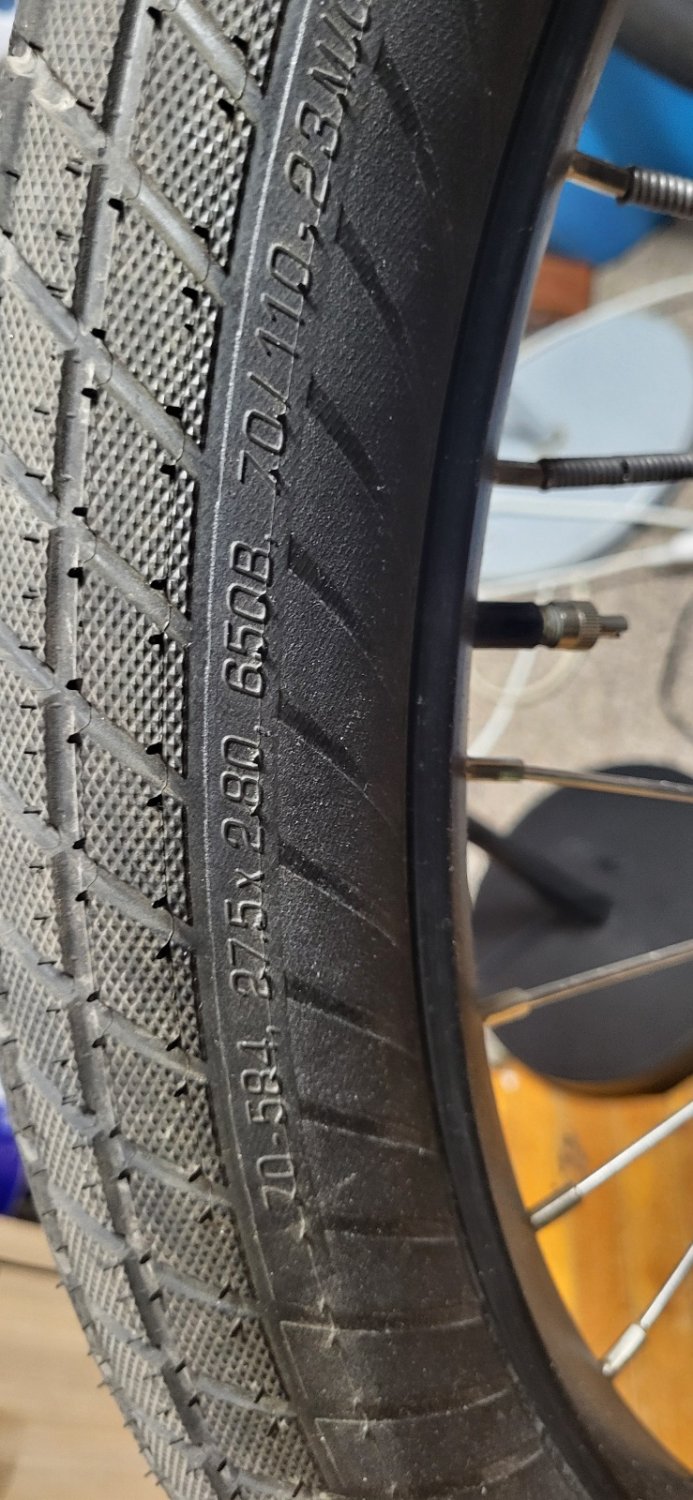

Comparing the 27.5 x 2.3 to the 29 x 4, the height difference didn't look to be more than a little over an inch, and figure to lose 3/4" height on the bike. Interestingly, the pedal height was 1" higher on the 26x4 tired bike, so dropping to the 27.5 is going to put the pedal height in the range of the other bikes and make the ground reach easier. The way it is now the seat has to be way too high to make pedaling normal and touching the ground is tip toe. Dropping it down an inch isn't going to hurt anything.
This pic makes the closer tire appear larger.

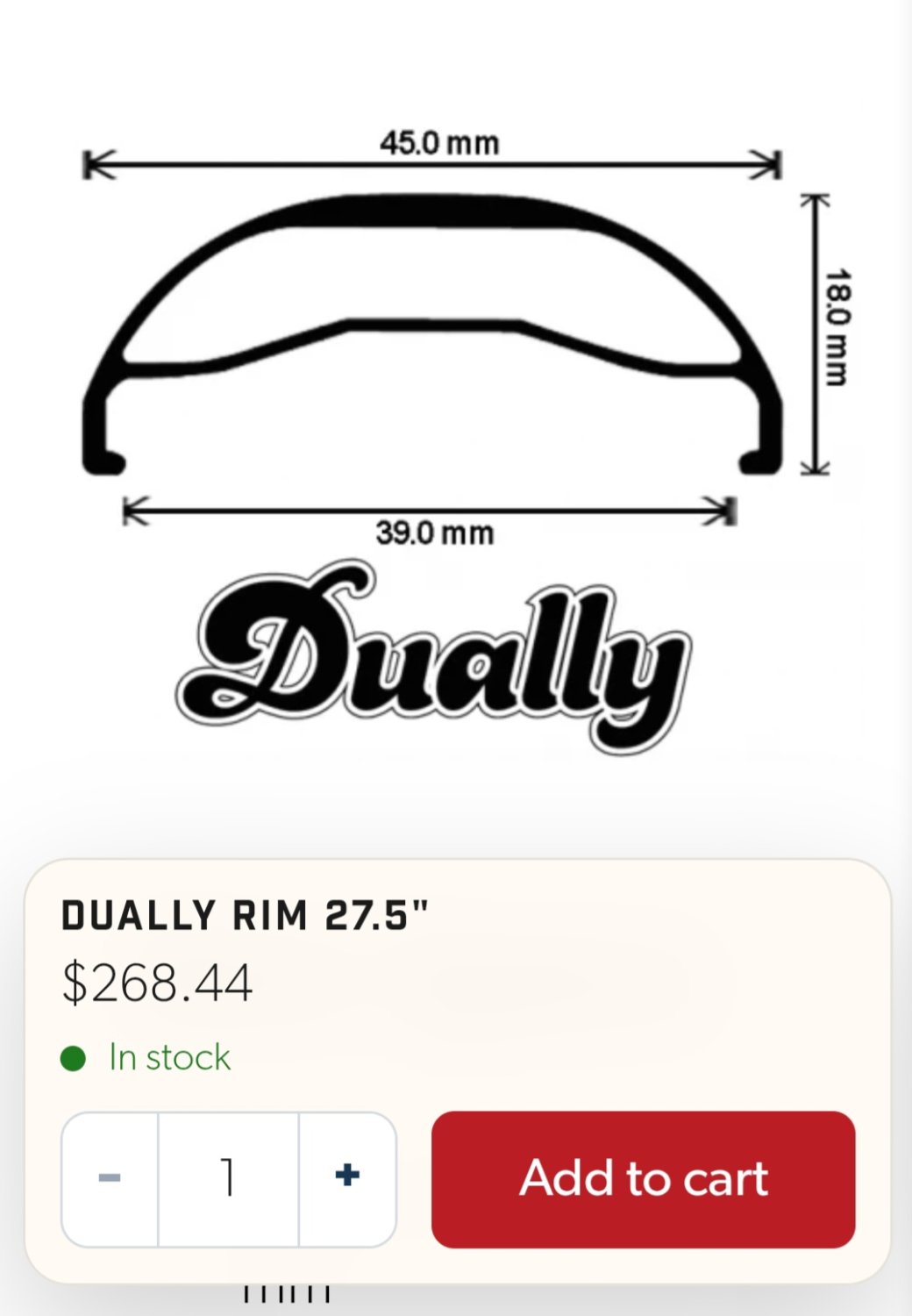

Velocity dually 650B with the 39mm id rim $170
Schwalbe pick up 27.5 x 2.6 $60
The dually also comes in the 26 and 29 same 39mm id rim if a suitable tire could be found but the 27.5 2.6 is real close to the 26 x 4. The 2.6 tire is available now and the 2.35 is not. Wonder what the weight rating difference is between the 2.35 and 2.6 if any. I figure to need 300 lbs carry capacity for the rear.

That's It !!
That's Exactly what I was looking for !!
It's got a wide rim, with a low profile (longer spokes).

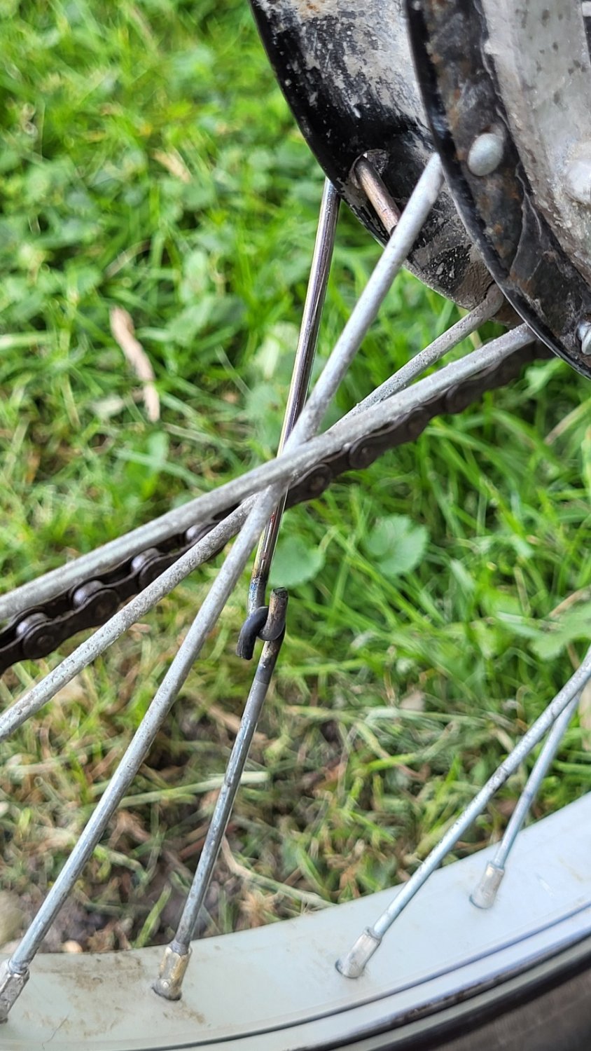

The spoke holes are staggered around the convex rim, so the spokes are slightly angled towards the motor and "closer" to the motor (less reach, and angle) because the holes are towards the sides of the rim.
Both of those things should really help with the Shitty angle of the spoke heads at the motor as well.
That rim was built to do exactly what we want for our fat motors.
The rims are all custom built with just a few in stock, but that means that you choose the spoke hole count, but I didn't notice a choice of spoke hole gauge, or whether the valve hole is drilled for presta or Schrader?

For this rim in particular, the maximum tension they recommend is 130kgf:
https://velocityusa.com/products/dually-rim-27-5?variant=40783711207503
"We recommend building to spoke tension between 110kgf and 130kgf."

It's either that or the DT Swiss U663 with the 30 mm rim width and the Schwalbe Pick Up in 2.3 which is shows out of stock at the moment on their web site. Haven't made any decisions yet. Both the 30mm and 39mm rim overlap in tire useage. $500 for a wheel change is kinda expensive dive to take. I was hoping you would be the first:). I missed that Velocity rim was asymmetric, was hoping to stay symmetric.
All that I know for sure, is that if I build a wheel, I'm going to use the rim that you found.

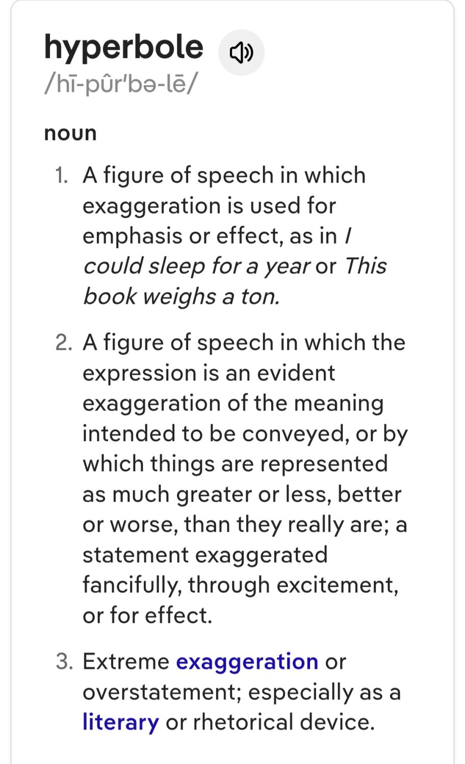

It was mostly Chalo pushing the idea, so there is lots of hyperbole in the thread, but he is a
Is Chalo a mathematician?

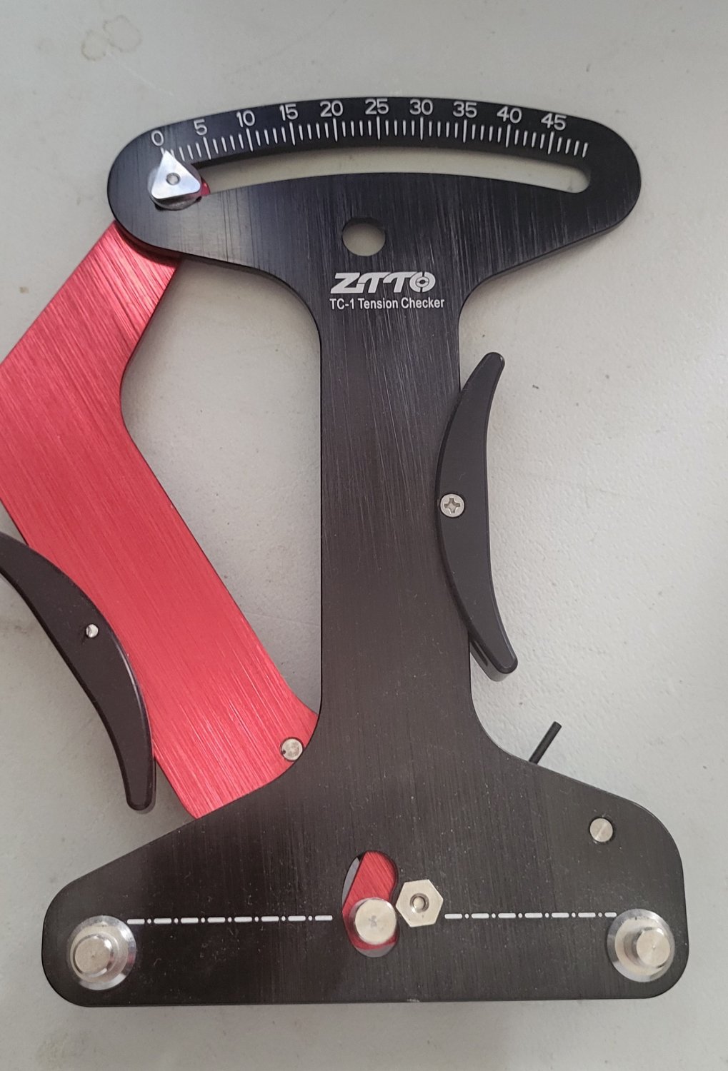

I have the park tool tension gauge similar to above, didn't have any luck with it. I have found truing motorcycle rims, remove the spokes one at a time and lube threads and nipple with anti seize, it will keep the threads from slipping and much easier to feel the amount of torque used. If a torque wrench is used with thread lube the torque has to be reduced and use 75% of a value. I do it by feel, toward the end only turning the nipple 1/8 or less, you can actually feel them pull tight, that is when to stop, going all the way around the rim and watching the dial indicators. Spec is within .020 lateral and axial for the motorcycle, I can easily get .010 and sometimes .005, depends on the rim. This is using two dial indicators, lateral and axial. Dial indicators are a must. Getting the spokes close to same tension won't be a problem using this method. Have to start with the same amount of turns on the nipples, then go from there. Finding center laterally/axially 180 degrees apart on the rim and using that as the benchmark and go from there. The rim will continually try to taco that is why have to take it slow when things starting getting tight, otherwise it will do all kinds of weird things.
I didn't have much luck with it either, especially on the hub motor.
The spokes are too short and I could barely get the tool in there to get it on a spoke, especially on the brake rotor side of the wheel.
I ended up going mostly by feel.

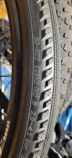

Went down to wally world and looked at their bikes. They had a mtb with 29 rims with the 2.6 wheel that looked real good. There were also the 27.5 with the 2.3 tires. Think cause the weight of my bikes the 2.6 tire would be preferred and not go any thinner than the 2.3 range. The tires were suggested 35 psi so they prob aren't designed for much weight, otherwise a guy could spend $3-400 and get a tire and rim set and parts bike thrown in.
It depends on the tire size and volume.

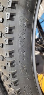

My 27.5 x 2.8 has a suggested pressure range 20-45 psi with a maximum load capacity of 155 Kg. (each tire)
The 27.5 x 2.4 version has a suggested pressure range 30-55 psi with a maximum load capacity of 145 Kg.
The Schwalbe Pickup 27.5 x 2.3 has a suggested pressure range 30-65 psi with a maximum load capacity of 165 kg.
The Schwalbe Pickup 27.5 x 2.6 has a suggested pressure range 30-55 psi with the same maximum load capacity of 165 kg.
(I'm pretty sure that the Heavy Duty Pickup is designed for maximum load, so the difference isn't as much as with my Super Moto-X tires?)

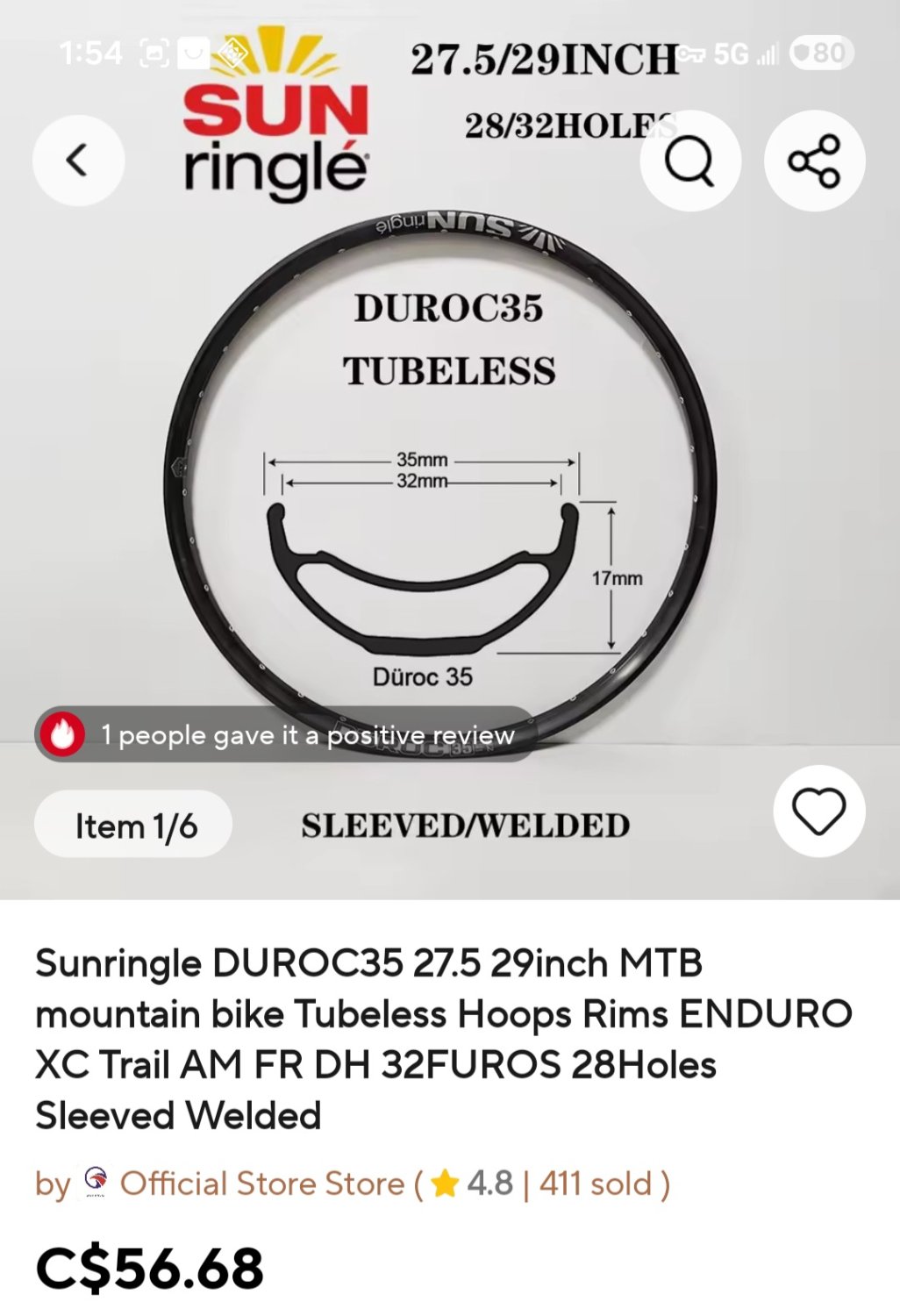

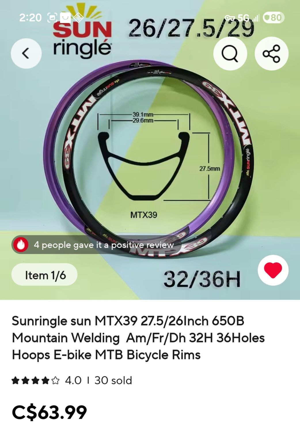

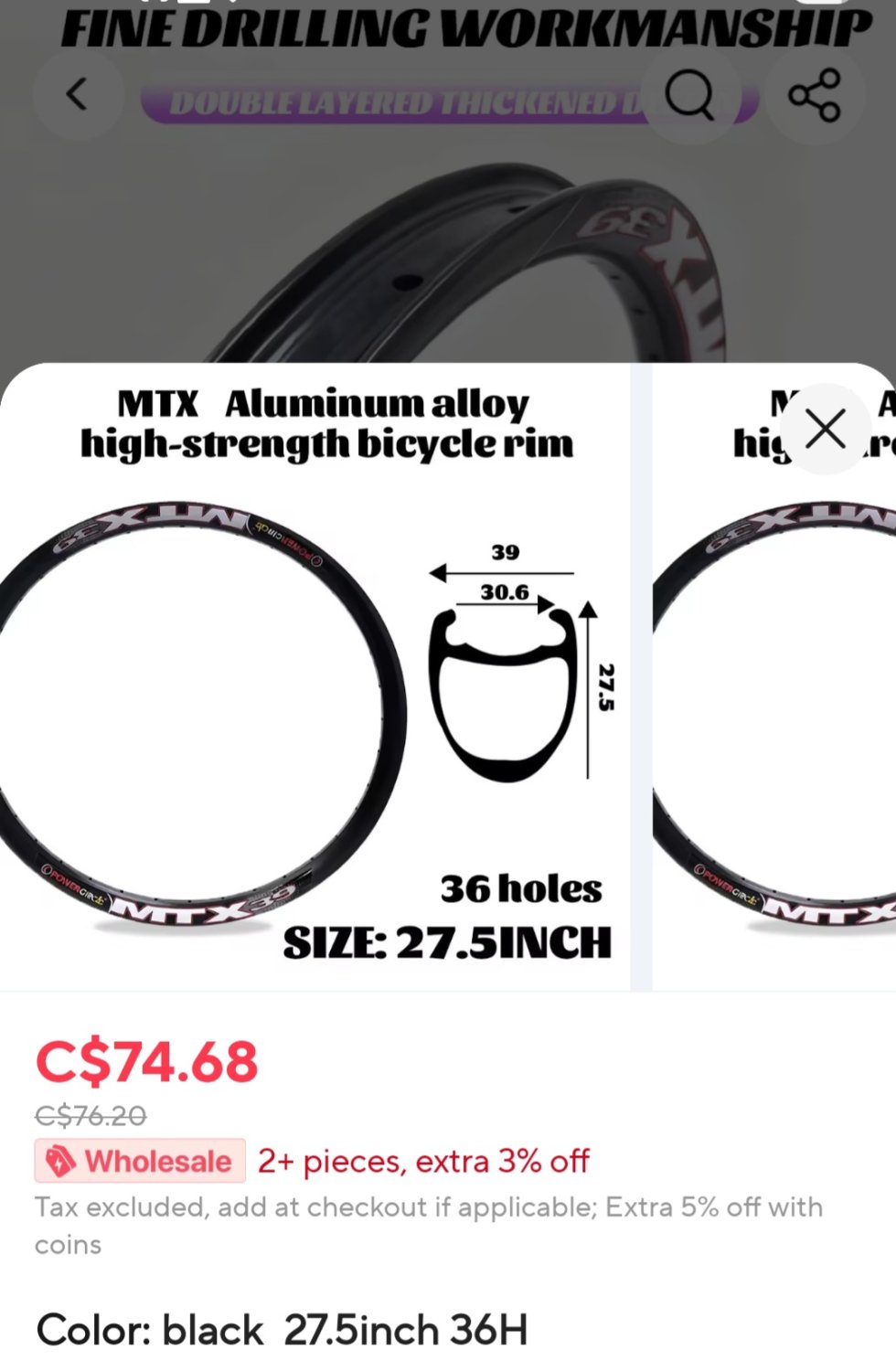

I just found this on AliExpress:
Sunringle sun MTX39 27.5/26Inch 650B Mountain Welding Am/Fr/Dh 32H 36Holes Hoops E-bike MTB Bicycle Rims
26/27.5/29inch MTX MTB Double Aluminium Alloy High Strength 36H Rims for Electric Bike
The J-hooks are 5mm thick.
This 28 spoke MTB rim has a larger inner diameter, but a smaller outer diameter.
Perfect for making Tacos !!
Just fill your innertube (or tubeless tire) with your favorite ingredients. 😁

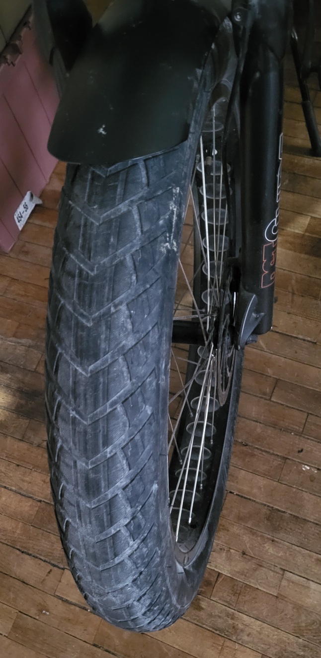

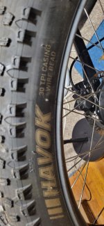

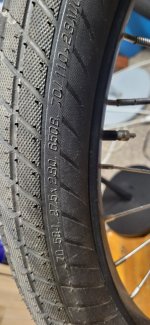

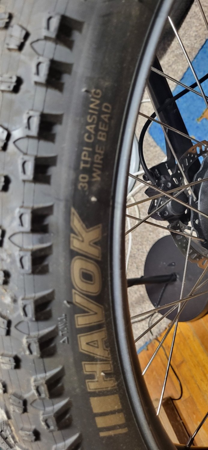

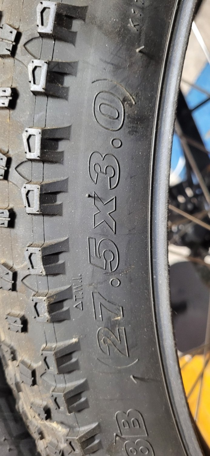

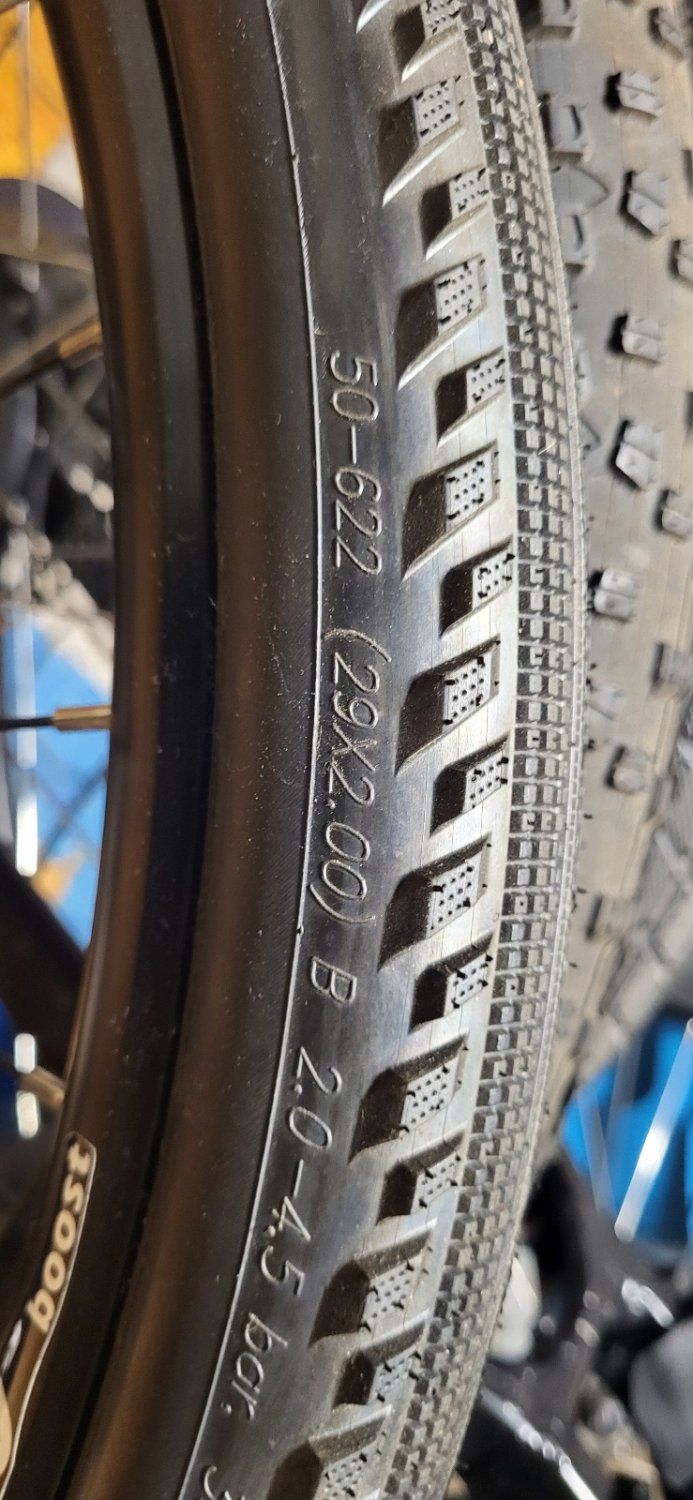

I noticed in your picture that your 26 x4 tire has more of a street tread than I was figuring.
This is the CST Big Boat tire that came with my first ebike.
I specifically bought the ebike because of the street tread.
These are my Super Moto-X tire, my (unmounted) Kenda Havok tire that came with my second ebike, and my Schwalbe 29" x 2" Hurricane.
I only took the Havok tires for a 20 minute test ride when I got the ebike, then swapped the tires, and I haven't even tried the Hurricane yet.
So I don't really know how the different tires feel and behave, and my only goal is to have the fastest rolling tires I could get to increase my range.
I thought it would be smart to inflate my first Super Moto-X tires to the maximum (42 psi) thinking it would have less rolling resistance, but I ended up swelling the tire, and the rubber delaminated.
I did get 7,000 km on the tire and the tread looked almost new, but it was no longer connected to the tire. 😁

Information about the Velocity Dually:
The ERD on a 27.5 Dually is 566.
We do not consider the Dually to have asymmetric or offset spoke holes; only the A23 OC in our line up does.
Also, keep in mind all our rims are drilled for a 14g nipple. We tend to use Sapim E-Strong spokes with the reduction nipples. 12g at the elbow bend and 13g at the nipple end. The reduction nipples have a 13g thread but the OD is the same as a 12g nipple. Also, we recommend getting tension close to 120kgf.
This all make sense? And what is 120 kgf converted to in lbs?
Yeah, that all makes sense to me.
They seem to know all about connecting a fat motor to a semi-fat rim.
That doesn't make sense to me? That's not a torque spec.
120 kgf is 264 pounds.
264 foot pounds doesn't make any sense to me?
EDIT: They probably mean pulling force?
How the hell are are you supposed to measure that??
I'd just wing and go by feel and sound.
Like you said, it's not brain science or rocket surgery.
I just gotta get the right parts.😁
Well,.. The Dually rim is what I want.
I didn't want to spend $268 for it though.
And that doesn't include the spokes, and I think that's USD as well?
I'm still considering it.

I saw that above. Some of those websites looked really fishy with really good deals. I ordered a couple rims from pro wheel builder dot com. $170 a wack but looked all over, the cheaper ones are 32h and everybody has them. Another place had them with free shipping but they cost more so it was same amount. $35 to ship mine. If you are in GA you could pick them up.
I was real close to ordering a couple weinnman rims on the cheap at $40, think that is what grin carries. The thought of a rim failure on a downhill concrete 8 ft. wide path may be the true cost.
