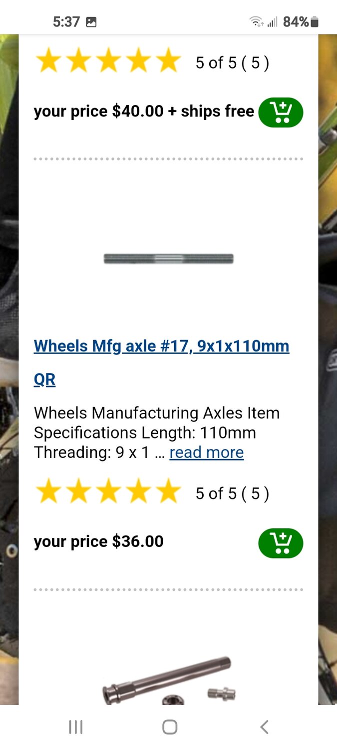

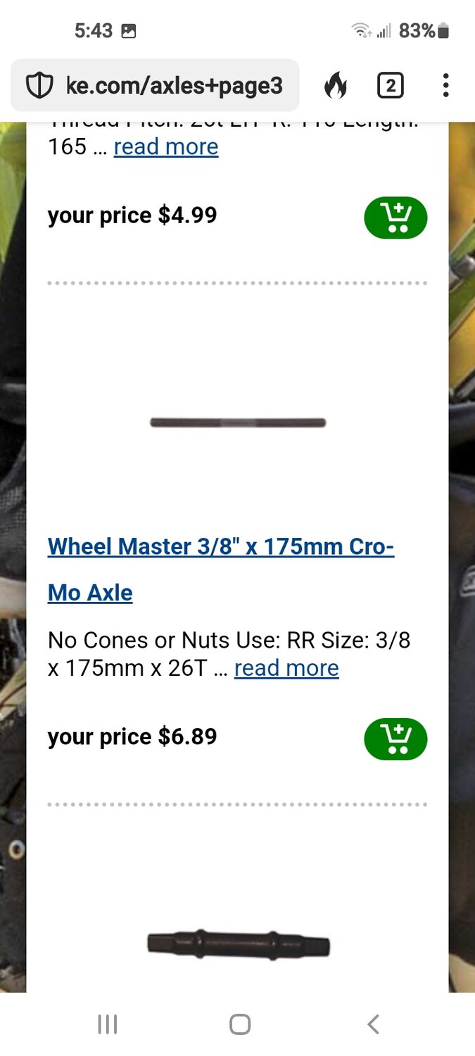

Will this (above) solid axle fit the cone bearing cups of the OEM hub?
I do not think any of us have any idea. One thing I am sure of, if you buy from ebay or amazon, "high quality" means there are no visible holes in the solid part.
If you buy from modernbike.com or universalcycles.com certain brands are from taiwan or austria instead of *****. DTswiss spokes are from USA. If there is a brand and part #, you may be able to download a drawing (pdf file) and compare to your present installation. People on the phone may be able to answer questions.

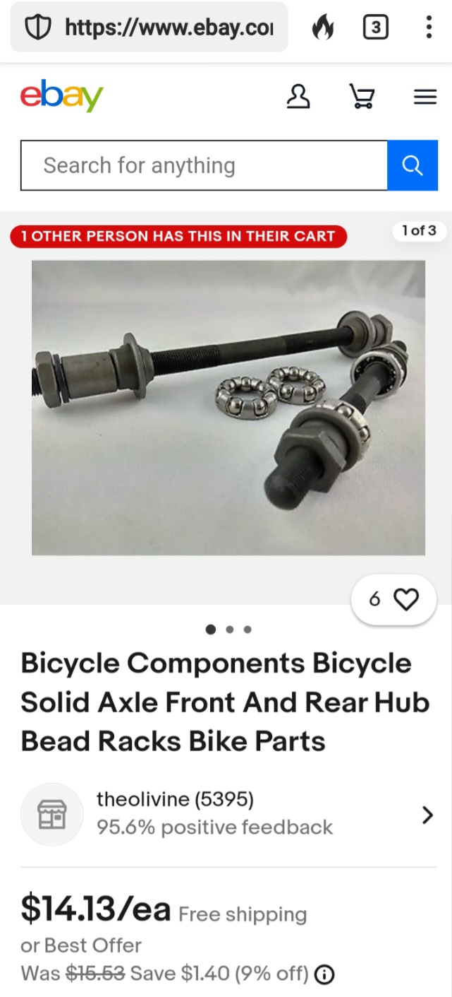

If you're OK with shopping on ebay, I found this axle set that Actually IS solid core,..
I'm about 95% sure that this axle will work for you.
Your bike is old before they invented 25 different types of bicycle axles.
This is just a standard cup and cone axle with everything you need to install it.
The cups and cones allow it to be adjusted to fit your wheel hub.

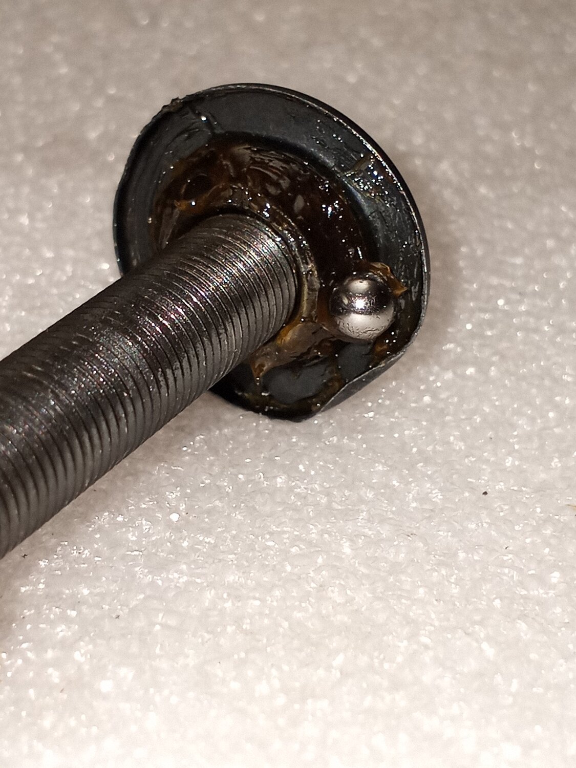

My axle was handy so I took a picture. I could only find one loose bearing though. 😂
