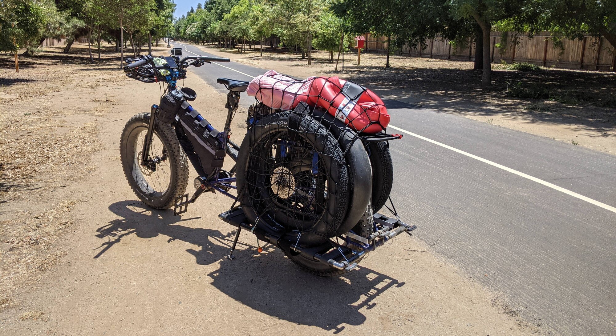

Bring a lot of water. I do a single 1L Camelbak bottle if and only if I know I am passing some parks with working water fountains for refills. I plant the big bottles on the top tube, up front, as they are too big for bottle cages. But there are bottle holders for them and their MOLLE strap mountings work great on the front of the top tube, especially if there is internal cable routing to hold the pouch up forward. You can see one in this pic and if the sun looks bright and hot... it is. I am alone on what is usually a crowded mixed-use bike path. Everyone is indoors hiding from the heat.

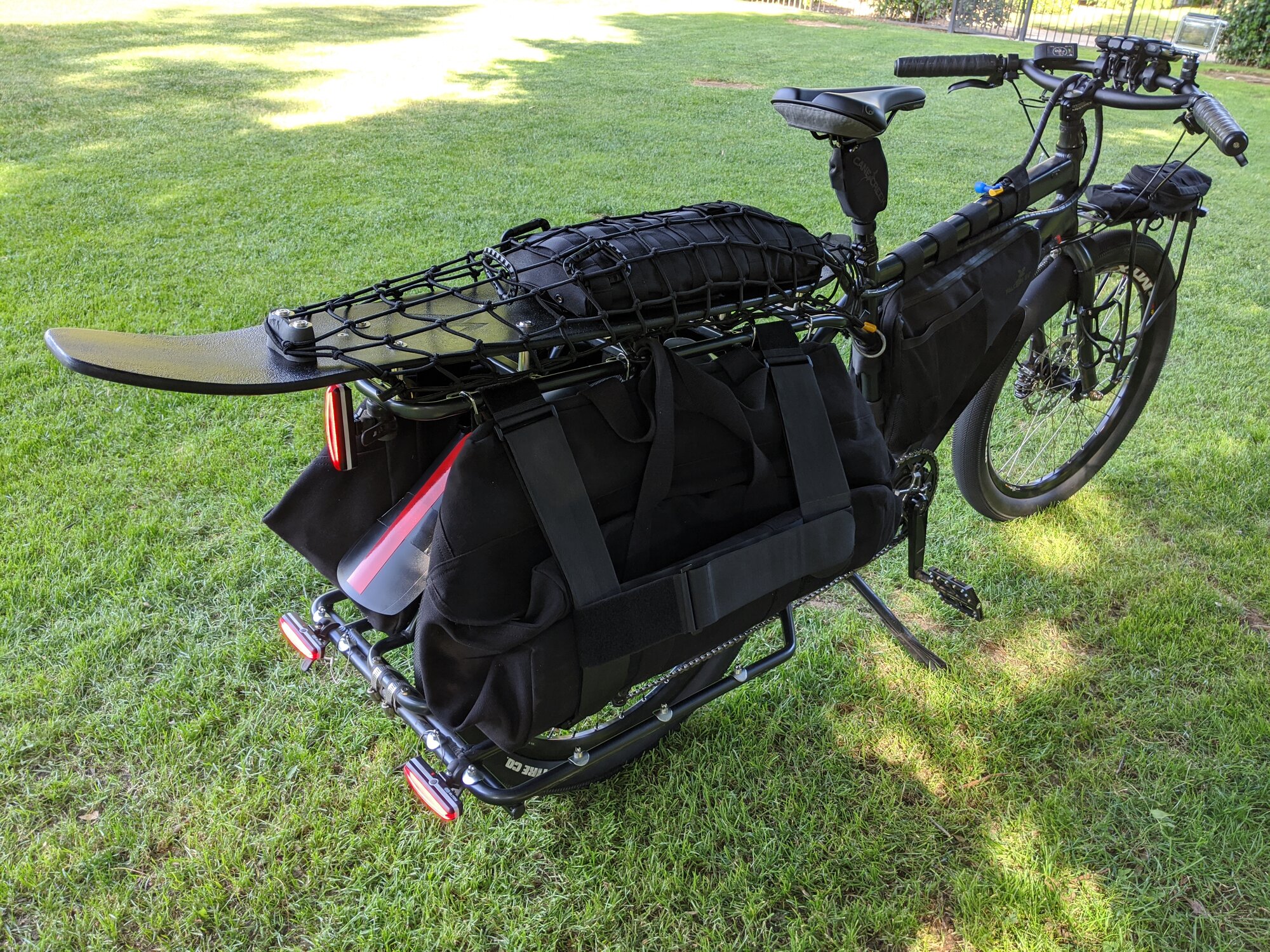

If I am just running errands thru the city with no definite refill spots, I'll pack along a 3L hydration bladder. This bike has one netted to the rear deck. I used a nozzle kit and 6+ feet of food grade silicone hose (Ebay) to run it up thru the handlebars. After these pics were taken, I subbed in a magnetic mount for the velcro you see here.

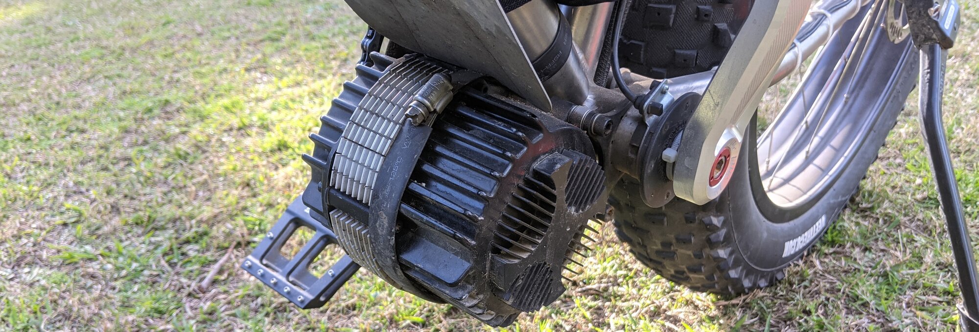

Heat is tough on the motor and battery. Put a wired temperature sensor on your battery and pay attention to it. Learn what is normal in terms of temperature so you can tell when its going overboard. Also your motor gets hot when the weather is cool. When its super hot and you are on a sustained pedelec cruise that is probably eating a sustained 5 amps, that motor can get blistering. Help it. Heat sinks work wonders. I've had motors reach casing temps of 165 Fahrenheit, but with heat sinks attached with double-stick thermal tape (special stuff - cheap on amazon - designed to conduct heat thru itself) I've gotten motor surface temps down to 130. This goes for mids especially but also for geared hubs. Nylon gears can become peanut butter with the right amount of sustained heat.

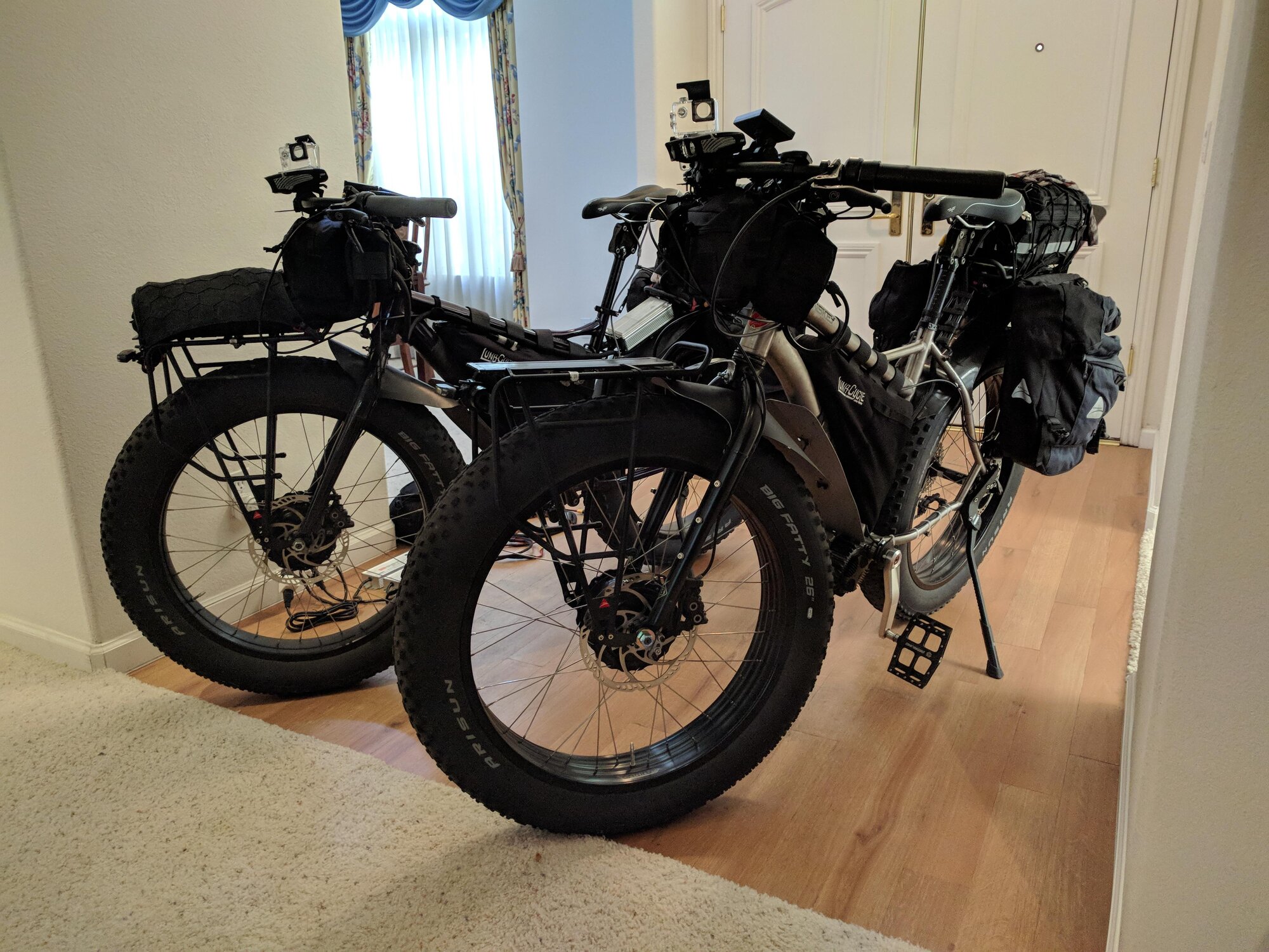

I have 7 ebikes at present. For most of them, for the summer, I pull the pack and bring it into the house where its air-conditioned. those bikes are retired during the hot months. For the ones that have to stay rideable on demand, I have an ... air conditioned garage :D
That pic was from 2018. This summer, the ti bike is still inside sitting in the same spot, but the Bullitt has taken the place of the Purple Thing on the left. And since I want to be able to ride my Big Fat Dummy this summer, I have that battery pack set up as a quick-detach. No way can I add an 8-ft-long bus in that same space so the bike stays in the garage but the pack is inside.
