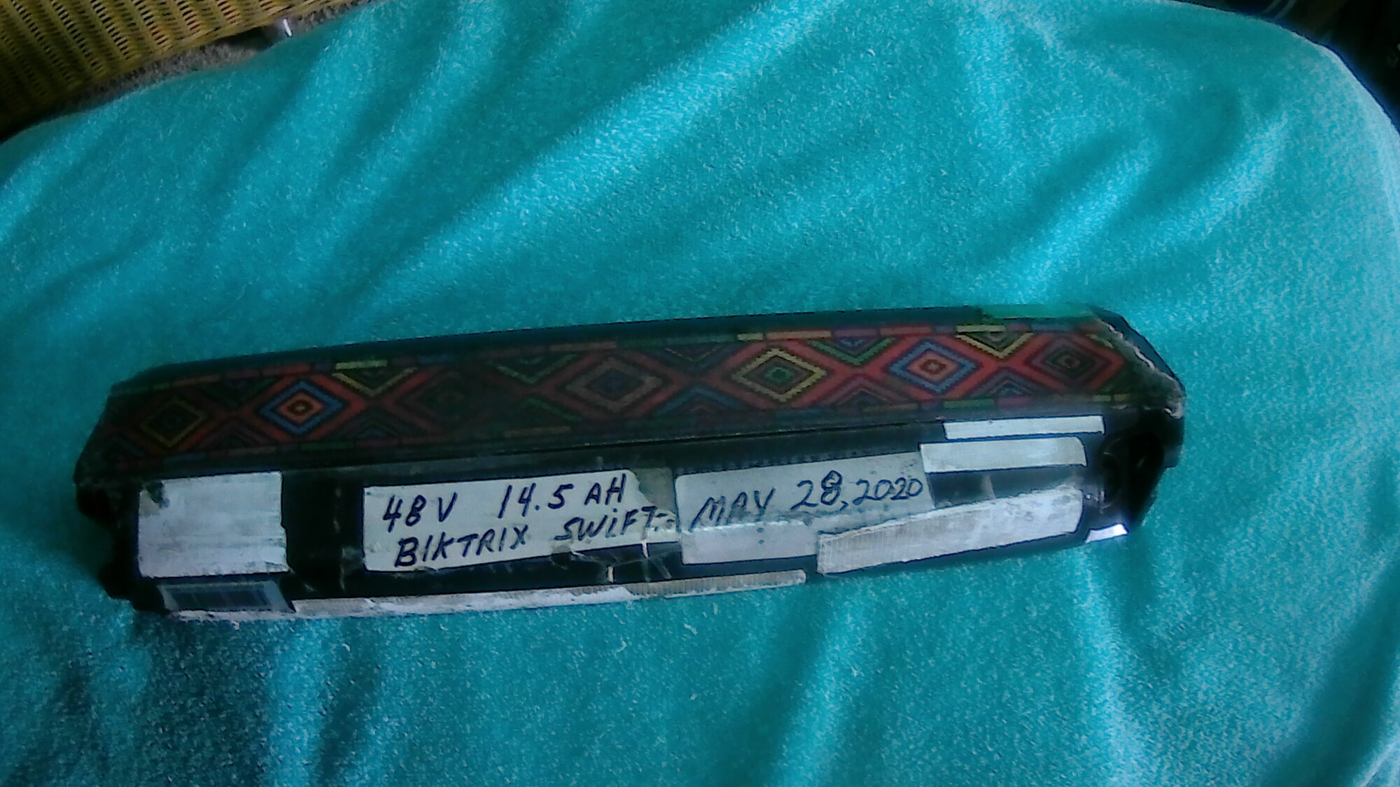

UPDATE: On July 18, 2023, I had yet another trusty ebike battery finally go caa-caa doo-doo.
This particular Reention Dorado-case unit was a 48v/21ah (i.e.“21 gallon”) item that had a “born on” date (that's when it was delivered to my front door) of July 25,2021 (25 months ago). I had purchased it as a stand-alone item from a dubious (in hindsight) stateside website-- but NOT an ebike company.
You must remember that I usually try to do a daily 50+ mile ebike ride. The year 2022 saw me doing a total of 12,731 ebike miles.. In order to accomplish those kind of miles, I either use two batteries (for the M2S(brand) ebike(s), or three batteries (when using the 2021 ArielRider (brand) X52 mini-beast battery hog ebike.
So, on this July 18, 2023 day-of-ride, using the AR X52, I load up two 52v batteries (a 20ah(20 gallon) and an 18ah(18 gallon) ) into my USPS mailbox seat/storage unit. They will be used as swap-out batteries at mile 15 and at mile 35. My initial 15 miles will be handled by the 48v/21ah(21 gallon) battery. I install this battery, turn on the ebike, watch as the screen appears for about 3 seconds, and then it shuts off. I press the end cap button. Nothing. No four green lights.. no red lights. ShitFire.
However, all is not lost because also located on the end cap is this note “45A”, meaning that a 45amp flat blade in-line fuse is installed on this battery. So, no problemo. I grab my 48v/14.5ah(14.5 gallon) battery, install it, and go do my most excellent ride. Though that battery is 6.5ah(6.5 gallons less than the 21ah(21 gal) “bad” battery, it is still capable of going for 15 miles in the X52 piggy.
The next day, I decide to pull the end cap and replace the blown 45amp fuse. I mean, what else COULD it be? I treat my ebike batteries like royalty, so dissention in the ranks is just not possible. BUT NNOOOOO!!!!!!!!!!!! the damn fuse is fine and dandy. My battery had apparently committed Larry-Mary (hairy-carry). Now it was definitely ShitFire and DoodleFartz.
Whenever I have a battery “malfunction”, if it's not a blown fuse thing, then that battery goes into the “won't pile”-- kinda like the “wood pile,” except that I won't ever be using this damn battery ever again. By the way, my pile currently has 6 logs total. I know some viewers will say to get the defective product re-built, but that costs mucho$$$, too. I figure that I definitely get the “mileage” out of the batteries I buy. If they can last for 2+ years at my pace, then I should be (and am) satisfied with that factor.
Oh well, I can't really complain because during its 25 month lifetime, it was probably the most used battery in my entire gangsta posse of same. But that also meant that I now only had THREE ebike batteries in my arsenal:
  1. the aforementioned 48v/14.5ah(14.5 gallon) item that was original equipment on my peas-o-chit 2020 BikTrix SWIFT ebike. It's “born on” date was May 28, 2020 (38 months ago).
  2. the 52v/18ah( 18 gallon) item that was installed on my ArielRider X52 ebike. Its “born on” date was Aug.5,2021 (25 months ago).
  3. The 52v/20ah(20 gallon) item I had purchased as a stand-alone item from the fabulous JennyMao. Its “born on” date was Oct. 7, 2022 (10 months ago).
So, two of my remaining batteries were possibly on their last leg, too. I had only recently managed to finally form the thought that I don't need to be buying more ebikes because, based on my three current top performers (their current mileages are: 21,800 and 15,187 and 15,789) these friggin' 750watt/1,000watt+ rear hub ebikes are gonna just keep on truckin', apparently forever. Too dang cool. What to do, what to do?? Hmm. Buy another battery!!! WhoDaThunkIt?

HiAll,
I just want to inform you folks about my latest ebike battery “what the hey” scenario.
Today I headed out on my usual 50 mile ride. Depending on which ebike I am riding that day, I either use 2 batteries OR 3 batteries. Since the beast of the day is my newly rehabilitated (kind of) 2021ArielRider(brand) X52(model) peas of chit ebike I took 3 batteries because, for some reason, that particular ebike has always been a battery piggie..
I try to use a specific formula for which batteries I take per ride and in what order they will be used in. For just in case.. Case-in-point coming up now. The older the battery, the first to be used. So, todays 1st item will be the 48volt/14.5ah ( I always refer to “ah" in the same context a motor vehicle refers to its fuel tank- thus a14.5 gallon fuel tank.) battery that came with my 2020 BikTrix(brand)Swift(model) ebike.
I load up, head across the street to intercept the local bike path system, and am suddenly looking at a blank lcd screen and no power at all. Zip..zero..nada.. ShitFire. So I stop and press the button on the end of the battery casing. No 4 green lights.. No 4 red lights. Hmm. Battery OR ebike? I installed one of the other batteries and PRESTO, I have mucho power. So I pack away the bad battery and using my 2 good batteries, I go for a 40 mile ride.
Everything went just fine and dandy during the remainder of the ride. I returned home, thought about the error of my ways (of which there are many), and removed the end cap (where the red/green lights are located) to see if this particular battery had a built-in flat blade fuse installed. Sure enough, there was one, a 40amp item. I examined it and though the connector wire appeared okie dokie, the was a very small dent on one of the 2 prongs. I installed a new 40amp'er, pressed the green/red light indicator button and sure nuff, I had 4 green lights. So, I re-installed the end cap, mounted the battery on the X52 and pressed the “power” button. All was good. I then pressed the thumb throttle and, again, all was good.
I'll be busy tomorrow, but the day after, I'll take the same ebike/battery configuration out and about. Hopefully, all will be righty-diety.
The subject 48v/14.5ah battery has a “born on” date (the day that it/the Swift ebike arrived at my front door) of May 28, 2020. As of today(June 26, 2024), it is 49 months old. I've been expecting it to give up the ghost pretty much any time during 2024. I'd say that, all things considered, I have definitely gotten my $$$ out of that lil' rascal. It is currently the oldest of my “in-rotation” batteryline-up. I have a total of 6 good batteries to choose from.
I just wanted to put this info on this particular thread because a). I wanted to, once again, give readers an idea of how long their own ebike battery should last . And remember that I use my arsenal of ebikes/batteries on pretty much a daily basis at 50 miles per ride.
So, if your battery seems to be acting up, check under that end plate to see if a fuse is installed. The difference between a 5cent flat blade fuse and a$500 new battery purchase really can be a godsend.
