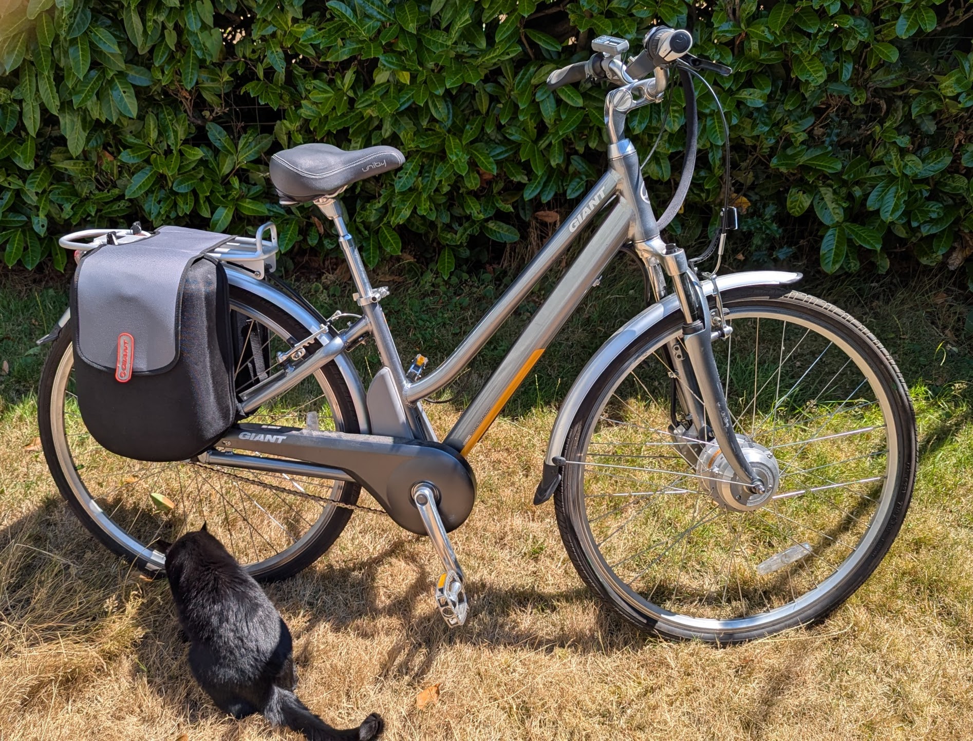

I recently purchased this 15 year-old ebike for $250. It's a Giant Twist Freedom DX W. Outside of one of it's 2 batteries being toast this thing is as if brand new. Figure it's a 2009 model.
I have been riding it around and it works really well, albeit it is slow. I guess back in the day, going the leisurely pace of a standard bicycle with a bit of electric assist was a novelty, and something that people would lay down $2,200 of 2009 dollars for. Who ever bought this hardly rode it at all, but thankfully stored it clean and dry.
I'm thinking of recelling the 2 batteries and keeping it the way it was.

A very nice find, and worth 250 bucks, You could probably rebuild the battery as a 28V12AH 9S-4P and have a little more power w/o blowing up the controller.

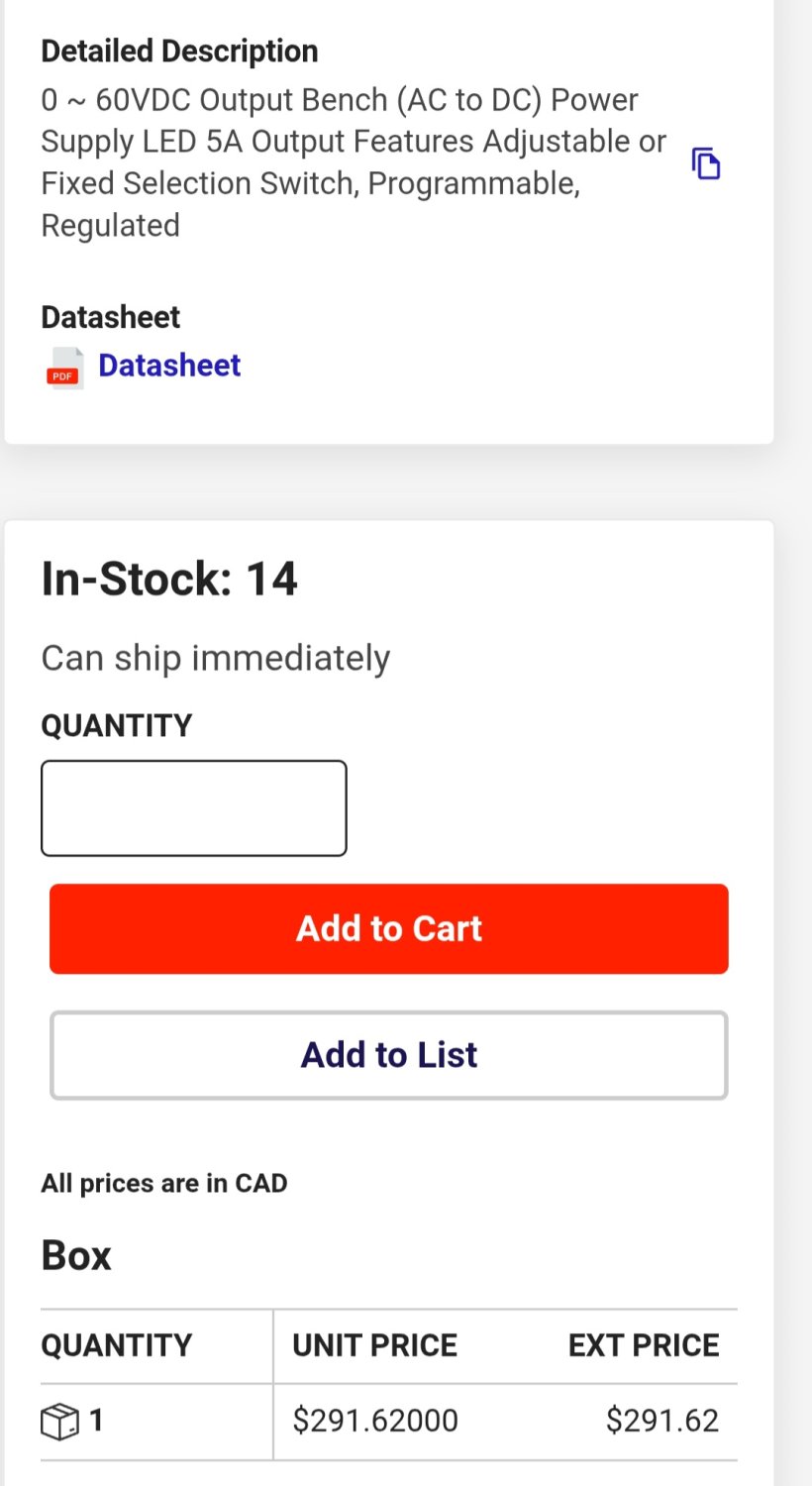

What about charging it ??
My bench power supply could do it, but are there any 28V chargers ?

Grin Satiator. I believe Gromike owns one.
The Grin Satiator is 4-5 hundred Canadian dollars. 💵
I have a $180 3 amp Bench charger that I use to stimulate and satisfy my batteries manually.
They seem to like it that way ??
My batteries are OK with the little 3 amps charge they get, but maybe the $291 5 amps version might really get their rocks off (or ovaries, ?? I don't know if my batteries are male or female, or if I should treat them differently??)

Seems the original batteries for this bike were 24v nominal.
The Satiator bottom rating is 36v, so no go.. But I do believe the current is variable on it so you don't need to pump all 5a into a battery if it is usable.
So is the correct charger for 6 cells in series? 25.2v full charge voltage?
edit:... a Google shows a 7S 5P configuration with a 29.4V charger.

It wouldn't be all that difficult to install a new controller and higher voltage battery. It's just that the design is so well integrated I'd hate to mess it up. As is, no one would desire such a slug. Nonetheless, it is enjoyable to ride.
