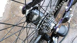

My experience is that a 6 or 7 spd freewheel will last twice as long as a 8,9,10 speed cassette,
requires less frequent adjustment, & are generally cheaper & readily available. I have yet to
break a freewheel, but cannot say the same for cassettes.

My experience is opposite that of John Peck. I had a 7 speed shimano come unscrewed & drop the balls on the road, leading to a 4 mile walk & bike push. It's a cheap design to dominate the $180 bike market. Threaded internal race has no lock feature, no locknut to countertorque, relies on a 5/8" long ferrule to rub against it from the outer nut. Would last the 250 miles the average $180 bike is ridden before the kid loses interest, but not the 2000 miles a year I ride. Could have been worse, I could have pushed the bike 30 miles. There is a replacement shaft with machined on race shown from "we the people" which is never in stock anywhere. Trying to install a locknut I bought 4 orders of random hex shaped junk the wrong size or the wrong thread. Finally I bought a 3/8"x26 tpi tap from victornet.com and suitable pilot drill, and made a ***-**** half-nut to lock the race in place. Took 2 years to repair that piece of ****.
I had a shimano 6 speed freewheel break the axle under my enormous 180 lb weight. I don't jump curbs or picnic tables. I don't know what they were thinking putting a 8 mm diameter shaft in there. Before the axle broke that bike dumped me on my chin twice. Gave it away to a guy who was arrested for driving a car with no insurance and a fake driver's license. He only rode it once that I saw, away from my house. The other times I saw him he walked.
I wore out a 5 speed shimano freewheel on a 1986 schwinn MTB. Tips of the 3rd gear wore off & started jumping links. By the time I wore out that bike, 5 speed freewheels had gone the way of the dodo bird. Bought the 18 speed diamondback MTB disaster reported above.
The 8 speed shimano cluster on this yubabike has been no problem, ~7800 miles so far. Wore out one chain ~5000. Don't know if is freewheel or cassette, haven't had it apart.

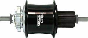

Reading this thread allows me to see how people think about the topic. It looks like people are attracted to having a wide range of gears. So, what if you could have a robust wide chain with thick cogs And have 27-speeds without throwing off your chain line? This hub works mathematically like a triple chainring X nine-speed but mechanically it is much more practical to run and you are less likely to drop the chain. I should make one. It is a three-speed hub for disc that gets an eight or nine-speed cassette. Sturmey Archer CS-RK3.
Reading this thread allows me to see how people think about the topic. It looks like people are attracted to having a wide range of gears. So, what if you could have a robust wide chain with thick cogs And have 27-speeds without throwing off your chain line? This hub works mathematically like a triple chainring X nine-speed but mechanically it is much more practical to run and you are less likely to drop the chain. I should make one. It is a three-speed hub for disc that gets an eight or nine-speed cassette. Sturmey Archer CS-RK3.View attachment 97478 View attachment 97479
i have a commuter/city e-bike with a 4 speed sturmey archer. fabulous concept, in practice it’s by far the worst thing about the bike. not sure if that’s because of the way they integrated it, the particular design of that model, or what. i haven’t heard as much negative feedback about shimano or rohloff’s versions.
in combination with an 8 speed RD, i imagine you’d use that particular one in the middle gear until you were on the smallest cog or two, and then you could jump 33%. ditto the other direction. practically speaking it would be the range of a modern 12 speed, which can of course be easily achieved with a 1x setup these days.
