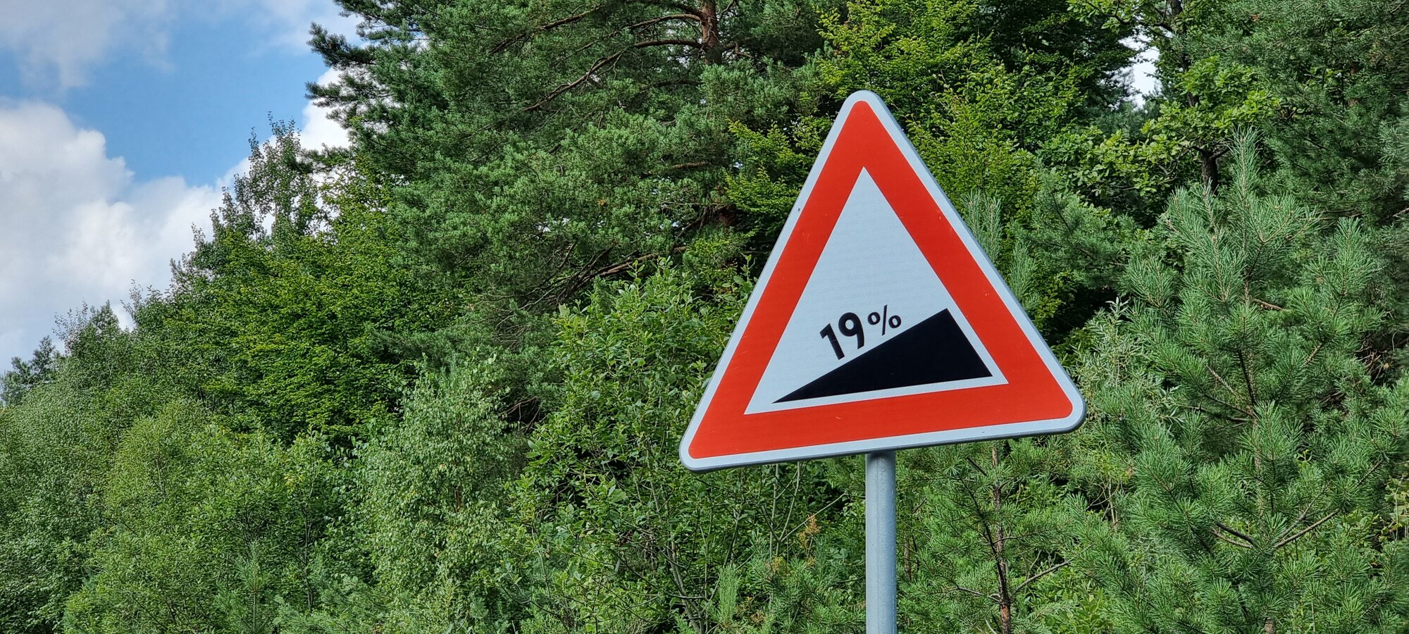

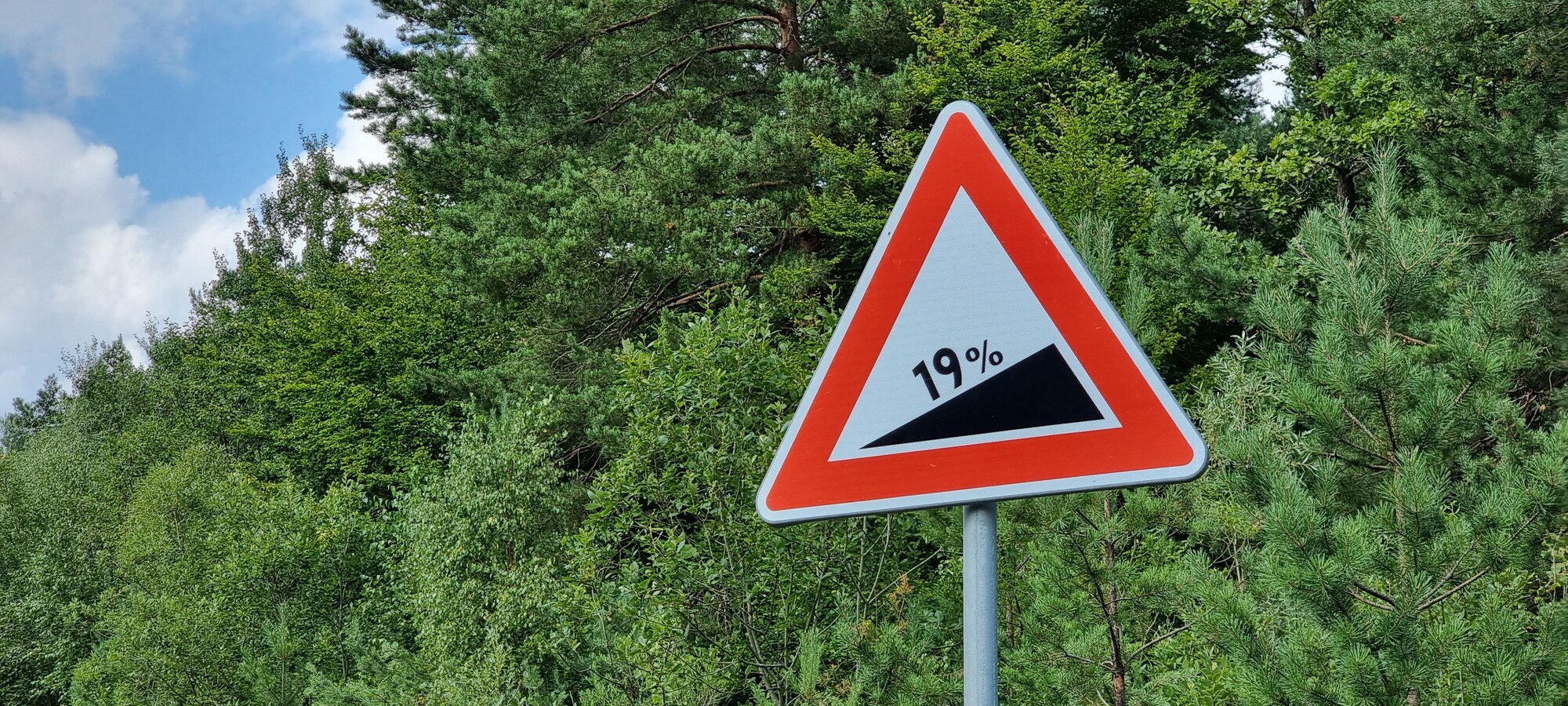

My hub drive e-bike has 24 speeds yet I wouldn't dare climb the 27% grade incline I climbed on the Vado today, and wouldn't even have tried that (also of today):
Bear in mind John 21 speed doesn't necessarily mean the same what you get from an 11 or 12-speed 1x drivetrain, as many of the 21 or 24 gearings are redundant or impractical due to the necessity to keep the chain line possibly straight. (Here, I stopped at the roadsign, then downshifted to the granny gear and continued the climb, upshifting as necessary).
