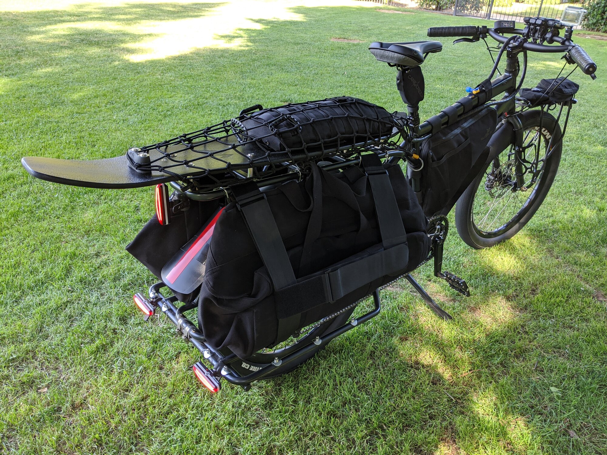

I like Matt's Mongoose Envoy + BBSHD project, a capable longtail cargo bike that can climb anything, I particularly appreciate his section on low-cost builds that lists wallet-friendly ideas. If like me you are not good at soldering consider crimping, I've had good results. If you would like to compare the performance of mid-drive motors against the RadWagon's G60 hub motor you can change the settings in Justin's motor simulator from hub-drive to mid-drive and you will find the BBSHD and BBS02 on the list.

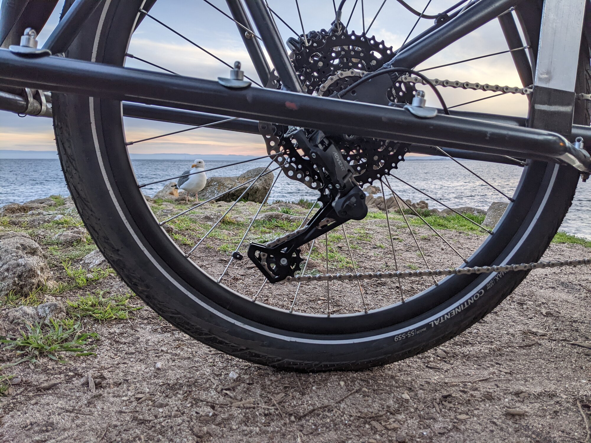

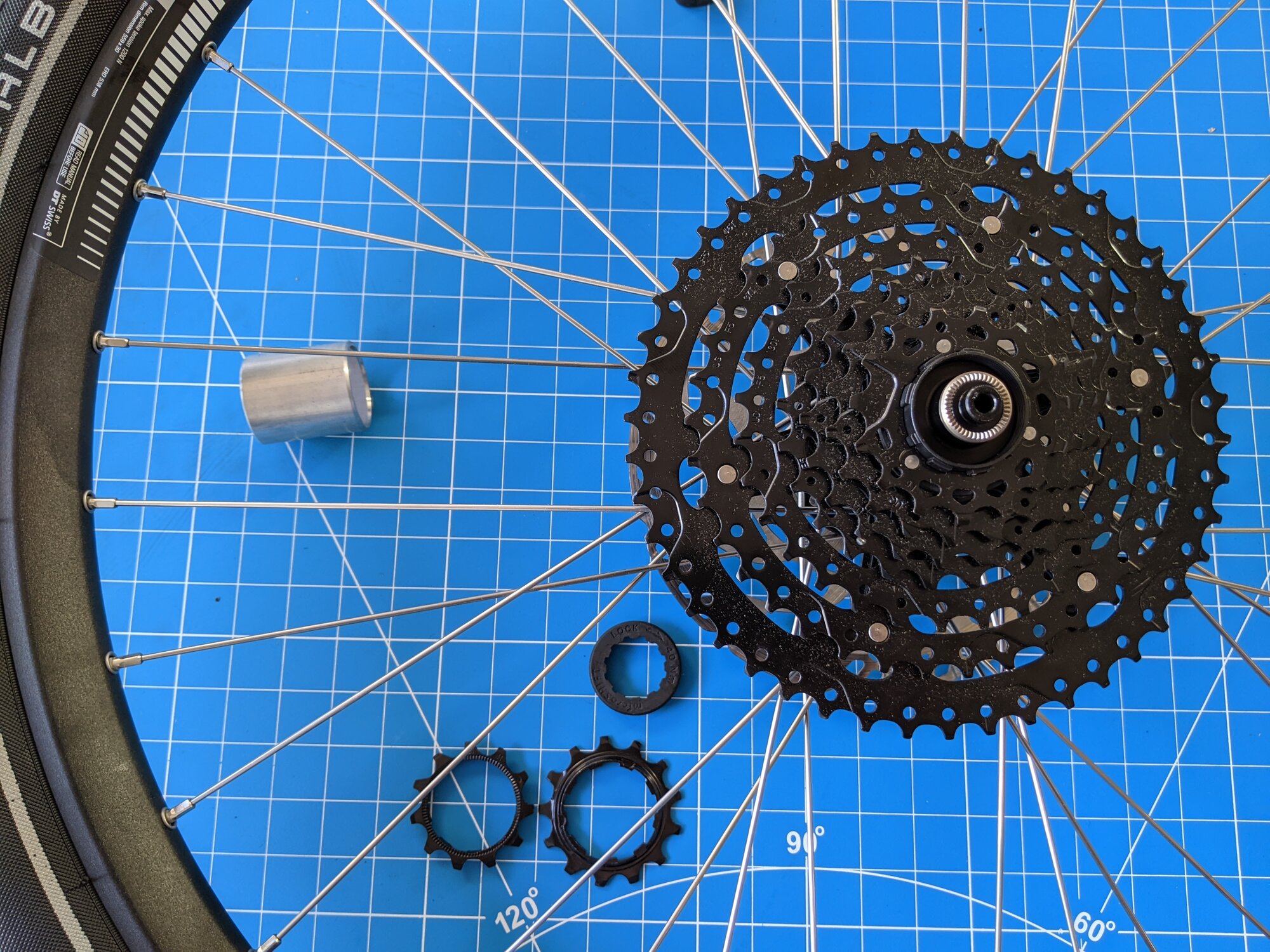

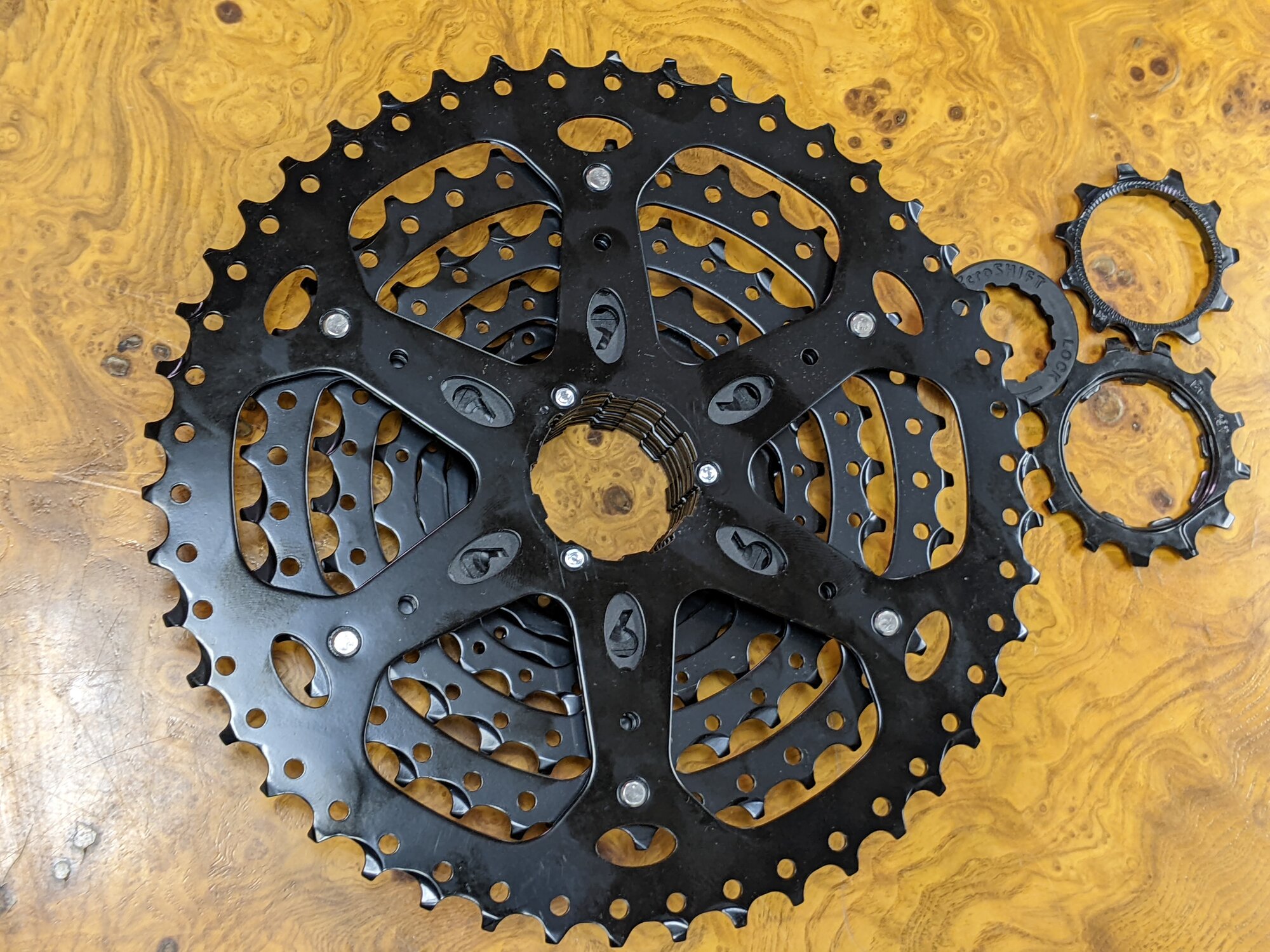

I was looking at that build page last night and I need to do a follow-on for 2022. Prices have changed and new equipment has come on the market. I recently put on a dirt-cheap Microshift Advent 9-speed derailleur (the long cage version), cluster and shifter for about $135 total. The 11-46T all-steel rear cluster makes a nice bump up in hill-climbing ability and is tough as nails. I almost never use the big 46T cog as its literally too big unless I have a full grocery load, but the ones near the middle - where the best chain alignment is for no extra wear on anything - are now bigger and my ability to get up hills is noticeably better as a result.
I liked the cluster so much I used it on the Apostate full suspension bike I just finished. It works fine with the Box Two derailleur.
Lookit: hardened steel and pinned together to boot. $35.99 @ JensonUSA. Compare that to a SRAM EX1, tool steel and also meant for ebikes ... thats over $400.
