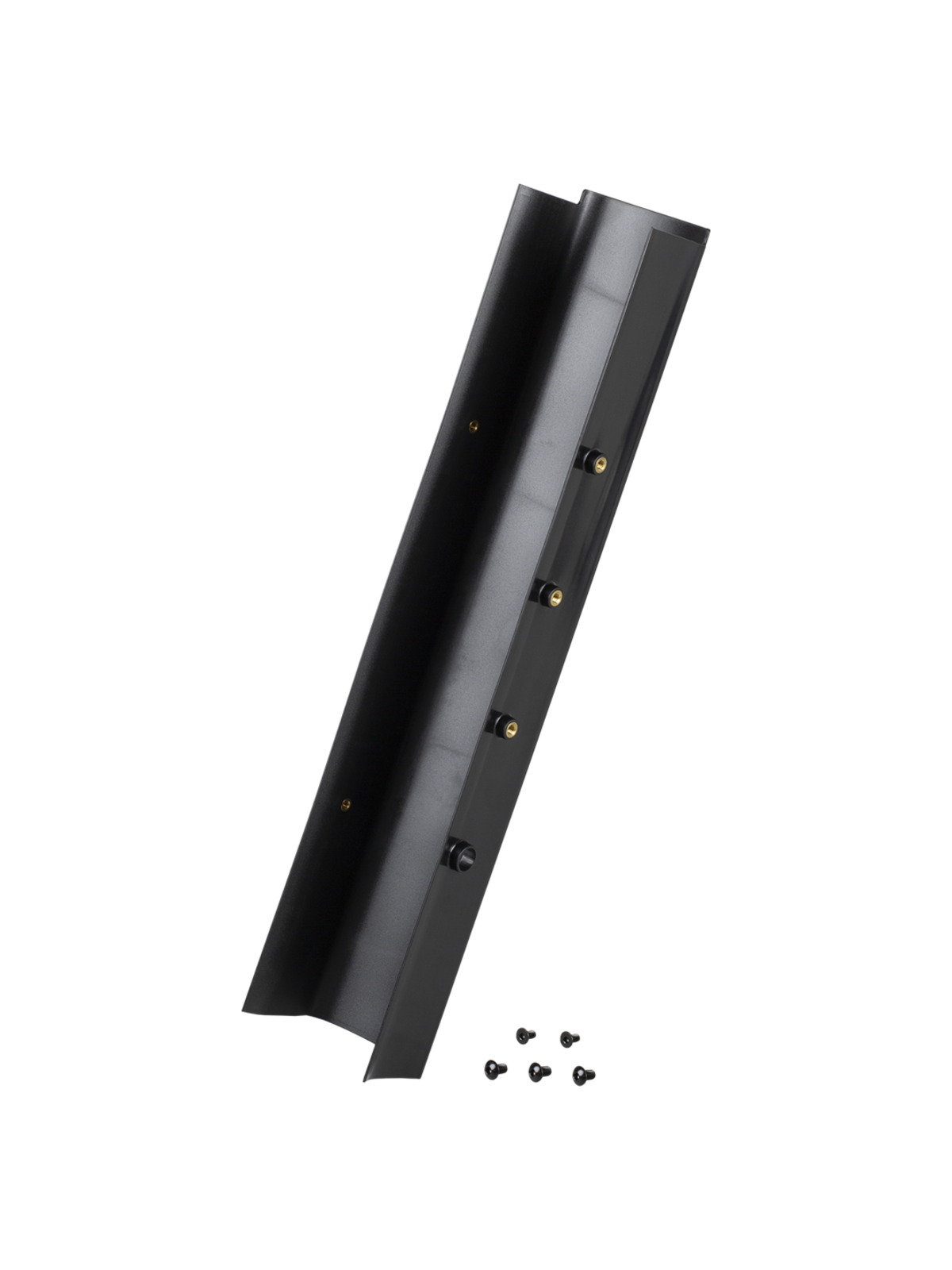

Does anyone know if this would work for that purpose:
It may be that this only fits the Allant+ 9.9s carbon frames and not the lower model aluminum frames. The product title specifically indicates Allant+ 9.9s.
If that would not work, it would be nice if Trek made a clip in version of this:
But for WAY less than $90! :eek:
Without a clip in version of the battery cover, it would probably require purchasing a dummy powertube 625 battery from Bosch (at a mere $100!! :eek:) and then attaching the battery cover to the dummy battery. Here's an example of a dummy battery:
A potential solution (if Trek makes a battery cover that fits)....but at $190 USD all in, it is certainly not a practical solution for what is essentially a simple dust cover to protect the battery contacts.
I agree we need a reasonable battery port cover. I wonder if the product in the first link would serve this purpose. At $25 USD that is certainly a bit more reasonable.
Good finds but I don’t know how you’d attach the cover or if it would be waterproof. Not sure the dummy bat would work with the battery key lock. And I’m sure not spending $190 for the cover/dummy battery combo.

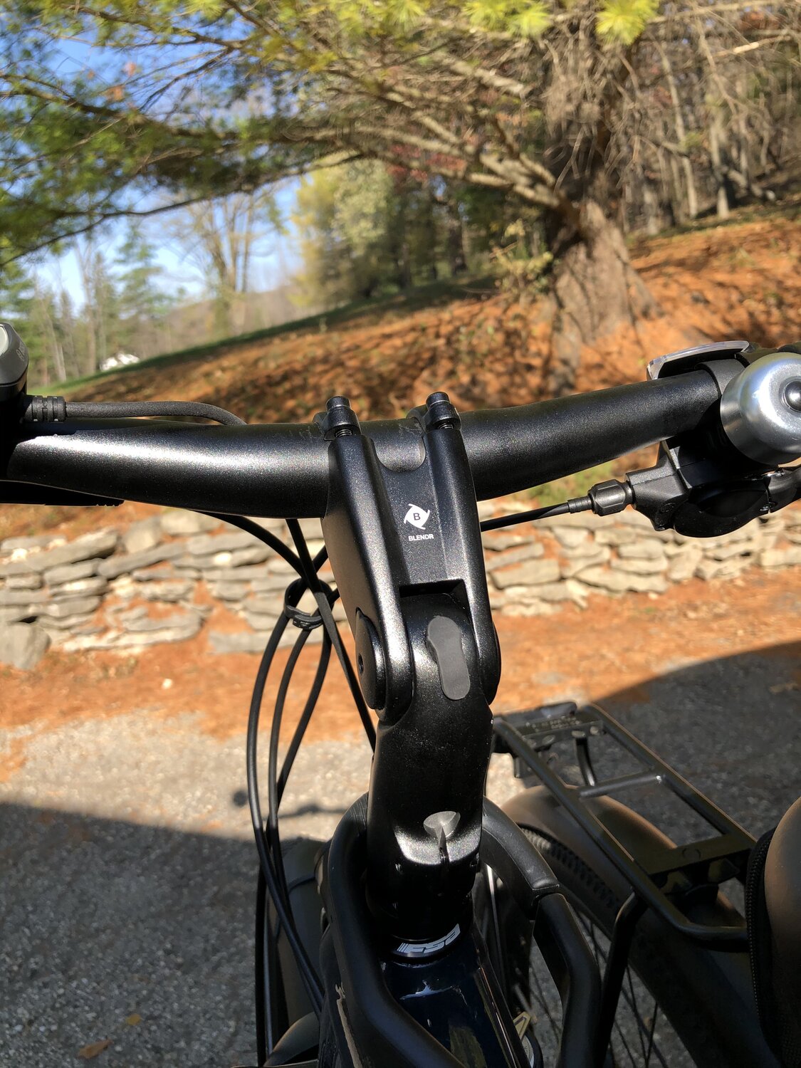

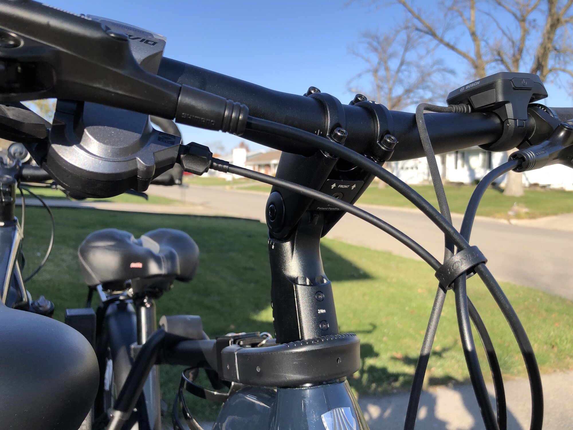

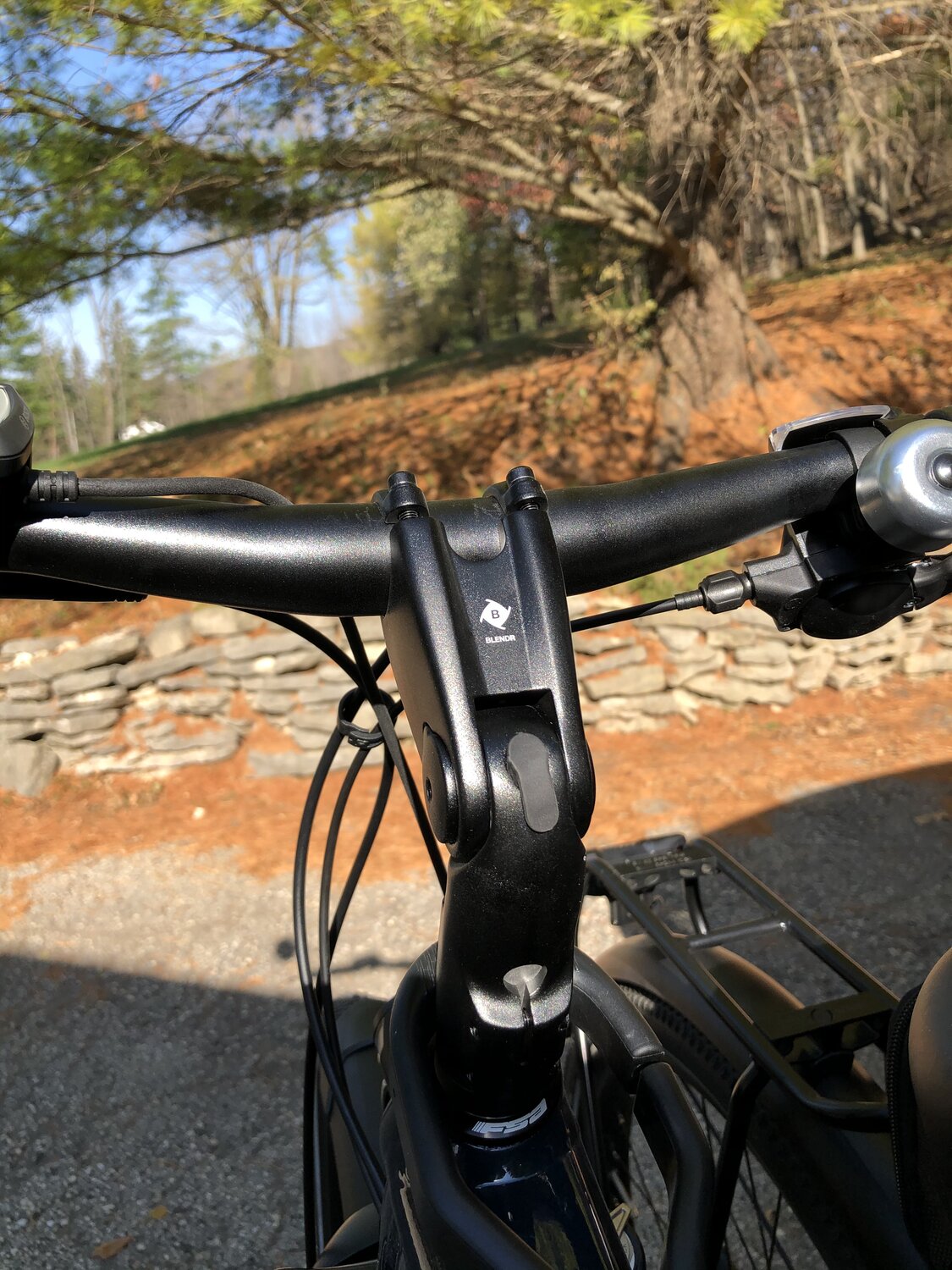

YES, the stem can certainly be replaced without replacing any cables. Show your Trek dealer this picture of the stem from my wife’s Allant+7 Lowstep. My Trek guy said it’s a Bontrager stem that only dealers can get, which makes no sense to me. The adjustment could have gone higher but the front brake cable may have had to be replaced/lengthened, especially for times when turning hard. We used the original handlebars and using longer/higher ones in combination with that stem might again require replacement/lengthening of the cable(s).
My wife loves it and says it perfectly replicates the upright ride of the Verve+3 she test rode. The Trek guy threw it in with the deal and kept the original stem.
BTW, great choice on the Allant+7! The Verve+3 is a great ebike but the +7 with the better CX, shocks, tires, and frame is just a more complete package for where we want to ride now and into the future. 😎👍
