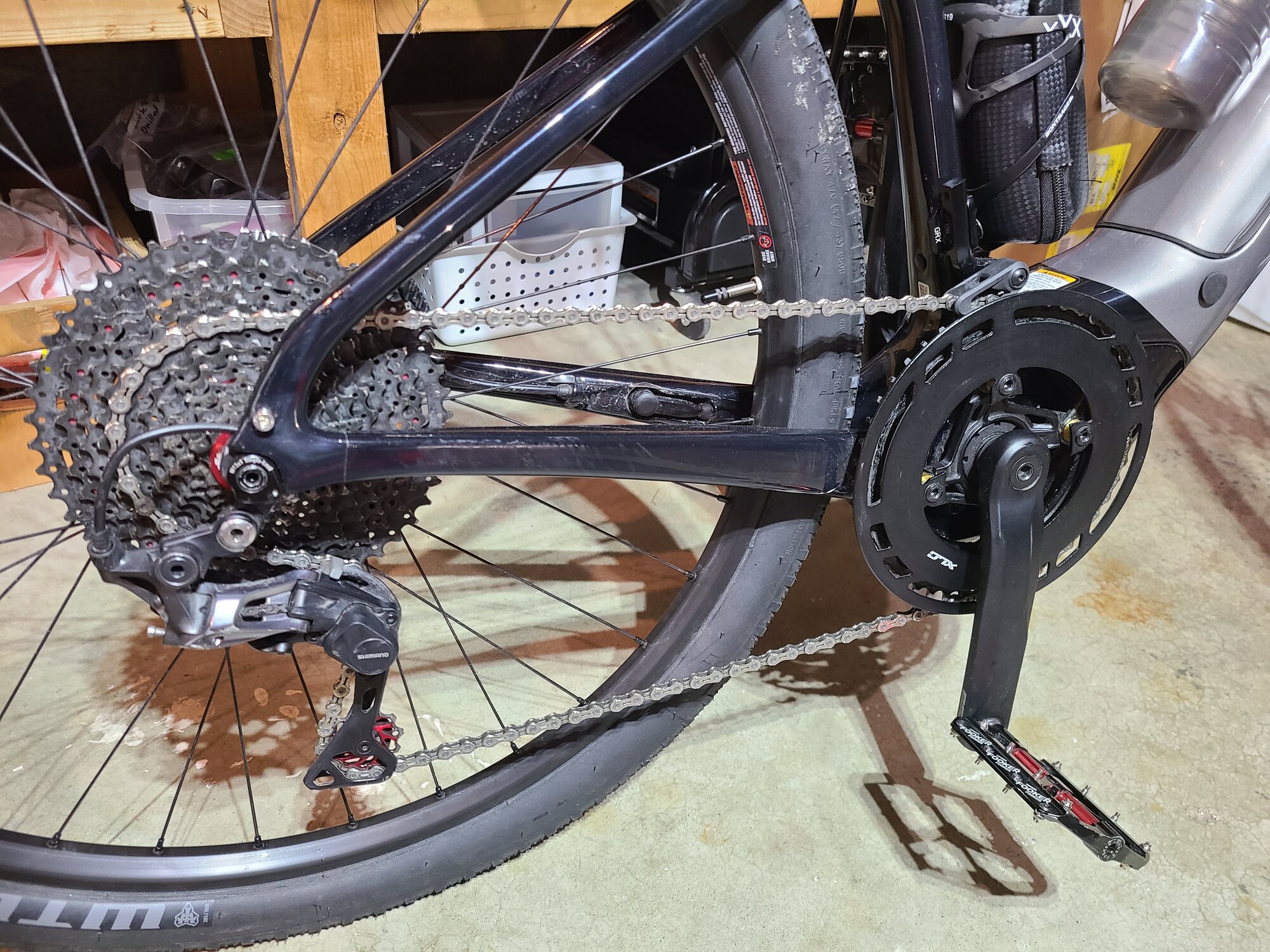

I replaced the 44 tooth front chain ring on my Cannondale Topstone Neo Carbon 3 with a 48 tooth narrow wide chain ring without permission or altering anything in the motor settings. The bike has a gen 4 Performance Speed motor. I have been riding the bike for more than one year with 3,200 miles on it without a hitch. I got the reduced cadence I was looking for in the 11 tooth cog, spinning at 72rpm at 25 mph.
I have had the firmware updated without issue. I did check with Bosch first and was told that I might have to have the settings changed to accommodate the larger chain ring but I might not. In fact, it needed no tweaking and worked great right from the start. I also went from a 11-42 OEM Shimano Cassette to a 11-46 tooth to recapture the lost lower end, even though the spec from Shimano on the GRX derailleur was not supposed to go bigger than 42 teeth. An adjustment to the B screw and it has worked just fine for over 3,000 miles.
Thus, despite the published limitations of both Bosch and Shimano, I did what I wanted to expand the drive train on my bike without any complications, objections, error codes or issues.

... it needed no tweaking and worked great right from the start. I also went from a 11-42 OEM Shimano Cassette to a 11-46 tooth to recapture the lost lower end, even though the spec from Shimano on the GRX derailleur was not supposed to go bigger than 42 teeth. An adjustment to the B screw and it has worked just fine for over 3,000 miles.
Thus, despite the published limitations of both Bosch and Shimano, I did what I wanted to expand the drive train on my bike without any complications, objections, error codes or issues...
this makes complete sense when you consider that 1) the motor has no idea what gear the bike is in with a mechanical drivetrain, and i'd be quite surprised if they made that integration even with an electronic shifting drivetrain like di2, and 2) the load on the motor varies wildly by factors other than what gear it's in - hills, weight, wind, speed, which would make a system that was so sensitive to load that it had to be reprogrammed for a 10 or 20% variation virtually useless.
the stupidity here is not that the system requires the motor/firmware to know anything about the chainring, it's that bosch claims it does, when clearly it doesn't and can't, at least within reason. they probably just don't want people doing dumb s*it like a 55t time trial ring with a 9t small cog and then try and grind up a hill at full power, stalling the motor, their legs, and falling off and dying. 😅
Didn't @Marci jo experience error codes when she replaced the chainring on her Bosch Trek?
Stefan,
Based on the opinions of the Bosch members here and the mechanic at my lbs, I did not change the chainring on my Trek. It’s still 38 teeth. I still may try it. Right now my class one Trek ebike is the one I use for group rides, sometimes as many as 20 riders tightly grouped together. My groups are slower pace, stop frequently, and talk all the time. And they know the all best places to eat!
My Trek is 45 lbs (20.kg), making easy to haul to the various locations. And has 50 nm of torque, so unlike a hub drive, the acceleration is as gentle as I choose. No smashing into riders ahead of me.
Based on Alaskan’s post I still may go ahead with perhaps a 42 or 44 tooth chainring. In the event the motor does shut off, the bike rides like a non-power hybrid bike, doable but no so much fun.
Stefan, I did not change the chainring on my Trek. It’s still 38 teeth. I still may try it. Right now my class one Trek ebike is the one I use for group rides, sometimes as many as 20 riders tightly grouped together. My groups are slower pace, stop frequently, and talk all the time. And they know the all best places to eat!
I'm very interested in the outcome of your test!
