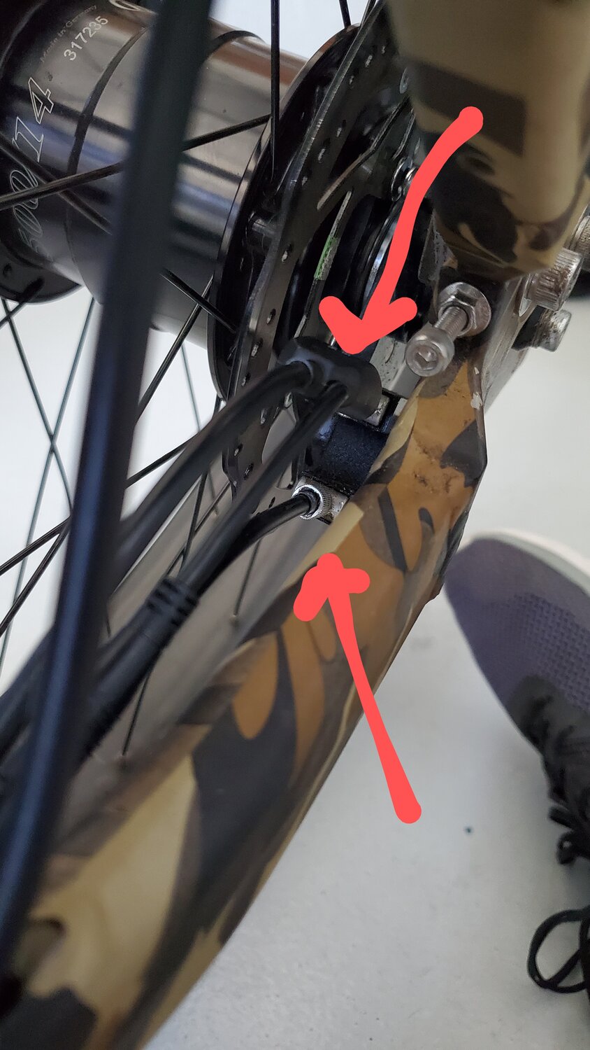

I'm experiencing a problem where my pedal assist and throttle stop working intermittently. The display is lit and the batteries are fully charged but suddenly I'm pedaling without any assistance. Sometimes it will restore itself by turning the power off then back on, but not always. I'm sure those of you that own this bike wouldn't want to be without the motor when you are miles from home, but I've had it happen twice now. The cables are fully connected and the bike has 50 miles on it. Does anyone have any suggestions?
The bike comes with a motor cut off when applying the brakes and I believe, when shifting. The motor cut off connection is in line with motor cable near the motor and it needs to be unplugged to remove the rear wheel. I bet that connection is the issue ...

Is this what you are referring to? The top plug with 2 cables is labeled shift sensor and the barrel connector was very loose. I thought tightening would solve the problem but 2 minutes into a ride I again lost pedal assist and throttle. Leili is suggesting I disconnect the brakes and test it that way. What do you think?
No, the inline connector I was referring to was the one you use to disconnect the motor when removing the back wheel. Leili's suggestion of checking the brake sensor at the brakes is a good next step. Sorry but I don't have the bike anymore so I'm relying on my 70 Y/O memory and it's a little foggy.

For anyone following my situation with the motor disengaging, I am closer to a solution but not there yet. There are 2 cables coming off the right brake lever. The thicker one I assume is the hydraulic fluid and has no connectors along its path. The second cable I believe is the brake sensor. When I disconnect it, my brake seems to work normally and the motor no longer disengages. I'm trying to determine why the brake sensor is causing the motor to disengage.
It probably is just faulty. I saw some Youtube videos which suggest that might be the problem. Might have to replace. Just the luck of the draw unfortunately. I hope you get it resolved soon and post.
