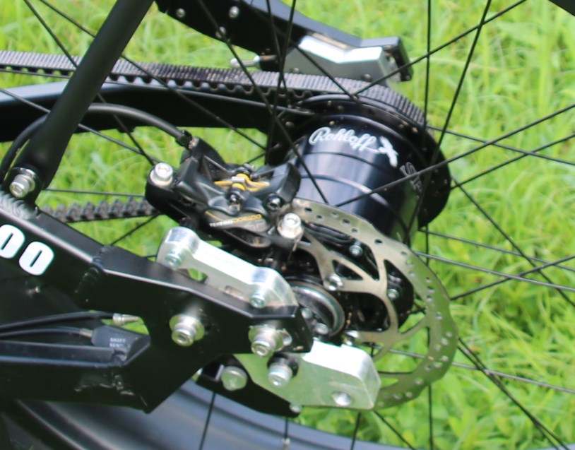

Just to double check before I contact the supplier to change it to 190mm, they said theyd put in a 197mm dropout idk if that makes a difference. Also why do you need a 190mm vs 177mm would it not align correctly with the front cog?
from what I found 190 and 197 is the same thing.... Just depends on where they measure it from. Anyways the 190 mm speed hub is what you need if you want to put it on the md1000 so that it fits in the dropouts properly. And yes the gates 22t needs to line up properly too
This is the exact model, it looks like I would need to get the e-14 addon separate. Can you retrofit the e-14 onto the MD1000 with the rohloff 500/14XL?
Short answer, no you can not retrofit an E14 to a non-Bosch (perhaps one other brand) powered Ebike. This is unlikely to change in the near future. The IGH KOOB referenced is the one Leili provides on the MD 1000. They told me they ordered 50 and have sold 35 MD1000's equipped with the Rolhoff 14. If ordering new, I would definitely go that way rather than doing my own retrofit ... it's cheaper for one thing and no bloody knuckles. :)

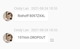

Ok I am just double checking with the vendor but the 8097ZXXL is in fact 190mm, when I was searching "8097ZXXL" on google it showed "8097ZXL" which is 177mm. I am fine with a manual rohloff, Ill just be very careful.
Confirmed its 197mm with the vendor.

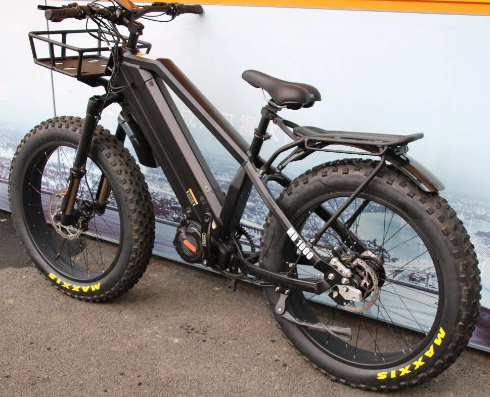

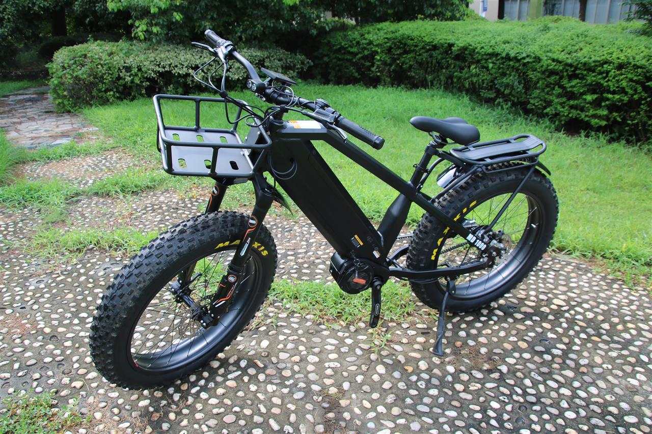

pictures if they havent already been released.

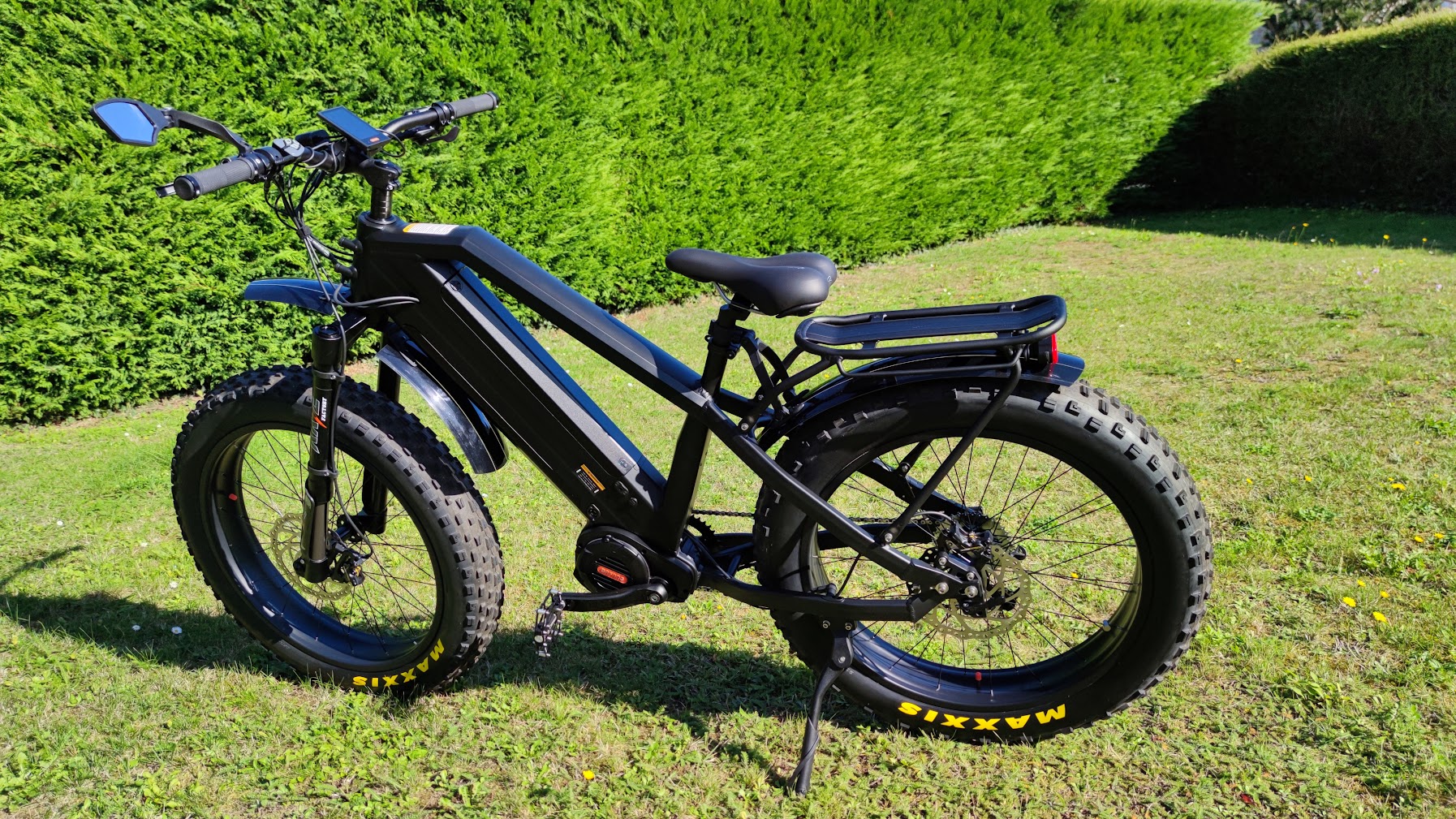

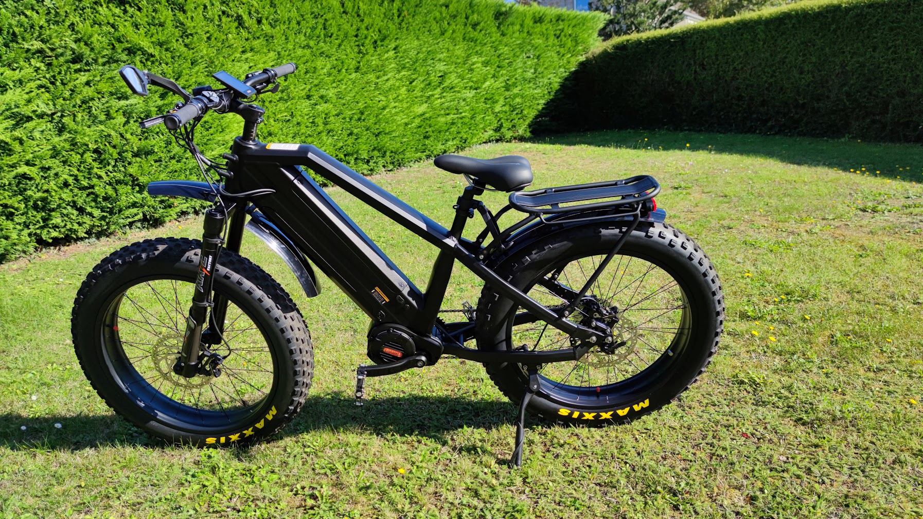

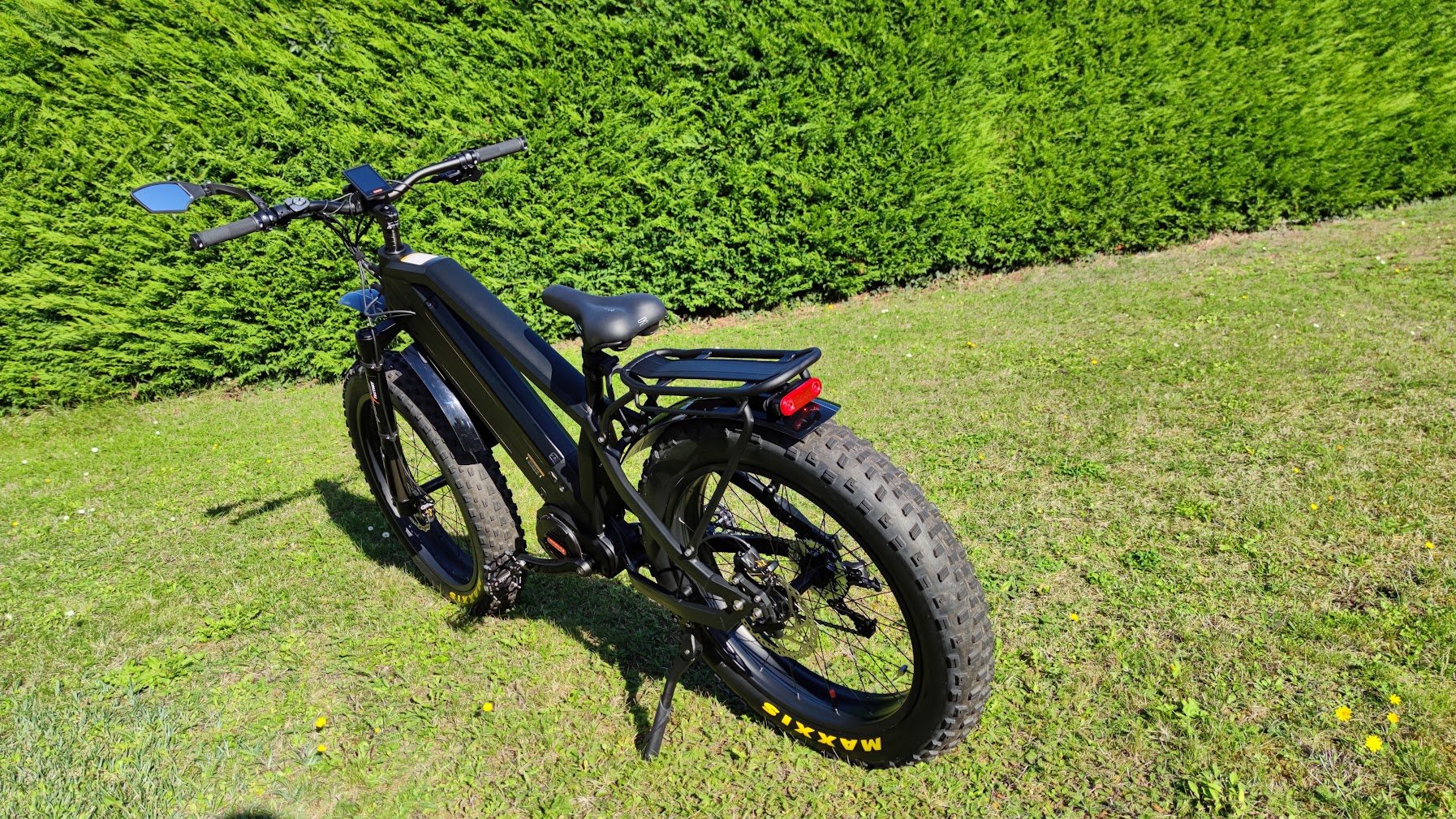

Voici Terry quelques photos de ma MD 1000 enfin récupérée après les problèmes de ma jante abîmée le changement du BMS sur les batteries et l'axe de moyeu cassé, je vais enfin pouvoir rouler avec et en profiter... J'espère tout ça va pour toi Terry ?
Does that light function as a brake light and what brand fenders are you using? Can you give information on the parts?
I noticed these fenders online and I bookmarked them as they look like they would fit the bike and keep the water from splashing on your front and backside.
Fat fenders
