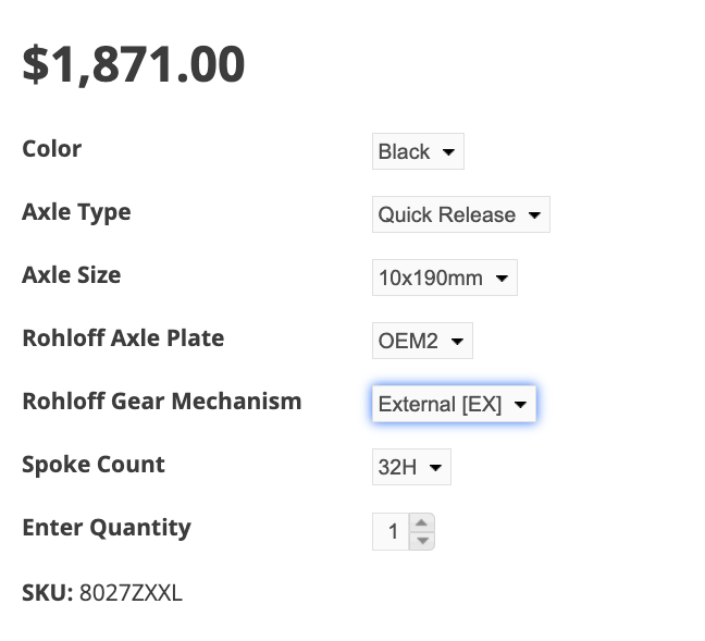

This is the exact model, it looks like I would need to get the e-14 addon separate. Can you retrofit the e-14 onto the MD1000 with the rohloff 500/14XL?
that will not work 177mm too small... you need this:
Speedhub 500/14 CC DB OEM2 XXL, black anodized,
32H
- 190mm Fat Bike Version
with
