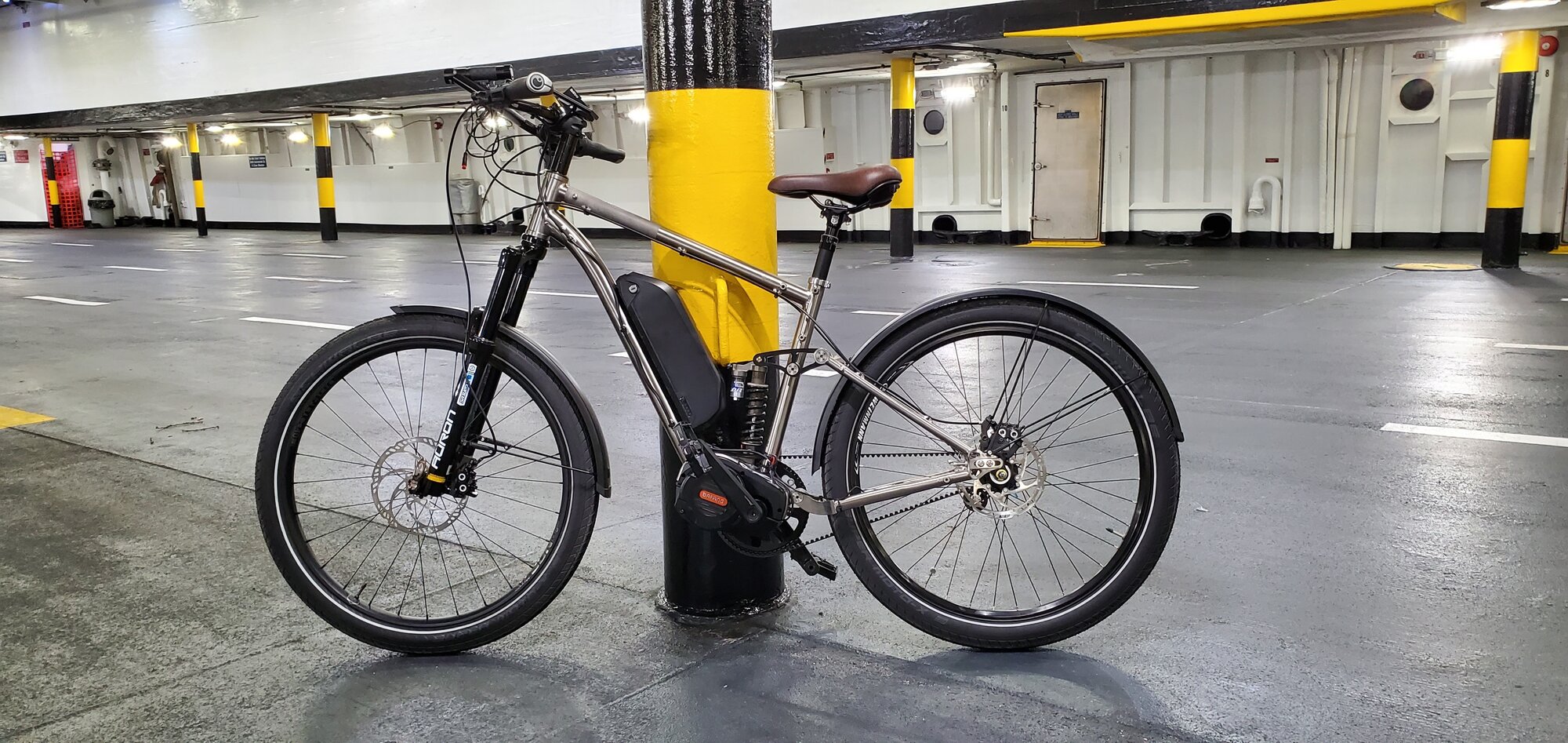

We have done 4 things
1. True full suspension, in titanium.
2. You can put up to 52V, 21Ah battery on board, no problem.
3. We have belt drive on it.
4. ASTM level 3 certified.
The bike can be made in Trail or Commuting geometry. This picture below is with commuting geometry, and has mounts for Rear rack and fenders!

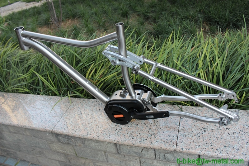

I'm sure if you asked, these people will be happy to make you a real rack, out of Ti for a Ti FS bike that will clamp on to the frame, rather than the un-sprung weighted swing arm. One attachment at the seat-post, the other two at the seat-tube.
They also make an FS Ti frame - and it may well be the same geometry. I've include photos elsewhere.
https://www.alibaba.com/product-det...offerlist.normal_offer.d_image.1d175eaeCBAIet
