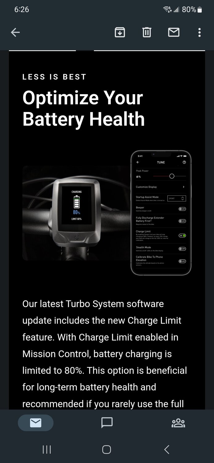

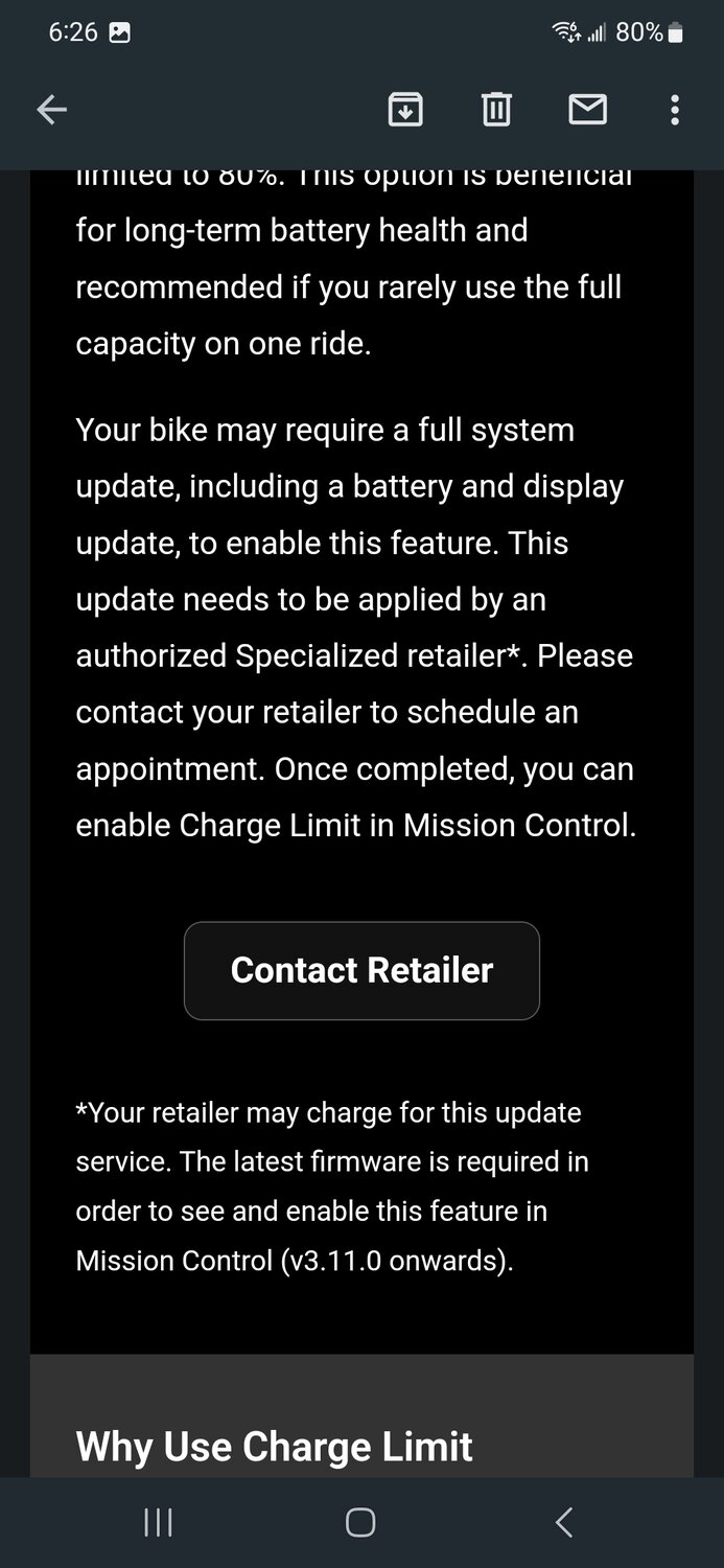

Interesting. I just got an email about it. It says it can only be done by a dealer and that they may charge for it. It's interesting that they put that caveat in about dealers charging for firmware upgrades. Pretty BS. Definitely won't be getting another Specialized bike if they try and charge me.
