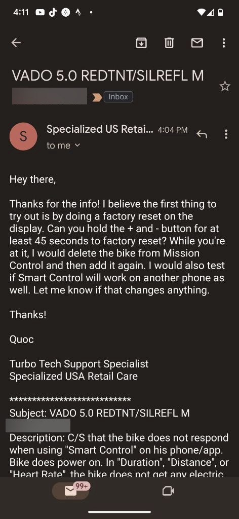

So, I went to ANOTHER dealer, he put a claim in and in 1 day the response was (I posted that in another thread, but here it is again), and yes, I did that process several times to no avail.
*sigh* It is quite obvious to me that Specialized support and warranty department is built around a parts replacement strategy. This makes a ton of sense pre e-bike. Mechanical problems will typically be straight up parts replacements. Furthermore, they seem to heavily depend on the LBS diagnostic skills, which again, makes sense on purely mechanical bikes.
Specialized seems to still be stuck in mechanical world when supporting ebikes. Software is hard. Version controlling software is harder. Doing these things in the confines of something like the apple app store is an art form. Wrapping that around electronic parts that may not be working correctly creates a huge range of variables to isolate and prove.
Specialized is particularly bad at this. If you ever need specialized for anything other than shipping out a part: good luck.

Well....here is the latest.
I followed the info as provided in the screenshots that I posted/supplied from Specialized.
I deleted the app (Mission Control).
I reset the display/head unit. (held +/- 45 seconds)
I removed the previously associated bluetooth device on my iPhone (it would not 're-pair' until the previous association was removed).
I redownloaded Mission Control and authenticated.
I added the bike with my account.
I set the time, date, etc, etc.
I activated 'Smart Control', still acts the same way, no 'Smart' assistance, slug, 10% max assistance no matter what slider controls are set to.
My question is, was and will continue to be, can the firmware be a problem, and as a troubleshooting step, if it could be "rolled back" to validate that yes it is or no it isn't to either resolve or move forward with the oddity of the functionality of the 'Smart Control'.
Also, if others who have/use Mission Control validate it works for them or not ((Smart Control) and what firmware revision they are using on the display, the motor and the battery.
