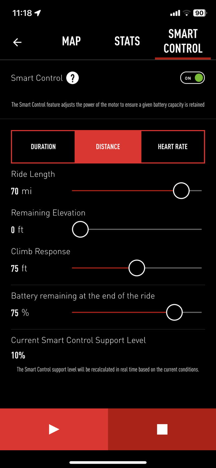

LBS said come on down, we'll do test (yesterday/Vado SL), we did it (paired my iPhone with the SL), then Smart Control immediately showed its "normal" screen (not the "you know something is wrong if it looks like this" (photo below) [meaning, when you slide the Smart Control ON, the DEFAULT OUT OF THE BOX settings are as displayed. AND, no matter what you do to try to "slide" any of the parameters (Distance/Duration/Heart Rate, Ride Length, Elevation, Climb Response, Battery Remaining at End of Ride, etc., etc.), "Current Smart Control Support Level" NEVER EVER goes above 10%.
This inhibits any riding as if you were pulling a 200 pound sled of rocks.
Again, no matter where the settings get set, the assistance level is always 10%.
With that being said, NORMALLY, in the past as well as yesterday, any parameters changed as in the references above automatically adjusted and changed the display of "Smart Control Support Level".

70 miles with 75% battery charge remaining means 10% assistance. What happens if you enter 10 miles and 10% battery left?
