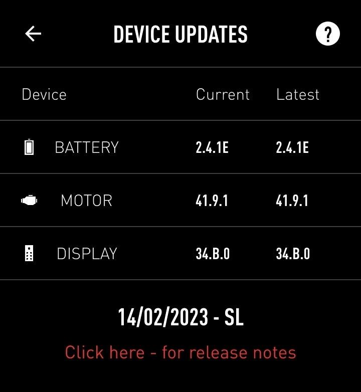

Is this what you are talking about? I can still access this information under "Diagnose"
@GrayFox: Wait patiently until the 14/02/2023 - SL text appears. (I think that reading the version numbers from an SL e-bike takes a long time).
Note: I could not get the version numbers with a Range Extender connected!

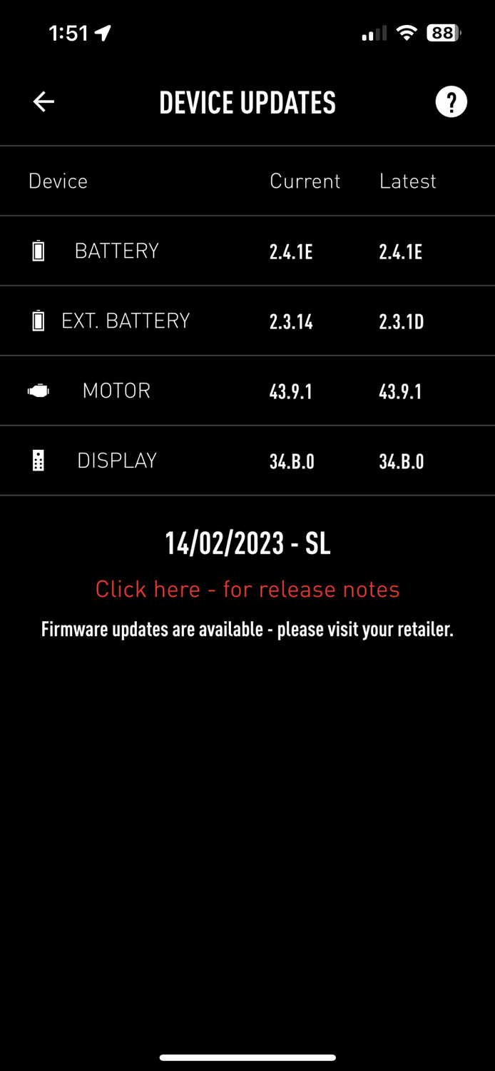

Indeed, when I disconnected the range extender the device updates page was populated. Of course there was no info displayed for the range extender. ( Not even the name).
Thanks for the fix...
Evidently a newer version of Mission Control was released a few days ago. It seems to have fixed the problem of not showing the device firmware versions...It looks the shop did not install the latest Range Extender firmware...

Thank you @GrayFox! It has started working for me, too.
II have different (older) firmware for the extender battery and the motor but I think I do not care anymore!
