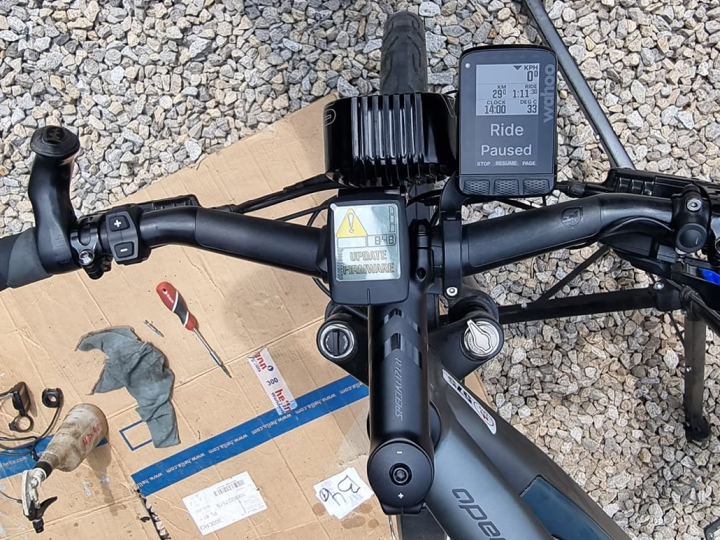

My stock Vado controller/display had its base damaged. I had to relocate the display from the original integrated stem mount to an external Garmin mount. I had to temporarily fix the old display to the Garmin mount with a strong tape to be able to ride the Vado!
The L1E Turbo Control Display (wired) for Vado 6.0 is a unique part (part number: S196800024) that acts as a "dongle" to activate the Vado 6.0, or enable its electronics to work. The display is different from any other TCD-w as it has the speedometer hard-coded for each of its 5 display pages; it is the requirement for any European 45 km/h Speed Pedelecs. I could have ordered that part from several online stores but managed the order through Specialized Warsaw (the price was even tad lower than online + shipment; and the LBS is fond of me!)
The product comes as the display connected with the new handlebar remote, and a set to attach Gorilla Glass protector to the display screen.

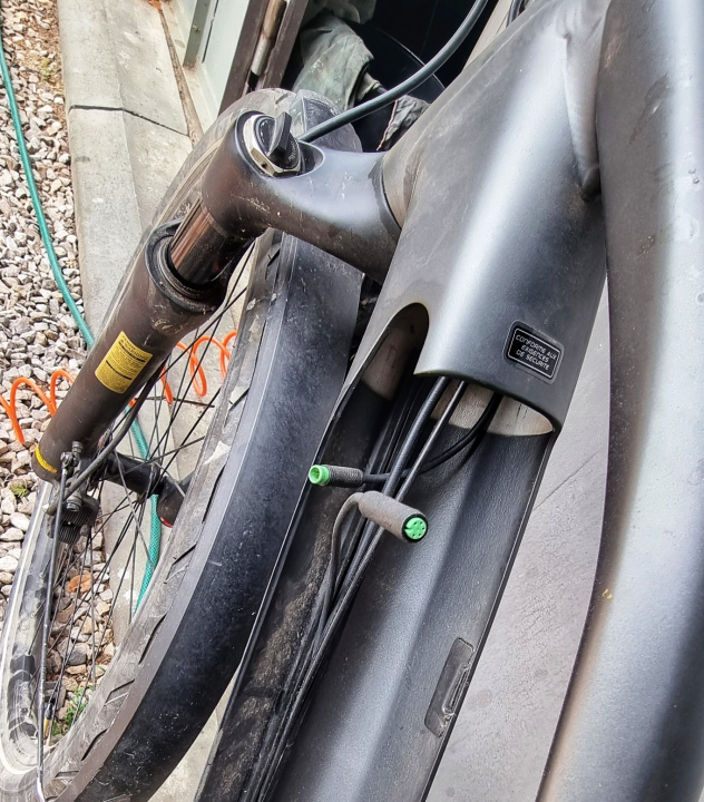

To access the kit connector, you need to remove the battery lock assembly, and ideally, the fork from the head-tube. Fitting the new handlebar remote requires removing all components from the left handlebar of the e-bike.
The protecting film on the display reads: 'UPDATE FIRMWARE'. It turned out to be important soon...
As the outcome of the display kit swapping, the Vado has become fully operable but... its functionality turned to something such as Bosch Purion... no, Intuvia Although everything worked, neither Mission Control nor Wahoo could "see" the e-bike! The Bluetooth pairing worked but the e-bike Bluetooth name was a long series of 000000... instead of the bike serial number! No possibility to use Mission Control, which is the whole essence of the premium Specialized electronics! I decided to ride to Specialized Warsaw on the first working day.

Firmware Update
The L1E TCD-w kit was also equipped with an "anti-theft plate", so the display could not be removed just by a quarter turn. I was glad not to install it! Because the Specialized man could easily remove the TCD-w from the Garmin mount and then apply the firmware update with Turbo Studio and a USB cable easily. After the update, my Vado started be seen by the Bluetooth and LEV ANT+ world as designed!

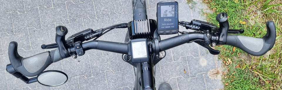

The latest version of my Vado 6.0 cockpit.

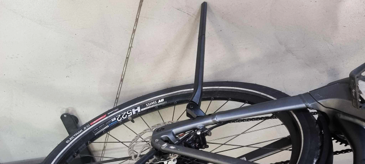

Specialized Turbo Kickstand
Oh. On one of my recent rides, I let my Vado fall, breaking the original kickstand. With a 26.4 kg (58 lb) e-bike, lack of the kickstand makes the Vado hard to handle! I asked the sales assistant whether he had the kickstand in stock, and yes, he had it! (Not the most expensive of the Specialized-ware)
It was the last part missing!
