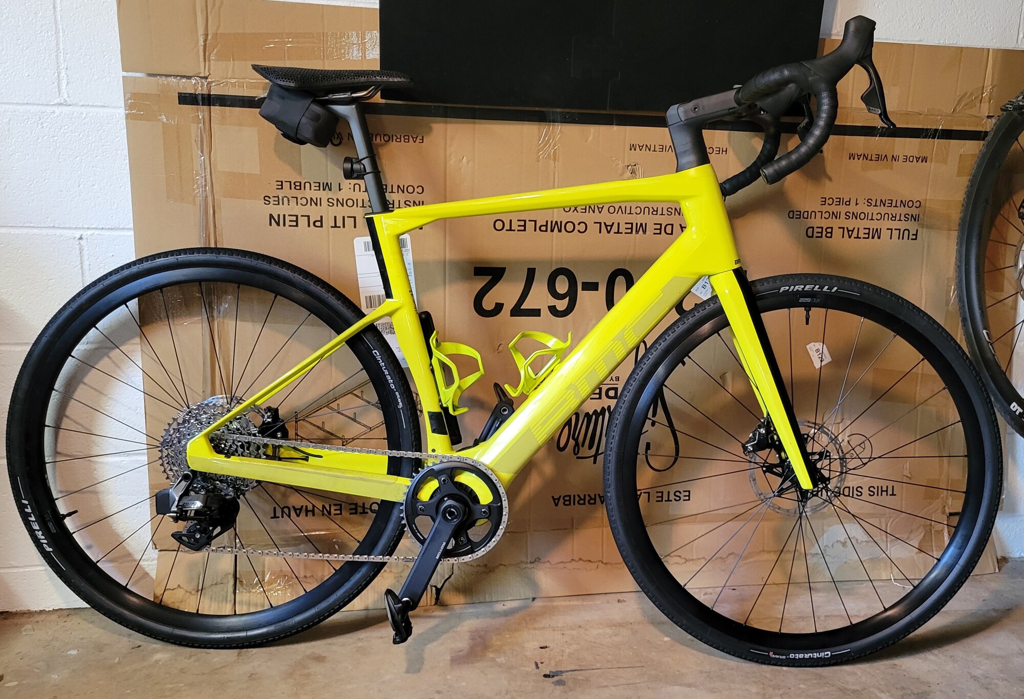

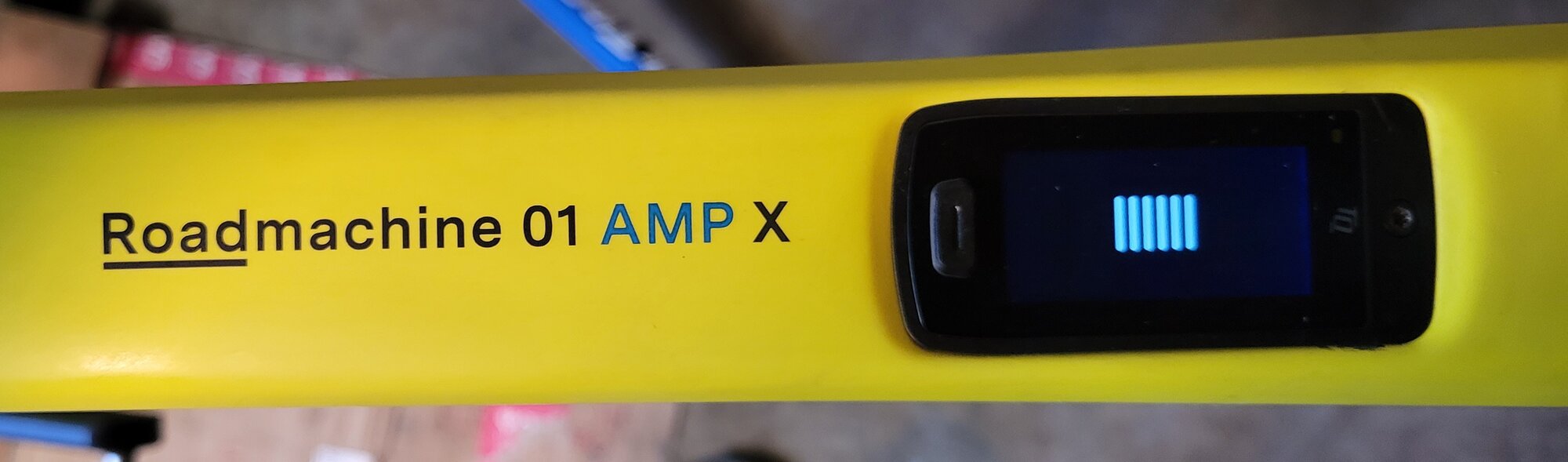

After having two separate BMC Roadmachine AMP Two bikes that both had Mahle X20 system failures that were not resolved, I upgraded to the BMC Roadmachine 01 AMP X TWO USA last Thursday. My first ride was this last Saturday and 23 miles into the ride, the TQ-HPR50 system died with 97% battery life remaining! No display, integrated taillight or BT connectivity and I wasn't engaging the assist yet. I was surprised at the 3% battery usage in 23 miles with only the intergrated tail light and BT on. After the ride, I plugged the charger back in and still no display or response from the bike. But, even though the rear light was not lit, it got very hot!! I suspect the tail light unit shorted it. I believe that is a BMC component and not a TQ one.
Aside for the system failure, I do want to keep this bike as the fit, comfort and wider tyre capabilities are what I am looking for compared to the BMC Roadmachine AMP TWO.
I'll updater this thread once I hear back from the bike shop with the resolution.
UPDATED: July 12 2023
TQ support quickly sent a replacement display unit and noted that if the issue continued, they'd also ship a battery unit. The original issue hasn't returned after replacing the display. I also asked the LBS to remove the integrated rear light at the same time. I am convinced the issue was that rear light shorted.

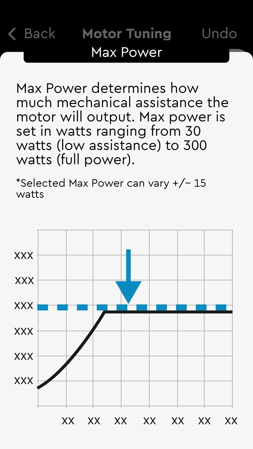

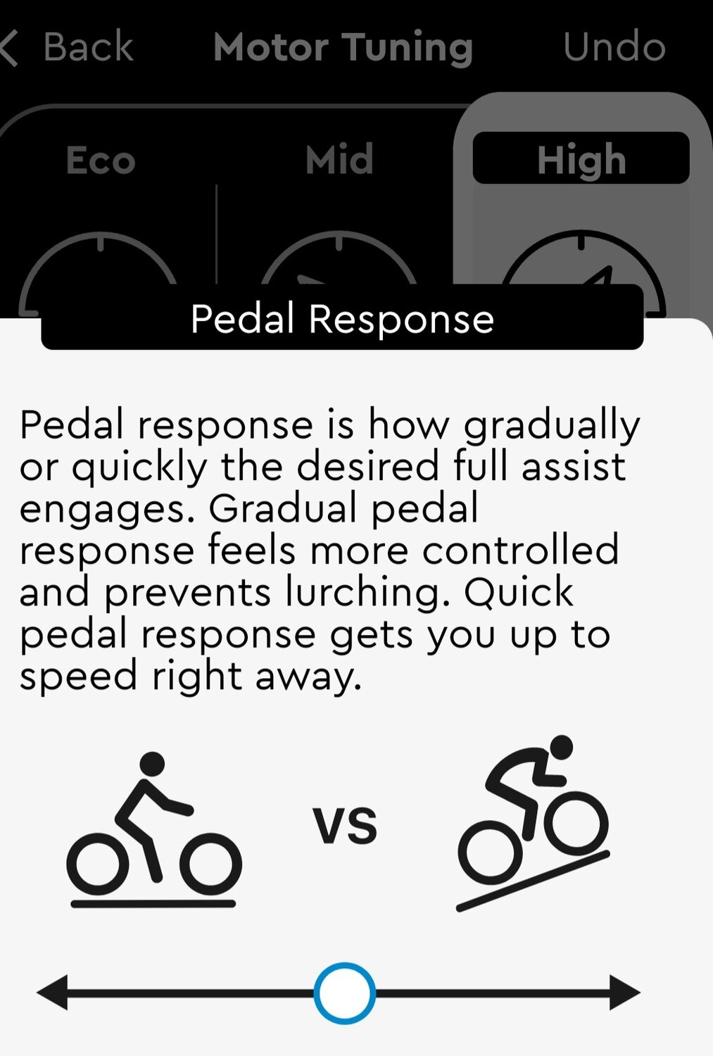

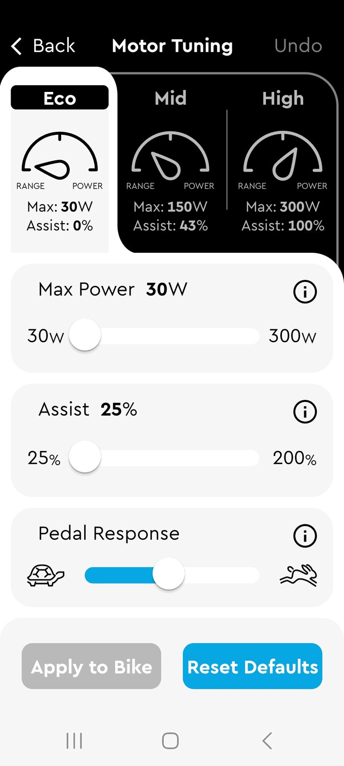

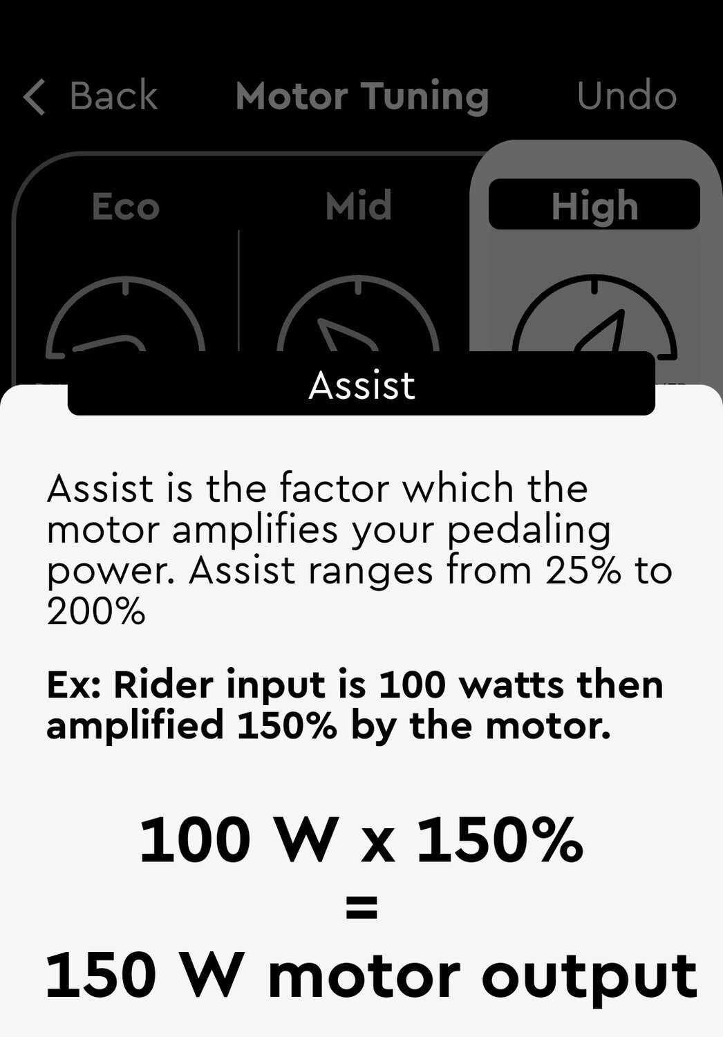

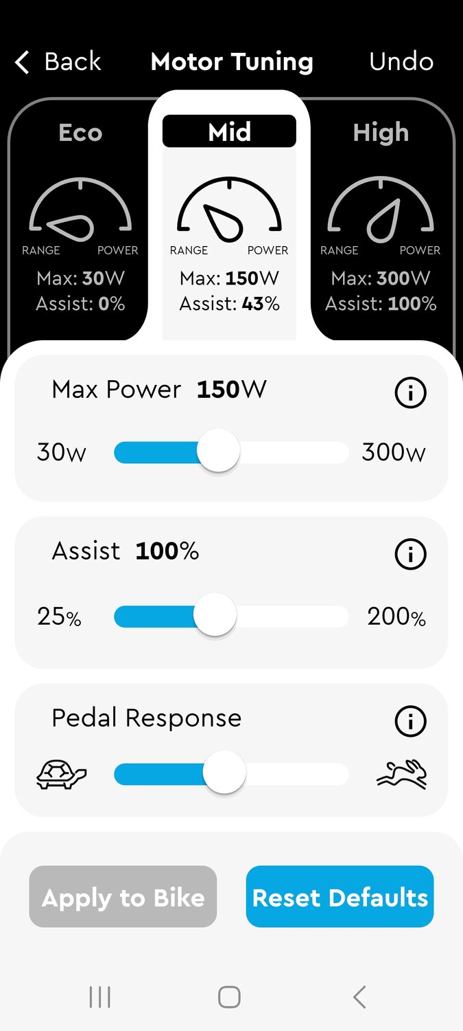

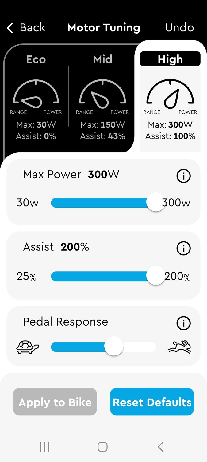

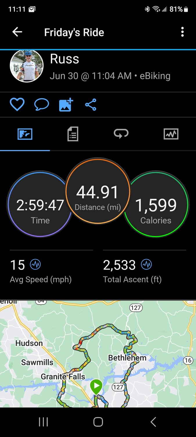

The battery life does appear to be shorter on the AMP X. But, I'm learning to manage it better. I mostly use the Eco mode when needing any assist. I'm not able to reduce the Max Power and Assist levels as low as I'd like. Have look at the attached screen shots from the motor levels from the TQ app. You'll also see an attached screen shot from my Garmin Connect app. I used 14% battery for that 45 mile ride with 2533 feet Ascent and average 15 mph speed. My personal weight is 191 lbs. Hope that gives a sense of battery usage, which is such an individual thing. It's impossible to say how many miles\km one will get from any system. I feel pretty confident that with the type of riding I do, I can easily get 100 miles or more from my battery before needing a recharge.
Power:
I feel this TQ-HPR50 system has more power than the Mahle X20, is definitely quieter (really difficult to hear the motor) and is a class 3, which can assist up to 28 mph here in the US. The screen shots of my current settings are not all the defaults. I reduced the Eco as low as I can and also reduced the Mid level. When using the mid level at my current settings, It feels similar to the highest assist setting in the Mahle X20. When testing the High level, it's way more power than I feel I'll ever need. But, it's nice to know it's there.
