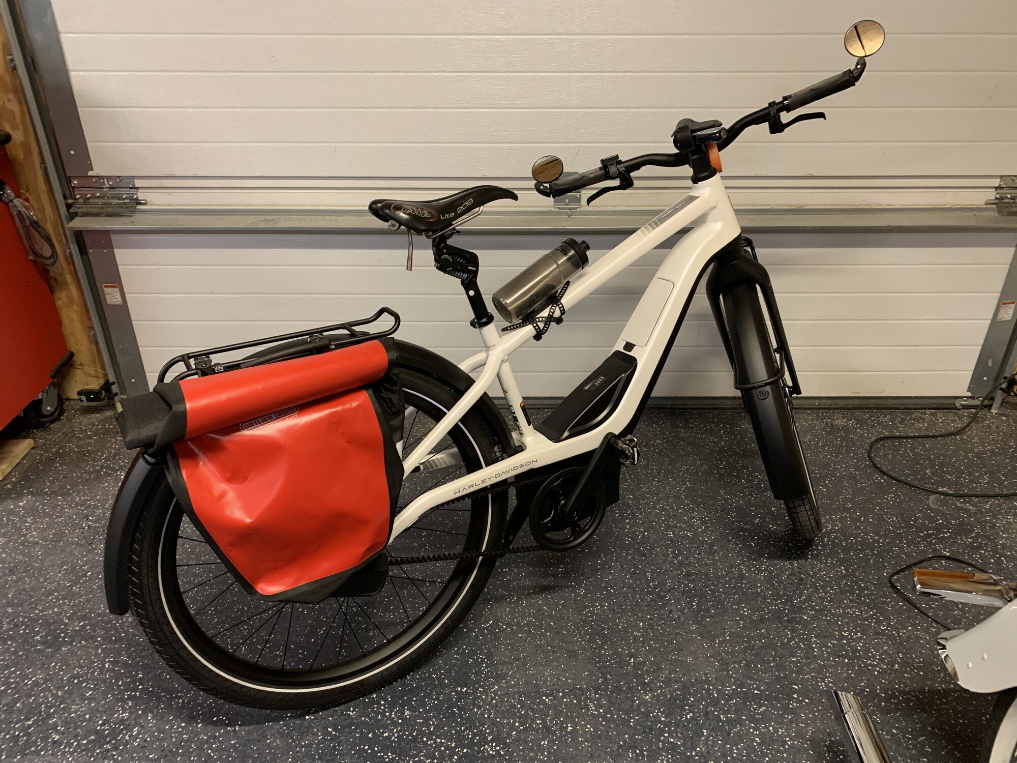

I have the enviolo automatiq on my Harley Davidson Serial 1. I’ve been riding bikes for 55 years and have owned a rohlloff on a tout terrain but there is just something weird about setting a cadence and never shifting… at times I feel lost to the technology doing too much for me.

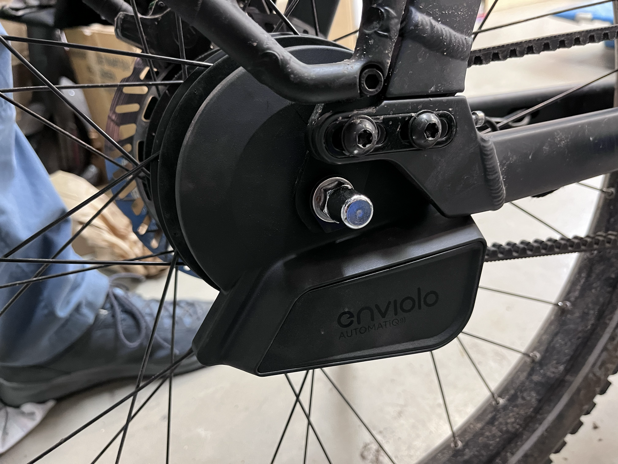

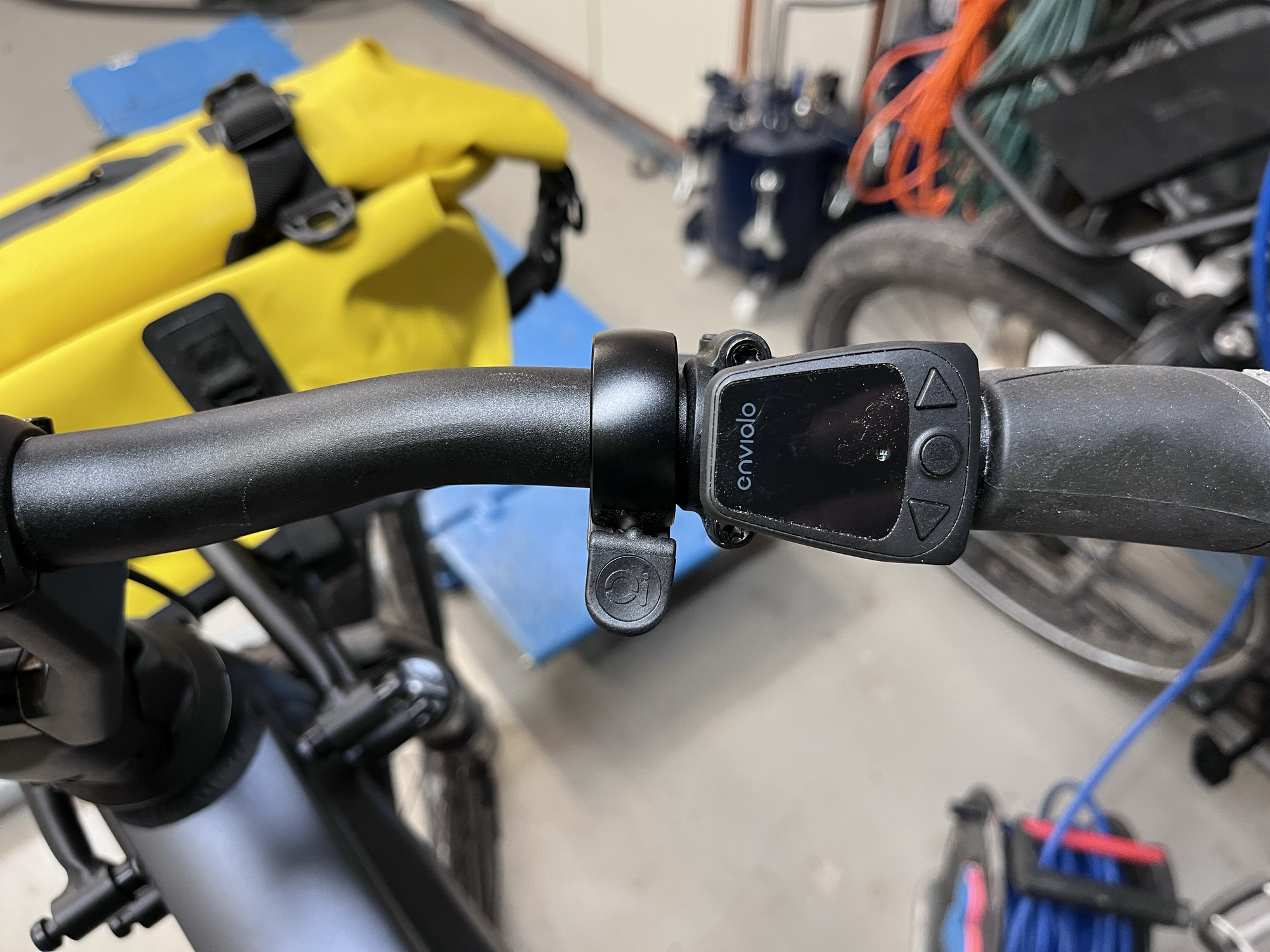

Hi All, Thanks for letting me in on this forum. Maybe you are interested in my story with AutomatiQ. I upgraded my R&M Charger 3 to AutomatiQ two weeks ago. Installation was quit straightforward however you need to be a bit technical. Main reason to upgrade was because I was annoyed by the heavy shifting. This is mostly caused by the cable system. My bikeshop did not want to do it because of issues with the older automatic Enviolo systems.
I purchased the Enviolo 2.0 to automatiq upgrade kit as this fits the 380 hub. In the hub you have a power cable, a remote controller (Bluetooth), two magnetic rings (on on the hub and the other one on the outer sprocket) and the AutomatiQ hub itself.
Setup is also pretty straightforward. Just connect the app on your phone to the hub and you can set the hub to either automatic (the hub is controlled automatically to maintain the set RPM) or manual (which gives you 9 preset 'gears'). In either mode you can control the hub. In automatic you shift 1 or 5(long press) rpm up or down with the buttons and in Manual mode it is just like a normal shifter with 9 gears.
This all gives you two complete different riding experiences with its own purpose. After quite some kilometers I come to the conclusion the the manual mode is super if you need speed of shifting. you can very quickly move up and down. The automatic mode is perfect for touring. You just set the rpm and the bike keeps itself on the set rpm. Little bit weird in the beginning, like you drive a CVT car.
Shifting is super smooth which strengthens my thought the heavy manual shifting is mostly because of the cable system. I have to say that you do not only want your smartphone to control. Because then you need to constantly reach for your smartphone to control the hub. Which indeed is cumbersome. imo you need the BT controller. Just place it next to your brake lever and you can easy reach it even on high speed with your thumb.
There are a couple of flaws however. If you want to change from Manual to Automatic or change the stop gear ratio or the preset RPM you have to connect the app. But after setting these in the app you have to disconnect the app and reconnect the controller. Also when you 'start' your bik you need to press the center button to connect the controller to the hub. Probably because of power save. Another flaw is you are as a private person not allowed to create an Enviolo account. And therefore you can not get into the deeper set up menu and that means you can not set the motor type, wheel size etc. You need a bikeshop to do that. Which irritates me.
I will never go back to the cable shifting. I know that for sure.
