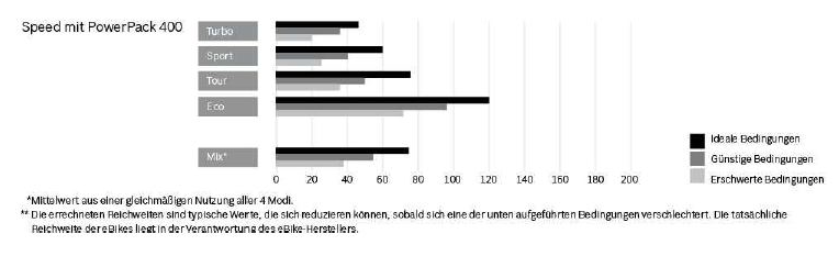

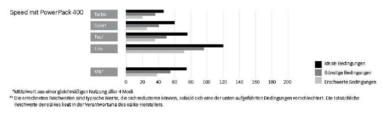

Comparison charts
Rider leg power difference can be huge!
Different types of eBikes
Differences By Speed:
Commercial Performance Chart:
For example, Bosch method:
Bosch Standards.
Ideal conditions**
Flat terrain at approx. 20 km/h average speed, no headwind, approx. 20°C ambient temperature, high-qualitybike components, tyre tread and pressure with minimal rolling resistance, experienced ebike rider (always shifts gears correctly), additional weight (excluding bike weight) < 70 kg.
Favourable conditions**
Slightly hilly terrain at approx. 25 km/h average speed, slight headwind, approx. 10°C to
20°C ambient temperature, medium-quality bike components, tyre tread and pressure with average rolling resistance, favourable cadence, ebike rider shifts correctly most of the time, additional weight (excluding bike weight) 70 kg to 80 kg.
Difficult conditions**
Terrain with long and steep inclines at 25 km/h average speed, possibly strong headwind, < 10°C ambient temperature, bicycle components with relatively low efficiency, tyre tread and pressure with increased rolling resistance, unfavourable gear selection / cadence, additional weight (excluding bike weight) > 85 kg.
