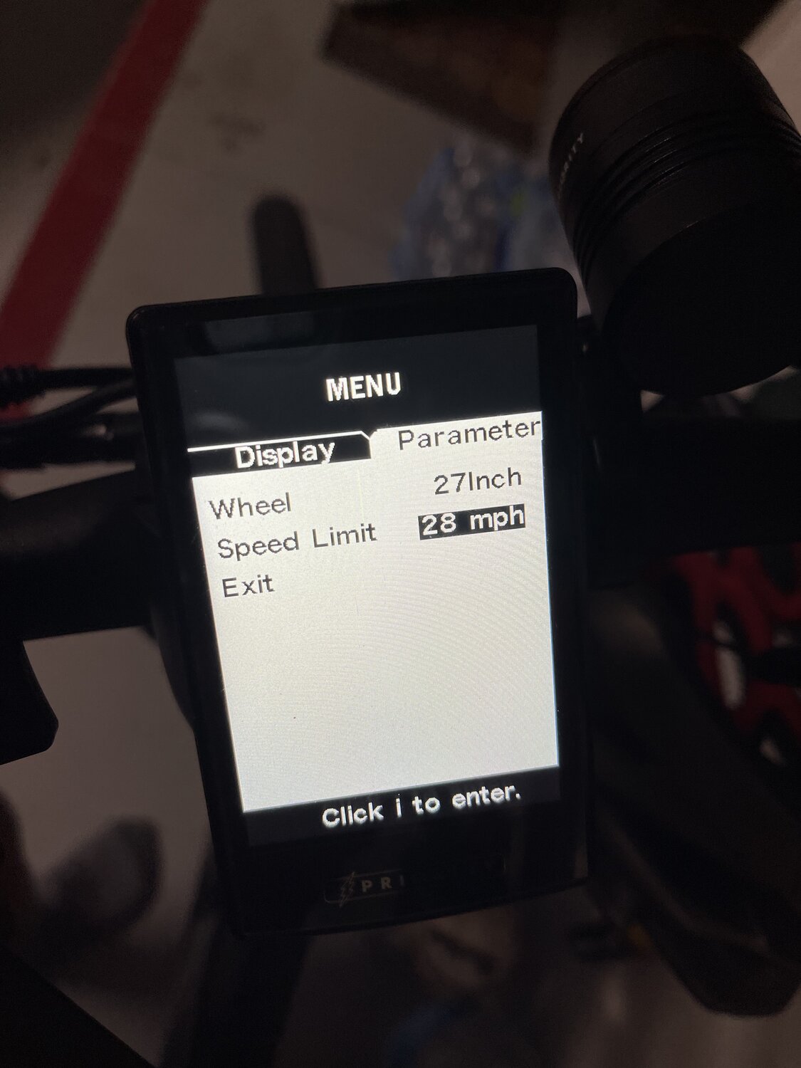

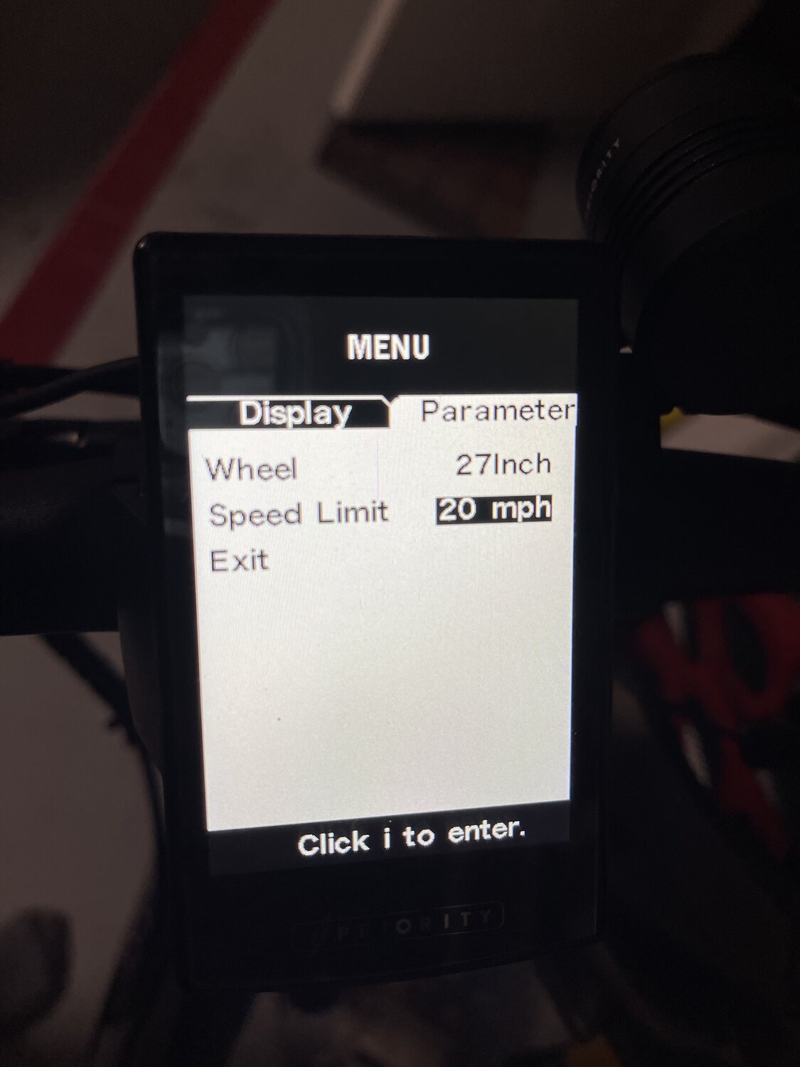

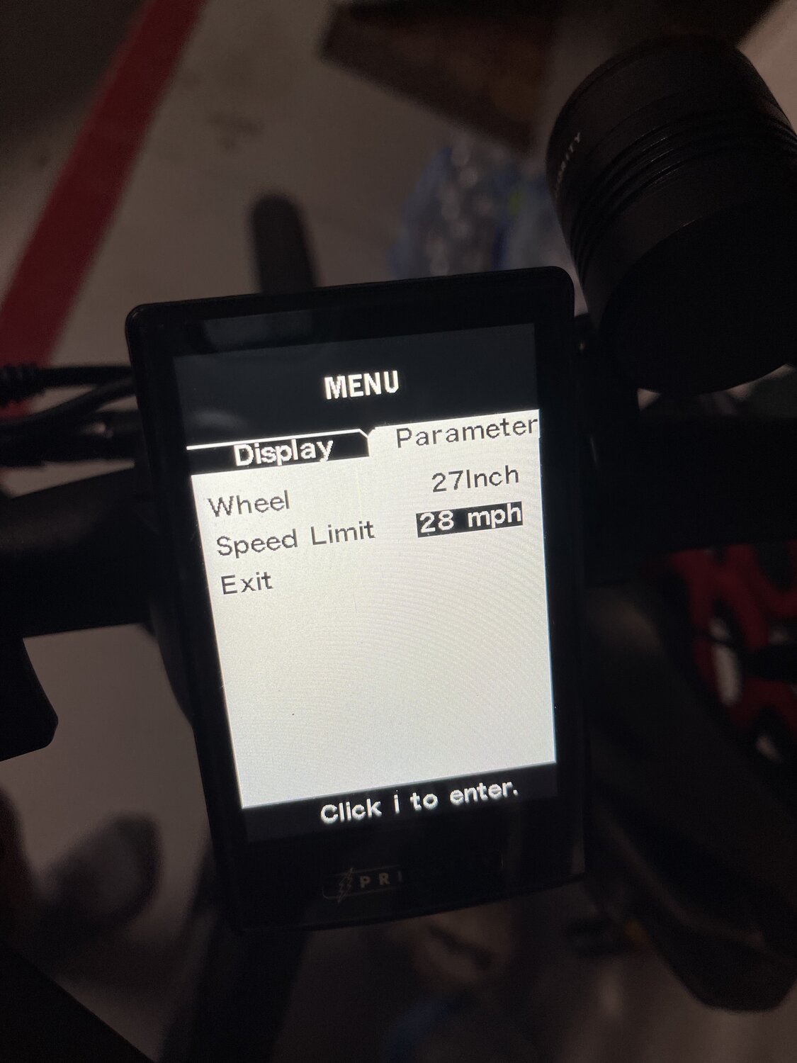

The Current ships as a class 1 -20mph max but the owner can easily change that with the controller to class 3. I never paid attention whether or not it could be set back to class 1?
If by 'the owner' you mean the company selling the bike, yes...but M600s can not be 'end user' switched without a CANBUS programmer or the BESST tool, at least without an almost-nonexistent-except-for-Luna-LudiV2-controller/custom controller on the motor (not the display, actual controller inside the motor). They're meant to be set only by the 'dealer' without jumping through hoops (e.g. buying the BESST tool and a Bafang login (or a hack to scripts, but not 'typical user friendly.')

That's one downside - seeing updates for US market bikes (i.e. moving the speed limit upwards) is somewhat slow and longer cycle time than some other changes, but it's good to see more and more brands doing it, even if in most cases it's the same motor and bike, just with the restriction removed/increased values.@TrevorB said Consider adding dropper post to whatever bike you buy. I now know exactly what it is and how it works.
