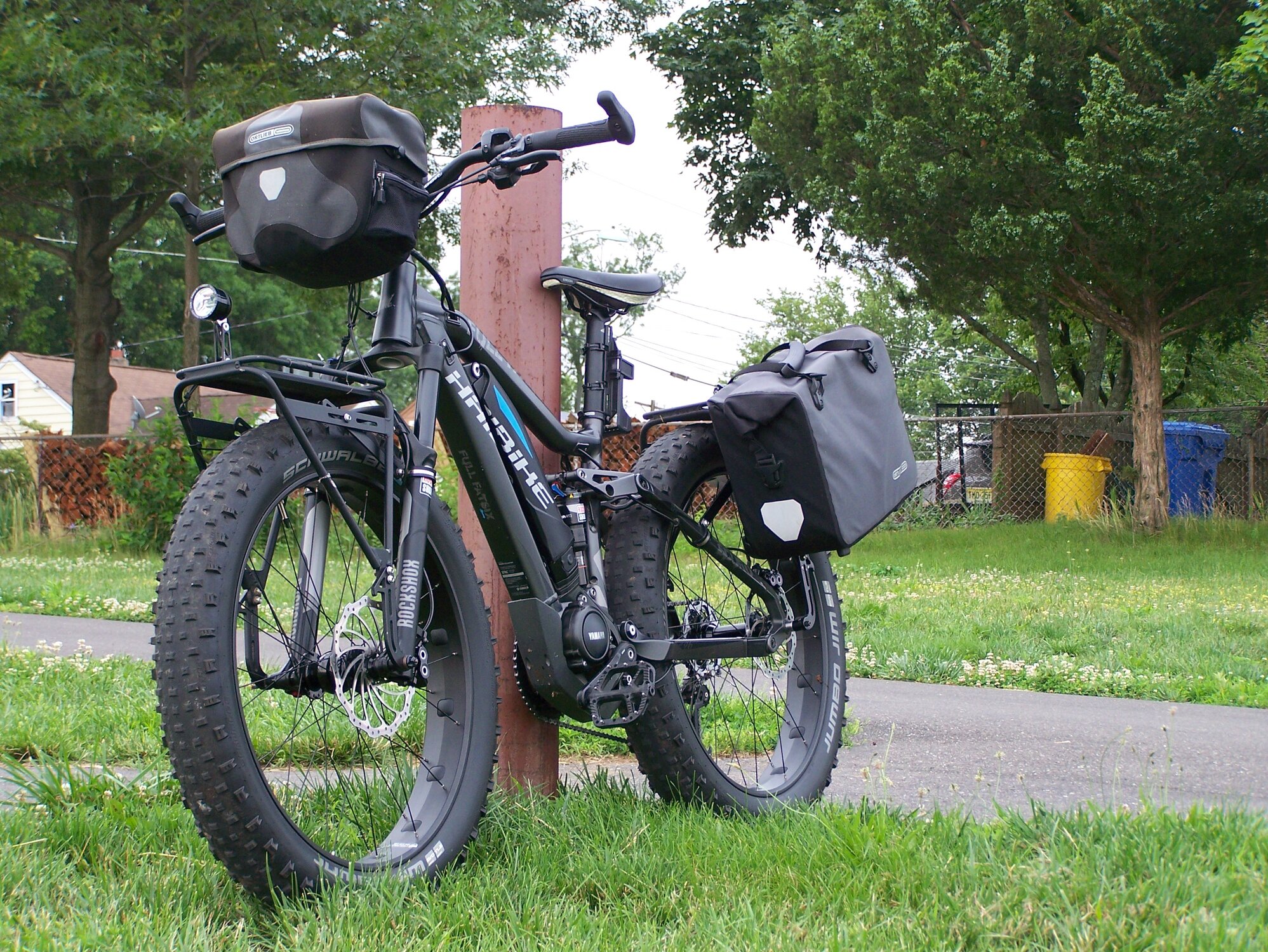

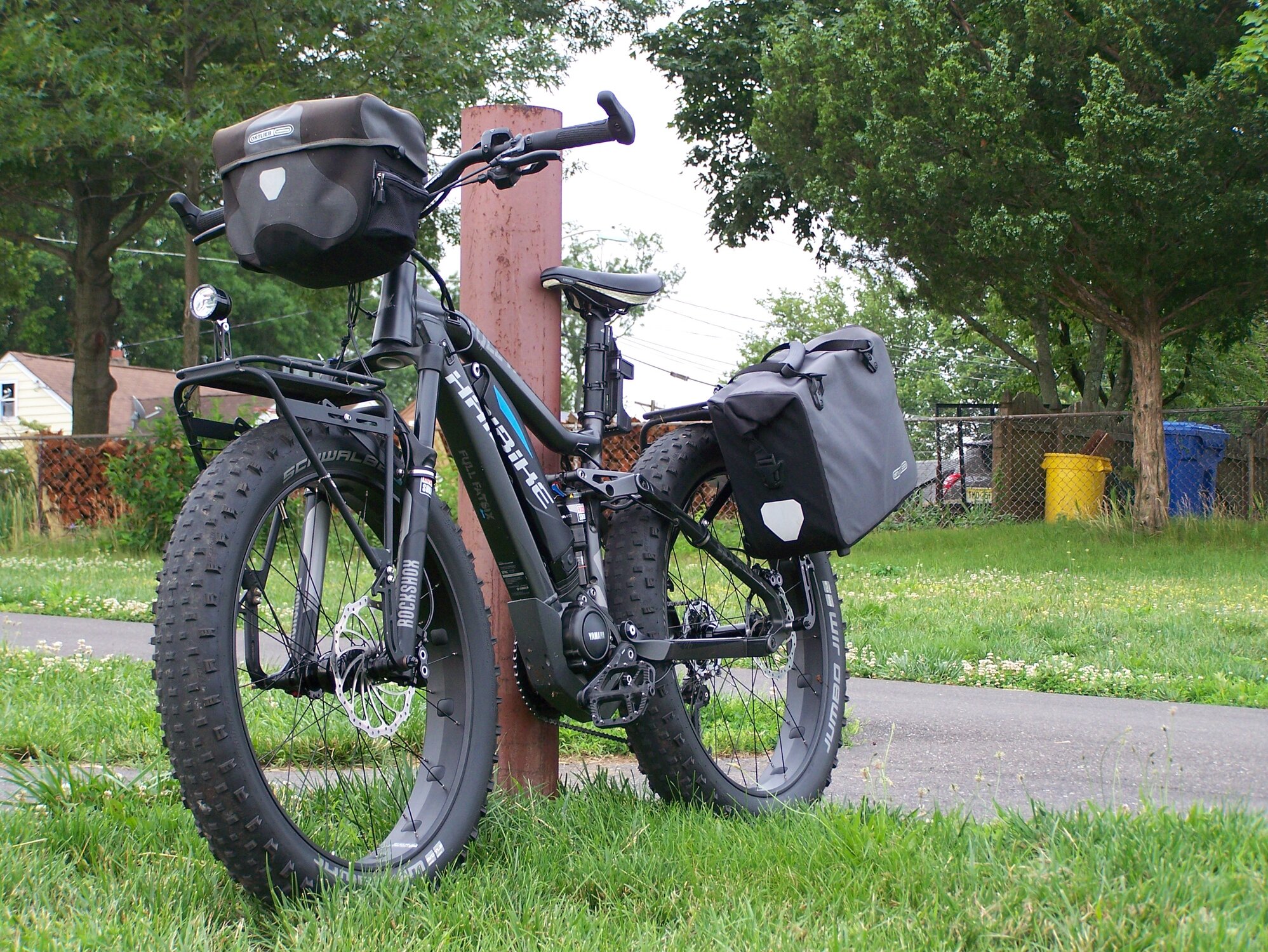

I've done alot of things to make this a true, trail and road worthy, touring-capable, 24/7 road and off road bike. Front and rear Old Man Mountain racks that use the Robert Axle thru axle as the chief mounting point. All sorts of Ortlieb bags for this application or that application. A Schmidt SON28 dyno hub feeding a Schmidt Edelux II front headlight and Schmidt SON tail lamp; all the more to make me visible even in the daytime. Tannus Armours (before that, I was tubeless until I learned that a major cut in the tire and no spare tube in your gear bag means a long walk.)

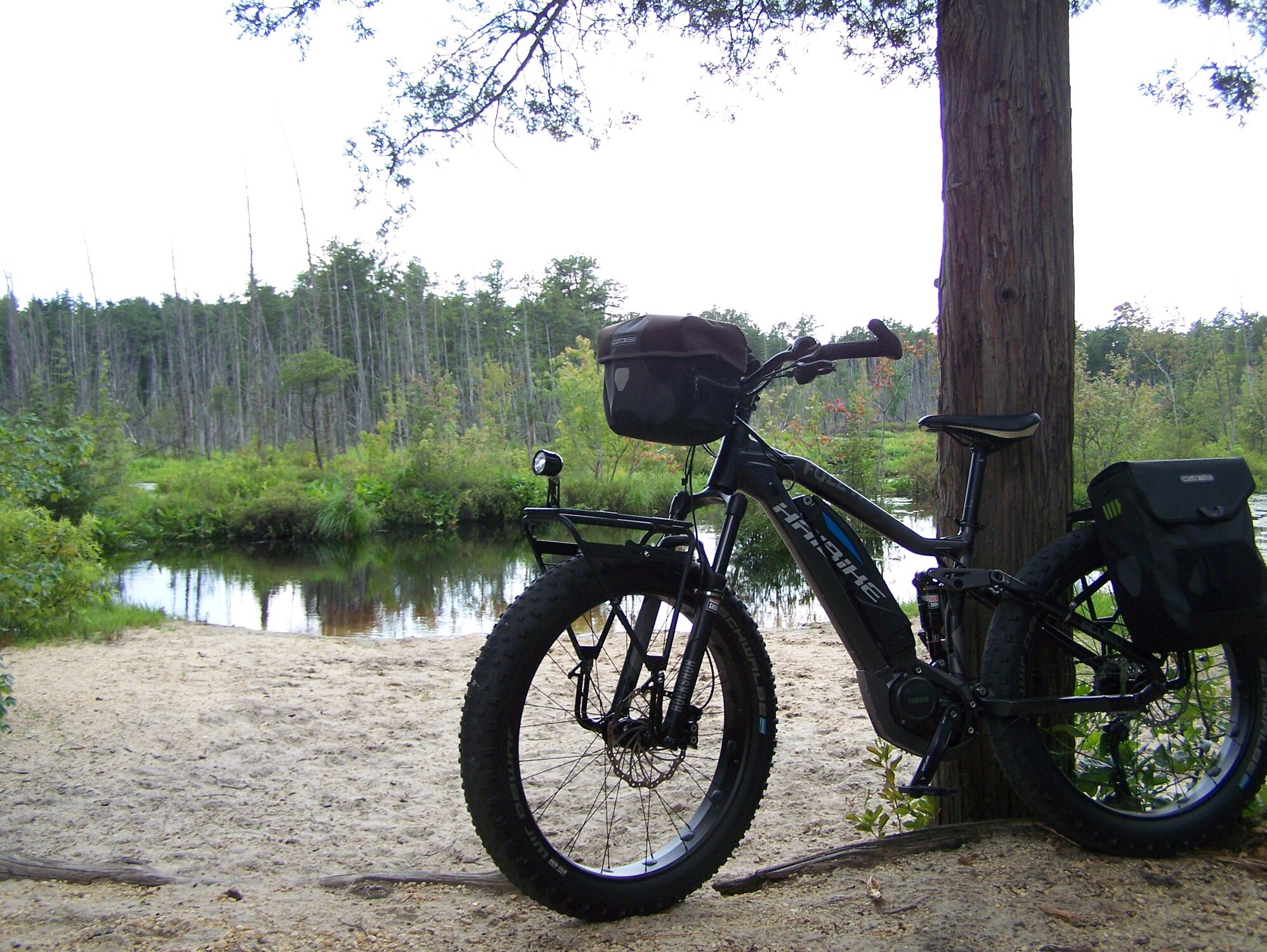

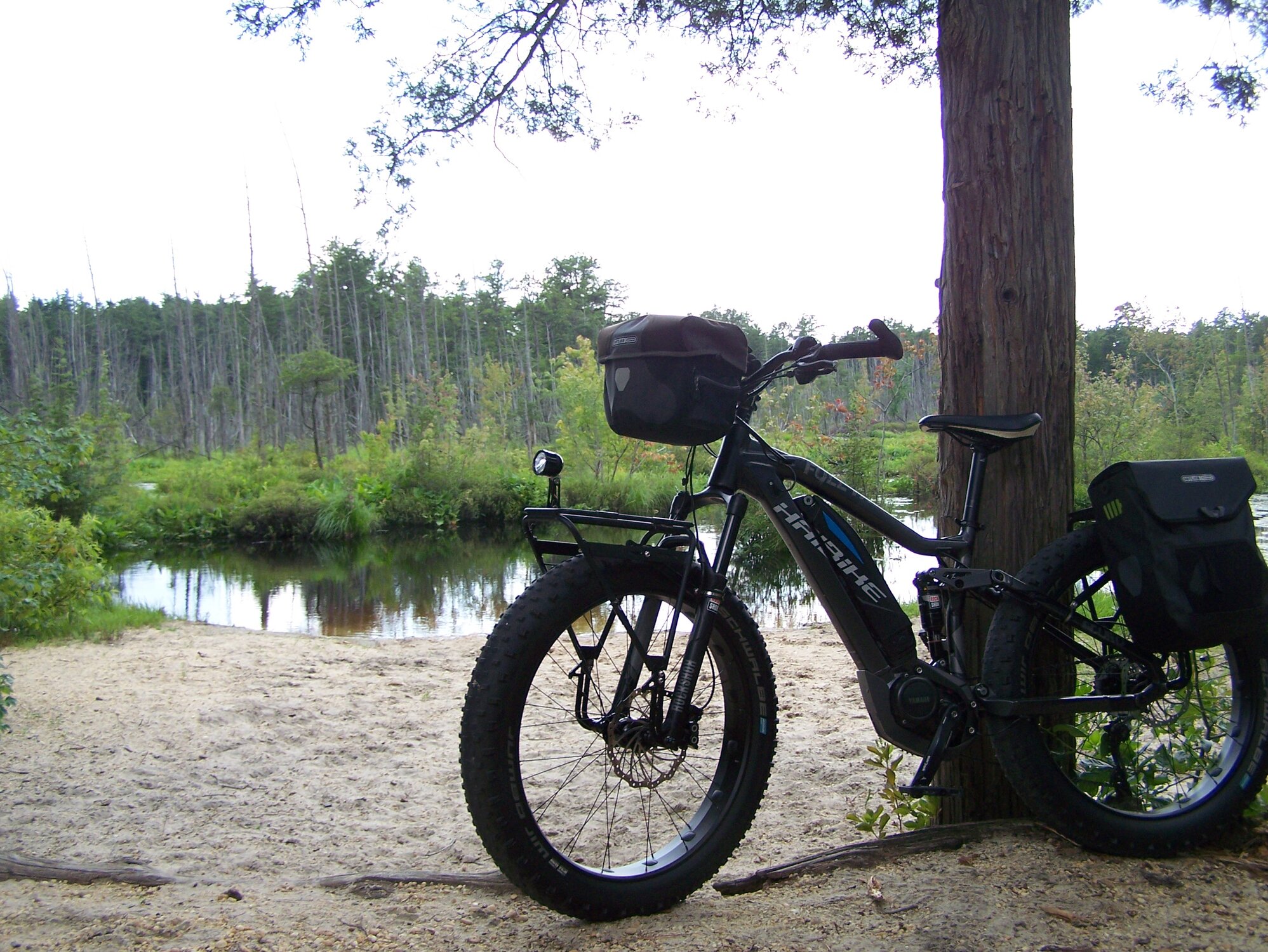

Local riding near home last week, a 30 mile jaunt using High power and one 500wh battery. Asphalt riding. That rear bag is an Ortlieb Office bag, sized large. Get two for the rear rack and you have pretty much enough capacity for your commute.
I took this pic on yesterday's ride east and back. Goshen Pond, Mullica River, New Jersey (USA) Pine Barrens. Asphalt road shoulder riding to get to this point. Rode on the deep sugar sand roads for a few miles before it was time to head home. 62 miles (99.72 km) total. That particular rear bag is the Ortlieb E-Mate, which has a carrier built into the bag to accept the Yamaha battery. For this trip, I brought my spare battery as I was moving at speeds from 11 to 19 mph. Not seen is the PearTune speed chip I installed. It's nice to go over the 20mph factory cut off speed every now and then. There really is no other bike that can ride on asphalt then jump onto a deep, sugar sand road like a good mid drive fat bike can. There is no other substitute......
