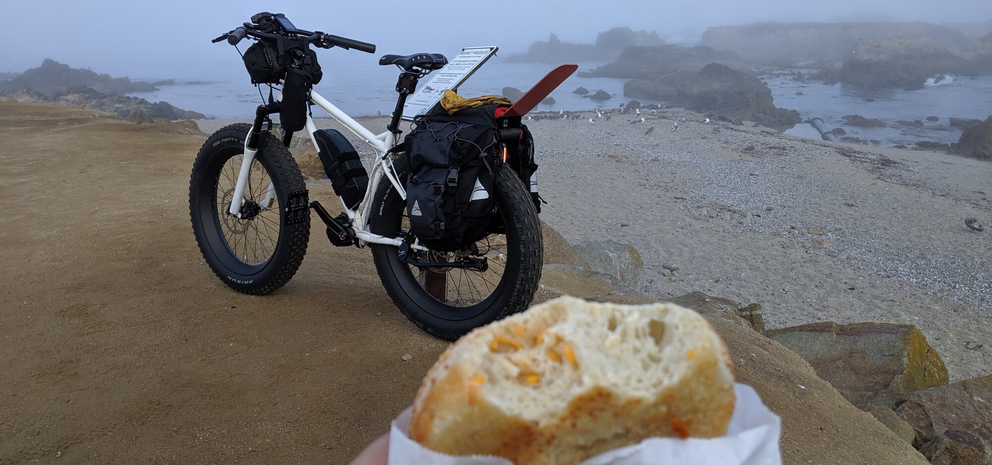

i dunno man, I have 3 fat tire bikes hub drive with 750watt bafang motors, 7,000+ miles on the Cyrusher, 1,800 on my tandem and nearing 1,000 on my bikonit, no issues with them so far except chain wear and 4 punctured tubes from road debris. 50 miles a day on the Cyrusher for almost a year now. all road commuting a slight 9% grade for 2.5 miles at the end of my commute. so I can't speak to hard hill climbing. but for commuting they have been great.
I am looking to move to a road or gravel bike for non-commuting riding. but I like my fat tire for commuting. probably due to riding motorcycles for 35+ years. the fat tire is more comfortable to me

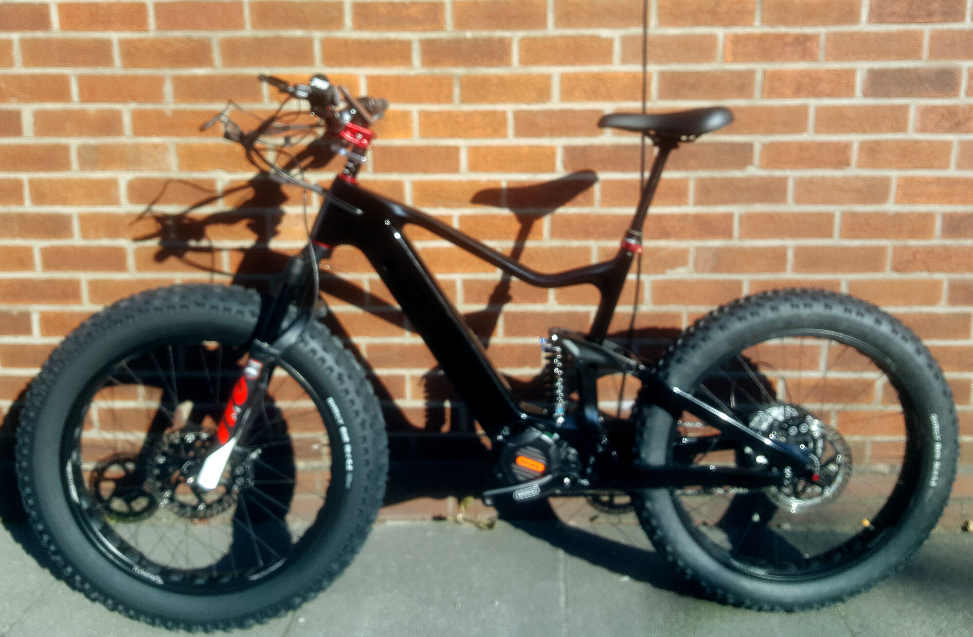

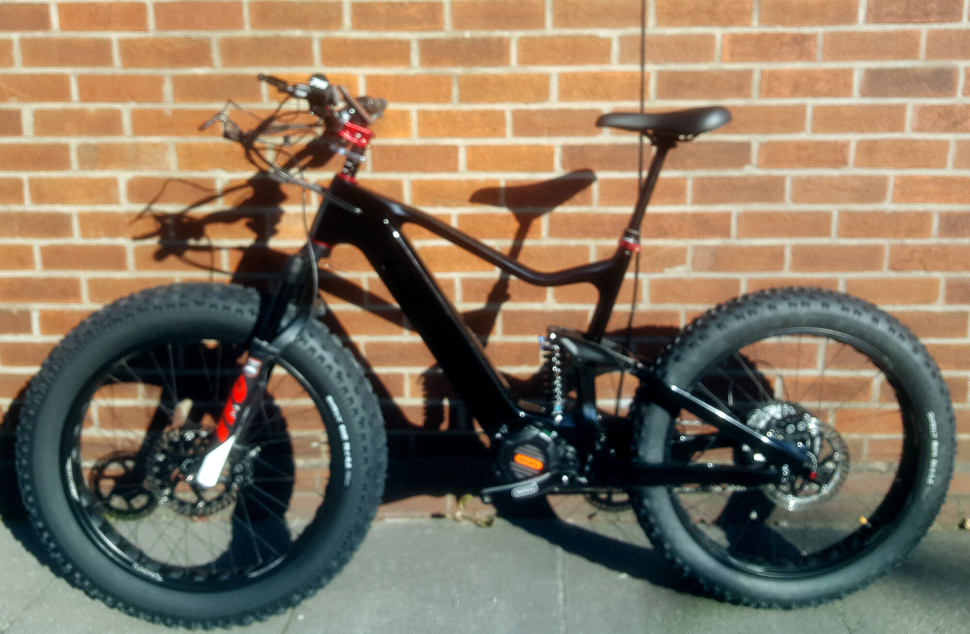

I have to say first i'm sorry for the quality of this picture, i snapped my phone in half clearcoating the bike and have had to use an old broken phone which it also happens has a bad lense, i wasn't going to post any pictures until i had some decent ones in the sun but the forecast is for rain all week :( oh and please forgive the messy cockpit/wiring, i haven't shrunk the heatshrink yet until i know everything is 100%
Self build FTW
wow! that came out great! very inspiring!
