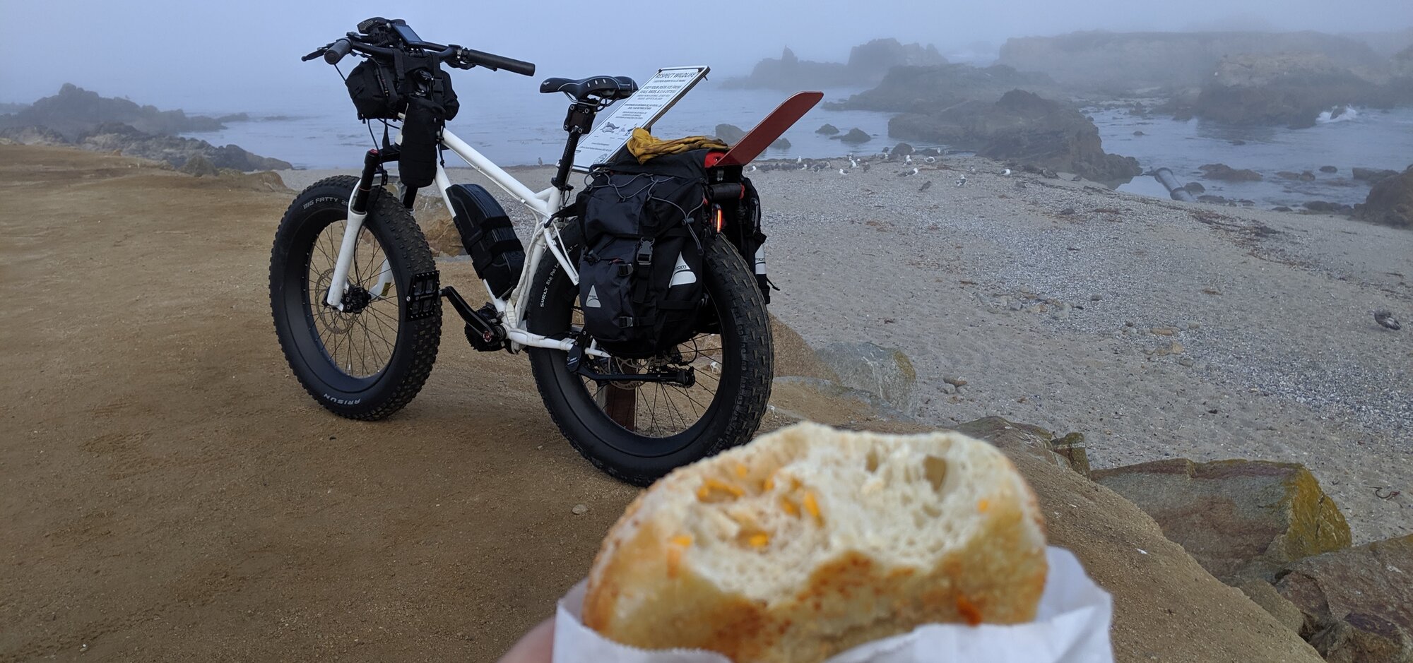

Ditch the rear suspension requirement and you have a WIDE variety of choices where otherwise you have only a very few at the top of the price heap. Get yourself a good suspension seatpost like a Thudbuster LT or a Kinekt. Fat hardtails configured like this, with a mid drive, can climb any street in comfort. My bikes generally have panniers on them specifically because they are commuters and store bikes that are carrying extra gear like work clothes/shoes, or my lunch or both.
A BBSHD conversion like this one can get you up the hill without any pedaling. Just upshift, relax and either hit the throttle and snooze your way up the hill, or max the pedal assist and gently pedal yourself up as if you are on flat ground.
I will almost always pedal a bike like this and get exercise, but if I have a date then I might throttle it all the way home, or a conference call coming up shortly same deal on the way into the office.
Lastly: You will find that plus-sized tires about 3" wide are just as comfy as fat tires on the street but are much easier to deal with in a number of ways. I would broaden your search to plus size tire'd bikes.
