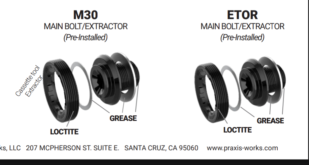

The summary: the practical torque on a Specialized thru-axle does not need to exceed 12 Nm. A torque wrench is a good idea. No greasing or anti-seize paste are required on the thru-axle (and nothing needs to be applied to Praxis mid-motor self-extracting crankarms) :)
Confirmed by the mileage of 16,563 km on my Vado SL, and 24,571 km on my full power Vado.
Did yours not come with some grease or antiseize paste already applied? The Praxis crank arms I installed a few weeks ago did.
I bought my replacement crankarm via a Specialized LBS. The techie told me to never remove the outer ring (using a cassette tool). I was told just to mate the female thread of the crankarm on the motor spindle thread, use an 8 mm hex key and rotate clockwise until the rotation stopped :)
