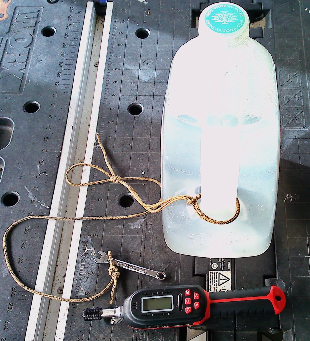

My torque screwdriver is an enjoyable toy. It came with a calibration sheet, but I used a 1/4" box wrench and a gallon jug to see for myself. The wrench weighed 19.1g, contributing a negligible .007 Nm. The jug and string weighed 3663.7. The point of suspension was 70mm from the center of the bit. I calculated 2.52 Nm. The gauge read 2.51, both CW and CCW. However, the calibration sheet found that it would read about 0.5% low in that area, meaning it would read 2.51. Right on!

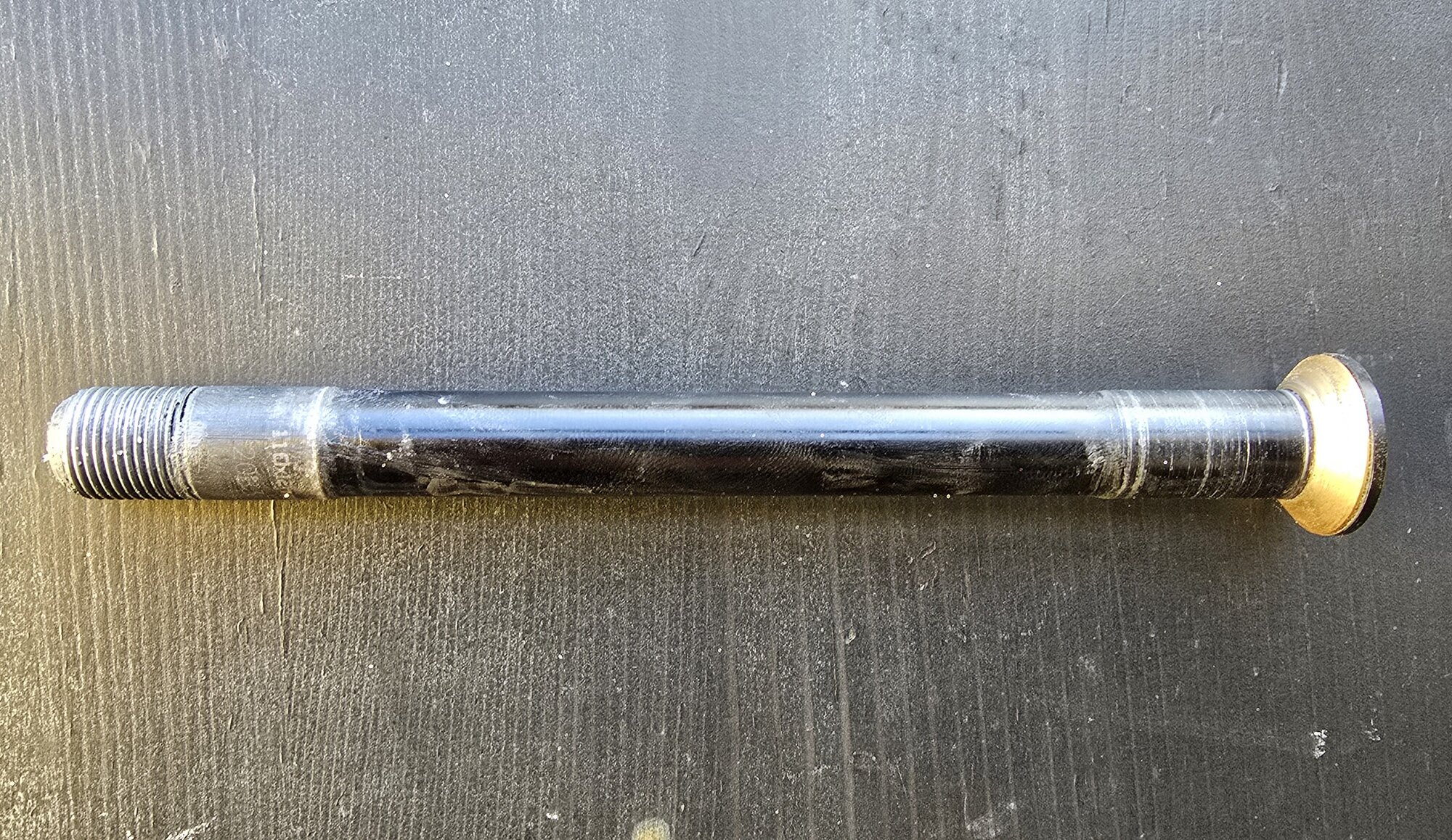

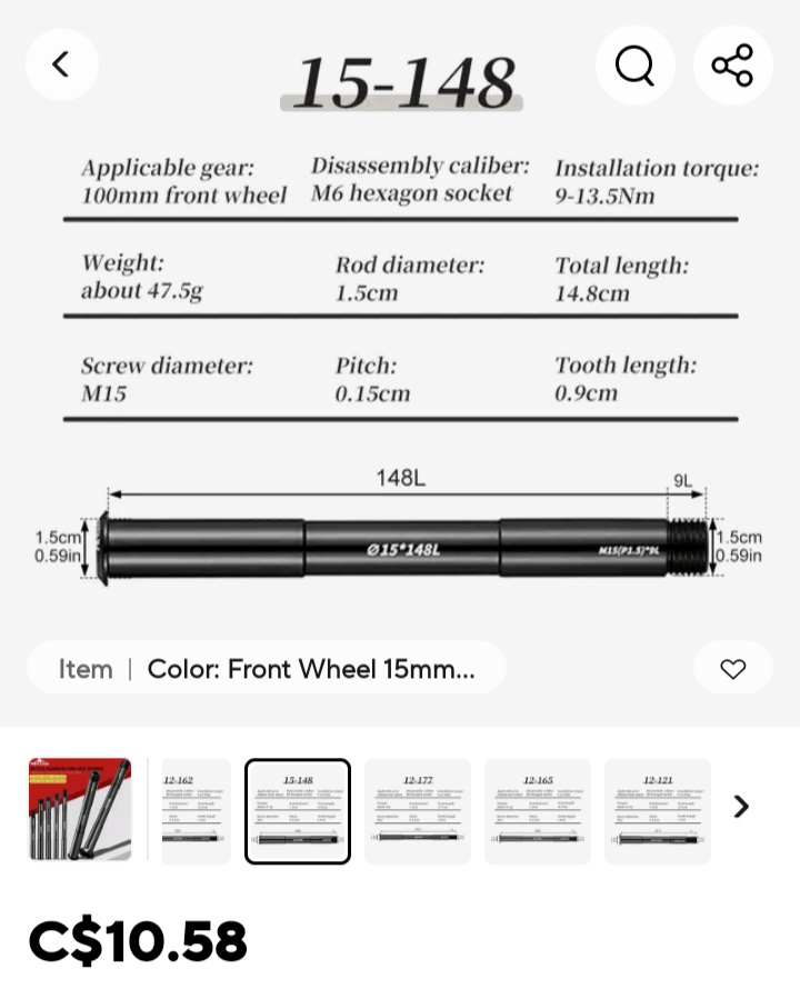

A thru-axle after 3.5 years of use. Never greased. It still has the paint on!

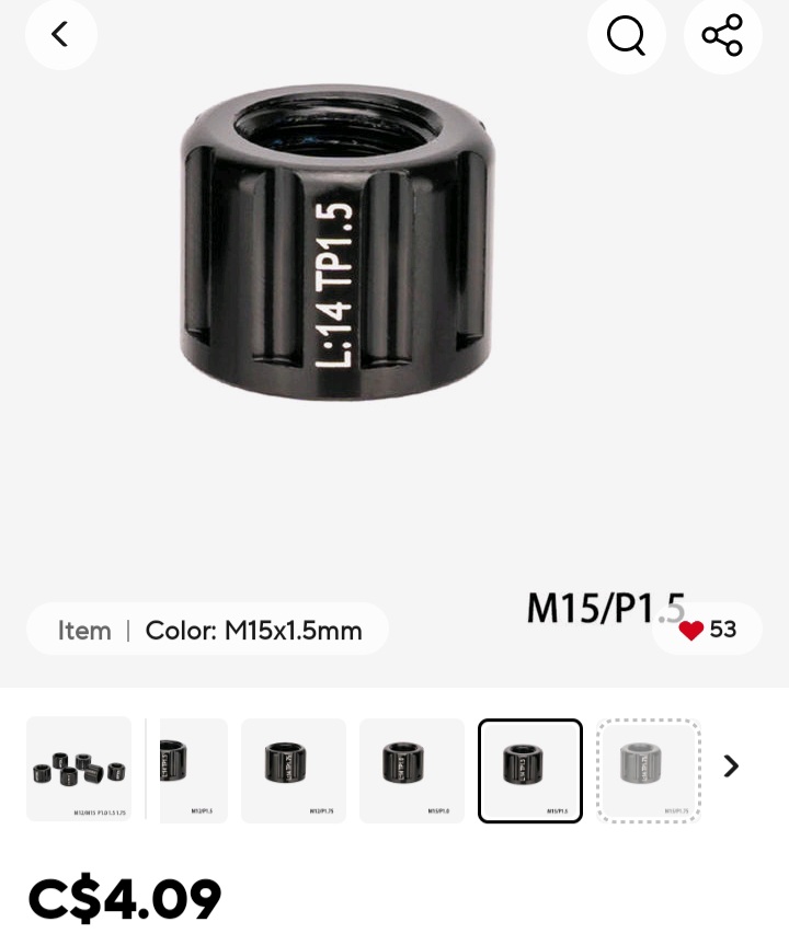

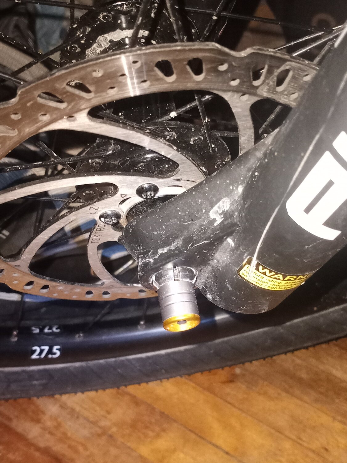

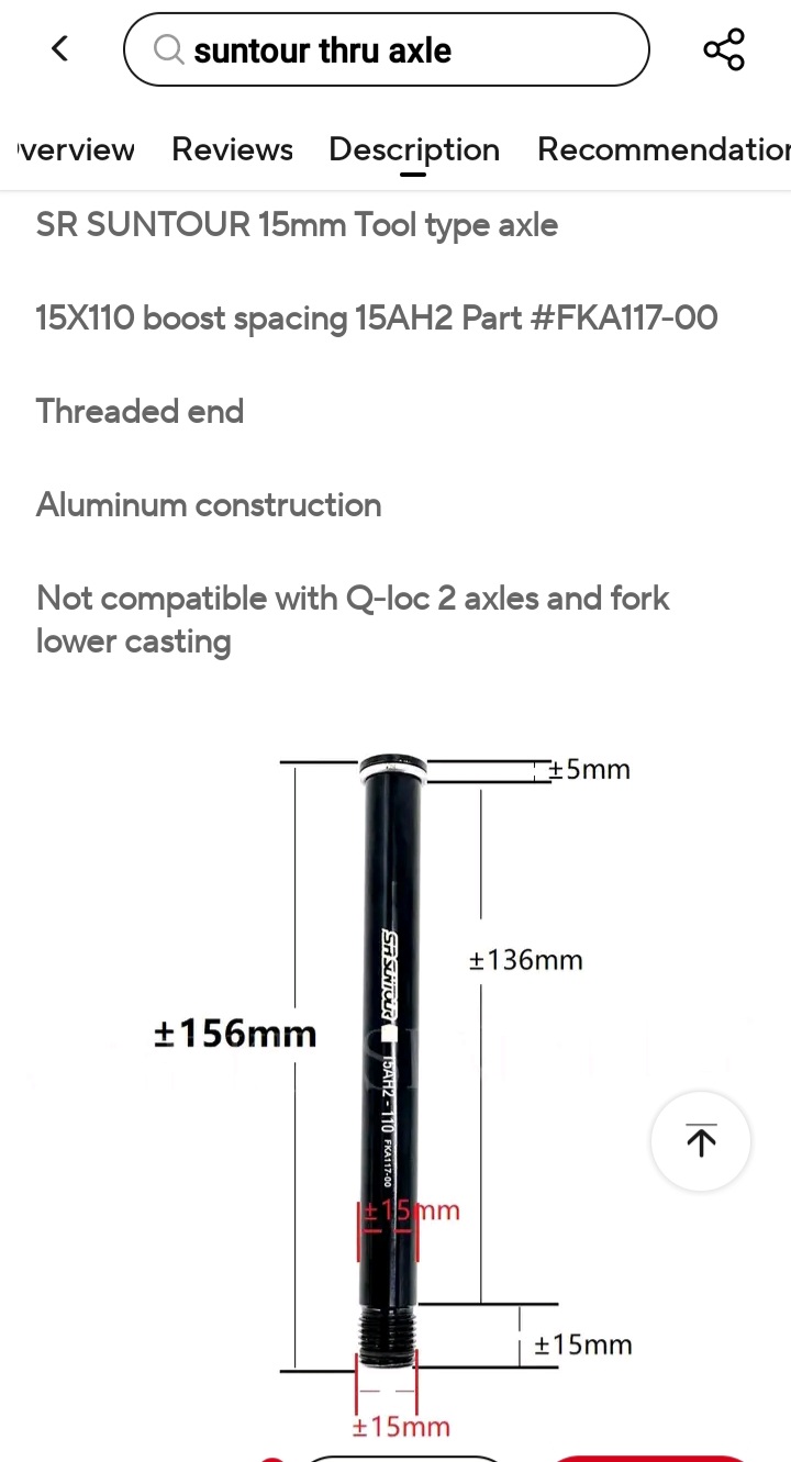

That's the kind of axle I want, but it doesn't fit my forks with a Q-loc boost axle,..
So I'd need to get this,..
And this,..

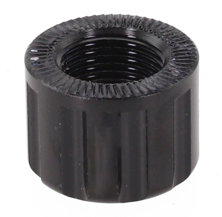

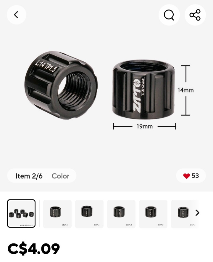

But the axle is ~3mm too long, so I'd need this so the threads don't bottom out on axle,..
Or, since the axle is only threaded for 9mm, and the nut is 14mm tall, I could just drill out the first 4mm of threads of the nut to take up the slack.
The drilled out threads will fit like a sleeve over the axle so the nut will compress on the fork drop-out.
That way I'll get the serrations on the nut directly contacting the fork dropout instead of the smooth sided spacer to help keep things from loosening up.

...The wrench weighed 19.1g, contributing a negligible .007 Nm. The jug and string weighed 3663.7. The point of suspension was 70mm from the center of the bit. I calculated 2.52 Nm. The gauge read 2.51, both CW and CCW. However <snip>
Dude... you either need a girlfriend, or you need a new one so you aren't hiding in the shed doing stuff like this.:D

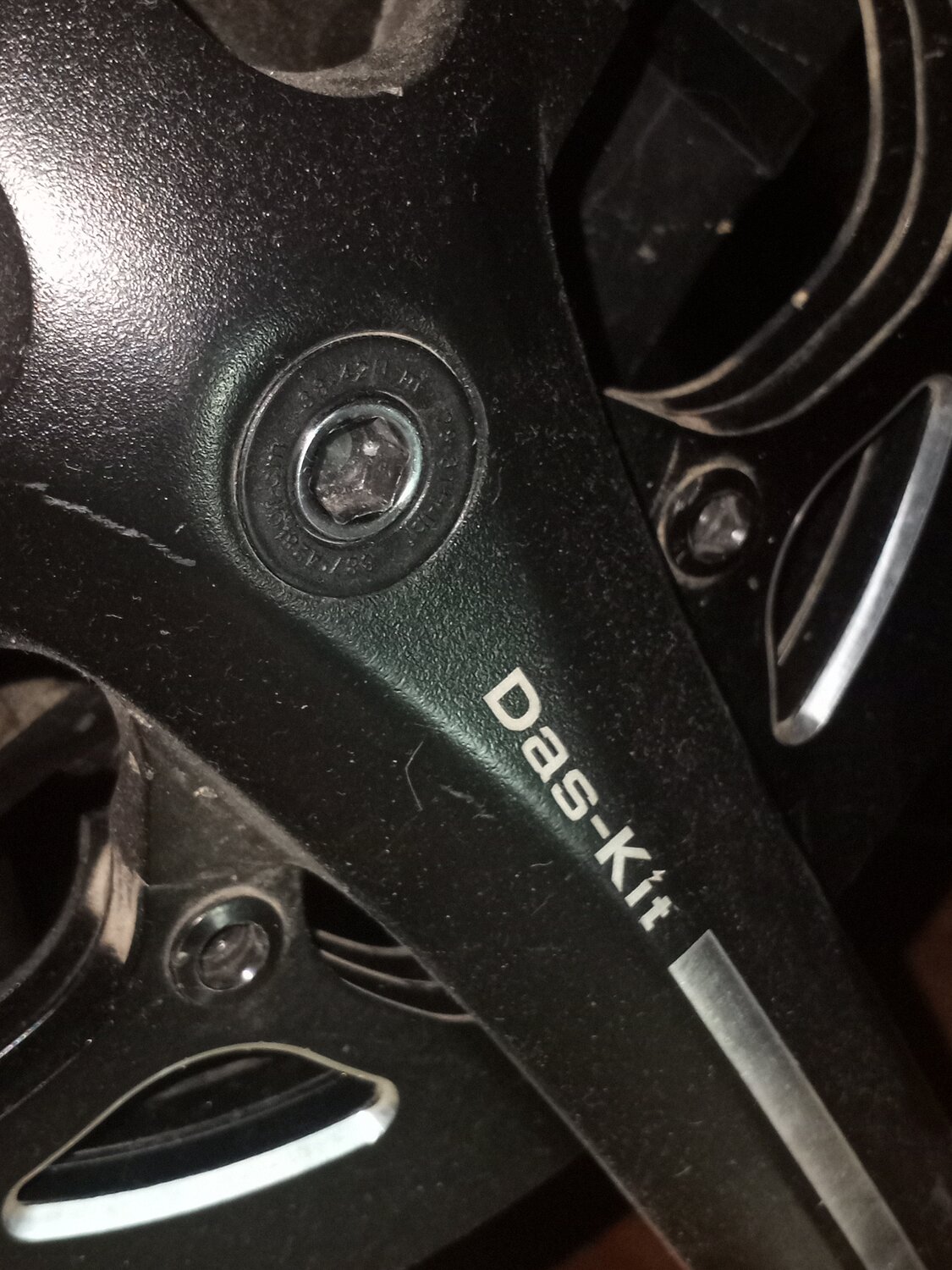

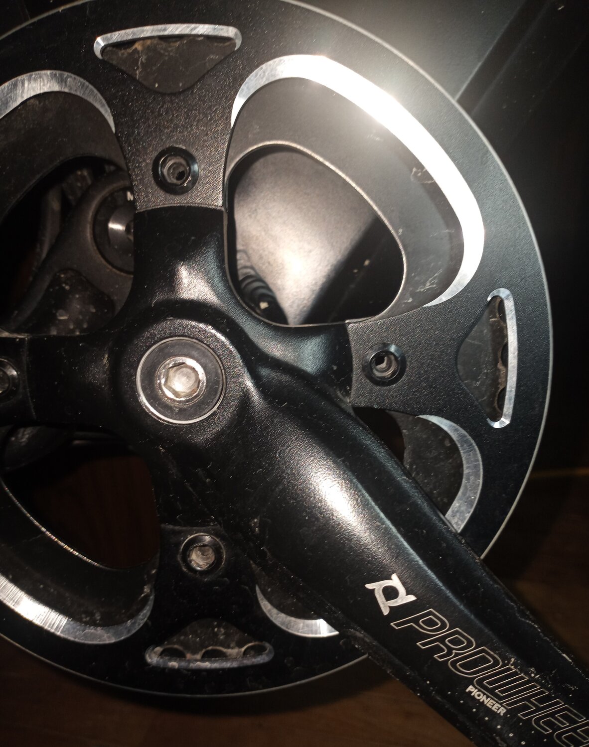

I think the only spec that truly matters thats not commonly covered is the M8 crank bolts, which vary by crank manufacturer. I stick to 25 ft lbs. I have seen 35 - at the upper end of the common recommendation - shear the bolt. Most people who just farmer-tighten a square-taper/JST crank (the kind on most DTC ebikes) will take it to far less than even 25, which means rounded (and ruined) crank sockets when that chicken comes home to roost.
If you have bike parts that state the torque spec right on the part,..
My new e-bike isn't labeled but my first ebike is, so I went with 35 ft lbs. on both e-bikes.

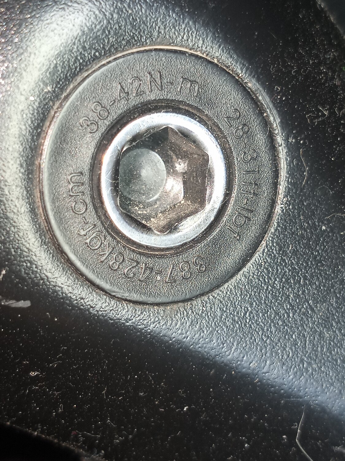

PS,.. Every farmer knows that when you tighten up the big bolts, you put a two foot pipe on the ratchet handle and step on it. 😂

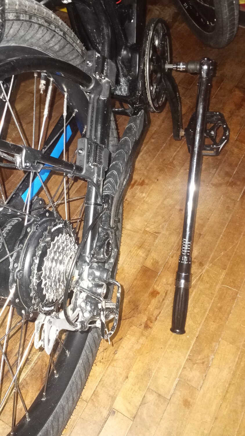

Well, that bolt is totally NOT an authoritative source :) Plus, it says max to 31 ft lbs, not 35. I've learned to go on the low side of 'certainty' when it comes to crankarms. When you tighten a square-taper crankarm, you are tightening a (relatively) soft alloy crankarm onto a harder steel shaft that is tapered wider at its base. So as you tighten the crankarm, it squishes down and widens itself a hair. Over time, if you remove and replace that arm a few times, it will squish down further as it forms itself to the axle. So... overdoing the torque makes it spread faster. I've never had one go bad on me from this but I'm in no hurry to have it happen for the first time. I've found 25 ft lbs is definitely tight enough to have squished on the axle properly, and never gets a hint of wobble.
In your case, the horse is already out of the barn :)
Don't forget to torque-check that bolt every few months. JST/square-taper cranks loosen. Do NOT just set the torque wrench and torque-to-click. That creates a very slight torque increase every time you do it. Back the bolt off 1/8 of a turn and then re-torque it to spec.

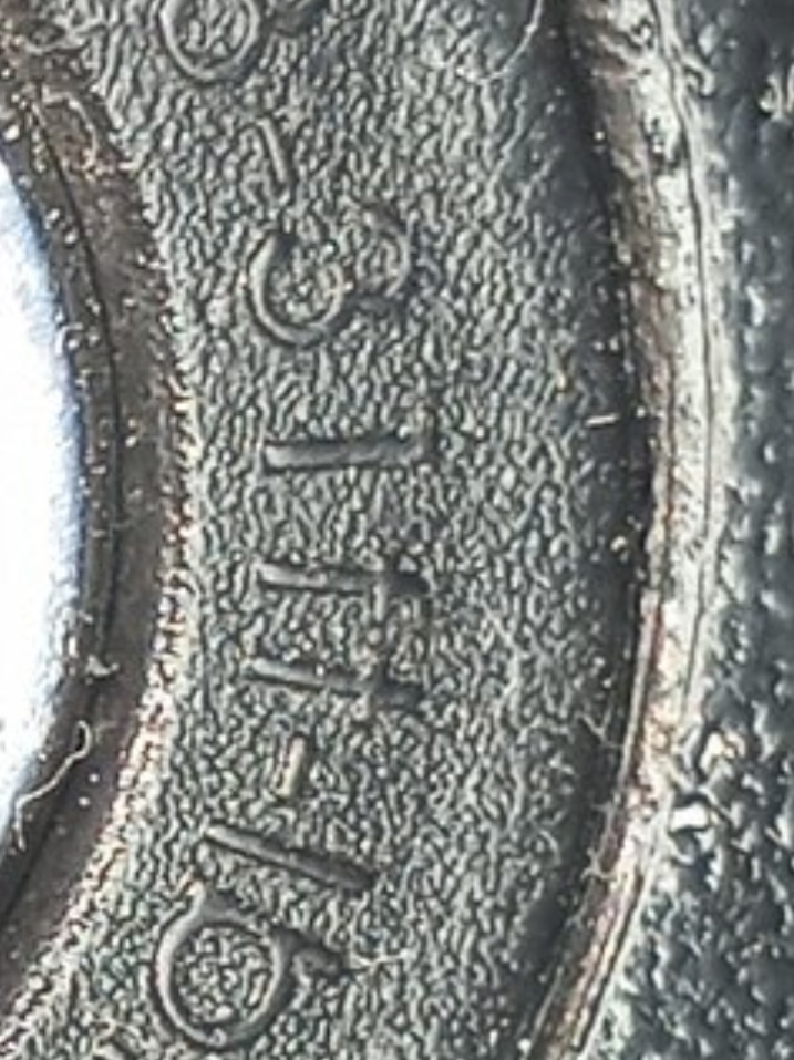

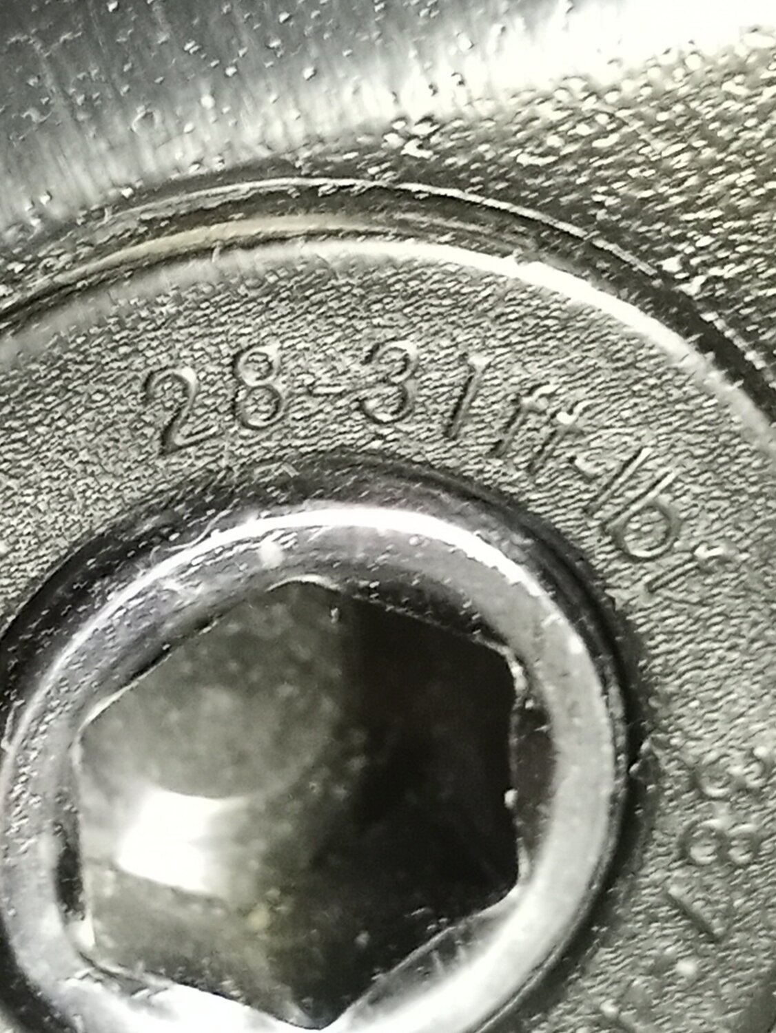

Ahh Crap !!
I thought that was a 7. 😂
I had to put on my reading glasses and take another picture.
I guess a 7 is supposed to be leaning like the 7 at the bottom of the picture. 😂
Maybe I'll just leave it until the horse comes home to roost? 😂

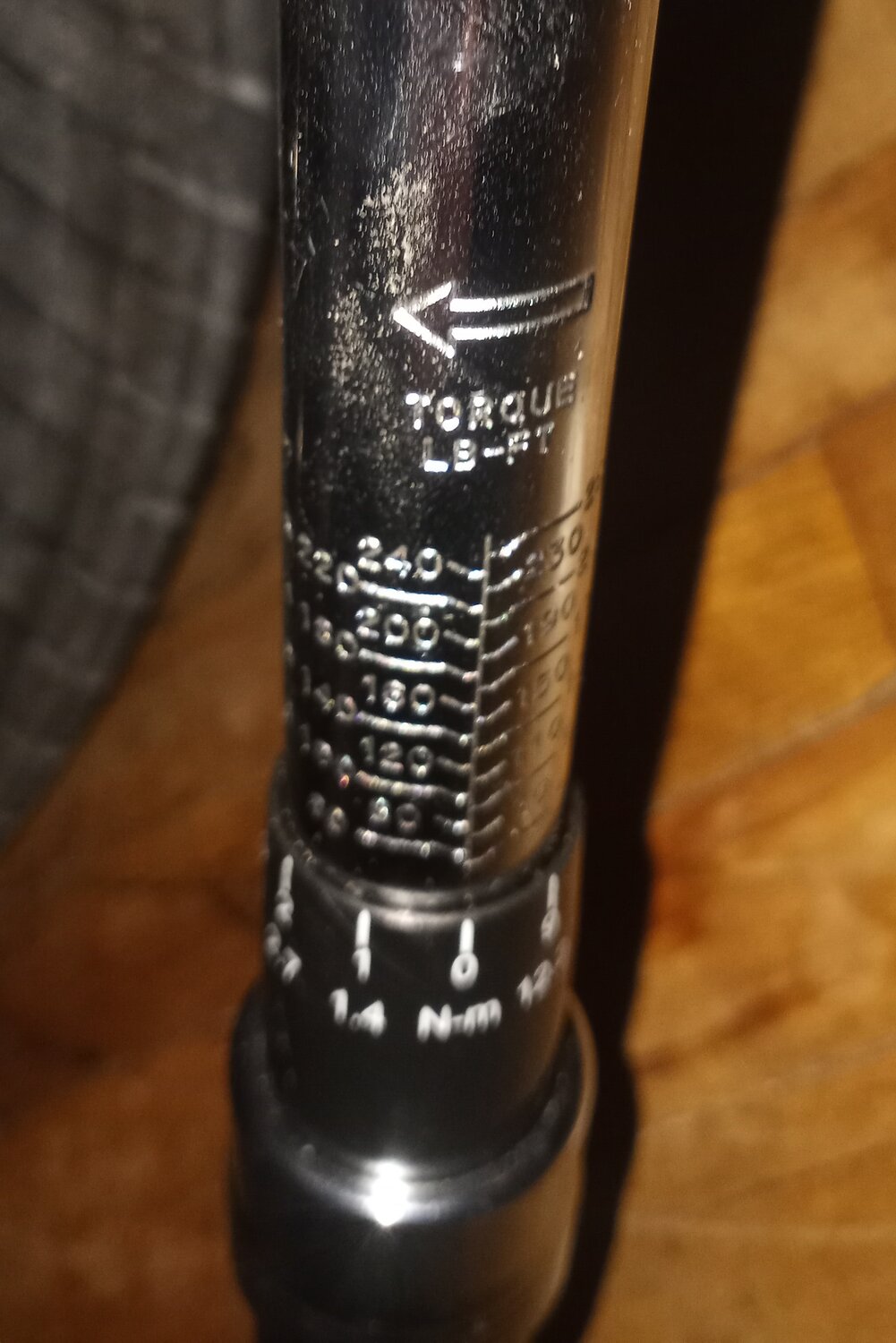

I'll check the torque again with my beam style torque wrench. I'll just make sure it's over ~25
I don't like the clicky ones.
The one in the picture was a joke.
It reads from 50-250 ft lbs. 😂
