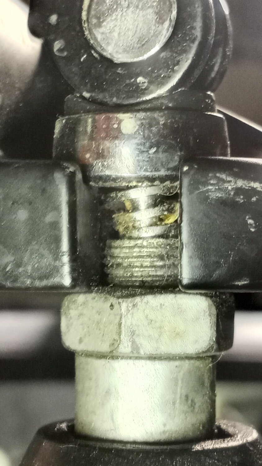

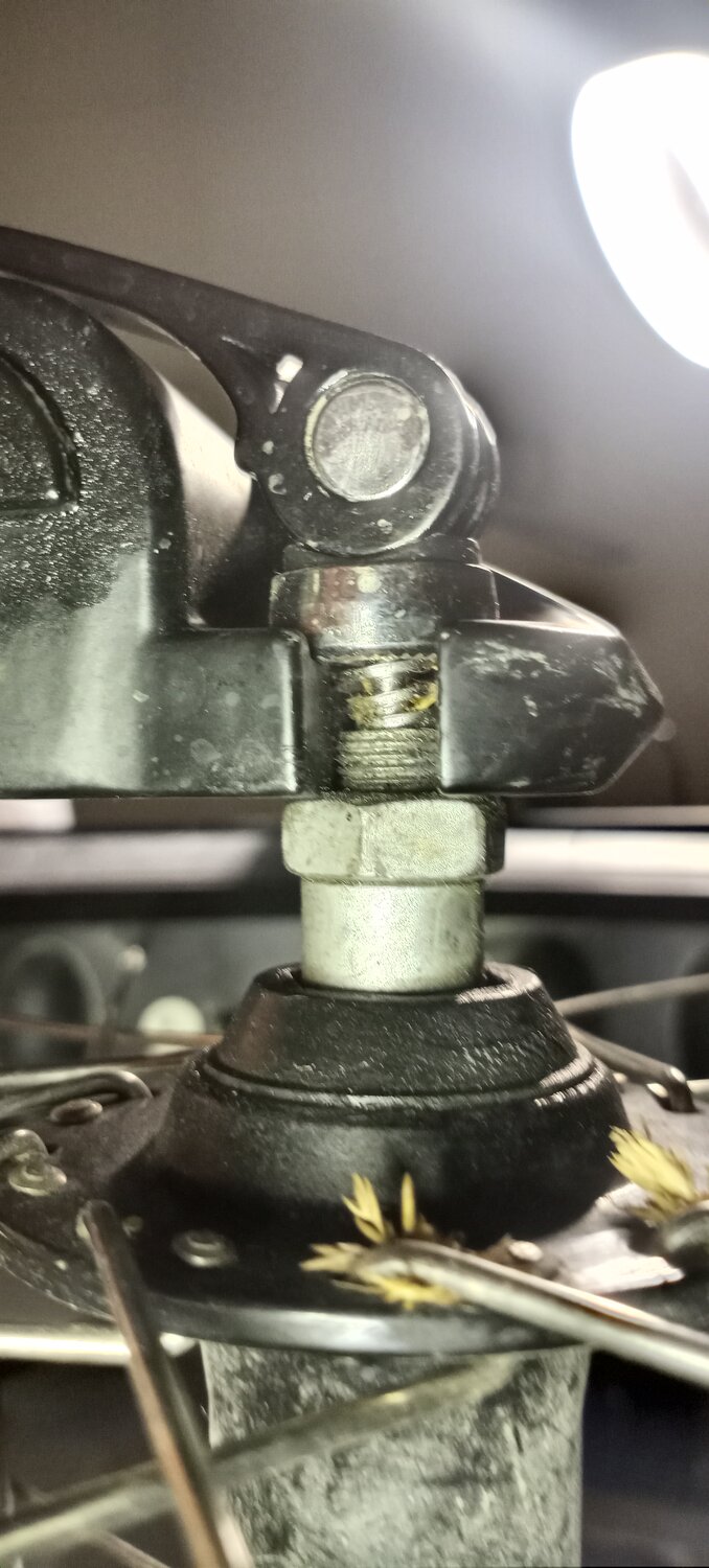

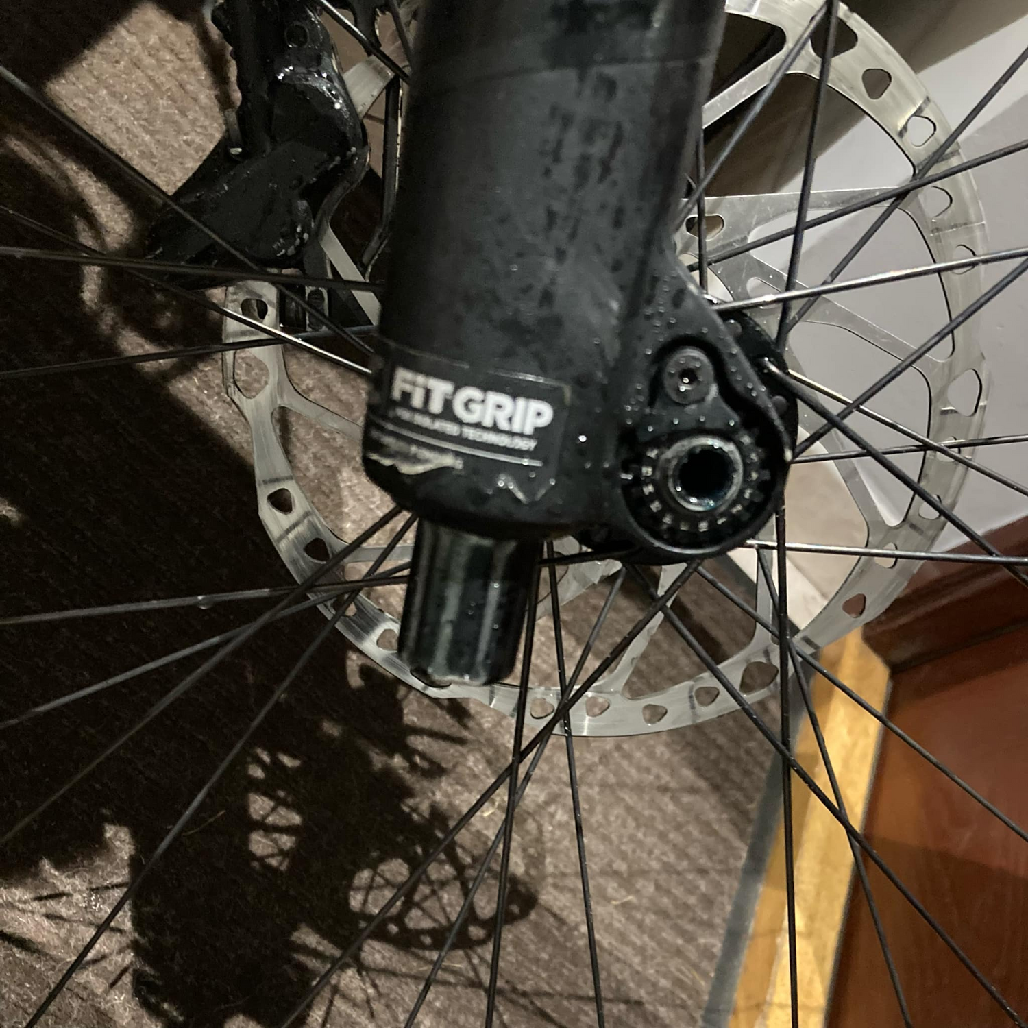

First of all, there is a nut on the opposite side of the fork. The position of the nut is set and fixed by a little screw.
That's the part I didn't know.
I thought the fork itself was threaded so the QR lever could only be tightened in one direction.
Is that the screw?
That looks a little tricky?
I guess the set scew locks the nut in place, and you remove it to let the nut spin so you can adjust the QR locked position?
But you can't see the nut, so you don't know what it's doing, and if it's rotating or not?
Looks like it will take some fussing around to get it adjusted?

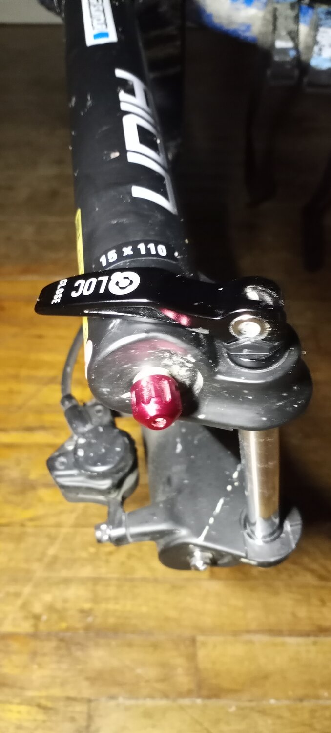

@Chargeride I do not want to mislead you. Here's how it looks on the Trance E+
The opposite side to the handle/clamp.
(usually it is vertically! so the clamp cannot open by hitting a rock),
I clamp my lever around the fork tube aiming "down wind".
I figure it's best protected from getting caught on anything.
The lever is even kinda shaped to fit around the tub.

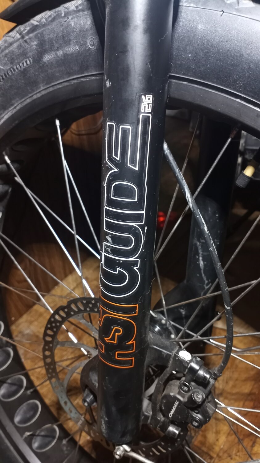

I Don't like how I can't stand the bike on the fork tubes after I remove the wheel, because the dial for the rebound adjustment sticks out further than the fork tube dropouts,..
The dial is delicate and it rotates easily so it doesn't need to be so tall.
Maybe I'll take the grinder to it and cut it in half to give it proper clearance.😂

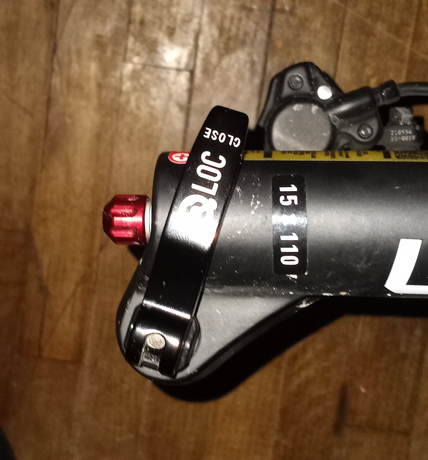

On mine you have to fulky oprn the lever to sit in the slot to be able to turn the axle, which means when it tightens you have to guess the torque so it will be tight when you close the lever.
I havent noticed the other side, I'll have a look.

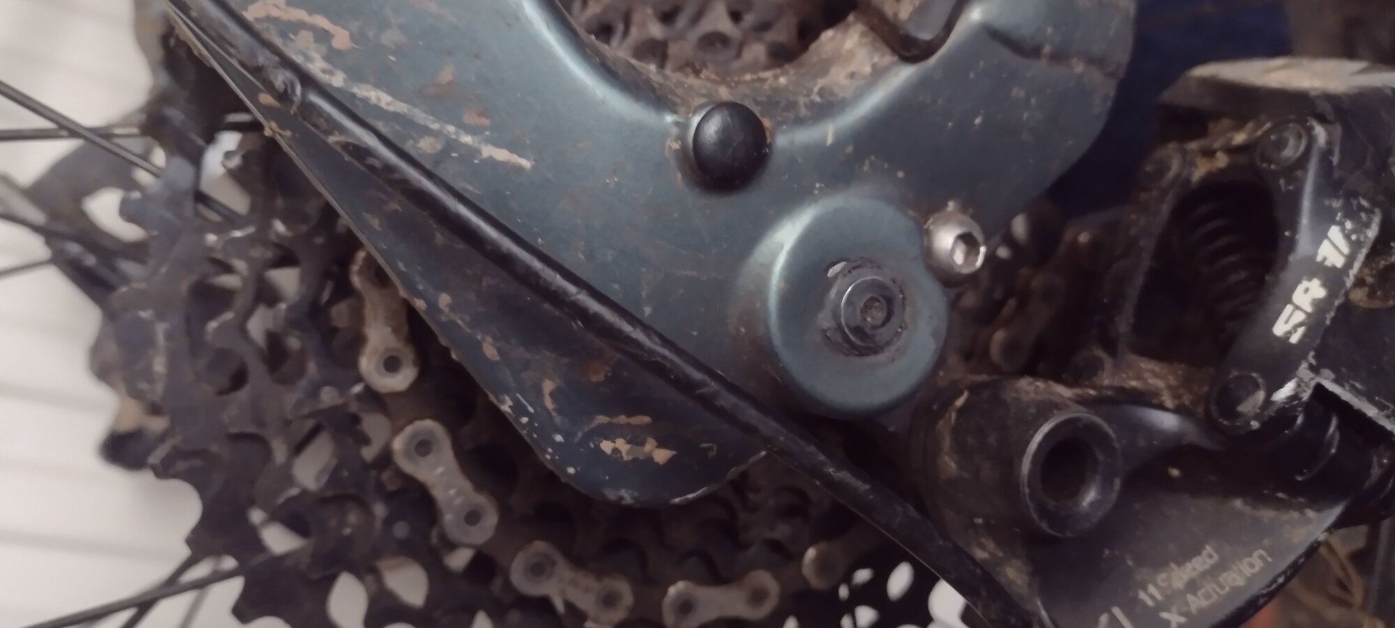

Is that the screw?
My Haibike has one in the same spot. I've always assumed it was for the derailleur hanger, but have never needed to mess with it.
FWIW my thru axle is similar to the one Foofer posted. Pull out the handle and you can rotate to any position. Push it in and it engages with the thru axle so you can tighten or loosen it. Really handy because without that feature I would have to remove the fender stays every time I need to remove the wheel. Thus allows me to ratchet around them.

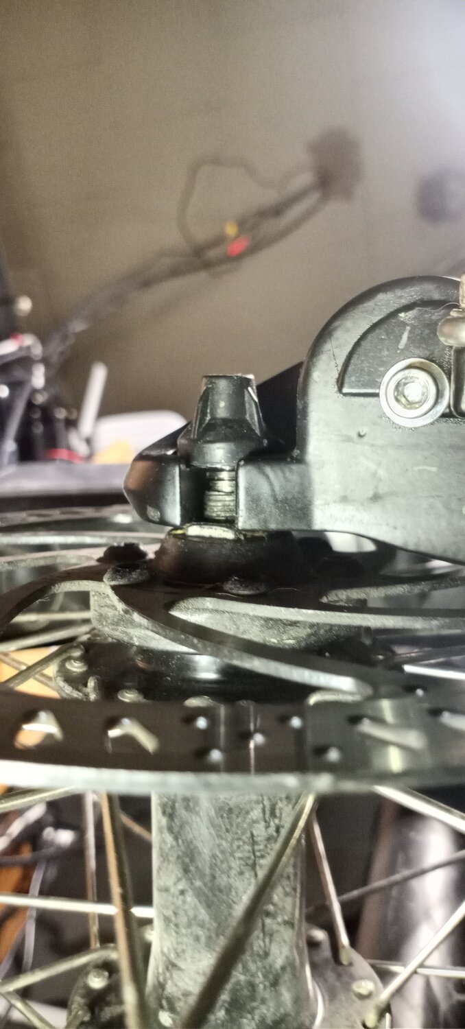

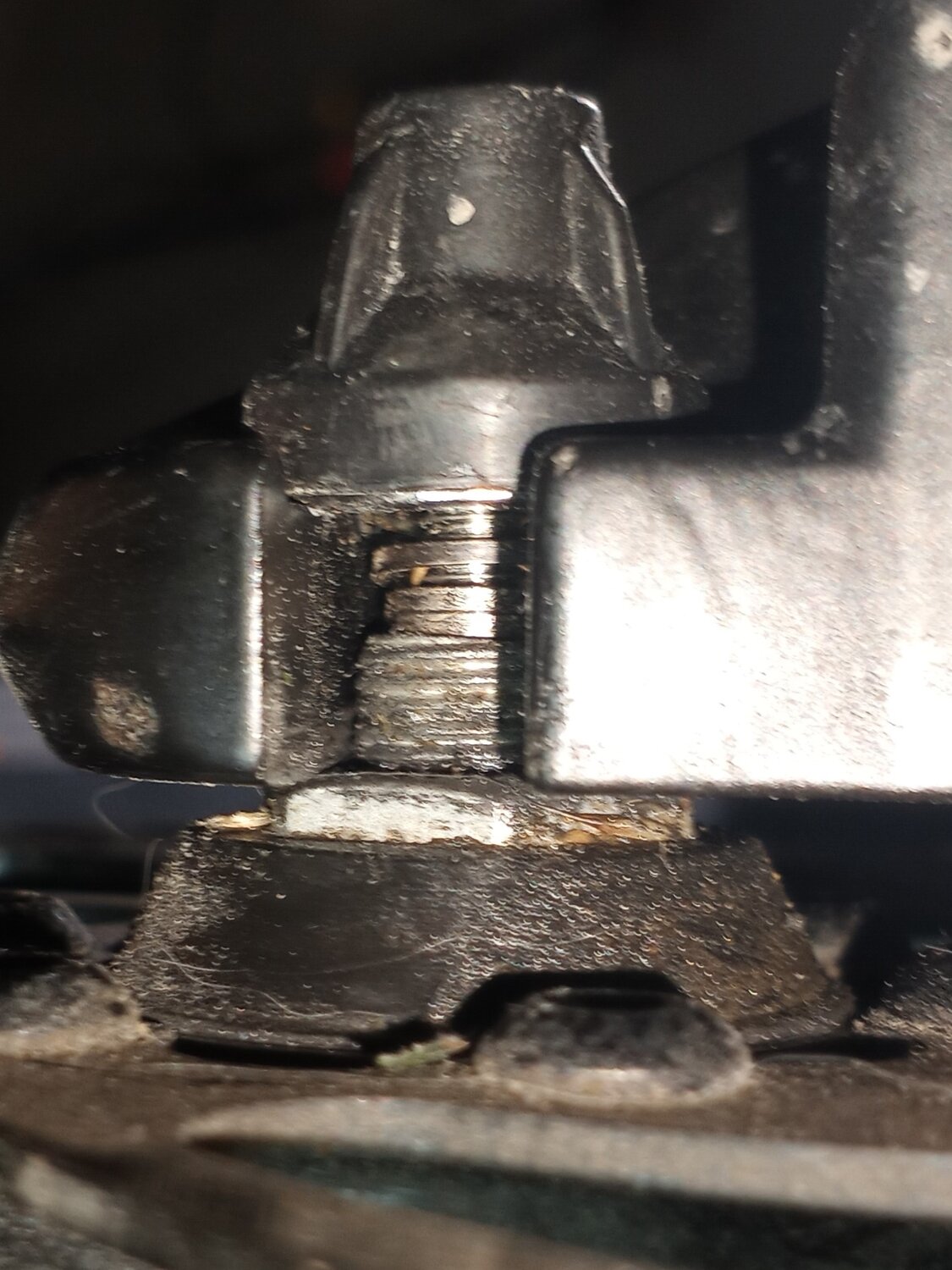

This is just SO WRONG !!!,..
About 3mm of hollow axle with threads cut into it, mounted only half way into soft alloy dropouts.
All for the convenience of not having to use a tool to get your wheel on and off.
I bought an old-school solid axle for a rear wheel that has the proper dropout spacing to replace it,..
