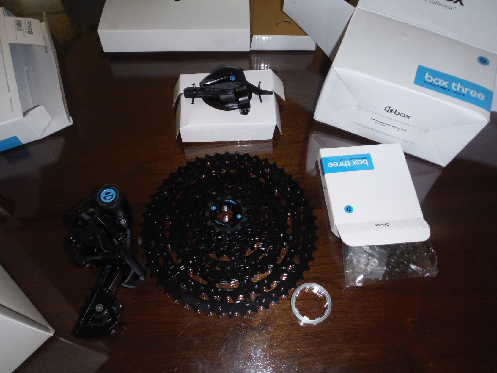

Okay, since you are doing so much anyway, the Tourney shifter, derailleur, and freehub on that bike are made out of stinky soft cheese. With peer review here on EBR, I recommend looking into a Box 3 nine-speed group set. These are very nice. $200. All the parts are perfectly indexed for each other. The gear range is much better, 11-50. The derailleur clutch system is wonderful at taking up the slack. One problem: You will need tandem shift cable because the gear or 'shift sensor' is burred way down under the battery. A big loop of cable must be made to feed it through. Getting the cable through there is a huge PITA even for experts. I have done it twice so far. You will also need needle nose vice grips to hold the gear sensor still while the cable is feed through. The seven speed you have is a screw on type that will not work with a free hub cassette body.

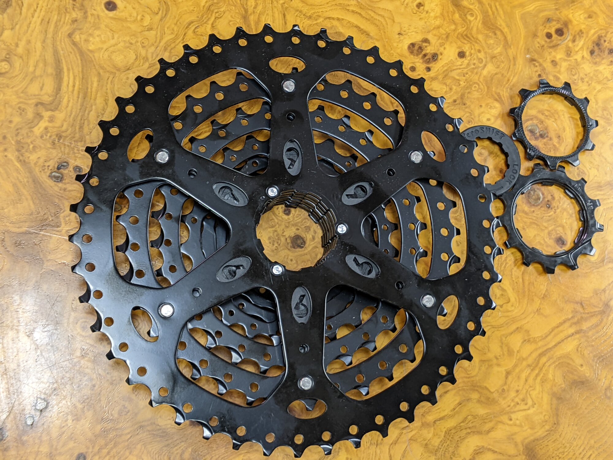

@PedalUma 's Box 3 suggestion is excellent, but you can spend less and do at least as well for yourself. The Box 3 cluster is actually a Sunrace steel cluster whose model designation escapes me at the moment (I own one of each), and its construction is strong but not best for a mid drive. You can see why when looking at the little bare alloy spacer in the pic above. That is needed because the bigger cogs are bolted onto the next smallest cogs. They don't attach to a spider that is full-width. So the spacer makes up the difference. In phone conversations with Box I asked one of their tech guys if that construction is going to hold up under a strong mid drive ... and they didn't know. It is meant to be strong and live in an mtb world. Not an emtb world. But it is a strong product. Whats better?
The Microshift Advent all steel 11-46T cluster. These cogs are single-piece hardened steel and they go all the way to the center. Not even a spider. AND they are pinned together. AND the Microshift Advent derailleur and single gear (best for ebike) shifter that go with it are cheaper than the Box. I have Box components on two bikes. One is a Box Two derailleur and Box Two shifter, with Box 3 cluster. The other one is a Box Two Derailleur, Box One e-shifter and Microshift cluster. And then I have a third bike that is Microshift Advent everything. The Advent parts are less flashy but cheaper than the already budget Box stuff and work great. I like the high quality fit/finish and glass smooth shift of the Box stuff, but the Microshift is so good for so much less its the way for the rider to go who is trying to justify a drivetrain change. The shifter, derailleur AND rear cluster ran me about $125 total. This and the fixed hub will transform your bike. Add in a SRAM EX1 ebike chain ($25 on Amazon) and you won't have to screw with anything in your drivetrain until you actually wear it out.
