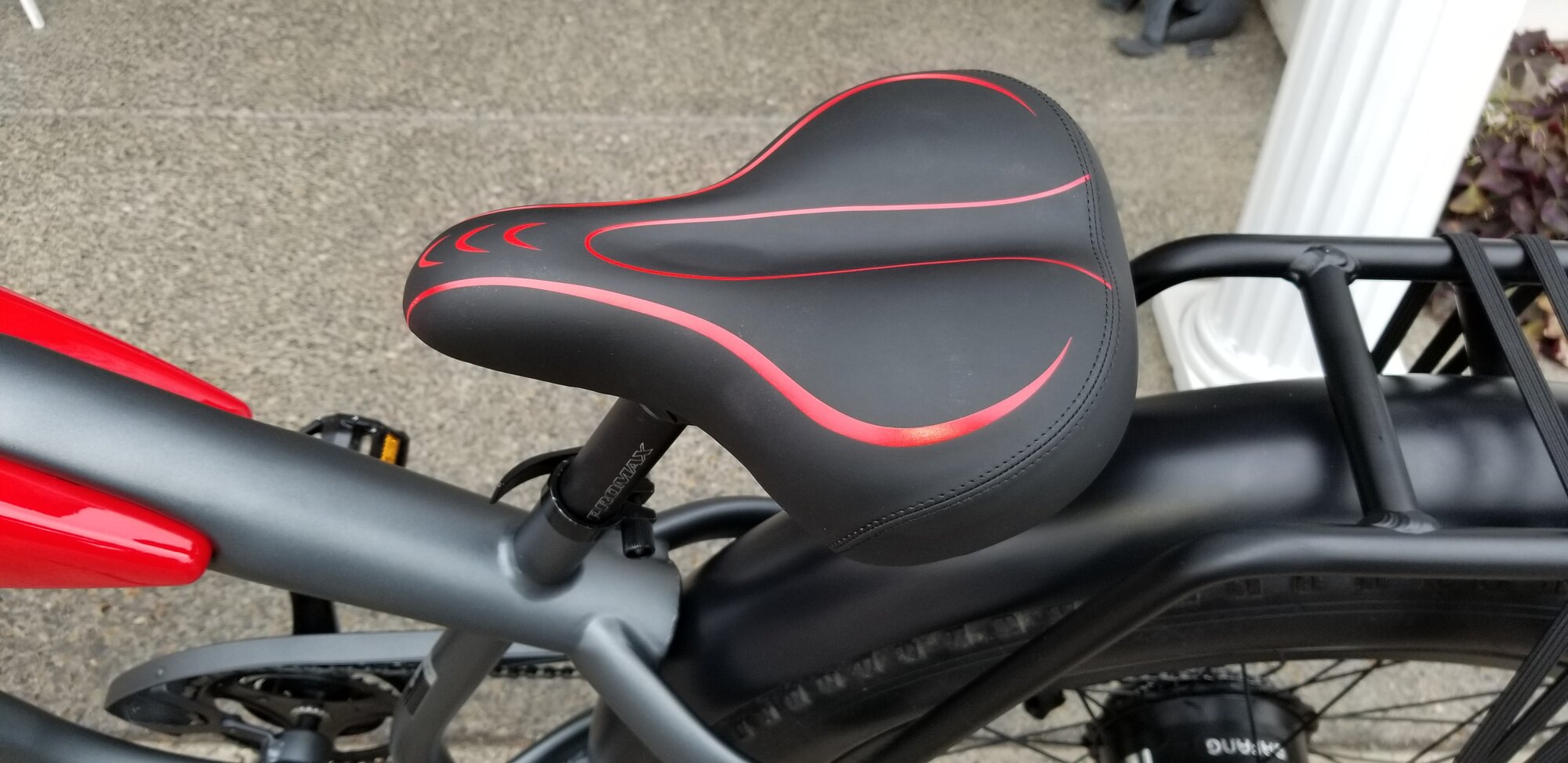

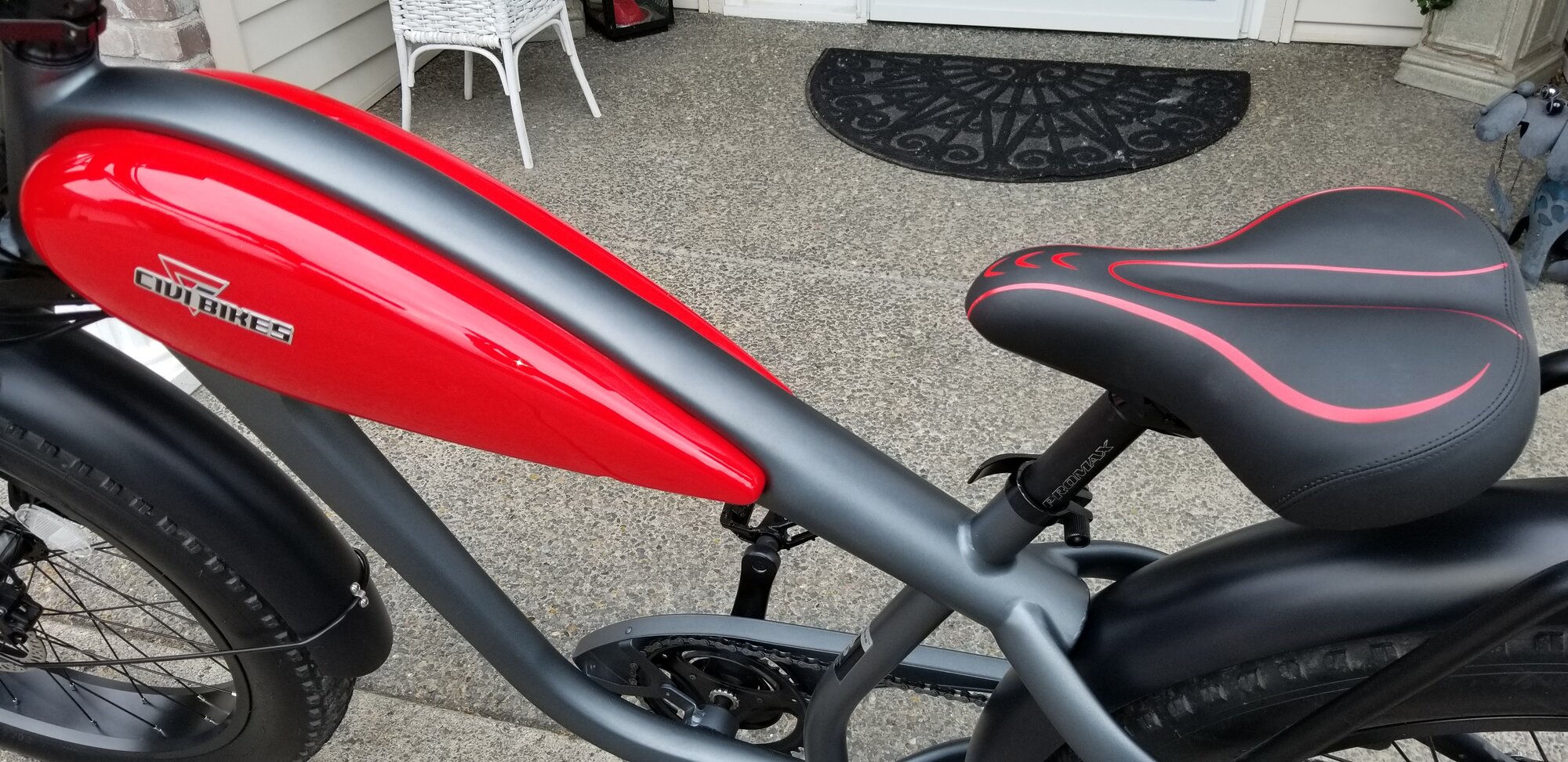

Cheetah Gel Seat and Mirrors Update and Reviews.
The Civi Cheetah comes with an oversized padded saddle with coiled spring suspension underneath. While not a totally bad seat, it does start feeling pretty firm on a long ride so I started shopping around for something more comfortable. I came across the Yoleo Gel bicycle seat, waterproof, ventilated, ergonomic, dual ball suspension, and an extra thick padded full size seat. Plus it has cool Red pin striping accents that match my bicycle nicely. Looks like it should have come this way. The seatpost clamp it comes with is a small diameter and is easily removed for rail mounting. It was a piece of cake to install and adjust.
Bottom line is it's a huge improvement and I love it! The red stripes and highlights really go with the bike and make the look.
Several companies market the seat under different names and it comes in a couple of colors. Yoleo was cheapest on Amazon, about $38.00.

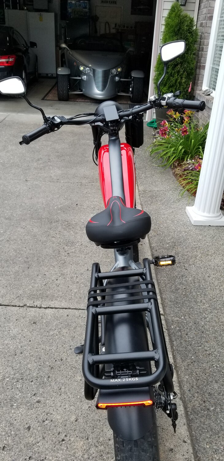

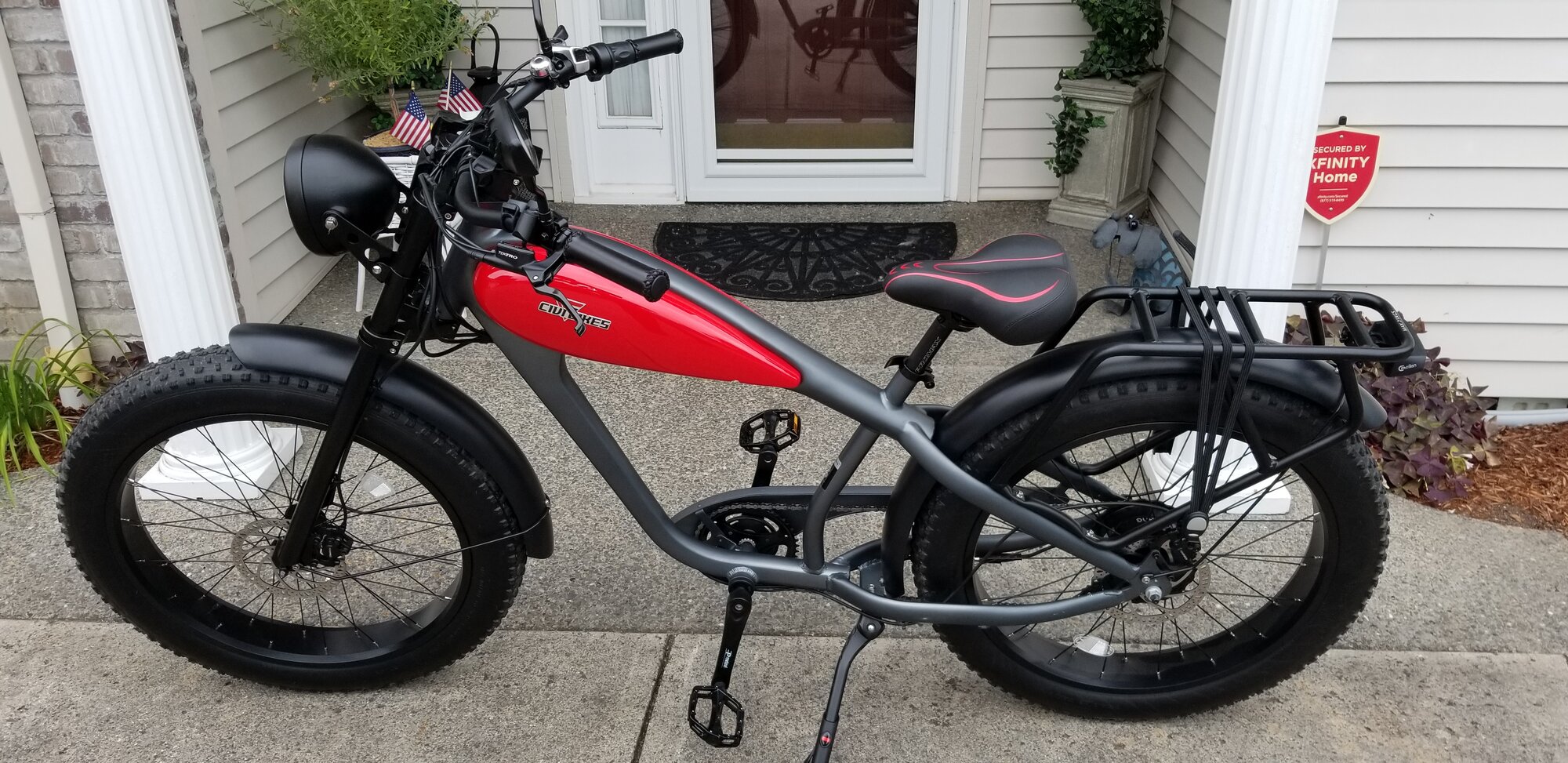

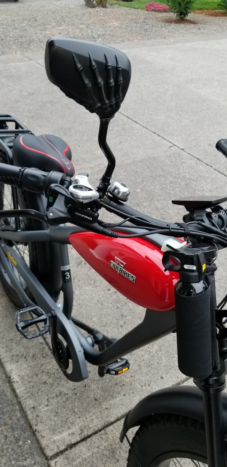

A mirror, or mirrors were definitely a safety necessity and come in a wide variety of styles. I wanted a functional pair easy to see out of and came across a fun set of aluminum matt black creepy bone fingers, clamp on handlebars mirrors. The installation was straight forward and easy. I did not need the height extensions that came with them. They have quality mirrors and excellent finish, the matt black matching my other accessories nicely. TopCabin is the brand I bought and they come in a couple of other colors. Black, silver, or blue. About $20.00 on Amazon.
Future upgrades planned are a larger chainring for cadence at speed and a rear rack bag. Watch for more reviews.
As always, keep it upright and be safe. You can always tell a happy a happy bike rider by the bugs in his teeth!
What is the black canister strapped to your fork tube used for may I ask?
Oh yeah, that is a good picture of my Bear Spray in an elastic holster tie wrapped to the front forks.

Would you mind posting a pic of how you mounted that rear brake light? I have the exact same one and cannot figure out how to mount it to the license plate frame....
Had to get creative. I used 4 tie-wraps using the optional 2 pc seat mount. I screwed it together and drilled holes through the plastic bracket for the tie-wraps and cinched it to the metal plate bracket with 4 tie-wrap cable ties.
Fits protected under the rack nicely and is easily removable for charging. Photos show some details.
Tape over the daylight senor on the bottom of the light to use in the daylight. I ride with it flashing red and rarely use the blinkers or the lasers. I'm never sure they're turned off. Just want to be seen. Be well.
