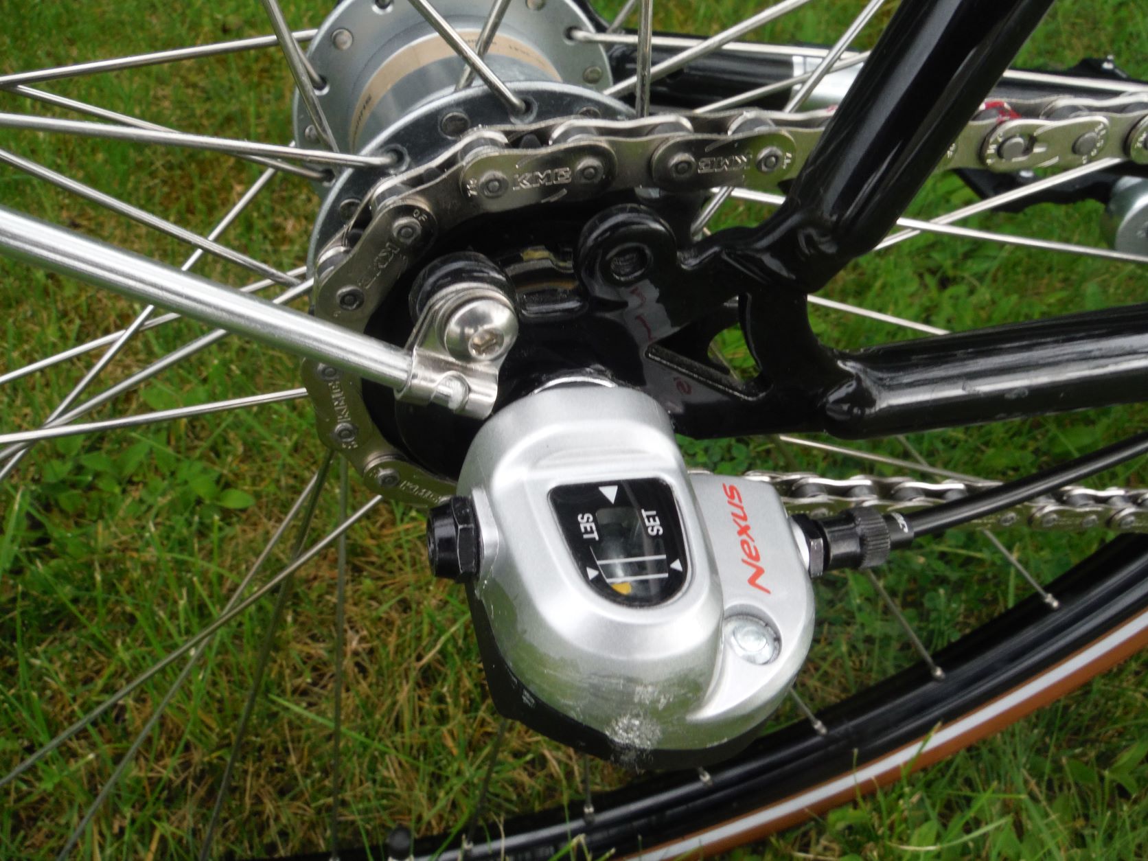

I have yet to see a single speed or IGH chain checker. The wide chains last.
I remember “back in the day” when I was growing up, 60’s and 70’s they made three speed bikes that shifted inside the rear hub.

“back in the day”

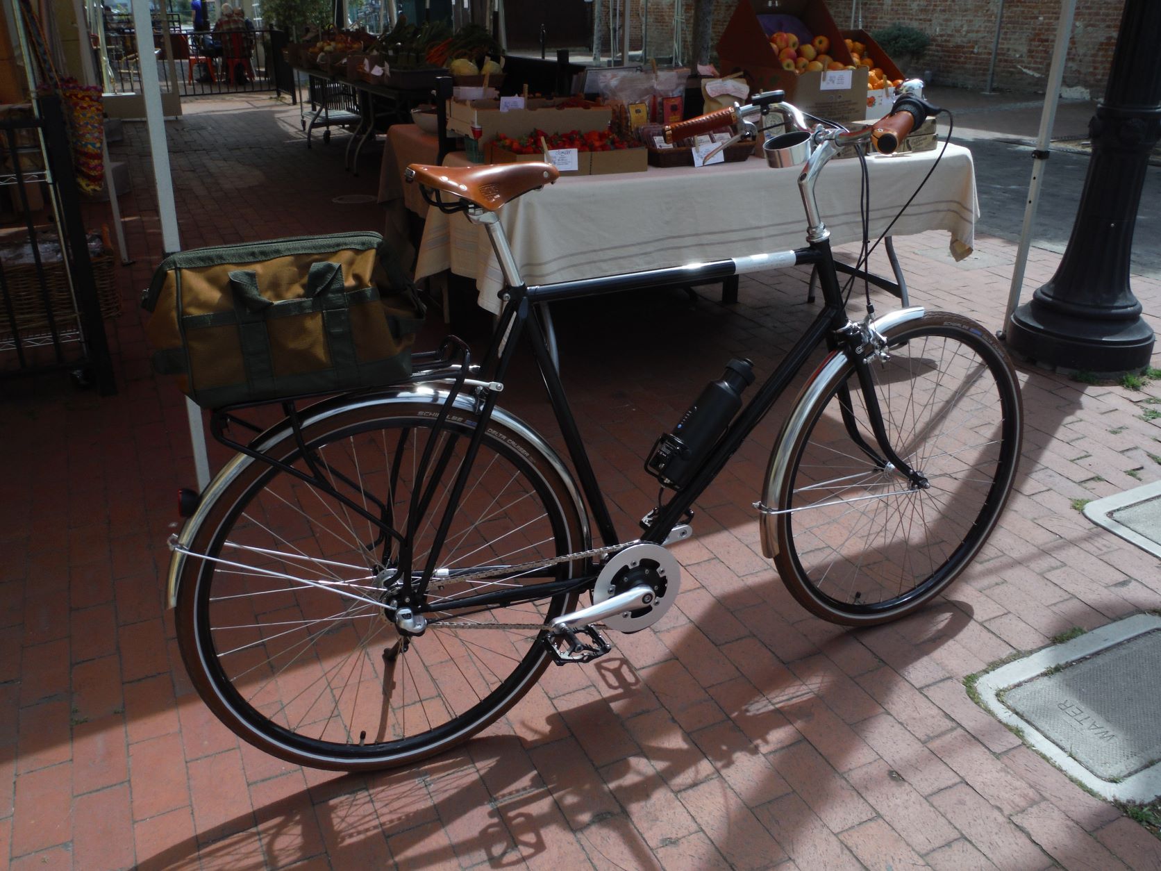

My daily go to bike is like that, 3-sp with a coaster brake. I so love to blow past the guys in spany-X on a bike that does not look electric. This is my daily rider's new brother. Also a 3-speed with a coaster brake. 85Nm on the mid-drive. Yup, that is what electric bikes look like.
