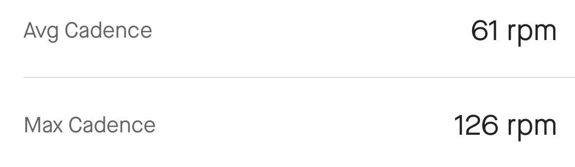

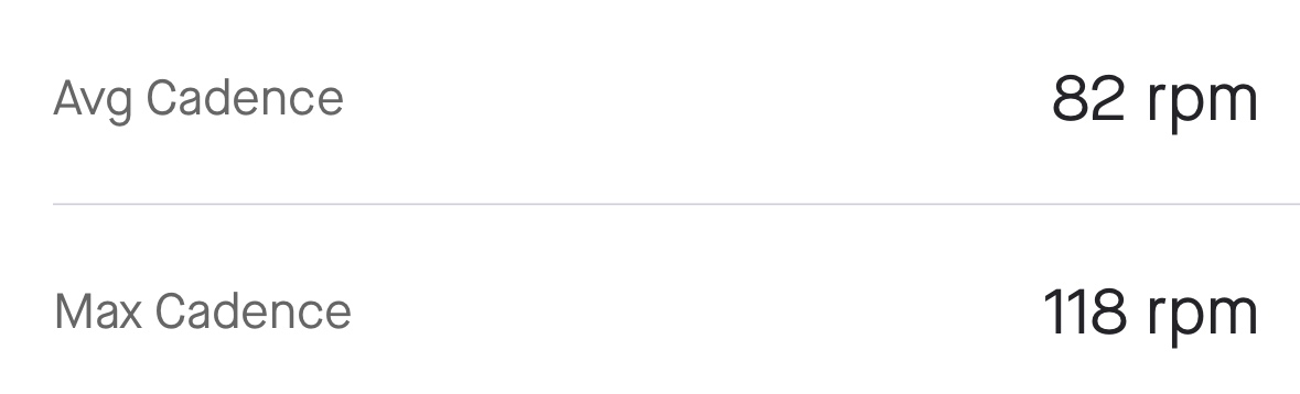

From Strava, from a virtual race on an indoor spin bike
From Strava, on an outdoor e-bike (single speed) metric century, approx 4 hours

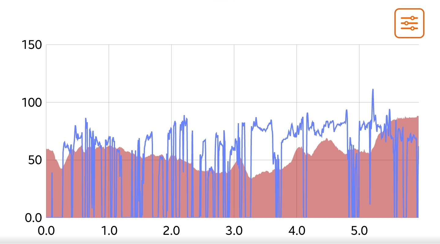

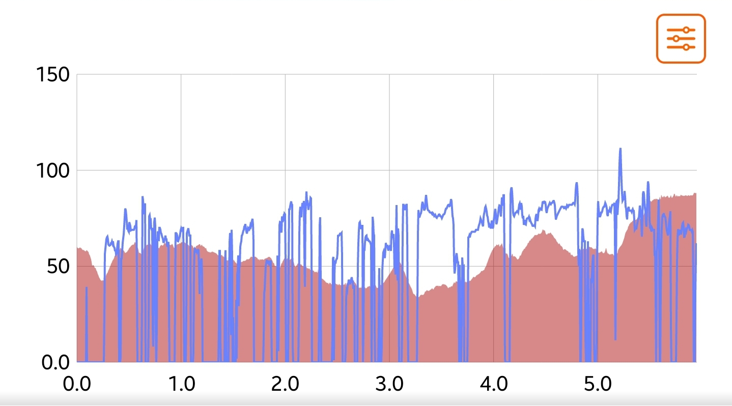

Yesterday, Friday, took a slow, flattish 8-mile ride with my wife — mostly through the 1.6 mile long Carlsbad State Beach campground, which was filling up for the weekend. Average moving speed was 9 mph, with many stops to ogle scenery, and many slow-downs to get around meandering pedestrians and parking RVs. A few short uphills, mostly at the end.
Here's my cadence for the last 6.0 miles, PAS 1/9 the whole time. Despite the unusually slow speed and all the distractions, I still gravitated to 80ish RPM when I could.
Ditto when I lap this same campground when its empty. Stay close to the 15 mph speed limit in that case and spin 80ish RPM pretty consistently without thinking about it. For me, 80ish RPM is just baked in at this point.
Jeremy,
What did you use to collect the data?
Thanks
Jeremy,
Thanks
This cheap Bluetooth sensor plus the RideWithGPS app for Android.
The free version of the app might monitor/record cadence, but I'm not sure. With the highest subcription level, I can add a cadence field to the ride-in-progress display and watch my cadence on the phone in real time while recording cadence the whole time.
Really like the app overall. With the wrong "handlebar mode" settings, the app can kill my Samsung Note20 battery in under 15 miles, but battery usage is tolerable now.
