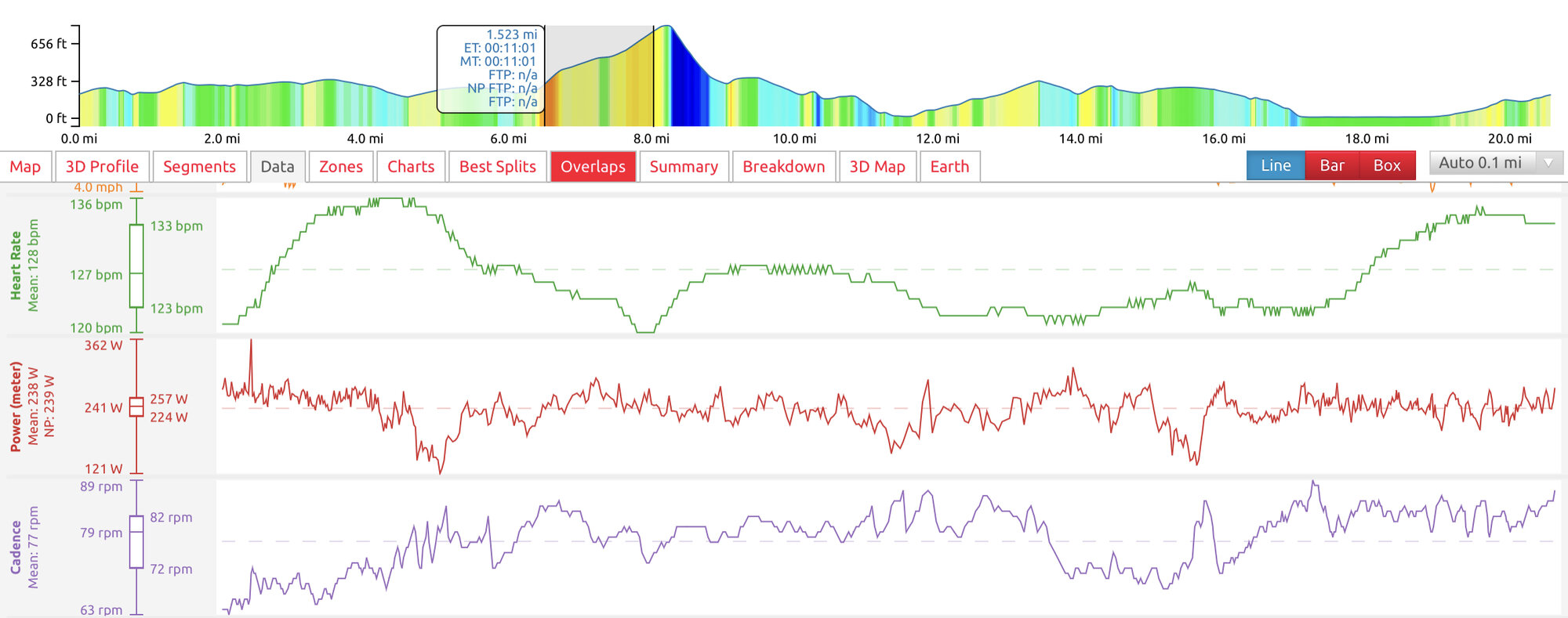

On flattish terrain, I find myself gravitating to a freely chosen cadence (FCC) of 80±5 RPM.
Typical RideWithGPS recording. Full metrics at bottom.
This FCC isn't a conscious choice. Seems mostly comfort-driven — primarily by my finnicky knees.* Speed's generally acceptable at PAS 1/9, and muscles and cardiovascular system are willing to play along on all but the steepest hills. So I just make it happen — first with gear changes, then PAS. Most hills have little impact. The larger dips in cadence just pull my average cadence down that much more.

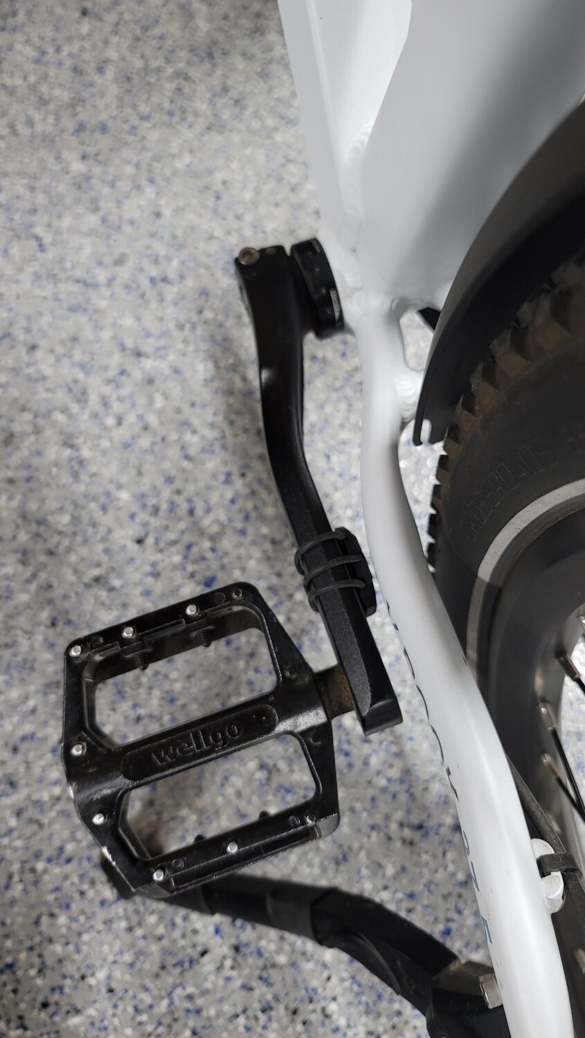

Out of curiosity, what are you using for a cadence sensor? I haven't had one since the 1990's as part of an old-school cyclocomputer and I miss it. I haven't put one on because the cyclocomputer of old is the ebike display now in the present day and I don't want to stick another screen on the bars.
The $20 crank sensor below, monitored/recorded via Bluetooth with RideWithGPS running on an Android phone on my bars.

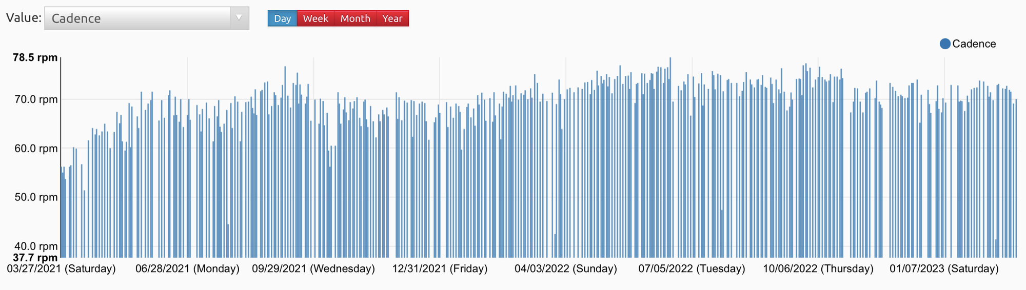

I have power, cadence, speed, heart rate, etc data for every (purposeful) ride I’ve taken in the last 2 years or so.
Here‘s the average cadence of every ride over time. Of course, including stops and starts and coasting lowers the average.
data for a steady effort (in this case a climb) on one ride shows the 80ish cruise.
