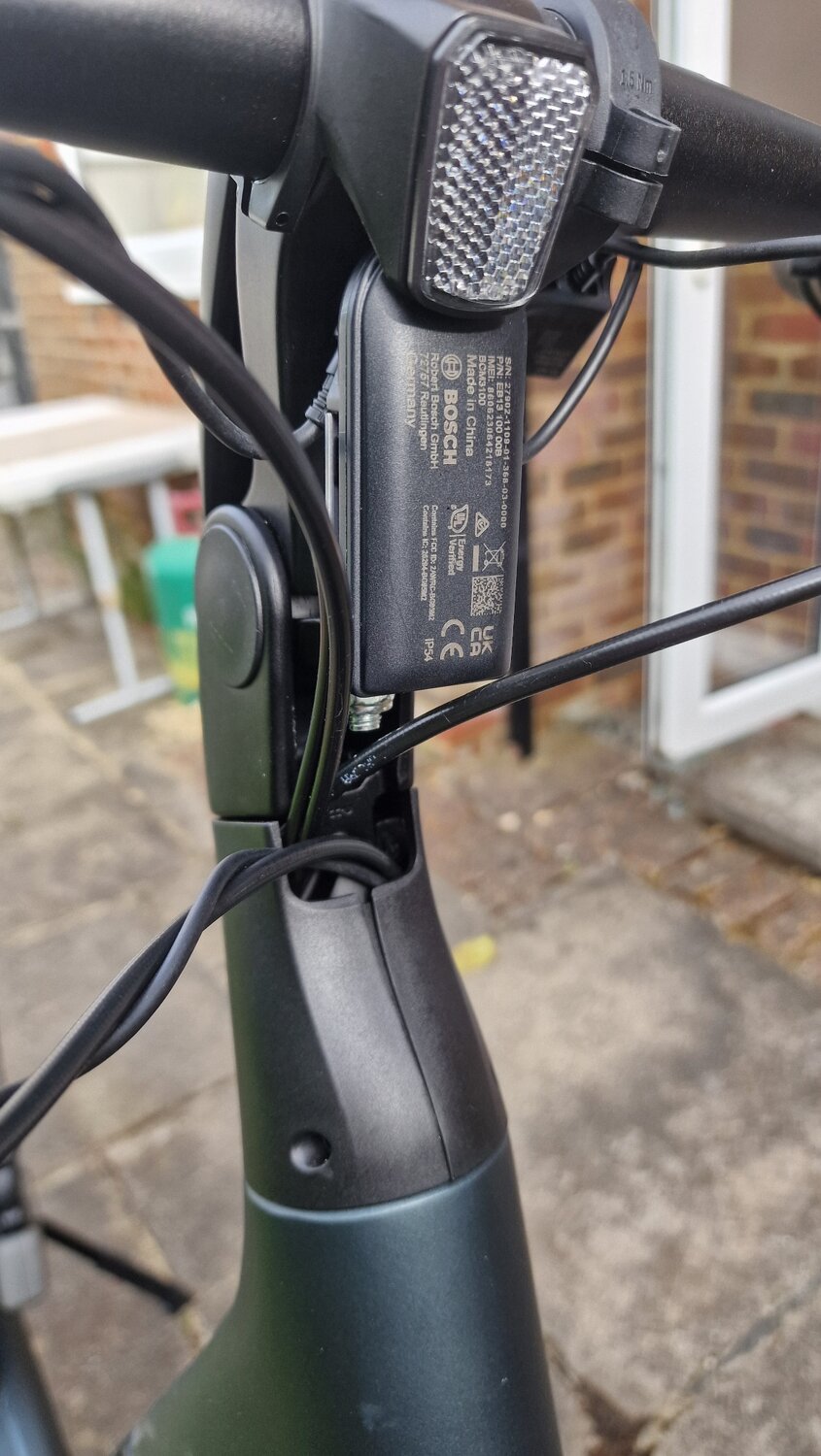

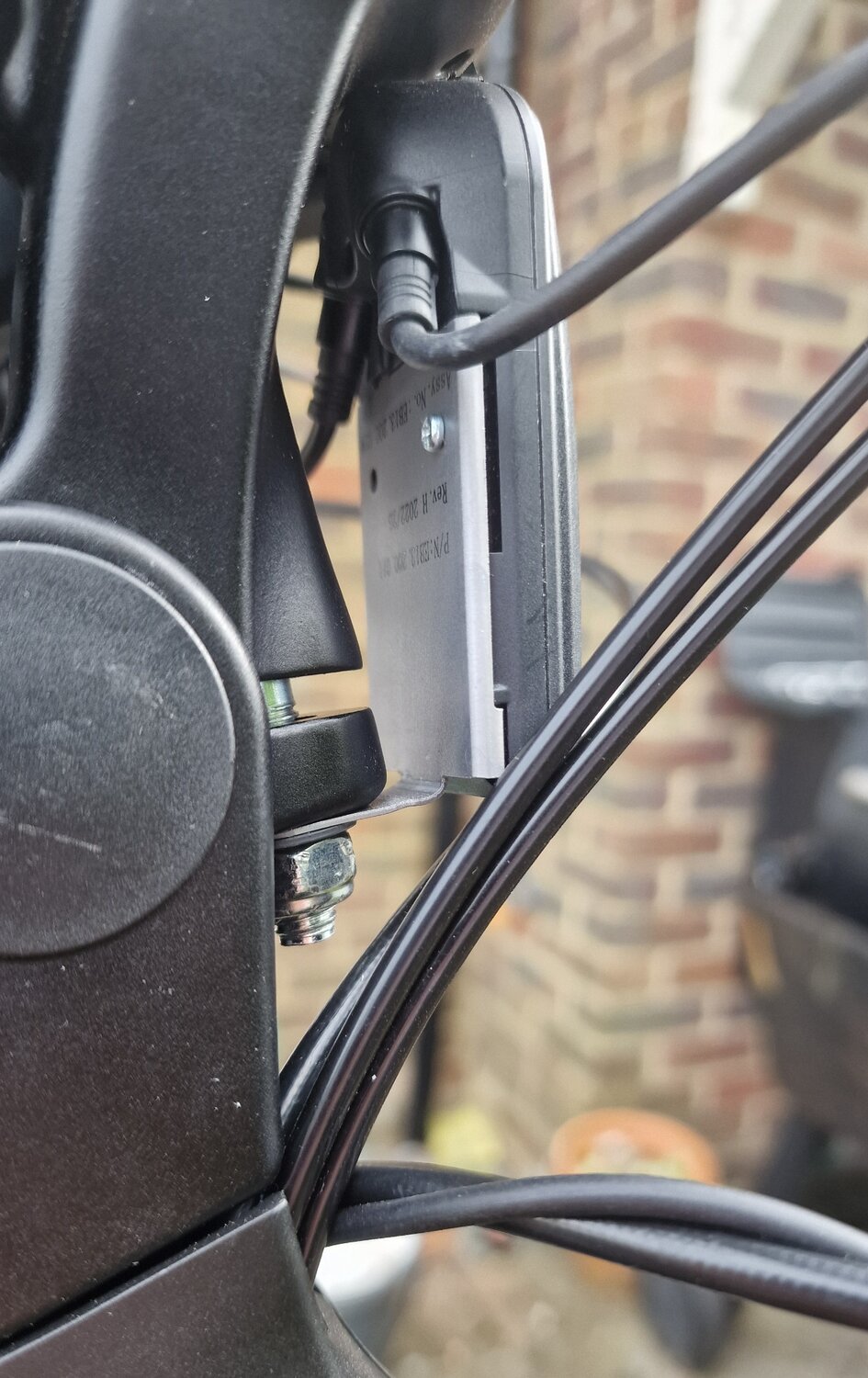

I have a Gazelle Avignon C380 Smart System. I opted for a simpler modification to install the Bosch connect module, under the handlebars. Here the module is in a near-vertical position, but I have tested it extensively and the alarm etc works perfectly. As the connection is simply in series with the display cable, it can be fitted using the short cable supplied with the Module. You will need to drill out the hole in the metal bracket to accommodate the steering head clamp bolt, and then shape the bracket to fit under the bars. It is necessary to cut off the plastic nib on the nose of the module. Photos below. Let me know if you need more info?
ps: the bike comes with Gazelle's version of GPS module, but after testing I realised it is not as fully-featured as the Bosch, hence I purchased the module online and fitted it myself. Thanks to this forum, I did not bother with trying to fit it in the conventional position under the motor covers!
